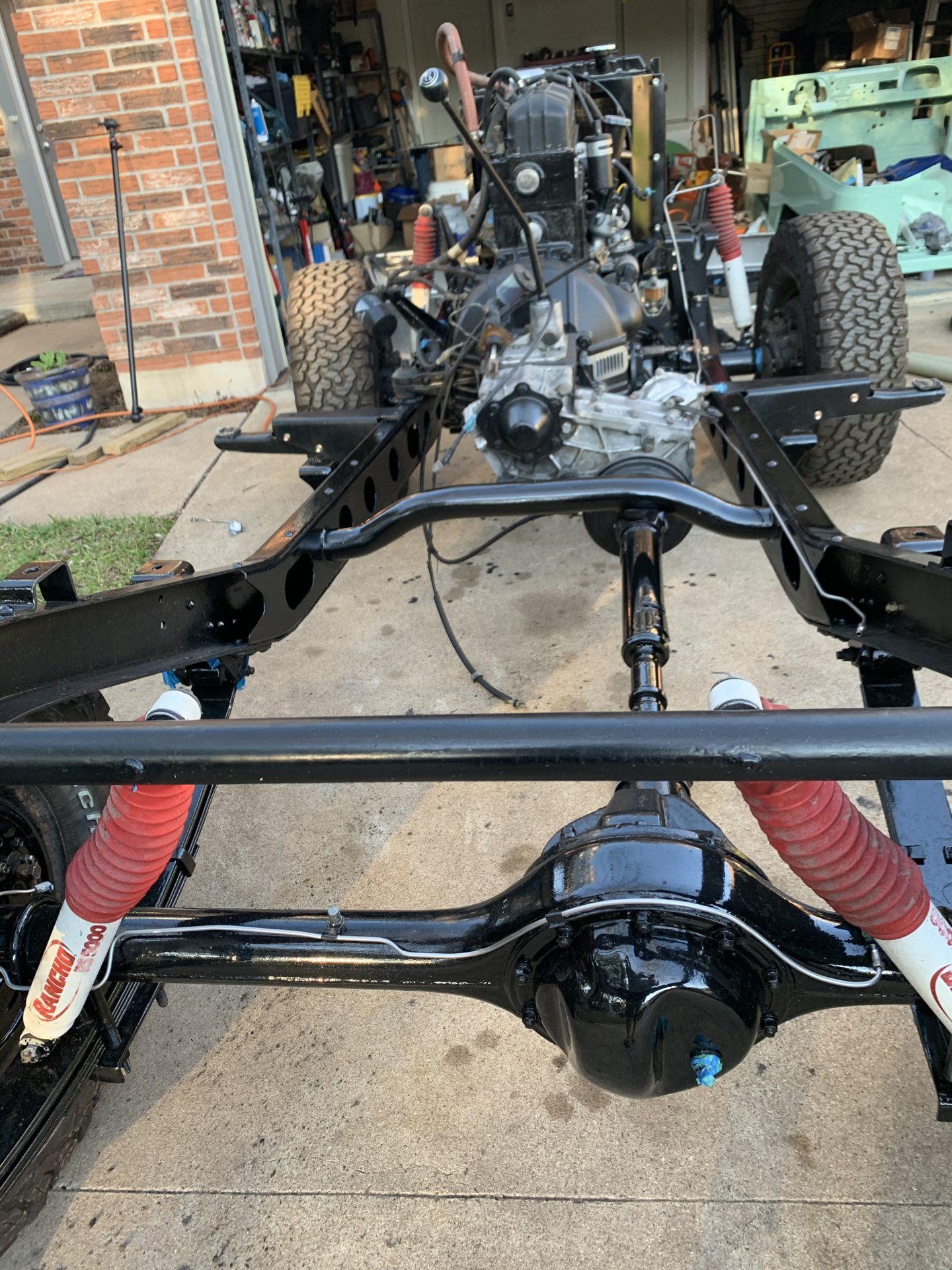

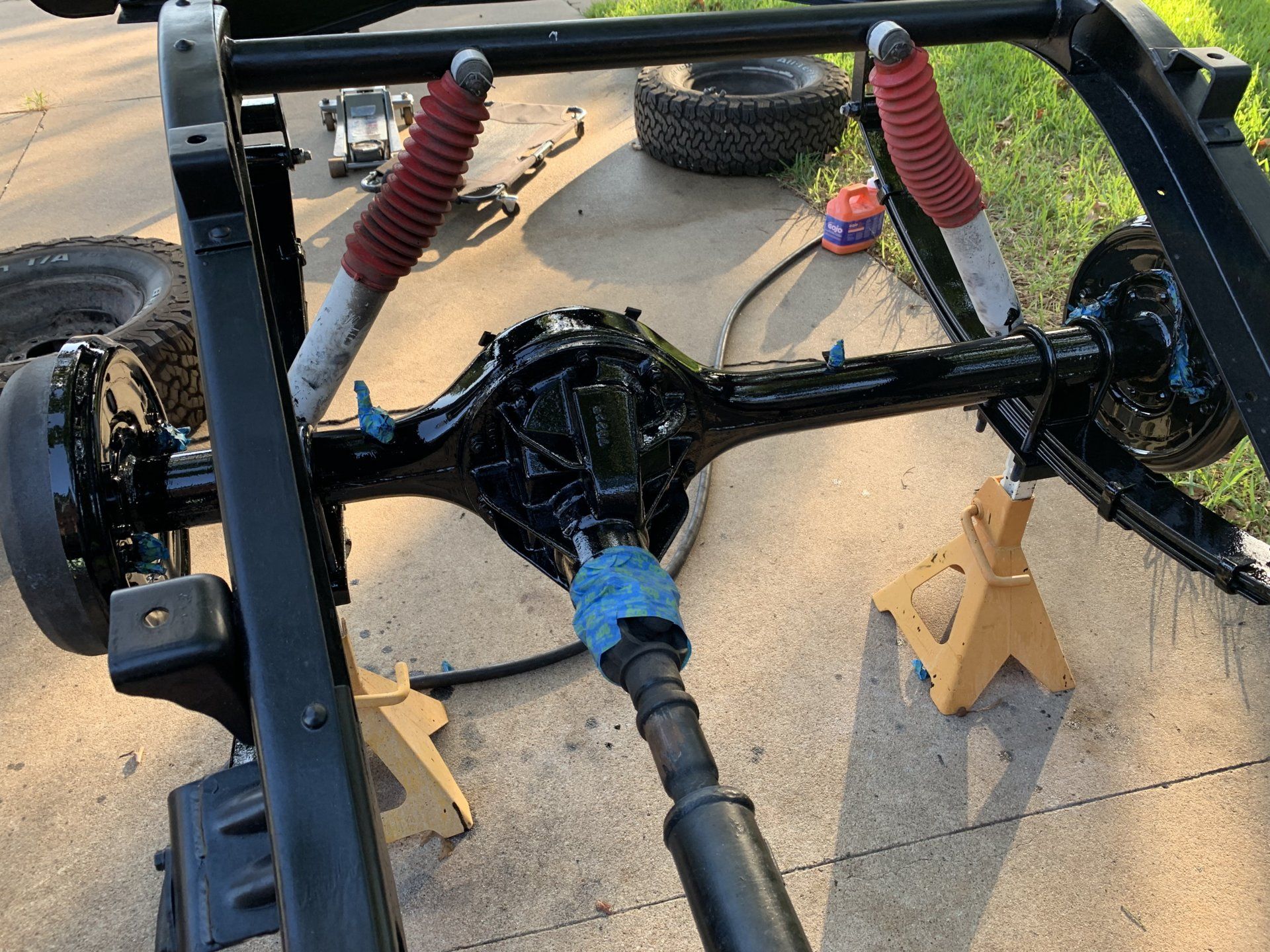

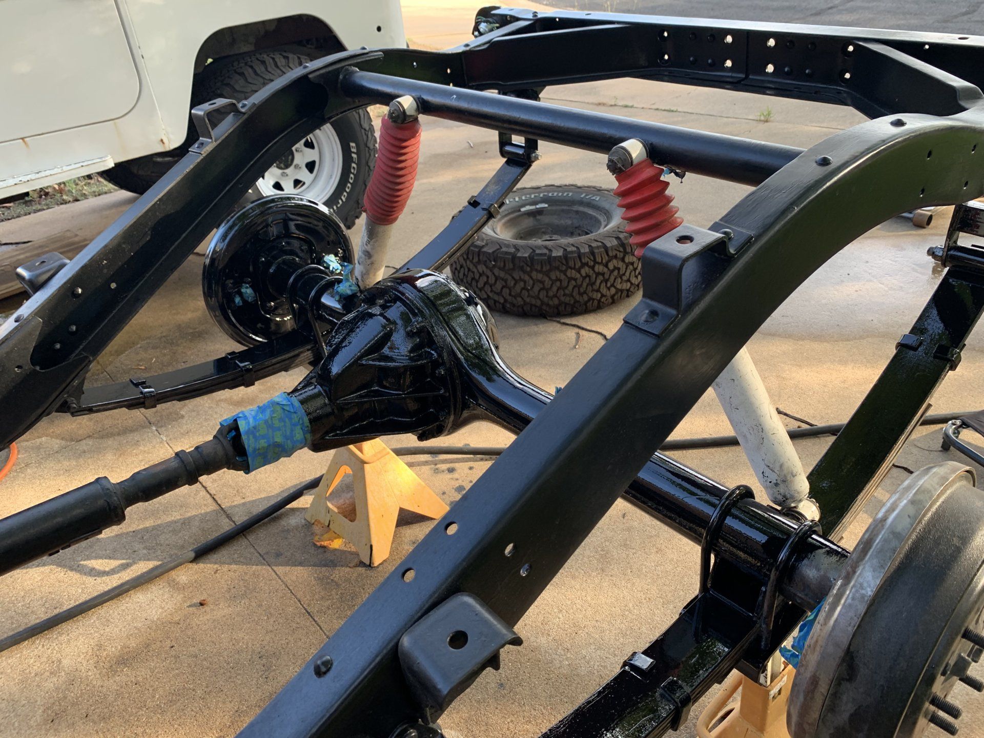

The ‘67 took a few more hours of wire wheeling, but the rear axle saw first coat of POR-15.
This gets the tub closer to back on. Left yet is installing a wire harness from @Coolerman and reinstalling the brake lines.
Not highly a technical update but progress to report. I finally applied POR-15 to the front axle and leaf springs.
If you’re considering POR15, I would recommend buying the small six pack. Link here: Amazon product ASIN B003SA053G.
Reason being is this stuff will never seal up right so unless you’re ready to paint an entire quart at once, most will go unused. Ask me how I know...
Project do it right the second time had a productive weekend. Started the beautiful day sanding out brush strokes left behind from initial POR-15 coating. Par for the course when you’re learning while doing.

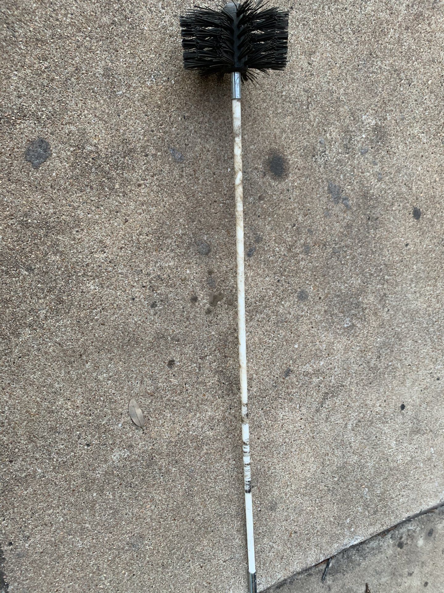

Also used a tool normally reserved to clean dryer vents as a way to apply POR-15 inside the frame rails. Worked well as the flexible tune connects to a drill which allows you to rotate the brush while in the rails. Definitely messy work.

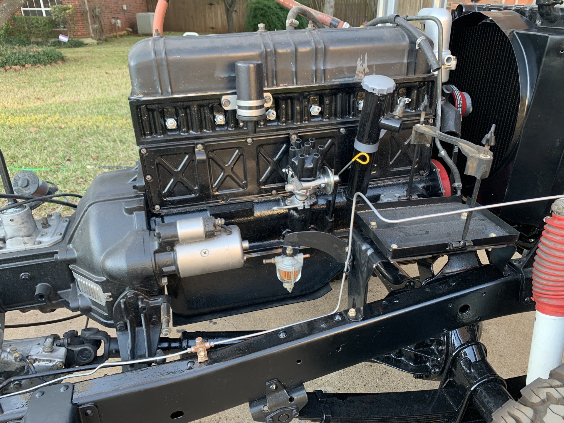

Mounted the battery tray and glass bowl fuel filter.
Dropped in a oem radiator into the reassembled shroud and bracket. Also, I installed the coil in the proper direction, because god forbid I do it correct the first try.

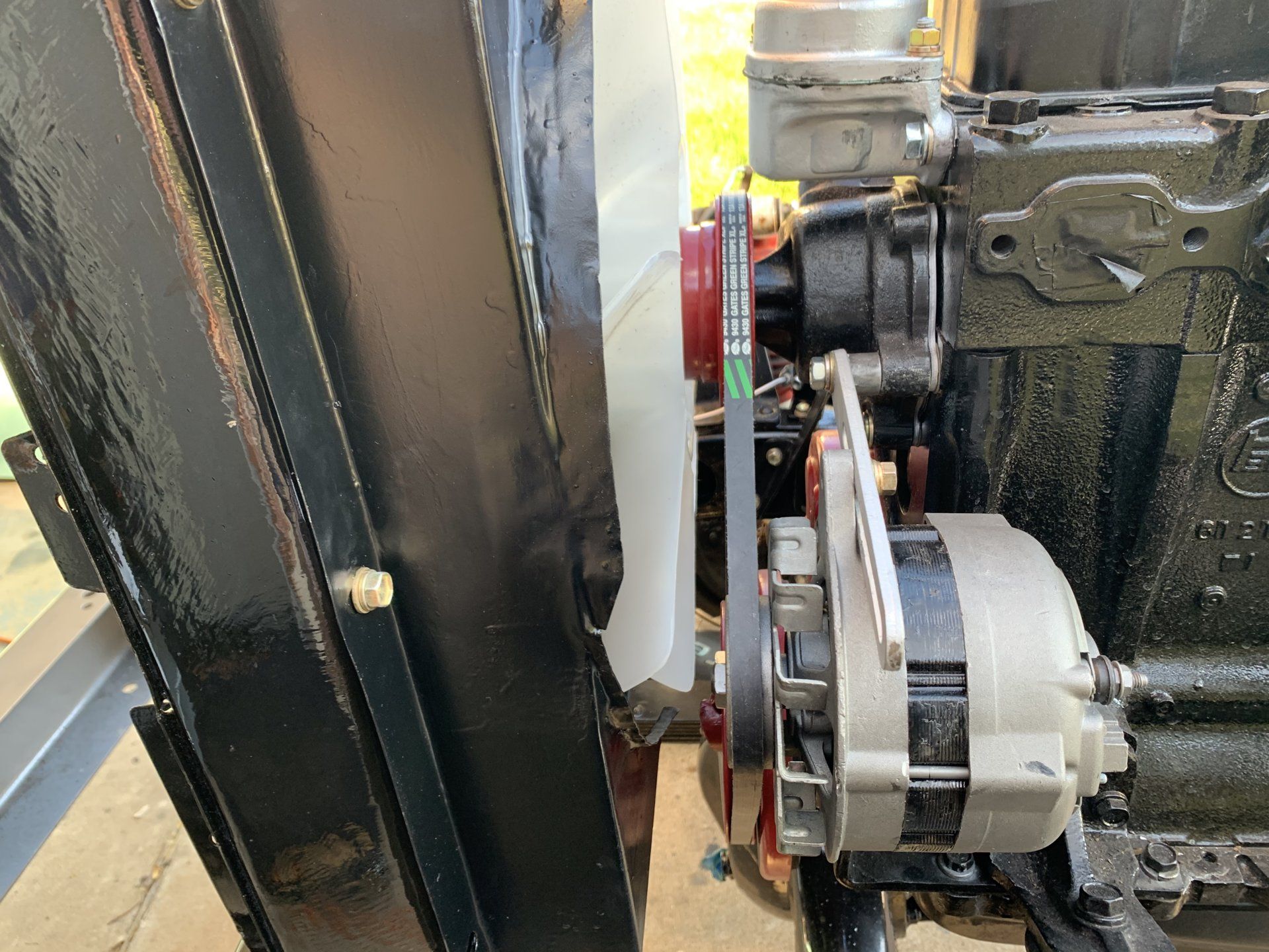

Spent more time than I’d care to admit aligning the sweet alternator I got from @65swb45
probably still not correct which would align to project theme

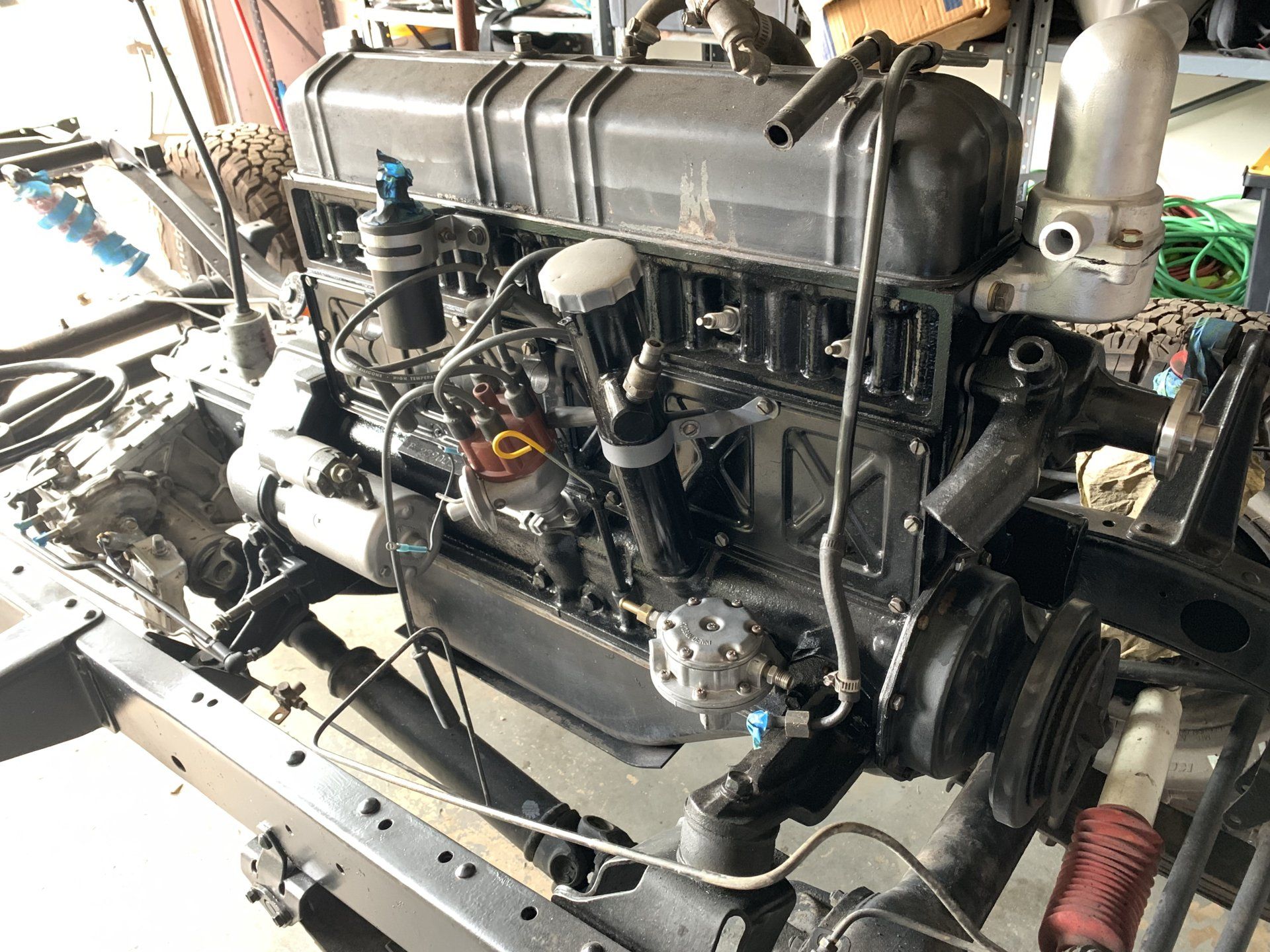

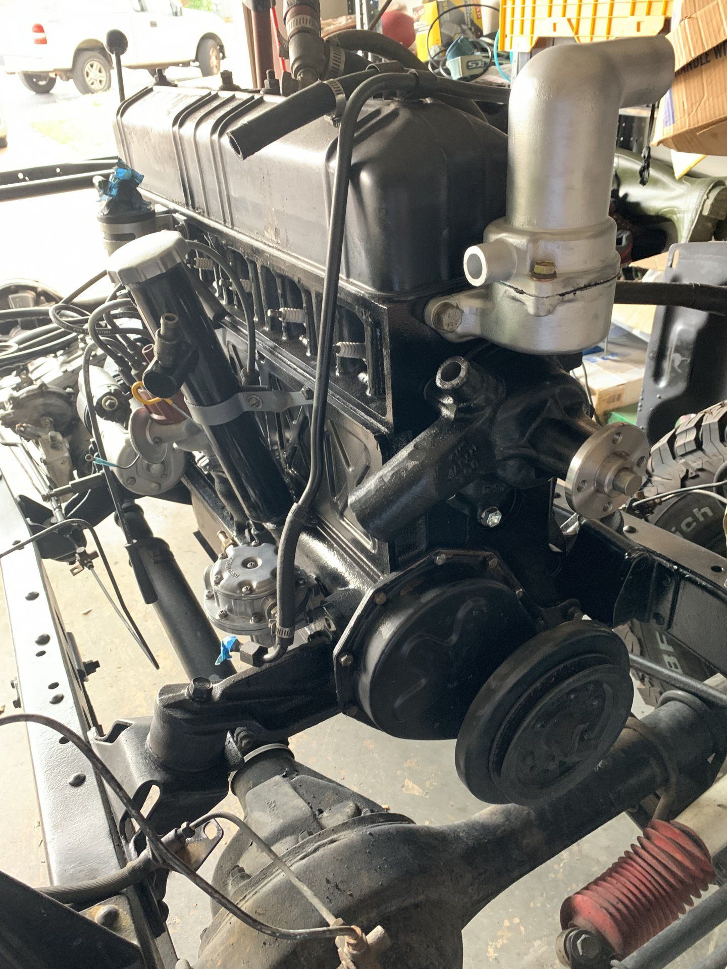

Got the front of engine disassembled and painted:
Found a new issue. The water pump I ordered is way different than my current. With the ‘pin’ part sticking out as it does, there’s no way for my old fan to fit. Any suggestions? Old 1f on left and new on right.
Move the flange out. It will move. Nice build!
FWIW, POR15 alone has exactly zero UV protection. Its nice and shiny now but will dull quickly if exposed to the world.
If you desire the shine to remain, consider a topcoat enamel from POR.
frame looks great,
