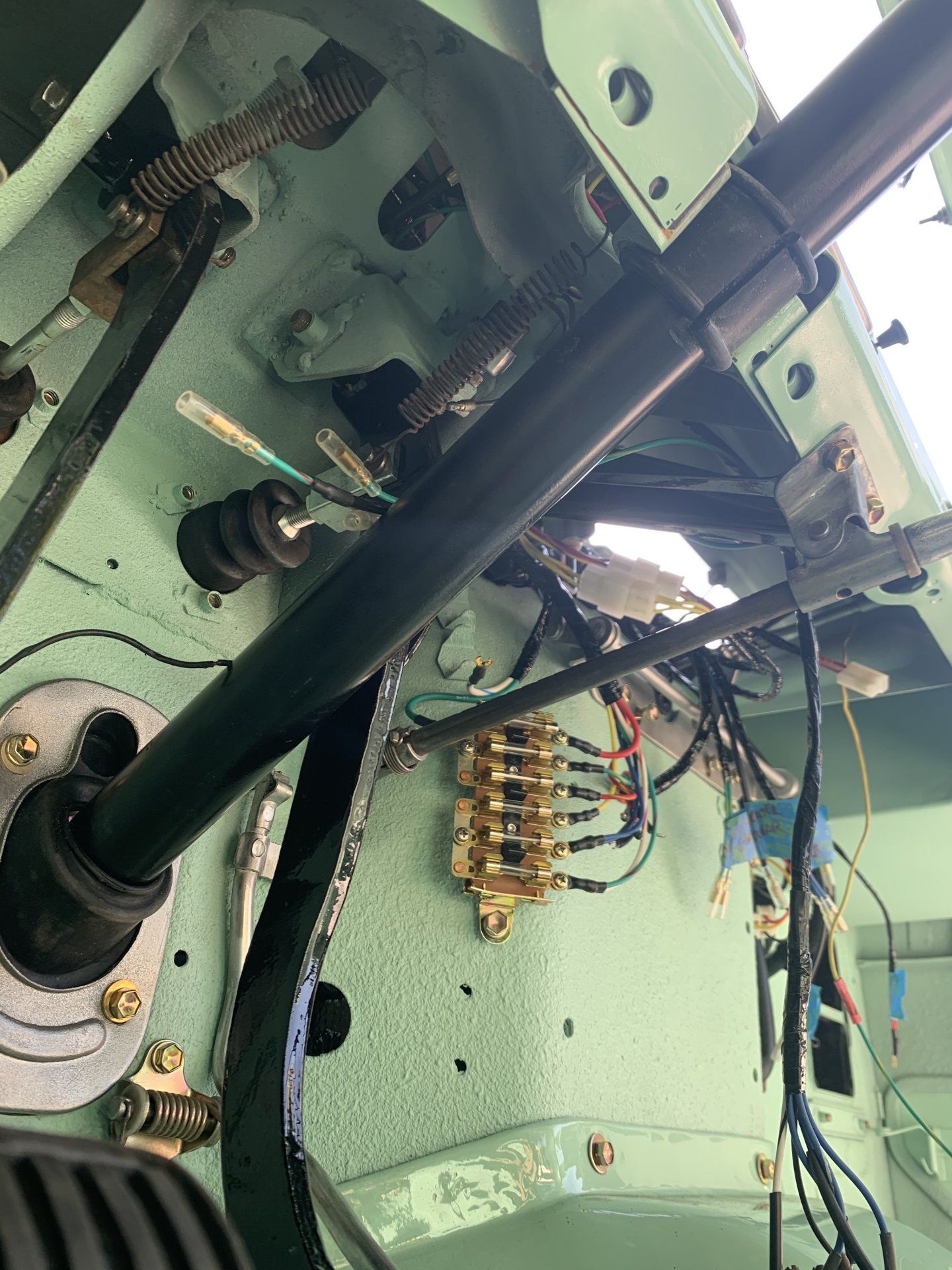

Started installing the main wiring harness. @Coolerman created a beautiful reproduction wiring harness for me. Special provisions are included for trailer harness and fog lamps. I'm missing the idiot's guide to reconnect this wire to that connector so it's been slow for me to decipher what goes where. I'll probably run it many different ways until I get it right. If anyone has recommendations, I'm taking them! Found this thread which helped get the light switch connected properly: 45 light switch wiring
Here's the main harness as it came out of the box from Mark:
I used a sleeve kit found on amazon and wrapped the harness 1 more time. Designers choice. I thought it would look cleaner.
Kit here: Amazon product ASIN B079SLRCQDresult here:

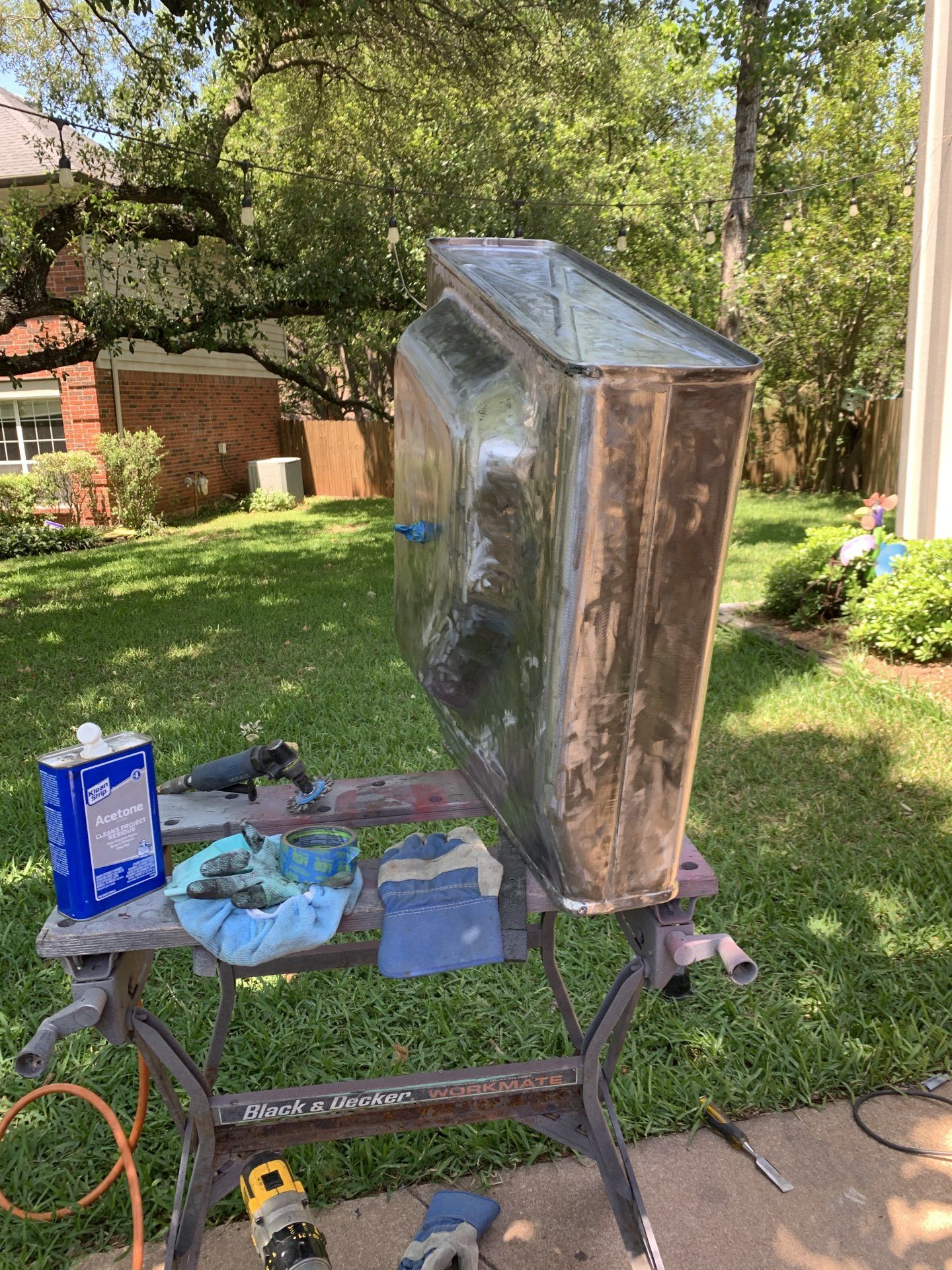

With wire wheel in hand, rehabilitation commenced on glovebox and fuel tank. This glovebox came from @Krondor I try to give credit where I remember to those that have helped me. Here are a few before and after:
After
I chose to paint the tank the 'pewter' color. With limited lighting inside these old trucks, black can make the interior dark. I'm under the assumption that lighter colors will keep the feeling brighter inside - one of many attempts at zen I'll continue to pursue in my life.

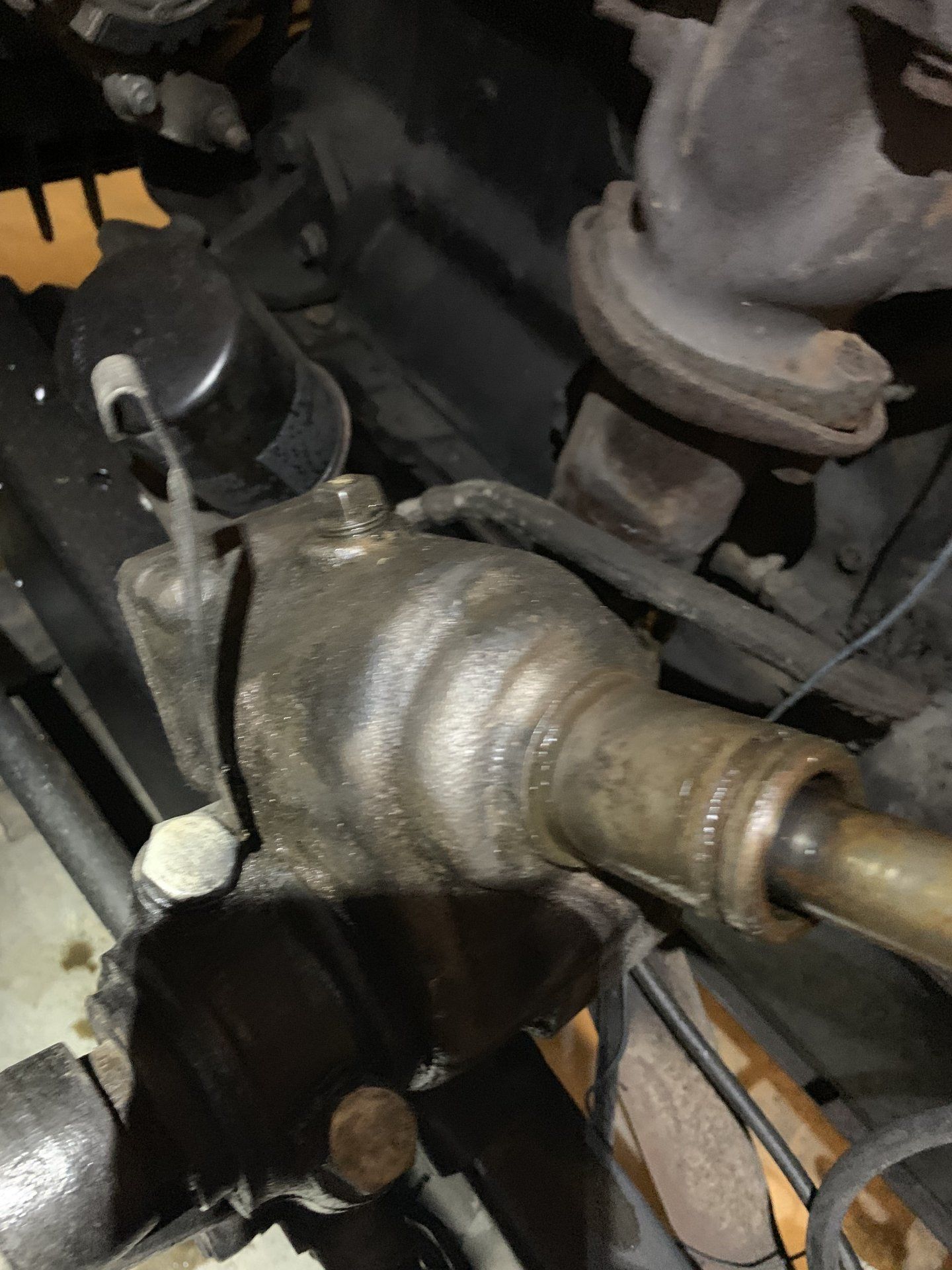

Ever have a list of things you never intended to do? I do. A lot of my list comes from this project.
I never planned to remove the steering box. It was fine, had a little play but importantly- didn’t leak.
Well, here are sights of the box before I removed it.
And now today after cleaning it up and repainting.
After removing it, I planned to rebuild it. I took it apart, cleaned it up and then made my own gaskets. Hope it still doesn’t leak. Will get some gear oil and find out soon enough.
Going to classify this activity from the ‘never intended’ file to ‘guess while I’m here’. (They’re really not too far apart)

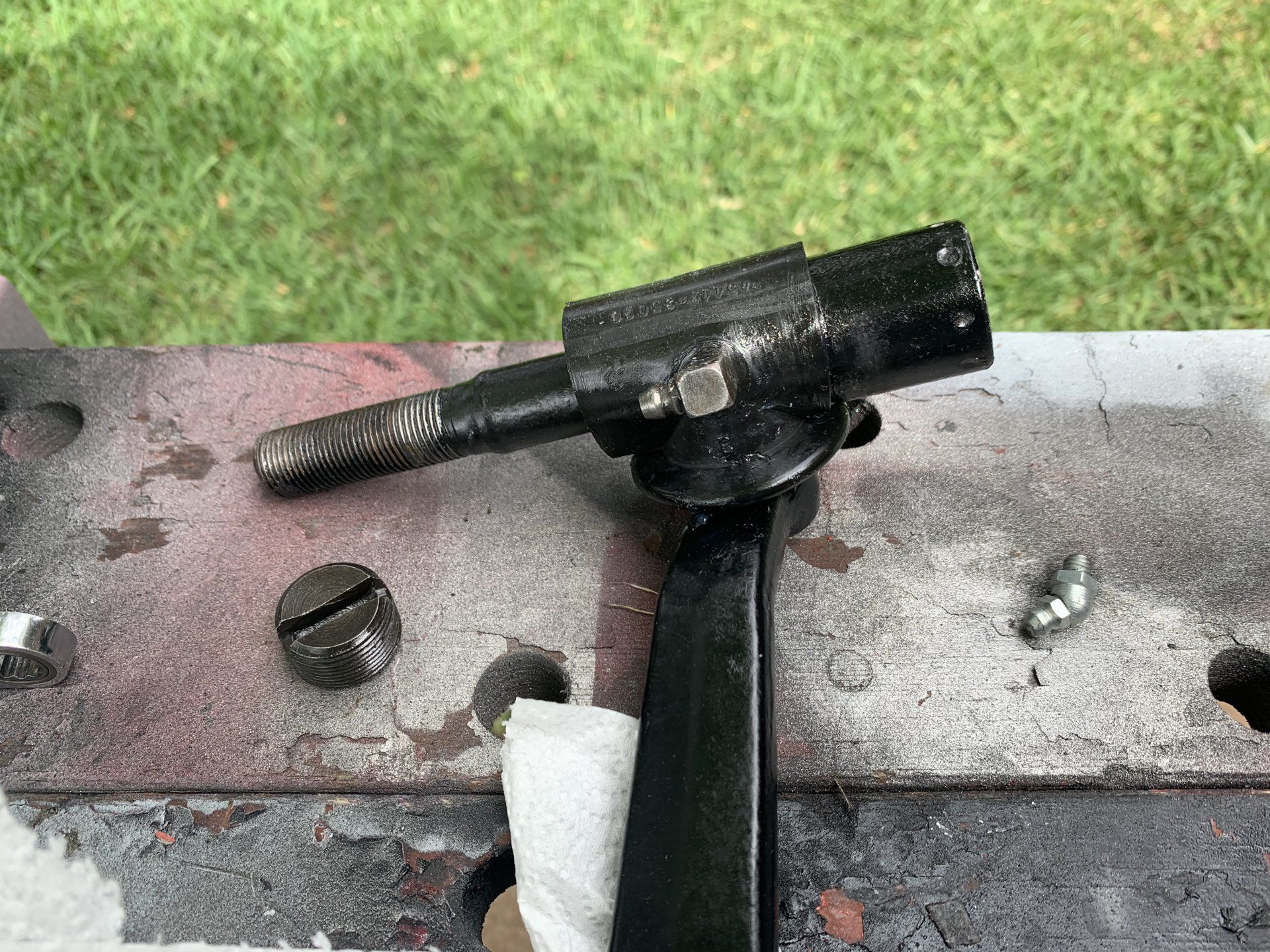

I had a drag link rebuild kit from SOR:
I Figure while it’s apart, may as well...
Here you can see the pieces that are included with the kit.
I chose to reuse the old end screw because it was flat and more screwdriver friendly. I was also forced to reuse the old zerk fitting as the new one from kit wouldn’t thread in with the new dust boot installed.
Think I was lucky because the screw was quite easy to remove. Here’s a shot of looking into it with screw and spring removed
I had to tap out the cups.
After putting the new parts back in, I made sure to put anti-seize on the threads to make certain if I have to redo this, the screw should back out with managable effort.
Final assembly after regreasing:
Should note that the new dust cover is more substantial and Encompasses the end link more than just the pitman arm ball

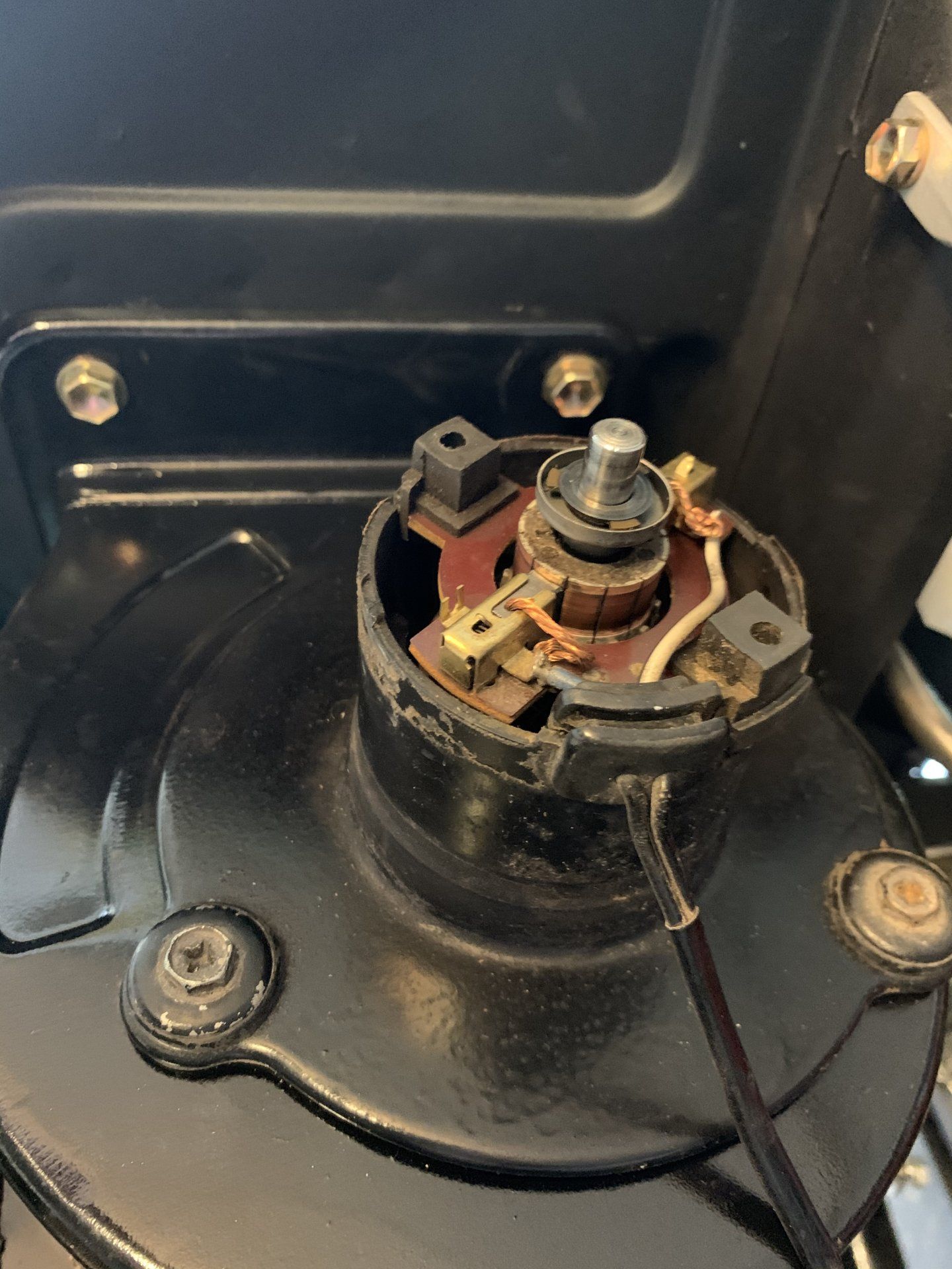

Can of worms - I’ve opened many on this project and today was a special one when it came to refurbishing the blower box.
With most parts getting spruced up and repainted or replaced, having an ugly blower box was not in the cards.
A good idea all started when I found a ‘blower box restore kit on SOR website. Spoiler alert- don’t waste your money. The $26 kit is mostly useless
Photo evidence:
Considering I’m learning as I go, and disassembling the box for proper paint brought on a new surprise to me. Specifically when I opened up the top where I expected to find an electric motor. I did.. completely raw And removal of the ‘cap’ came with a fair amount of electric motor bits springing out and all over the floor.
I guess I was expecting a fully encased / replaceable motor. Turns out the heater box is the actual encasement for the motor.
After finding what I hope was all the pieces, I set out to wire wheel and paint the box.
Here it sits, most worms back in the can
If you learned anything from this post, avoid SOR Heater Blower Restore Kit. It’s foam tape and 3 screws. Literally. Go buy $20 of beer and a powerball lotto ticket and have more fun with $26

I'm still a bit lost on what goes where for the wiring. There are a few extra connectors that I'm uncertain where they terminate. Most of my issue is lack of a good guide to tell me what belongs. The old wiring was from an aftermarket harness so notes taken at disassembly are completely useless. You can see the wires in shot above, but I'll call out what they are and maybe someone can chime in:
Editing here to share answers:
Connector with Red/White and Red/Yellow = fog light
Stray Red/Green wire with female bullet connector = Vader light if present, if not - this will plug into the black wire below for dome light
Stray black wire with male bullet connector (this one is near the wiper switch bundle) = dome light (other end comes out top of windshield in the wiper bundle)
Stray White/black wire with ring terminal = ground
