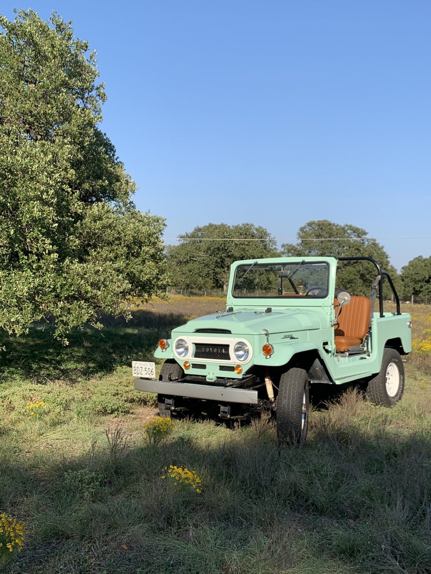

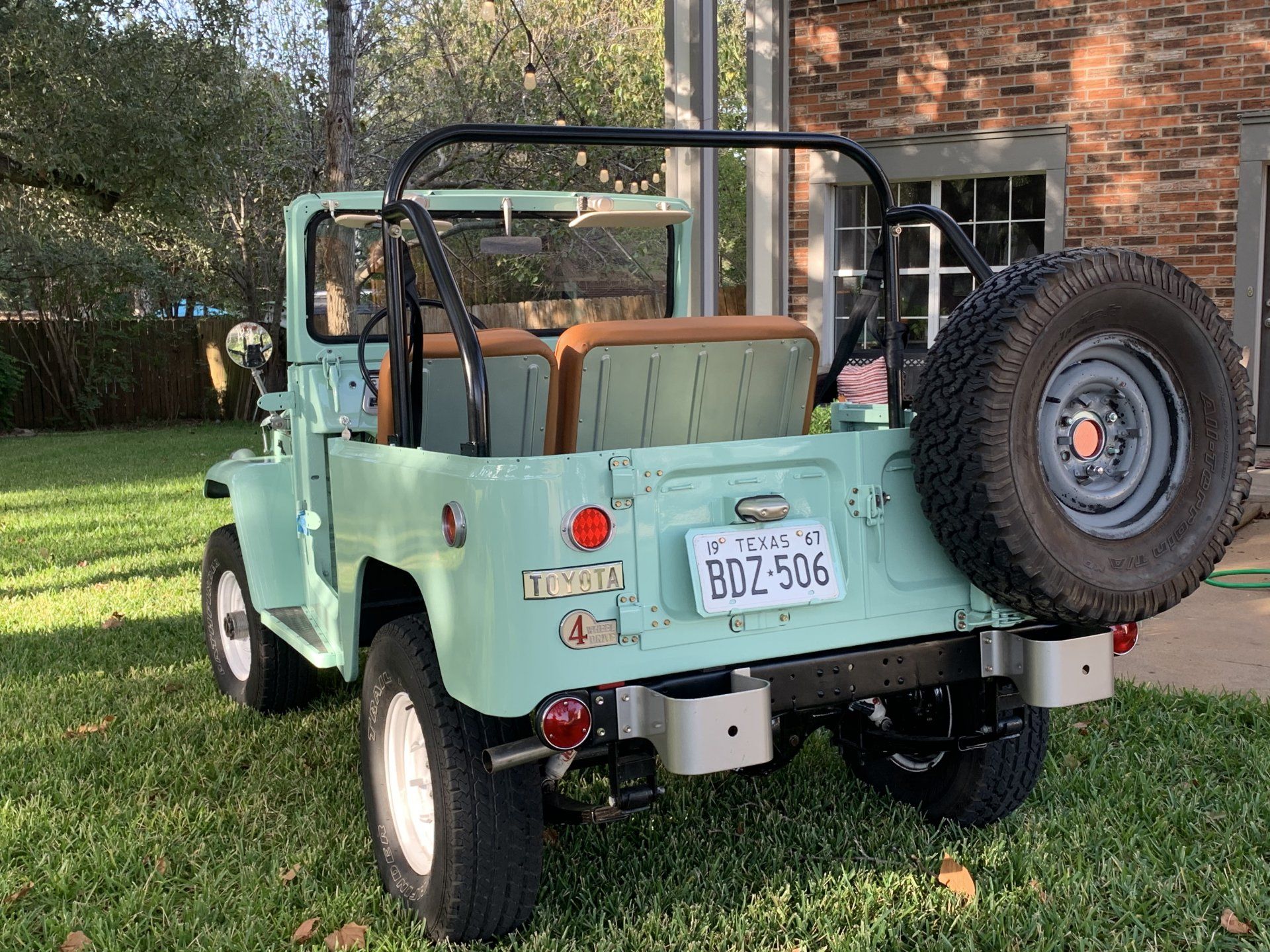

Looks Fantastic!
What size tires did you end up running?
Does Texas have the License Plate year of manufacture rule? Florida has that also.
and last note, Your hood windshield bumpers are backwards, short end goes towards windshield.
You, and Ferris Bueler are my heros.
Thanks!
Tires are BF Goodrich KO2 31x10.5 r15.
Texas used to swap plates every year until 1974. Can find year issued plates on eBay and run them with a registration sticker. Pretty slick.
Thanks for the hint on windshield blocks. Following online photos, You see them going every which direction. I’ll swap them. At least the bezel is correct?!?!
Cheers!

Damn near luxury car ride with new shocks and a bikini top.
