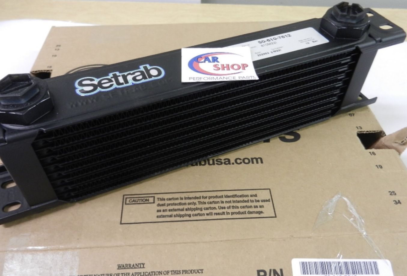

Next will be a cooler. I’m looking at the Setrab coolers, they are quality parts I’ve used on past projects.

Cooler? What cooler?
