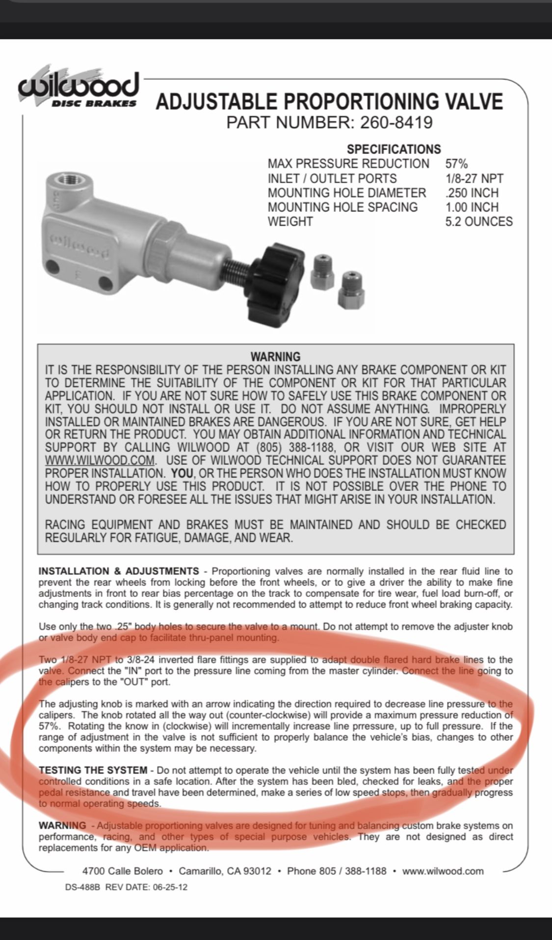

People need to hire better technical writers because I interpreted that differently than you did, but that doesn't make me right and you wrong.
What I read was that the lowest you could go is 43% less line pressure with the knob all the way out counterclockwise and by turning the knob incrementally clockwise the line pressure will increase all the way up to 100%.
So, I would assume (probably horribly) that no valve present is a balanced 50/50 braking pressure. If the knob is all the way out, does that take 57% of the pressure off the rear calipers and then all the way in restores the set back to 50/50?

so the way the I read that is with the valve out (counter clockwise) position the balance will be aprox 75/25 front to rear. the valve will be reducing the pressure to the rear by 53% on a 50/50 split. at full (clockwise) in it will go to 50/50 front to rear similar to as if the valve wasn't in place.

The proportioning valve has no reference to the front brake pressure, so all it is doing is reducing the rear brake circuit pressure. It can be adjusted for no pressure reduction, down to a 57% pressure reduction. IOW, if the rear brake circuit is making 1000 psi (to keep the math easy), that proportioning valve can vary the pressure from 430 psi to 1000 psi.

After installing mine, I’m still confused. I guess a call into Wilwood tech on Monday is in order !
I *think* that this is correct, but when we're talking about braking systems, you don't really want to operate on what you think
It's not rocket surgery, a valve can't increase pressure, all it can do is let it flow 100%, creating a 50/50 bias, or you can let it restrict the rear by turning the valve down (CW), which limits the pressure going to the rear.
