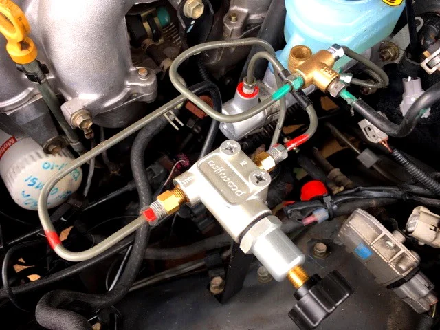

Write-up: Toss the LSPV and install a manual proportioning valve
Been a couple of months now since I ditched my LSPV (and ABS). BEST thing I ever did for my brakes.
I installed a proportioning valve (under hood) and played with settings a bit, but since I always have 500 lbs of stuff in the rear, it was easy to find a setting that works well for me.
Brakes are excellent now.
IF/when reusing the OEM lines, the ends that went into the 'Tee' below the Master Cylinder all have a slight 'lead' built into them. So if you place that end into a shallow fitting....there won't be much thread engagement and a leak might occur.
It's an easy thing to overlook.
Good tip! Wish I saw this earlier. Mine looks a little shallow threaded into the MC and this would explain why. Guess I'll leave it for now since it's not leaking.

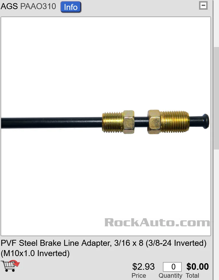

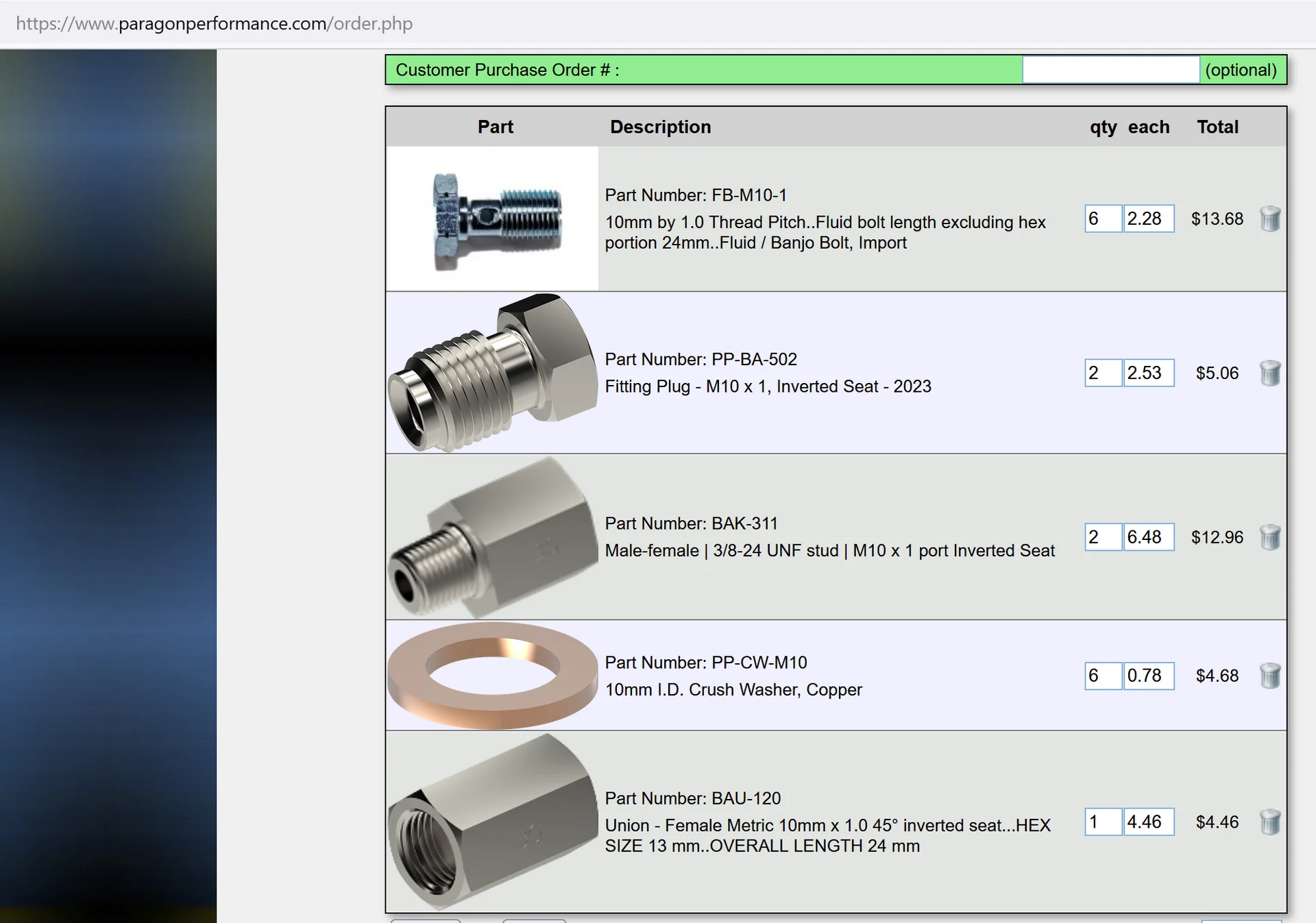

rock auto also sells a 8" hard line with 3/8-24 on one side and M10x1 on the other. Could be useful for anyone putting the proportioning valve up by the master cylinder.
thats a nice find there, saves the hassle of having to cut an end off and reflare or find different adapters

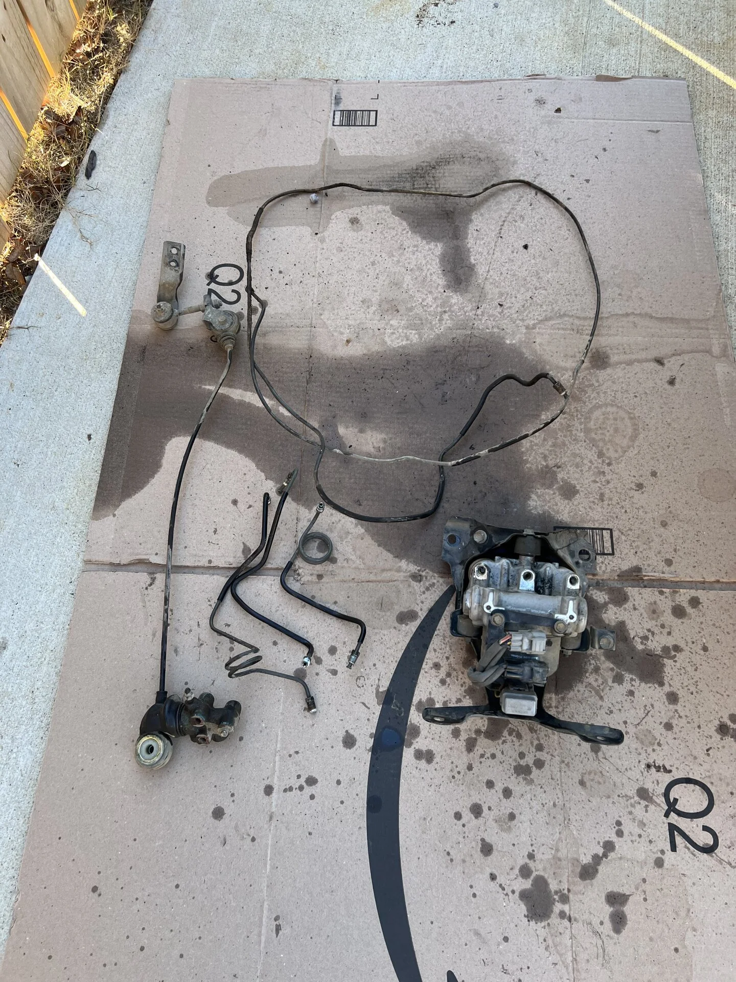

The brake booster on my 94 just went out on me. Many years ago, I removed the abs fuse and took the bulb out of the dash after I could not get the brain to bleed thoroughly. Been driving it without issue ever since. Additionally, I’ve removed all the ABS sensors and wires along the axles/frame. Figured now would be a good time to do the full ABS/LSPV delete while I’m in there. I’ll also be replacing some brake lines as well.
I’ll report back with results and initial thoughts after the first test drive. Looking forward to the extra room under the hood and hoping to have better braking as well. What’d everyone do with their old parts?

All of mine went into the garbage. ABS unit, lspv, the whole lot of it. Not going back and I'm not selling this rolling death trap

all of mine went to a local 80 owner, because he is under the disillusion that he'll replace these brake parts as they age and fail. :rofl:
I havent looked at mine in a while, though I removed the abs pump, I think I put in a T from another cruiser to the MC...how did you plumb your two hardlines from the front brakes to the single output for the front on the MC?

I boxed mine up in the hope that someday they will be worth $5k and I can go on a bender.......

I’ve been doing that for decades, maybe I have a $500 jewel hiding out there now😜? My old brake parts were lucky to make the recycling bin.
