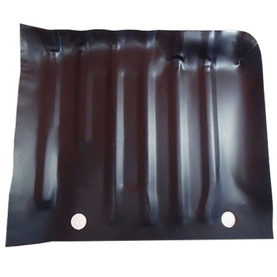

What's next on the Price is Right - oh yeah. A tiny matter of a rusty driver's side floor pan - as in bad. You can't exactly throw a cat through the holes, but you could push one through with a stick. (Sorry cat lovers.)
I found a real old time body shop - one that actually works on sheet metal, not just swaps panels for the insurance company. Gonna go down there next week for a Spa Day.
I got a replacement floor panel from Cruiser Utes and Parts in Australia - great customer service, fast shipping (got here in a week) and the panel is high quality. Heavy, very stiff steel. Fits very well. They have a ton of stuff for our trucks, highly recommended. Cruiser Utes & Parts: Your Online Landcruiser Parts Specialist - https://www.cruiserutesandparts.com.au/
Same place I got my replacement pans from. Very good quality and I'm very happy with mine
Crazy - but then shipping for 1 was about $150 so it makes sense by weight I guess. If you go through the order process you can enter a USA address and it automatically calculates shipping. It was either that or scrap sheet metal. Only took about a week to get here I think. Maybe 10 days max.
