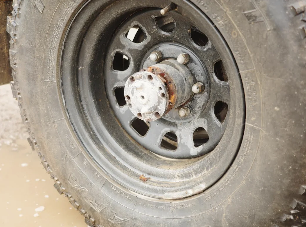

I had the pleasure of shearing all of my rear hub studs yesterday while out wheeling around. The axle slipped right out.
Reading thru some of the posts here I see that sometimes bad bearings are to blame, some are blaming a bent axle housing, and others are just chocking it up to under engineered hub hardware. For me, I'm not really sure what's to blame yet. Hoping they just broke from hard driving.
I had the hub bearings/seals replaced less than 1000 miles ago. Both seals had blown out on me during a longish drive. It was the first real trip I had taken since importing the Troopy so I didn't really think much of it. However now that I've had the studs shear on me I'm starting to wonder if I have a deeper issue. Assuming the bearings were installed correctly it really just leaves bent hardware or under engineered hub assembly.
In any case, I really want to just drill out the studs and replace them with the hub still installed. Has anyone attempted this? I know it's probably a job for a bridgeport or similar. Just wondering if it's even possible to do while installed.

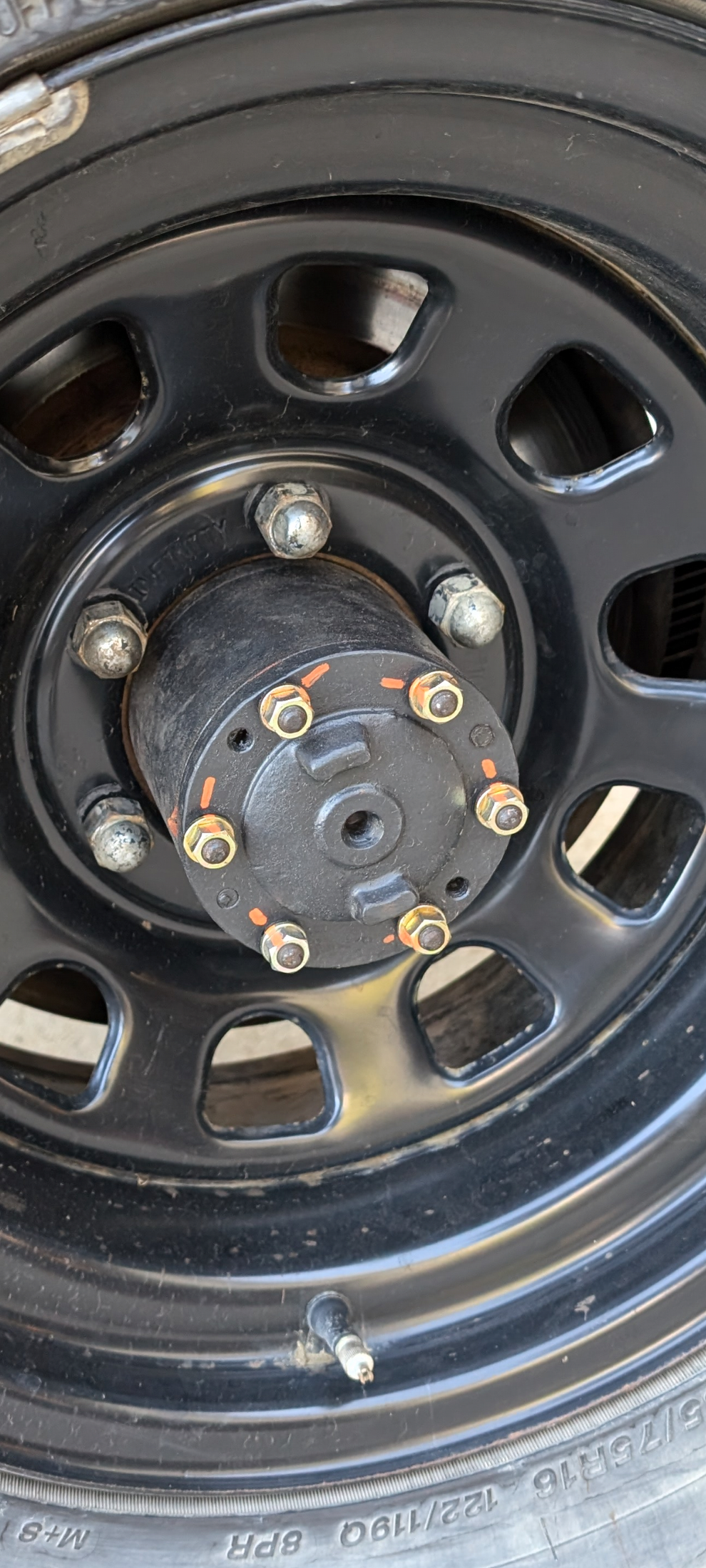

Only before picture i have. With any luck, maybe I just needed to retorque the nut after a few hundred miles of breaking in the new gasket...
There is a fault somewhere, bad bearings, hub, torque, low quality hardware, bent axel etc etc. The factory setup is stronger than the axel itself, I've broken many. Changing to larger hardware just masks the problem.

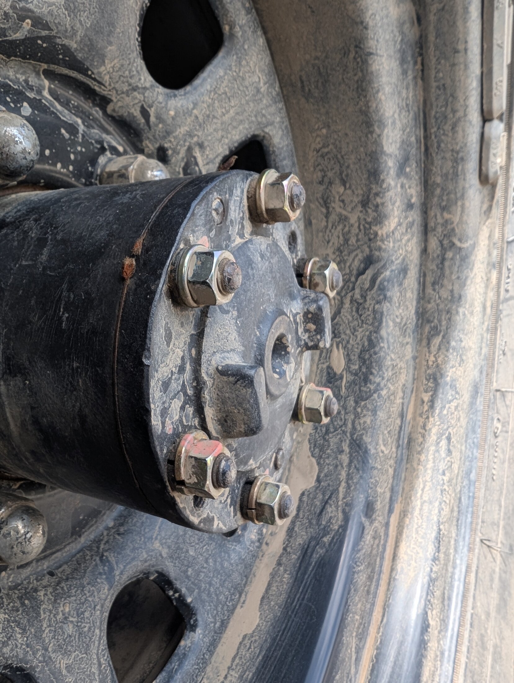

Your average idiot-with-a-hammer mechanic likes to hit the edge of the hub/flange when they don't know how to remove the cone washers on the studs. I can see yours are slightly flattened at the edges. It doesn't look bad, but it might be worth looking if the tapered holes are deformed.

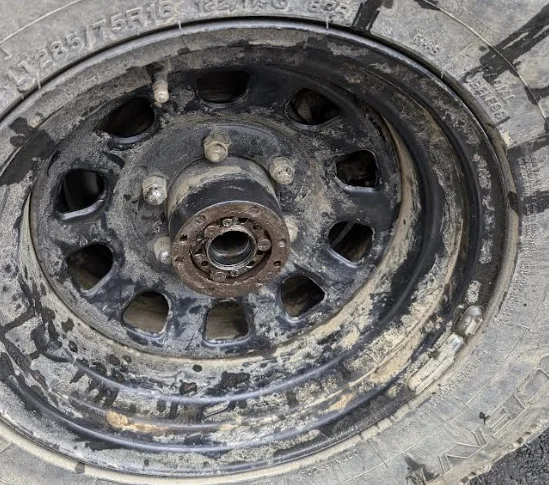

Also, why if they were so recently serviced were they so rusty inside? Did your last mechanic grease the bearings? I think I can see an oil seal in the spindle, in which case they will not run on gear oil.
Another thing - it looks like someone has electroplated the cone washers for some reason, and not fitted the plain washers on top of them (as far aas I can tell from your pictures). The plating may interfere with the fitting of the cone washer to the tapered hole.
In short, although they made it look nice, someone who does not know how to work on these vehicles has had a go at your rear hubs (not necessarily the last guy that worked on it, but the rust raises questions about his work).

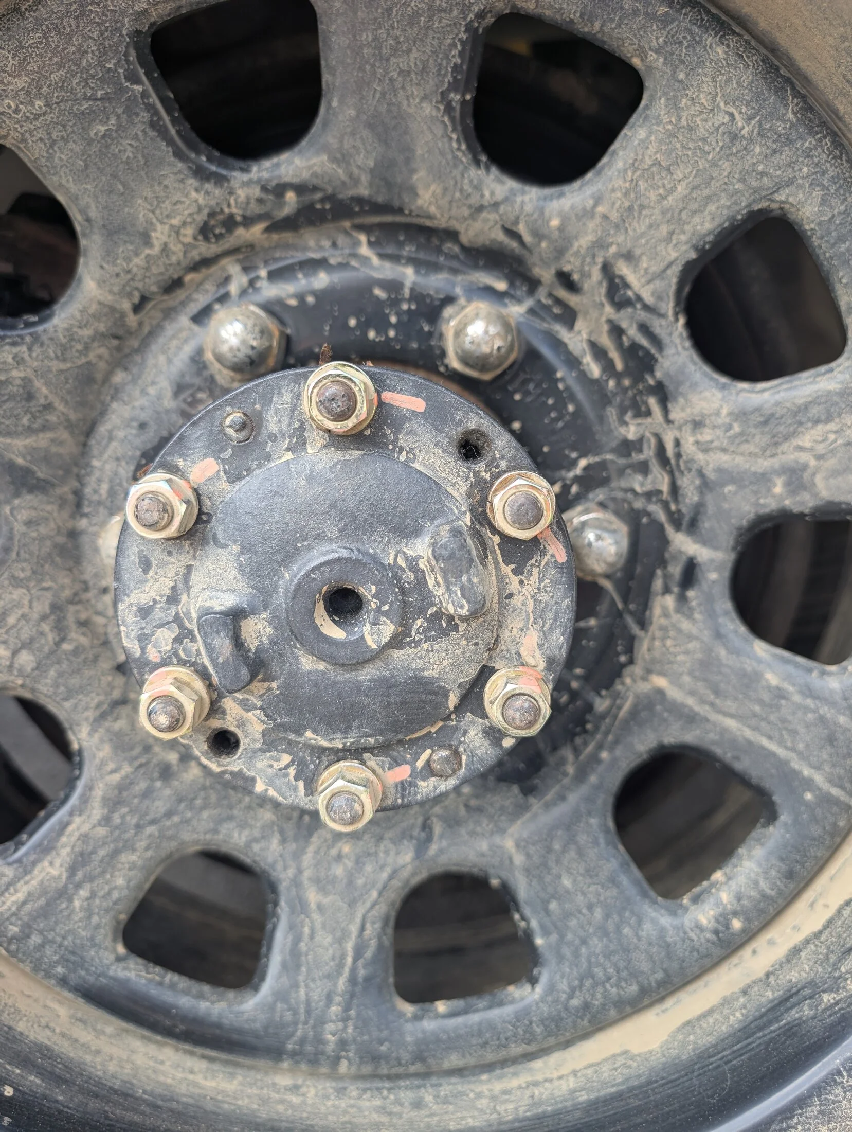

for what it's worth, here's my surviving hub. Might just replace it too for good measure. At least I'll know it's my fault next time it breaks.
Sorry, now that I see those pictures I was wrong about the cone washers and missing plain washers, so please ignore my remarks on that. Any damage on the hub or axle shaft sealing surfaces could be from years ago and nothing to do with the last guy to work on it.

I would take the hub off and check the bearings, and also look at the sealing surfaces of hub and flange.

Was the dowel pin inserted in the hub? Looks like they both came off with the axle shaft?
How the "surviving side" looks? Are the nuts tighten?

The surviving side - the nuts we're all below torque. The hardware also fits a lot different than on the newly installed side. The conical washers on the surviving side don't nest as deep.

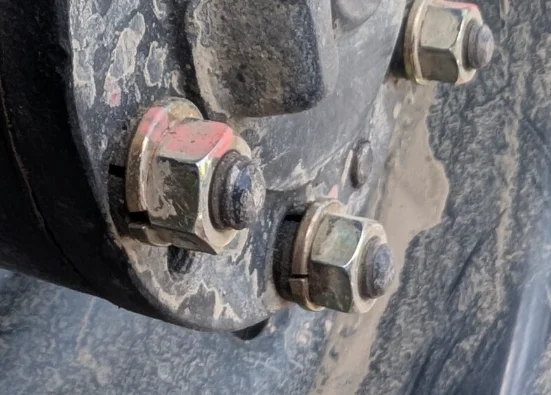

IMO get rid of those spring washers, they are nothing but baaaad, use good flat washers and correct joint torque. You can also see in the below image one of them has failed and starting to spit out.
I'm with you 100%. After i picked up the new hub kit I also noticed that the conical washers installed in the image above are too large. They don't seat all the way down to the shearing plane of the bolt. So I think the gap is causing the bolt to be loaded in shear and a little bit of bending which isn't helping the case at all.
