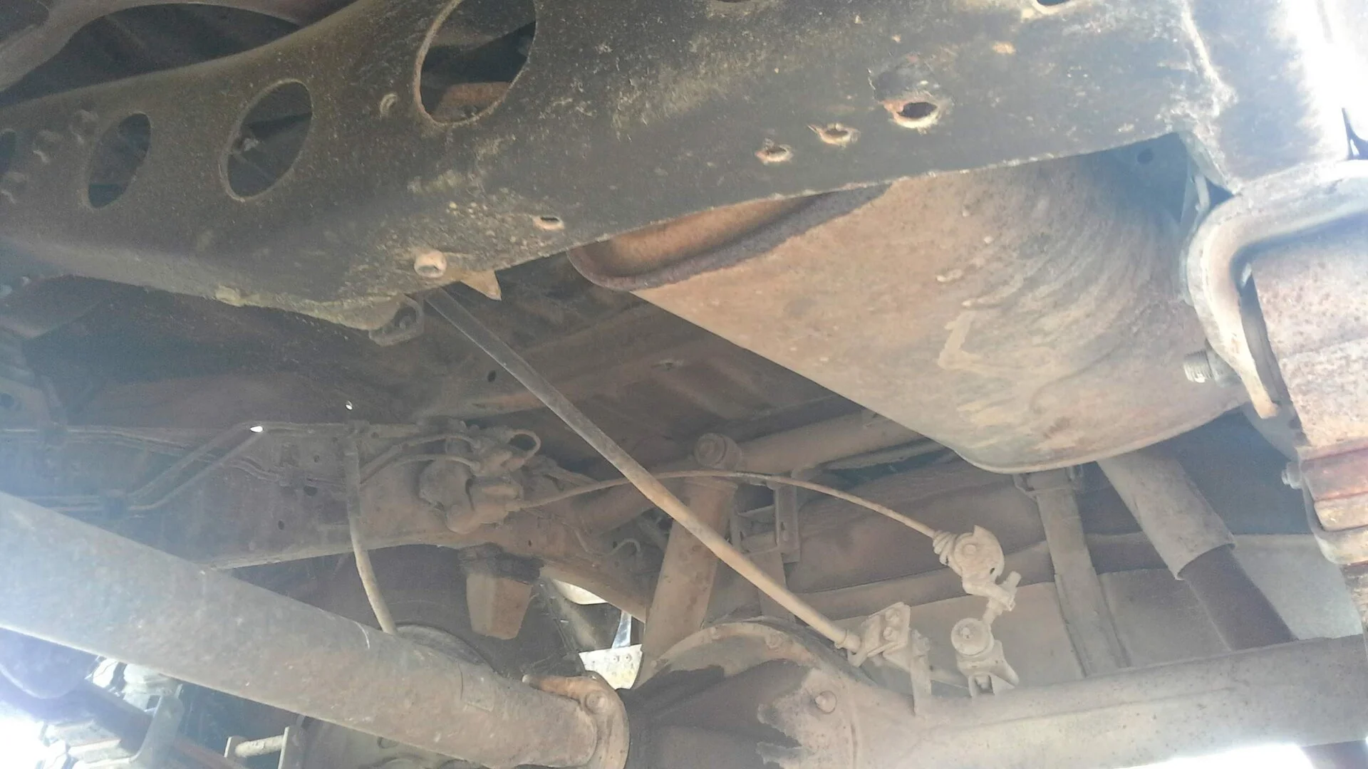

He starts to undo the binders then stops and hold his hand up - the universal sign for STOP. He points at the rear axle. Then he takes his phone out and Temujin says something into it which I took to be "Conan - what is best in life??" but translates out in Cyrillic letters as "NO BRAKES". He points again at the rear axle then makes the right foot stomping signal - the universal sign for no brakes. Then I notice that the rear axle hard brake line is bent at a 90 degree angle - probably not the way it was designed. Then he points at the ground and sure enough, there are drops of brake fluid. He then continues to point in a dot dot dot manner, back in the direction of Texas, signifying that there was a trail of brake fluid all across the fruited plain. OK - be calm - don't cry.
I looked at him - saw the Russian letters - and I said "You from Kyrgizstan?" and he stopped like he had a stroke, his eyes got wide and he grabbed both my shoulders and said "KYRGIZSTAN!" and gave me a shake which I guess means I have a standing invitation for tea if I get over that way.
No brakes. I can't drive it home like this. So I just parked it - luckily the E-brake worked great. I was only about 500 yards from the garage where we usually get all our major car work done. So I got up early the next morning about 4, nervous as a cat, and drove it without brakes over to the garage and parked it and left them a note.
So, long story short, new rear hard line was made (OEM one is en route from Megazip now, couldn't get it locally). Also it needed all front brakes, calipers, the works. I had all the parts and dropped them off which surprised them, all those candy cane boxes falling out of the sky like that.

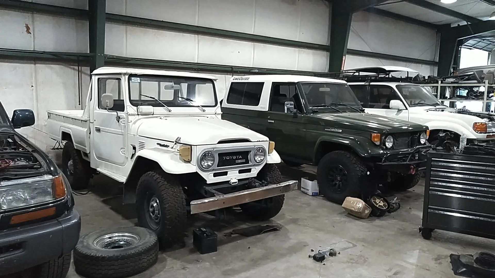

I also wanted stock steel OEM wheels. As luck would have it, Cole at OTM Cruisers (just east of Birmingham) had a set of new wheels on site, and said he'd love to slap in a rear pinion seal while I waited. So I took the opportunity to make a day trip down there.
I can't say enough good things about Over The Mountain Cruisers. I pulled in and in about 30 seconds Cole and Joseph tore into my truck like a hen on a june bug.

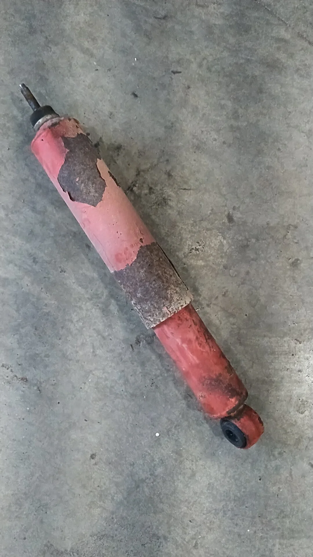

I had new OME shocks from Cruiser Outfitters and they had those in in about 20 minutes, then for good measure put in new rear U joints.

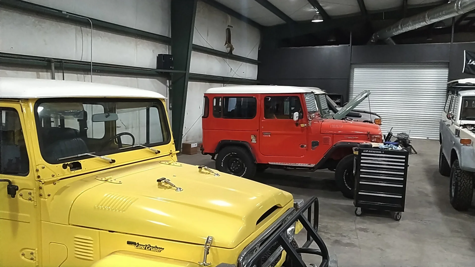

OTM is a great resource for Cruisers here - ACC in Atlanta is a well known standby but there's nothing else in a reasonable driving radius around here. I think they had 3 of every kind of Cruiser here in various states of total restoration or basic repair.
And this is just what was inside - there were lots more outside including a really sweet 73 that Joe Katana brought in from the Netherlands.

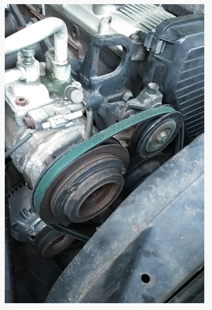

That lasted about 45 minutes - I heard a chirping sound, then the temp slowly started increasing. Deciding it was nice while it lasted, I turned it off and drove home with the windows open.

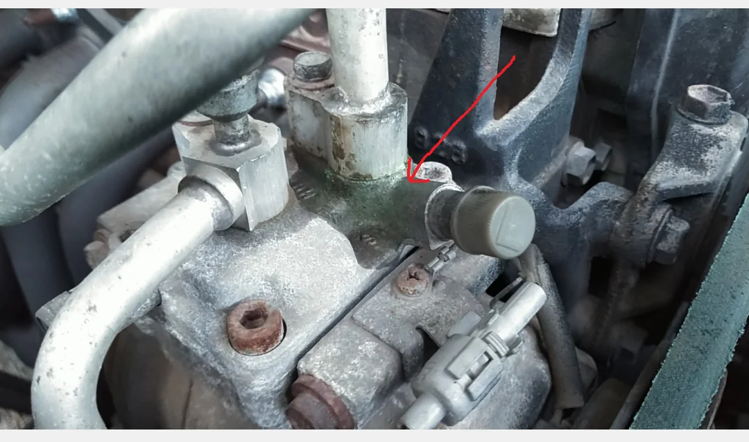

When I got home I raised the hood. The belt was loose - obviously the tensioner couldn't hold. So I have all that and a new pulley ordered.
Also there is a leak where there was none before - the green wet area. It was originally completely dry there.
Apparently there are O rings under that top cover - change those out, recharge the system, and it should work great.

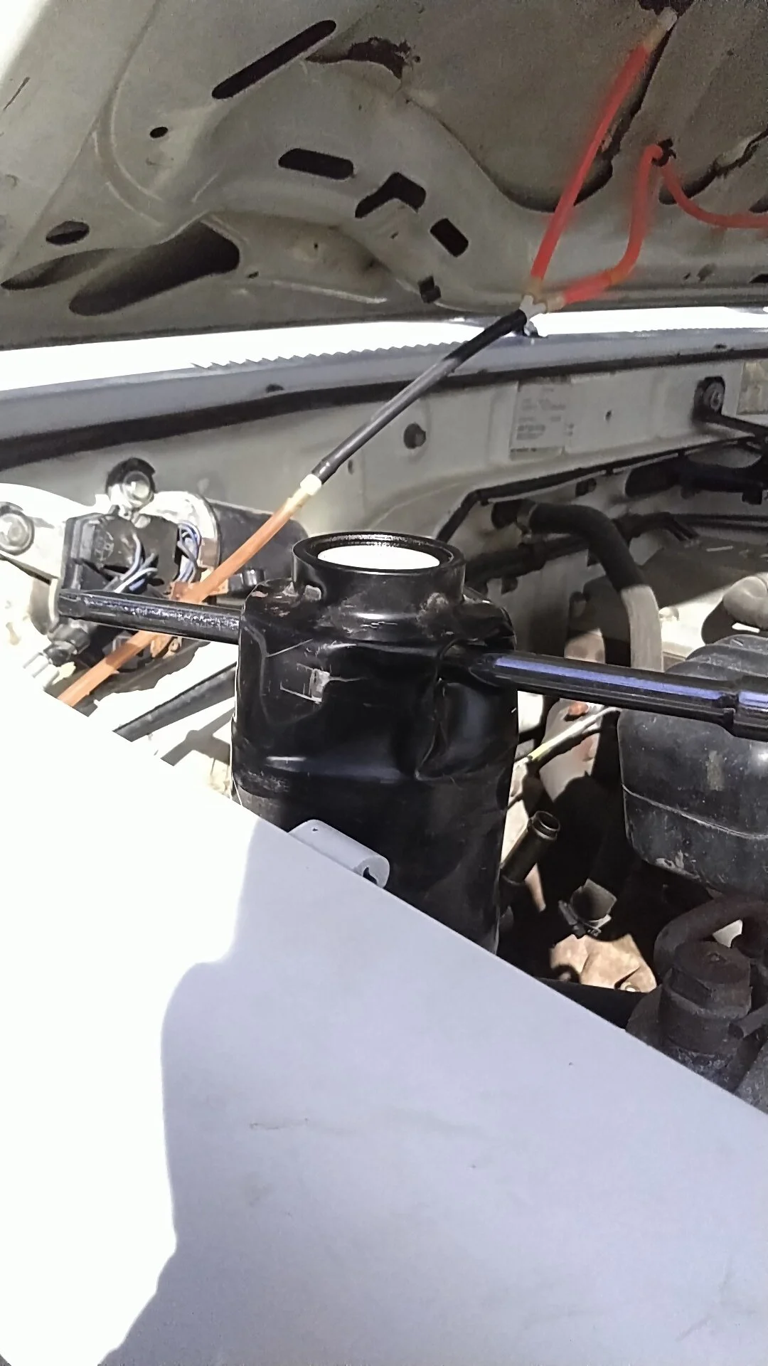

I also ordered another Collector/Accumulator.
But at least one of my bigger worries - no AC - seems to be partially addressed. It can work - we can rebuild it.

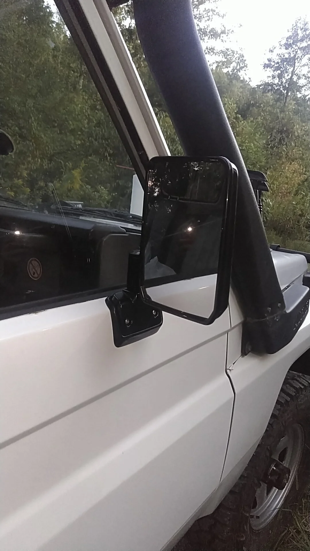

Also new mirrors both sides. Hard to overstate the difference this makes.

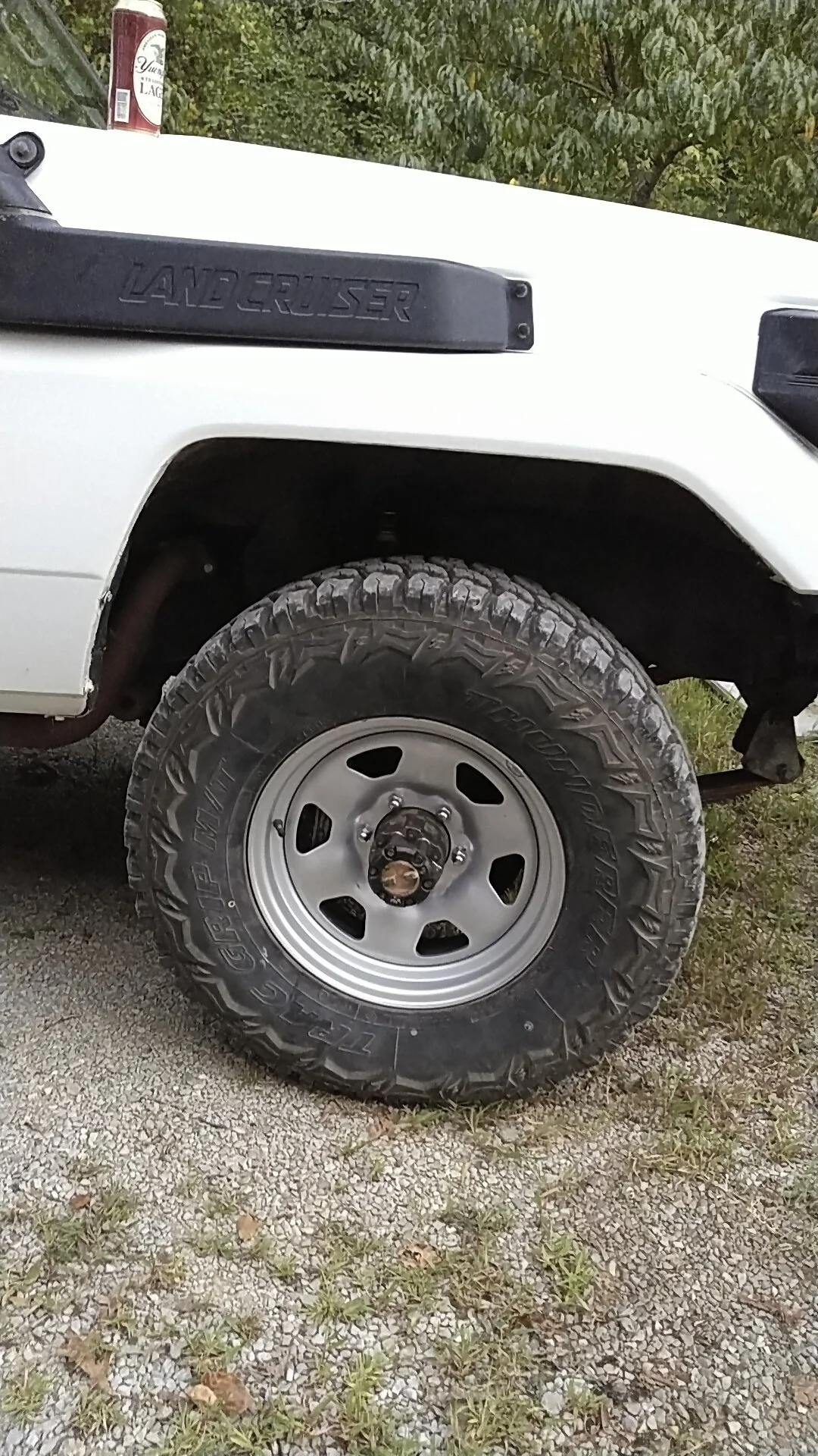

Glad I went ahead and did the wheels! Otherwise would never have discovered the broken and corroded studs, or the spacers on the front and not on the rear. No wonder there was a shimmy, 90% gone after the new stabilizer, now 100% gone as near as I can tell.
Ok ready for the meet and great I think. New wheels and studs. No spacers. Now zero shimmy at any speed. Took a joy ride just for fun.
These phones cameras are so distorting. Look how tiny that rear wheel looks. I guess it's time to whip out the Nikon.

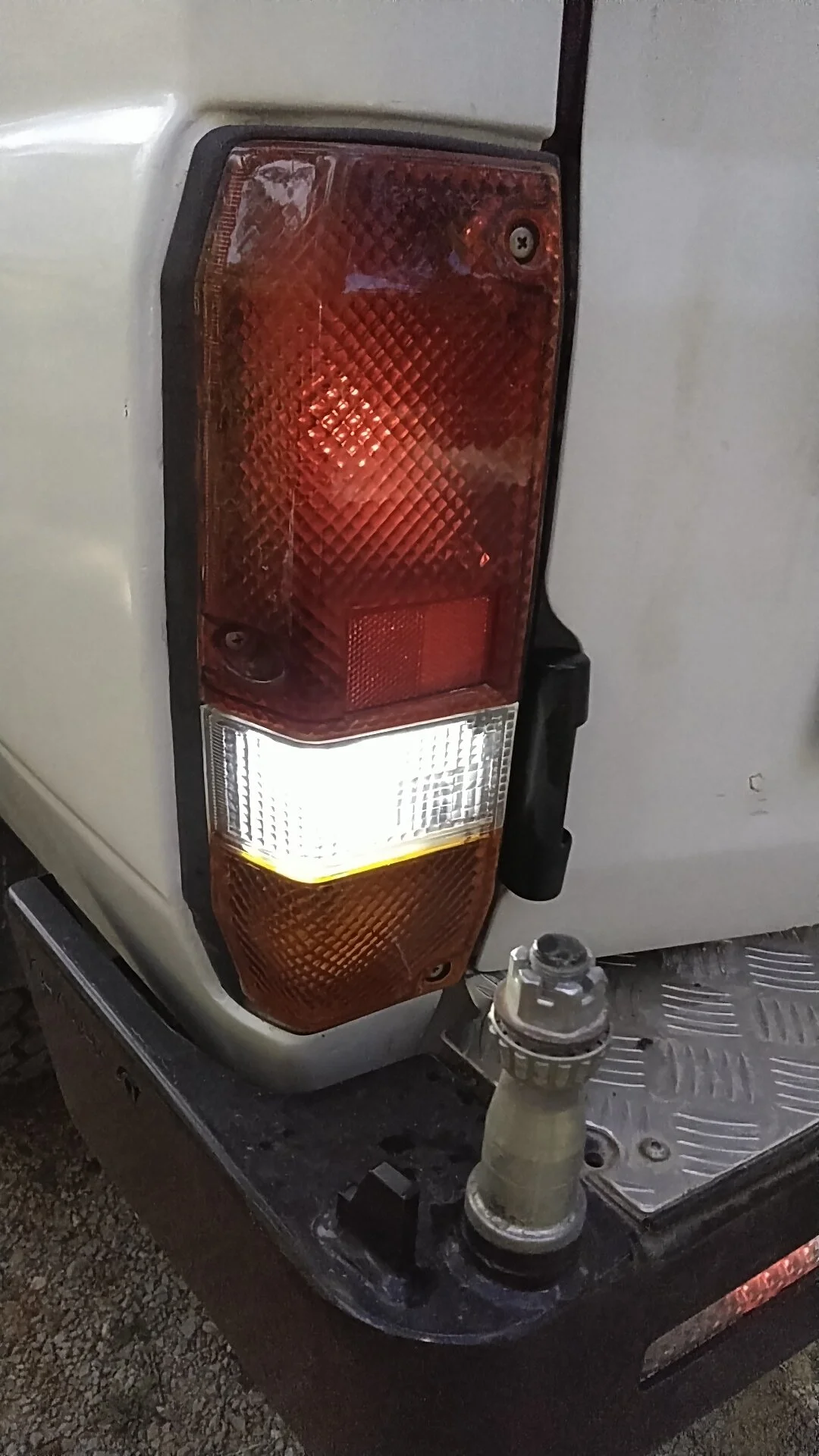

Got LED reverse lights and interior dome and cargo lights from Odd Iron - only to discover that my front dome light doesn't work at all - the fuse is fine, but I'll have to get my multi meter off the boat and see what's up. But the LED kit from Odd Iron fits perfectly. The rear cargo light itself is useless - old and crusty - so I ordered a new one.
Replaced the small bulb that lights up the heat/AC slider control area - disassembled the panel and popped in a new bulb replacing the little green cover on it. Sorry no pic.
The reverse lights are amazing - the night time photo was worthless but you can easily see the difference compared to the red tail light.

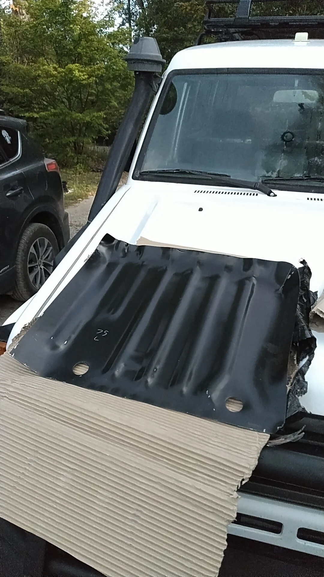

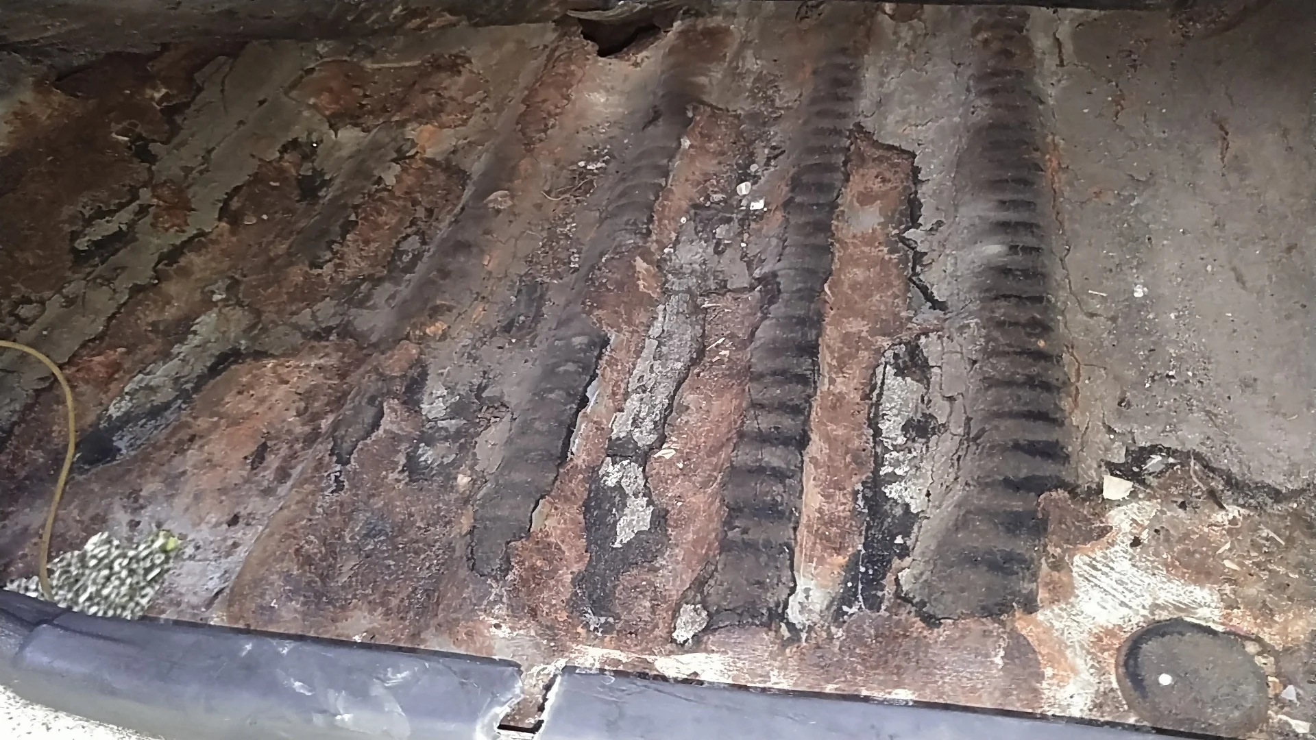

What's next on the Price is Right - oh yeah. A tiny matter of a rusty driver's side floor pan - as in bad. You can't exactly throw a cat through the holes, but you could push one through with a stick. (Sorry cat lovers.)
I found a real old time body shop - one that actually works on sheet metal, not just swaps panels for the insurance company. Gonna go down there next week for a Spa Day.
I got a replacement floor panel from Cruiser Utes and Parts in Australia - great customer service, fast shipping (got here in a week) and the panel is high quality. Heavy, very stiff steel. Fits very well. They have a ton of stuff for our trucks, highly recommended. Cruiser Utes & Parts: Your Online Landcruiser Parts Specialist - https://www.cruiserutesandparts.com.au/

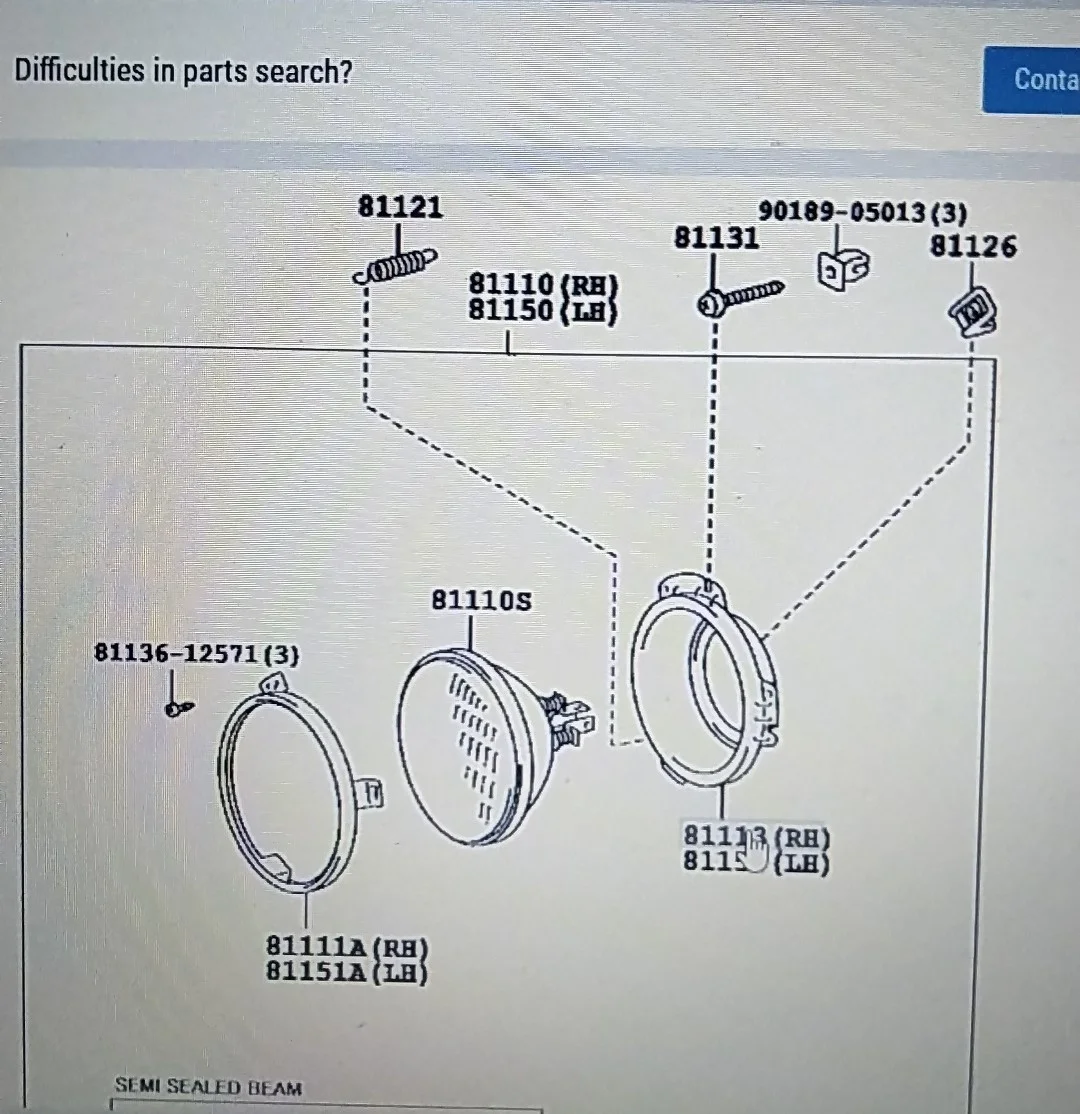

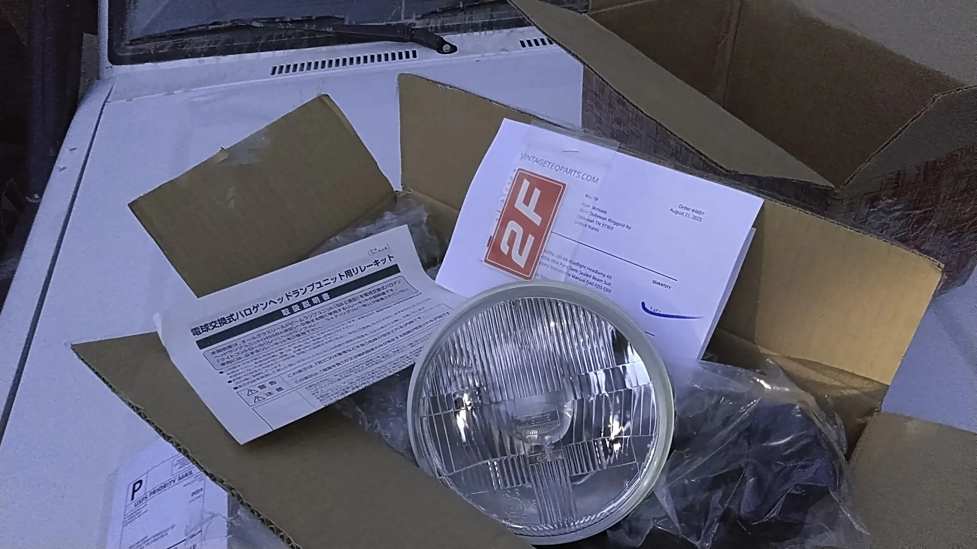

Teaser - got my delivery of my new Koito headlight kit from VintageTeq. SO NICE and shiny - heavy glass lights. (Thanks to @ToyotaMatt.) Went to put them in and discovered that now that I have headlights, I need EVERYTHING ELSE. Trim ring on the front, retainer ring on the back, screws, bolts, springs, this, that, the other thing...
But it'll be so worth it. If you're thinking of doing this, check out your current light set up and make sure it's not all barnacled together like mine was - I was able to order every single item from my local Toyota parts crone. Except for one item (of course). They had one rear retainer ring (that the bulb sits in) but the other was NLA, discontinued, etc. So I got it coming from Megazip.
I'll list all the part numbers when I get everything and do the install. The one they didn't have at Toyota was one of the ones marked with the hand cursor on it.
