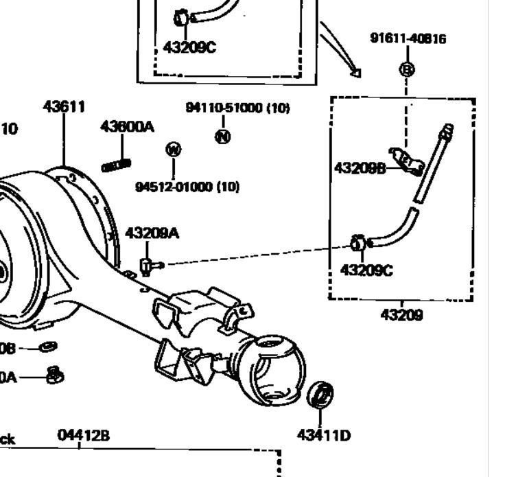

Did you happen to look at the vent hose on your front diff? With that much water I wonder if the hose is cracked or vent missing. If so would be a quick fix before your trip. That much water in there will do a number on the internals pretty quickly.
@Prairie Swamp, I hadn’t... didn’t even realize it has one. Can you point it out to me on a diagram?
full
Assembly 43209. Should be a hose attached to the right angle fitting on the left of the axle housing, then goes up to the left frame rail. There should be a little vent cap thingy at the top end of the hose.
Ah perfect. I have to figure the rear has the same? On the passenger side, I had my hand on what that looks like yesterday and it’s coated in dust/grim and potentially the black oil seal that was added at some point before me and the PO I bought from.
There’s thick gobs of rubbery feeling stuff near the fuel lines on the frame rail too. I touched them but didn’t dare pick incase it had to good a grip. All that s*** needs to get a good scrub and wire brush to really know what I’m looking at. Hoping to check it out when the weather is better.

Do check those breather hoses. Pull them off the axles and see if you can blow air through them. There is a little dust cap on the upper end by the frame. The caps get crudded over with dirt and grease and they clog up. Especially in the rear, a clogged breather can create problems. As you drive, the diff gets hot and the air inside has to expand out. With the breather clogged, the pressure has to release somehow. It will find a way. It will force gear oil out out of your axle seals and into your rear drum brakes. How does the old saying go? "An ounce of prevention..."
