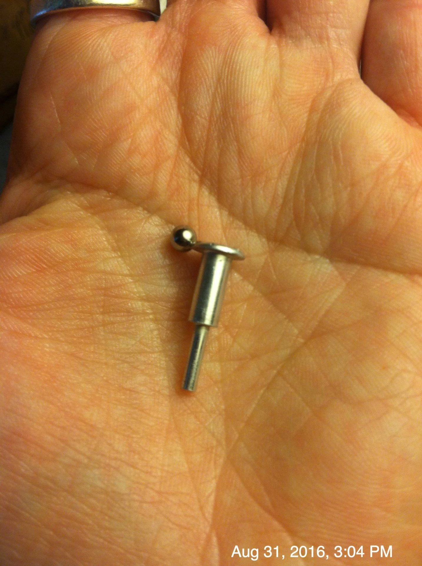

I found that a little metal plunger (shown in the first pix that is flat and has three groves cut to its sides) is supposed to have a spring under it, did not. Sorry I am flaking on the name of it. Jim @FJ40Jim, could ID it instantly. It has a tiny port that juts out inside the upper horn (?) and through it I stuck an opened up staple and was able to push up on the inside underside of the plunger and popped it out. The second pix is of it and the ball that resides under it and the spring. My rebuild did not have the spring... Another part I had to hijack off my own carb once I removed it from the truck. There were a few things... I kept a list as I tore the carb down.
Third pix is of the spring I took from my own carb for the plunger.

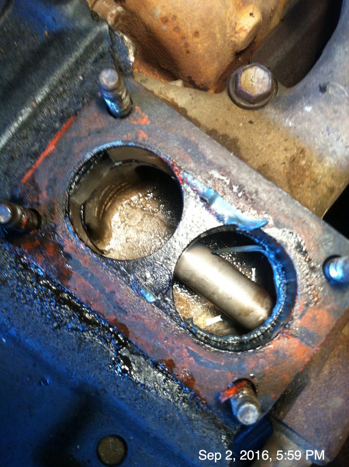

I'll add a photo here of how my carb insulator gasket looked once I pulled my carb.... Red and Blue RTV. This was not me. From what I have been told and have now read, RTV is never to be used in this area. It will shrink and cause gaps and most definitely become a vacuum leak. Also my insulator plate was missing a section. @CaptClose was kind enough to hook me up with his which was cracked but I more than willing to simply mend with JB and toss it on. Ryan painted the under side first for me (his pix in the background). The upperside is where the fibery materiel was best able to be noted. I have seen a few folks here call it plastic. Its not. Its definitely a metal insulation embedded thick thing (it almost looks like a fiberglass sort of material). Where it was broken and I added JB, it had fibers visible.

In the last pix you can see the JB putty on the insulator where it was cracked. I did not paint the upperside of the plate as the material appeared to be something that should not be coated with paint.
When I replaced my carb I did use two gaskets from possibly cruiser outfitters, I'll find it and add it and the P/N here as soon as I come across them. One was a pink plenum material with an oval hole and the other was blue with two round holes. One (pink) went under the black thick insulator that is part of the plate and the other (blue) went on top. I was under the idea I needed these but since then have read conflicting info. If the black thick insulator is in good shape and w/o any gaps or marrs you do not need either extra gaskets. For now I will leave them in place. But was glad to spot the recent info that I actually do not need them. No RTV was used for reinstall.
