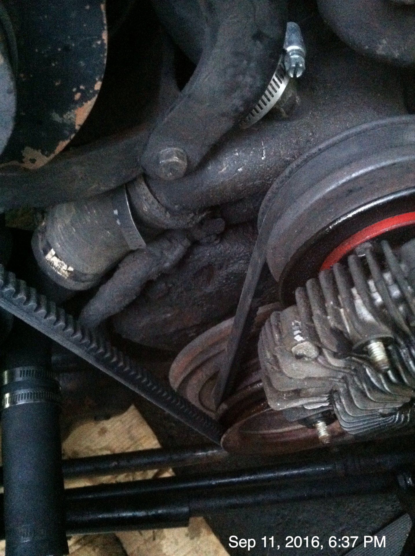

I've replaced the hoses on my 62 and on my 40. The hoses are PITA for sure:bang:

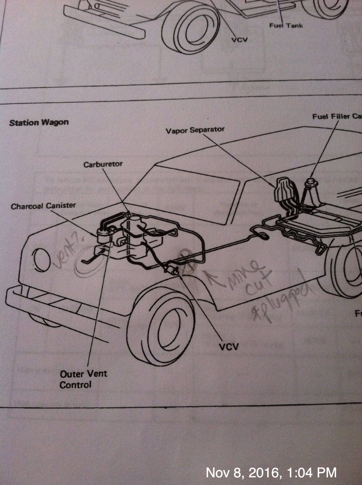

Charcoal Canister Gut and Refill: In between trying to understand the desmog stuff and what I need and what I don't need I pulled my charcoal canister... As you can see in the diagram from the FSM, my purge line is not hooked up so swapping lines didn't seem like the wisest idea for fixing the big gas cap whoosh. One of the hoses on the top was entirely degraded and as you can see in the second pix was totally useless. I picked up a section of 90* hose at Napa and cut it to fit. I used my dremel and chopped the canister in half. I refilled it with aquarium charcoal (all I could get my hands on was the pelleted type of substrate) and replaced the fiber filters top and bottom with the basic cut to fit material from the fish store. I made a lip on the inner edge of one half with jb putty (Quick Steel) so the other half would fit against it. I let it dry for a day and fit it back together... I used a piece of thick plastic (dog food bag) to hold the pellets in one half while I flipped the other half on top and then slide the plastic out. I lost some but its filled the best I could. I then added another layer of jb putty to the outer rim. I added a coat of black paint and no more whoosh from the gas cap.
IF I was to do this again I would cut much closer to top or bottom so the sealing of the canister was easier.

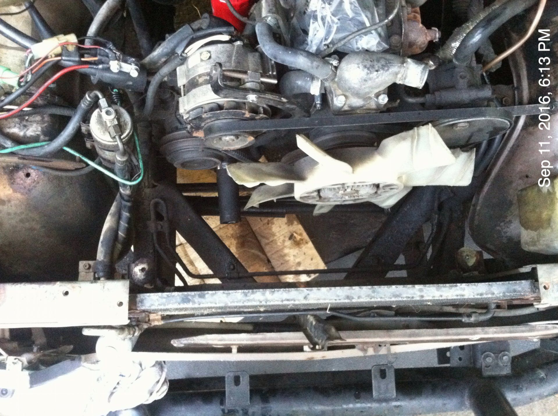

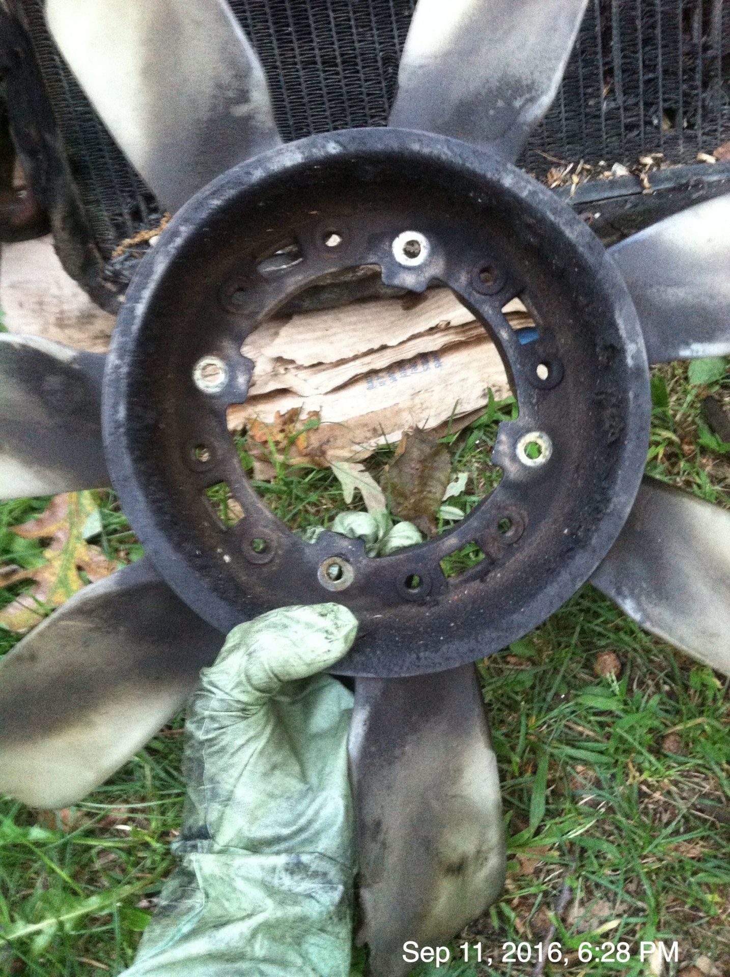

Carburetor Cooling Fan: I then pulled my carb cooling fan and figured I 'd give it a shot to cleaning it out and seeing if I could revive it from its sleep.
Ground Carb Cooling Fan Wire: Initially I grounded the broken wire that was hanging free from the two ICS wires to the closest section of bracket (first pix), its the green wire and I added a ring and still got nothing.
Once I pulled the fan which is a bitch job... the bracket to the hood prevents one screw from being able to be backed out fully. I ended up pulling the bolts to the hood bracket and had a few seconds of an MI as the hood leaned quite a lot of weight on my head... I held it though and got the friggen carb cooling fan bolt out and the hood bolt back in. I tell you the strength I have is amazing when combined with adrenaline.
Lots of material left on the brushes. But quite a lot of wear on the edges of the magnets... (totally not right verbiage here).
I used the suggestion of someone here on mud to tie the brushes in place with dental floss and once housing is back over the mechanism, simply cut and pull the floss out. Worked like a charm. Sorry, thought I had pix. Hands were probably too busy, its not a easy task.
It still does not work but could be a wiring issue as someone at one time did some funky hacks inside the kick panel and relay area.
Then I did the green wire mod per @Landpimps suggestion I simply made a jumper and grounded the other side to the carb. I have since swapped out the ICS for a new one via someone... forgive me., I'll find the invoice in my stack and add it here. It was less than $10. Mine clicked as it should but I still felt apprehensive of it being that it was possibly the original one that I had taken off my carb and added to the rebuilt one.

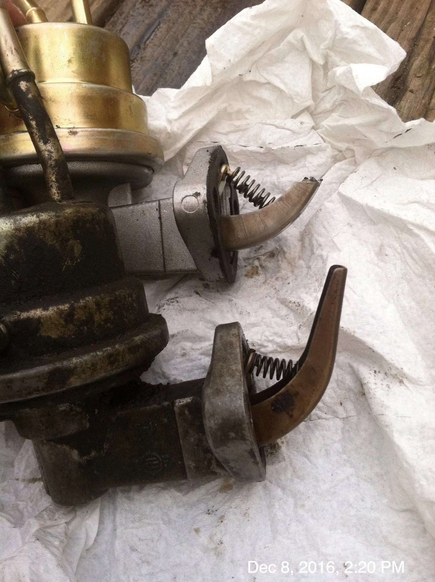

As I got all this figured out I noticed tons of fluid from my weep hole on my fuel pump. Thing was spitting a constant stream. I know right away the diaphragm was junk and pulled it. I had a aftermarket (yes, gasp!) pump I had picked up from Rockauto and figured I'd swap it right away. The spacer was in great shape and stuck on tight. It wasn't brittle or worn so I let it be. I hooked up the pump but was surprised that it didn't go in easy. I had to use the bolts to pull it in... First indication that I should have picked up on... most likely not the right pump for the year my truck came off the assembly line.

In the end it was the after market fuel pump. I knew looking at the one I pulled and the new one in my hands that the shape of the arm was a hair different as I was about to install it but I ignored my gut. After charging the battery which was a tad low and still not getting her to fire I figured out I wasn't getting fuel to the carb. I pulled the feed line from the pump and put it in a bottle and tried to fire her up and got nothing so that told me the pump was bad. When I pulled it my heart seized. The actuator arm was literally missing almost half of it. I stuck my finger in the housing and could easily feel the cam lobe which thankfully felt smooth and not marred. I read many threads of this exact thing happening to folks so I don't feel too much like an ass. Its what it is. The chunk of arm is down in the first baffle most likely in my oil pan. I could fish it out and up the side of the block with a magnet but being where it "most likely" is I'm going to leave it for when I pull my pan this spring for the new used pan I have in the garage.

Fuel pump may have been aftermarket, but was it a reboxed Kyosan ? Kyosan is the OEM which made the pump for Toyota and is sold in lots of different ways. Toyo part # is 23100-61070 81-87 FJ60. (Kyosan TP-636) The insulater is different, cutoff being 10/84, but if they one on the truck is ok, then stick with it. Use a little sealant, though.
Difficult to tell from your pic if that's a Kyosan pump.
