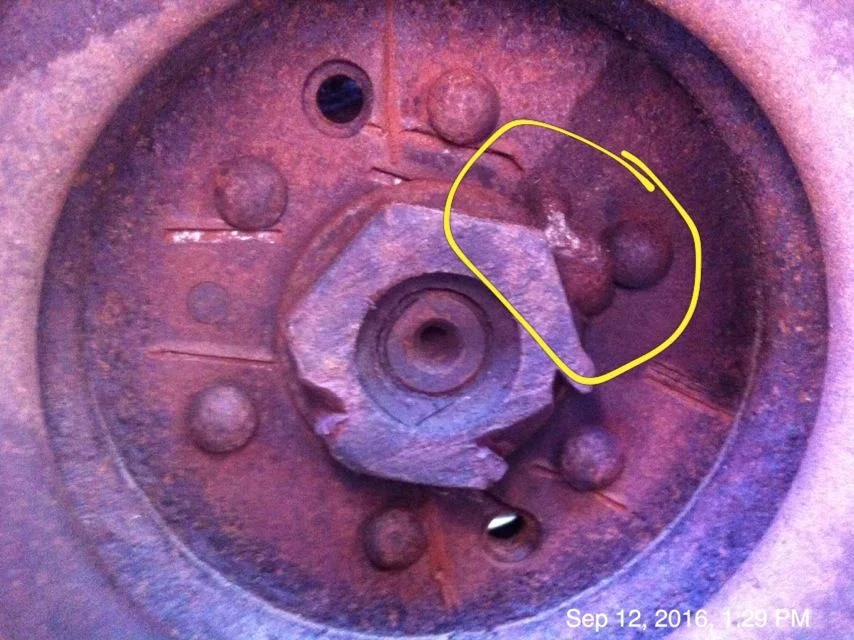

Harmonic Balancer 46mm Nut Removal: And now comes the big guns... My neighbor was kind enough to let me borrow a big wonkin' wrench and socket to get the 46mm nut off the Harmonic Balancer. He primarily used to deal in big tractor trailers so most of his tools are standard size so as you can see the socket was not metric.
That is until I realized the nut was spot welded on. And it was done by the PO I just bought the truck from. He himself told me about how he went to Cruiser Parts in NH and bought an HB from them... They took it off a brown 60 on top of the hill... (my old 60 was brown and I sold it to them for parts in '13). So it could be that this HB he had put on this truck came from MY old truck. Serendipity.
In yellow is the spot of weld. And the marrs along the edge were not from me... Crowbar is my guess. Luckily they did not get in the way of the socket nor the actual 46mm socket I bought to reinstall the nut later. I cut through it with my dremel and a metal cut off wheel. That was a whole s*** ton of fun. My son watched from a distance while his mama made sparks. I used a section of 5 foot pipe over the wrench handle and after a few almost full body pulls from the left fender side the nut came free.
This lady was damn excited when I felt it suddenly let go. "Its loose?!!!! Holy s*** I did it!" My little 3 year old had the mind enough to tell me "Congrats Mama!"

nice job doing the most feared stuff first, maybe try to find why it was welded, thread ok? (or why it came loose previously, or is that just old damage from the prevoius balancer)
I would never have removed the weld if the balancer is fine and the seal behind it is not leaking, enough other stuff to do: maybe you can be a bit more lazy :grinpimp:

You will see soon enough 'why' it was welded on in a short time.
If you look at the dates of my pictures you'll notice that all of this work was months ago...

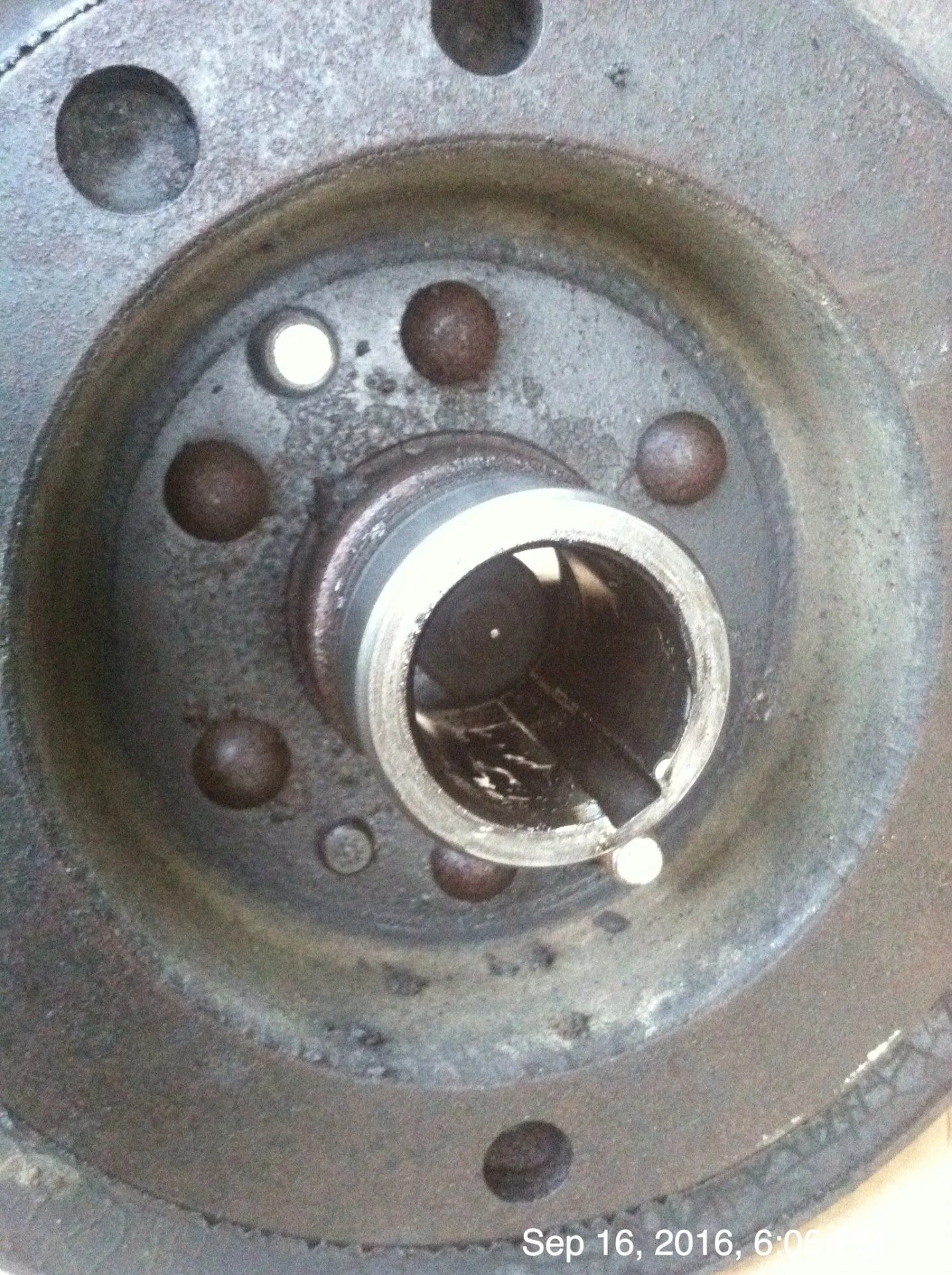

Pulling the Harmonic Balancer: I rented a puller from Advance Auto for something to the tune of $127 indefinitely. I tried it a number of times but was confused because the bolts in the case didn't seem right. It took me a few weeks of staring at the puller on the hb to realize I simply did not have the right length bolts. The kit comes with 2" or 4" and come to figure out the truck requires 3" bolts with this puller. It was the one that is shaped like a birds foot, first pix attached. I had read MANY threads on pulling the hb so I was well read on the subject. I knew that this puller was not the recommended type. I did order the "better" one, second pix attached, in between finally getting my guts up with the correct bolts I picked up at my local Ace Hardware and just did it.
It has quite a lot of length to slide before it actually comes free. I went slow and easy.
What I found was not exactly what I had hoped to find.
No key. And the keyway a sheared mess.
The inner edges of the key shaft on the hb was pretty okay... the inner walls of the shaft had some bubbling.

My gut tells me that this truck had some sort of accident from underneath. The oil pan has a good dent in its underside closest to the rear of the timing cover. And someone took the time to weld it because its a mess of bubbly bumpy metal, pix attached. And as I said the PO had this hb put on so he knew what was going on and chose to not let me know the condition of the keyway or the lack of key. I believe in karma.
So what I can imagine is that somehow the truck took a hard hit from underneath and whatever hit the pan also hit the lower edge of the original hb and caused the key that was probably in there to shear the keyway. Especially when you look at the direction the shear occurred... thrust side and out toward the nose edge.

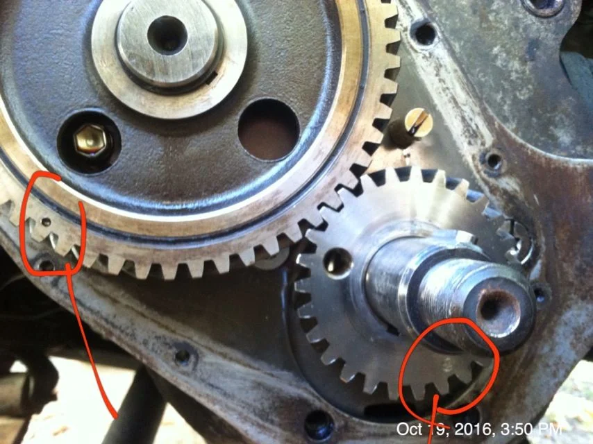

But before this I had to get the keyway into position. I used my starter to crank the cam shaft over. This was a funny nerve wracking moment for me. I had the truck in 4th and wheels chocked. I hooked up the battery tray and the battery and gave it a go. It only took a few on offs to get her sunny side up. Happy dance.
And there it is in all her glory.

Oh and while I was at all this Ryan, @CaptClose gave me a bit of a heart attack when he asked me if my gears were lined up right. "the bearing marks, are they correct?" Something or other like that and I pulled the cover back off and counted the teeth on each to where they would match up and the count was the same (last pix circled in red, number of teeth before they would meet is 10). I pretty much wanted to throat kick him through the phone.

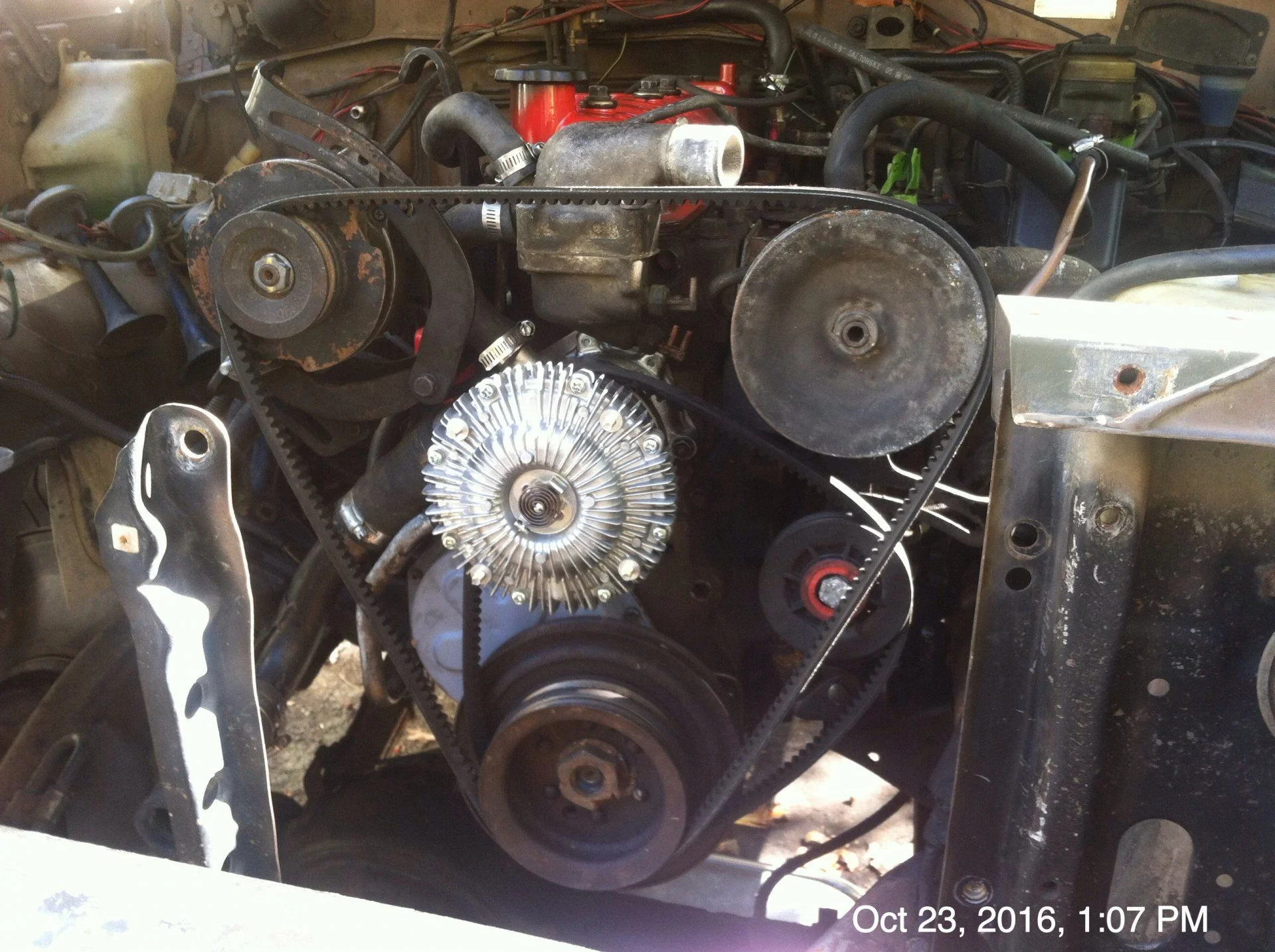

Radiator: So as you can see above the truck got put back together... New radiator (CSF 2708 All Metal from Amazon $293.81 8/30/16) with the smaller cap I ordered from Toyota (16401-54750 $17.98 9/01/16) tho I did talk to @beno about it but did not want to wait for it to be shipped. And yes, the day I ordered the key I had talked to Onur @beno on the phone and he did have one as well as he states above ;) ... again, I chose to go with the dealer for the fact I knew they'd be quicker.
Harmonic Balancer Reinstall: So to get the hb back on I was not about to use a BFH to do it. I used my stock bottle jack and a piece of wood. Worked perfectly.
New WP and FC and cleaned up the fan I had tho I had gotten a stock fan awhile back I chose to stick with the Aisin one with the additional fins for increased air flow.
And prior to the reinstall I d/c'd my entire AC. Unhooked the Freon lines and when they started to hiss I walked away. It only took about two minutes and all hissing ceased. Compressor is pulled as are the lines and the condenser. @Cruiser Jimmy is taking some of it... but the rest is up for grabs... @thewadejack mentioned it on "what did you do with your 60 this weekend" recently and I offered the compressor... he has dibs if he needs it. @mattressking is seeking a bolt. LMK guys, if you want those parts. I can get better pixs then the one above which is fuzzy as heck.
I reinstalled the hb nut, chose to add blue thread sealer as a precaution and torqued to spec.
My girl looks a whole lot different today.
Water Pump: Aisin WPT-028@W22 from Rockauto, sorry no price on my reciept, bought 8/30/16). I bought the water pump wrench too but forgot I even had it and made do with two wrenches to get the nuts off the inner surface of the FC to the water pump which are almost impossible to reach. Hold one wrench stiff and twist with the other. Takes some thinking but it was easy enough. Getting the nuts back in place is the witch job... thankfully I have small hands... smaller than most of you guys at least. ;)
Fan Clutch: Aisin A8 FCT017 from Rockauto, no price either, bought same time 8/30/16)
And oh my fing god were those new hoses a bitch to install. Lots of dawn soap and lots of swearing and I got them done but they were seriously the worst part of the reinstall.I simply brought all my old hoses to napa and we matched what they had in stock and I cut them to length with my heavy wire snips.
