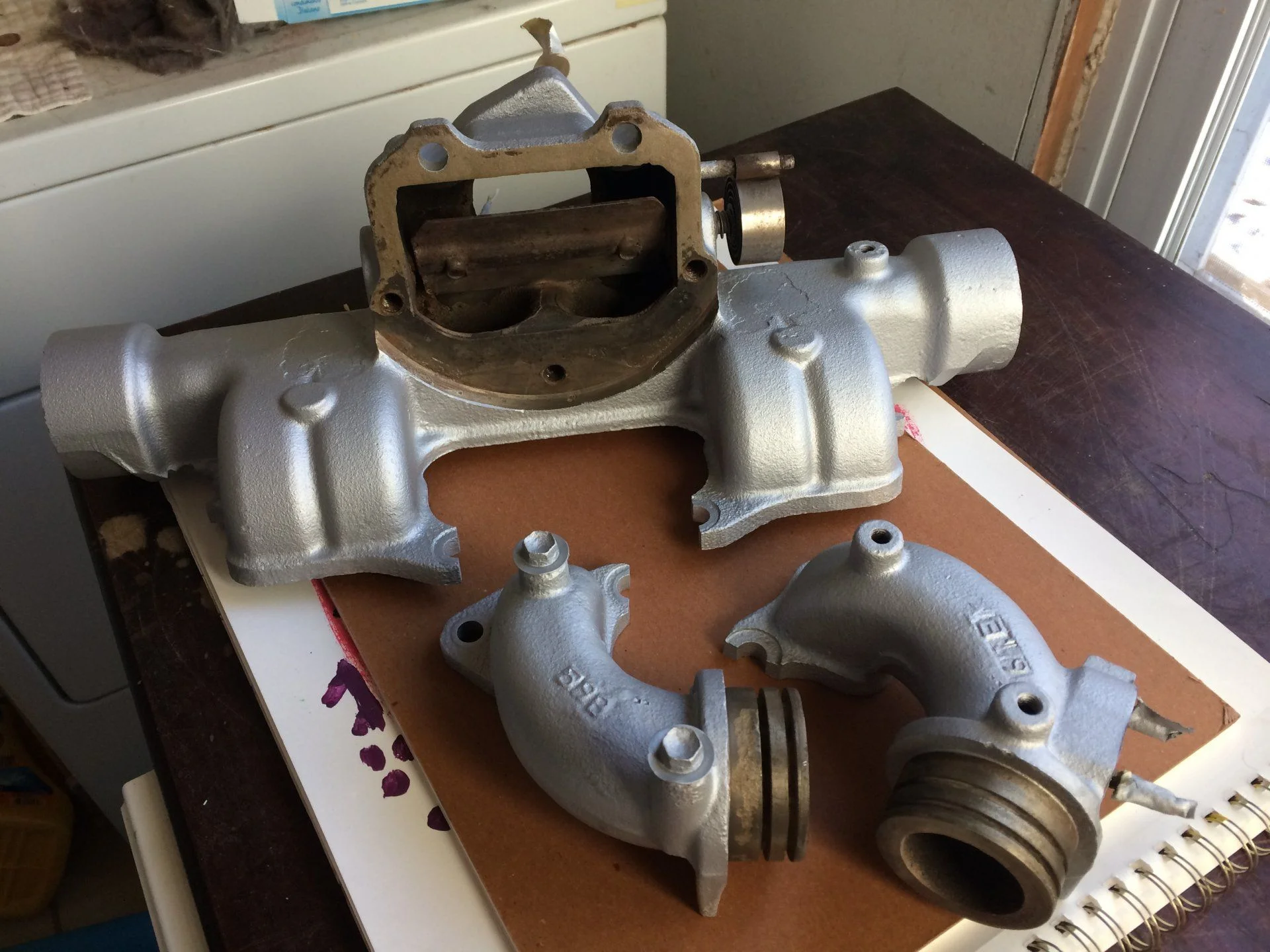

So I finished the exhaust horns from the molasses bath, scraped and added one coat of high temp to them as well. Welder says this week he'll have the intake welded up, guess they were crazy last week. No big rush anyhow since I still need to get the supplies for putting her all back together. Thanks to jim(@Cruiser Jimmy) and Brad (@Breitz6989) who've helped w/ some extras they had hanging around.

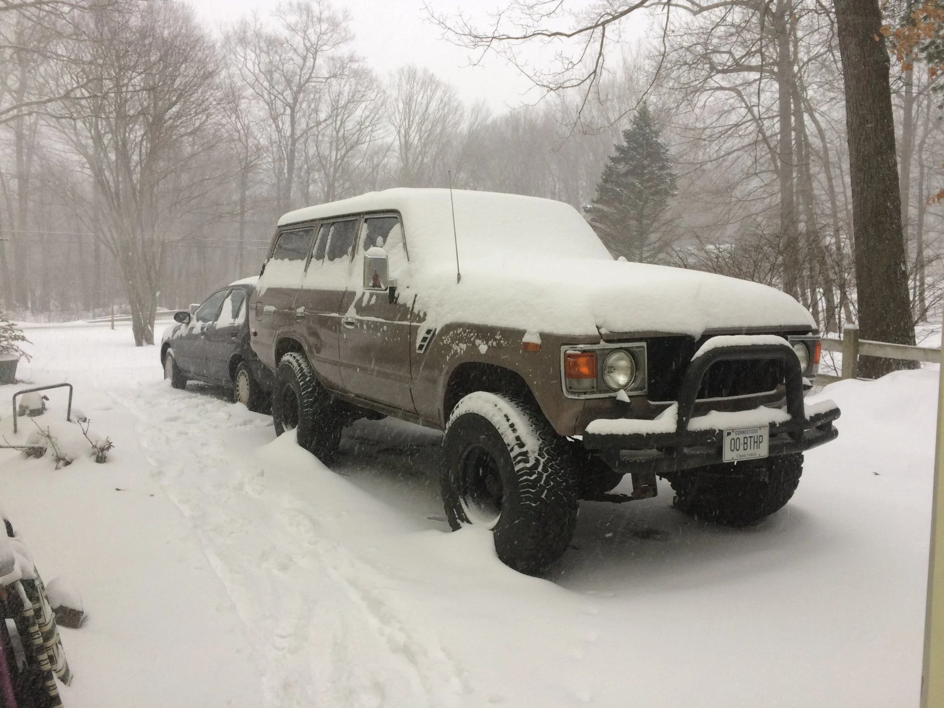

Not much happening here tho seeing as we are in the midst of a snomegeddon... expected depth of 20+". Obligatory cruiser snow storm start pix...
But if I'm outside and I have snow around me do I need an extinguisher? ;))
If a bear falls in the tree and no one is around to see it, does it still make a sound?! Don't want to hear about you getting blown up randomly.. Always good to have as a "just-in-case" measure.

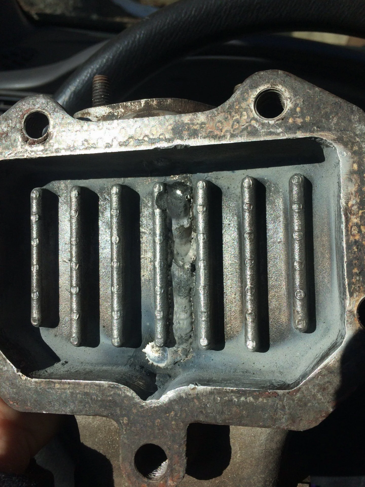

So I got my intake back... No charge because he did not have a 'cup' to fit into the carb side?? So they baked it twice at 200 then he opened it up w/ metal wheel from the backside and put a couple drill holes at either end and filled it. The crack is more visible from the carb side but I'm guessing it's cuz the weld pushed it downward which opened its edges but not necessarily opened the crack?
I put in some calls to a few other welders and am now attempting to check how level it is.
I think he shoulda welded both sides, but it'll be fine as is...
You might give these a try, if you want to seal the carb side. They "melt" with any propane torch to patch aluminum. A few vids on youtube show the process.
Low Temperature Aluminum Welding Rods 8 Pc
I think the welder is saying he couldn't reach down in the carb side with his TIG torch. Should be fine as long as it doesn't leak.
Eric
More or less. He said he doesn't have a special fitting he called a cup to get into there. So I shouldn't worry?
And the weld he did leave is pretty rough. I thought maybe I should try to smooth out the lower edge. There's a few buggery lumps leftover.
Yep bust out the Dremel if you want and smooth it out. I wouldn't do anything with carb side if it's airtight. The less heat and fooling around with cast aluminum the better.
