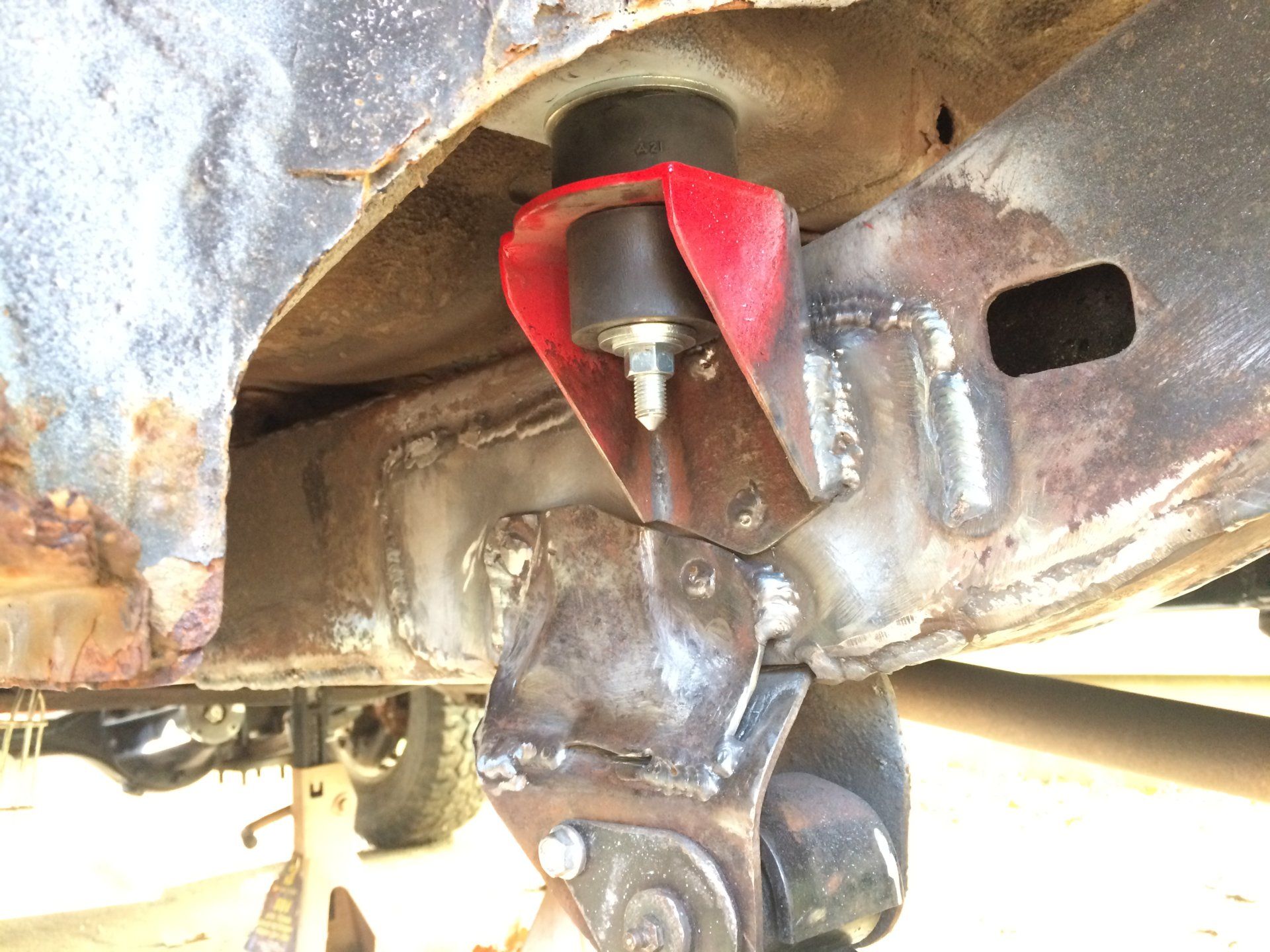

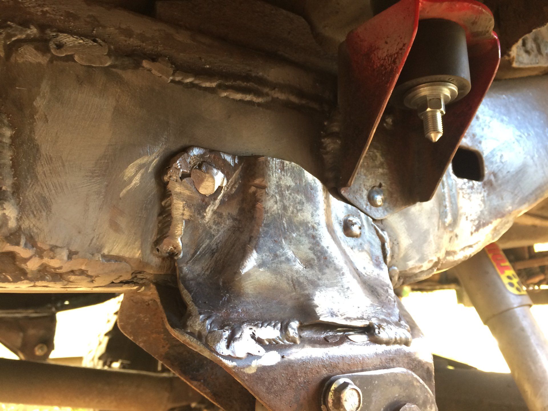

Finally wrapped up the outer driver frame patch. Body mount reinstalled, new hardware, welded the brackets on, cleaned them up and now painted.
Your welds are looking great:clap:

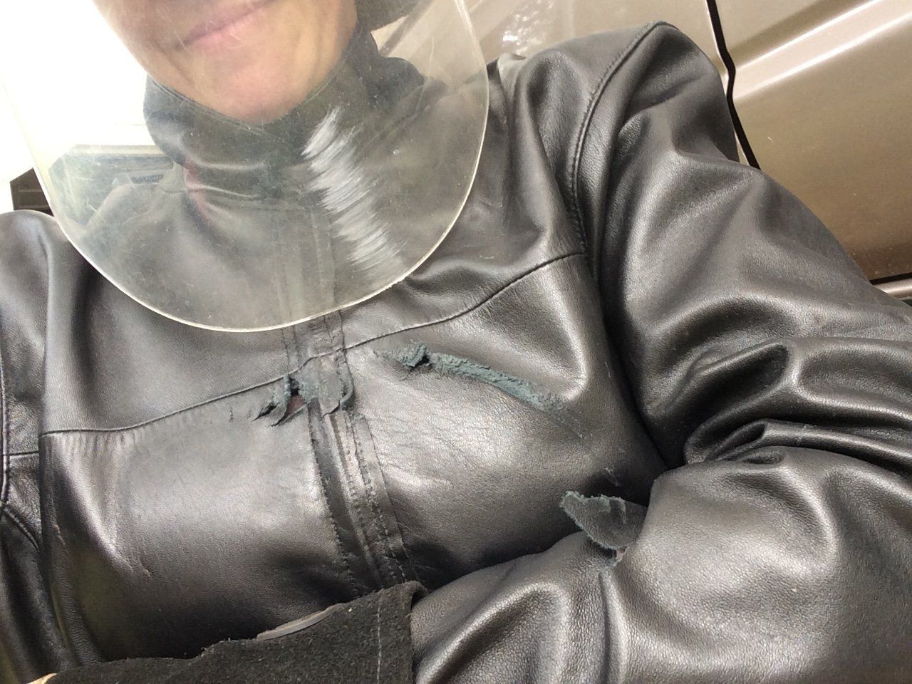

Today I had swung by a Harbor freight to get a backing pad, nut and a package of sanding discs. Ended up buying a second angle grinder w/ a deadman’s switch. Last week or so I was on my back and had my other grinder get ripped out of my grasp because the flap wheel on it caught a perpendicular section on the frame. It dropped on my chest, still spinning. I instinctively pushed it off me and away. It landed in the dirt spinning and tossing crap at me. I got it shut off but it definitely freaked me out. Thankfully I had on my cheap Wilson leather refurbed welding jacket and gloves and face shield or I may not have come away so unharmed. Hence, number two grinder now w/ a flapper switch.

Thanks for the kudos on my welding. I can most definitely thank Matt, @cruisermatt for all his help and guidance. I definitely wouldn’t be where I’m at w/o his assistance.
I also need to add thanks to @FJACS for giving me great step by step directions on how to do the outer rear frame rail repair.
Yeah I’m pretty scared of those things especially when the first thing everyone does is take the guard off. A friend has a nice rash on her leg from years ago - thru her carharts. Glad you are always geared up and nothing happened except fright and possibly PTSD. Damn! Is the flapper switch the one that goes off if you aren’t holding it?
@evilorgoodtwin, yes, it shuts off instantly. On sale at HF for $30. Little awkward to hold because one hand has to be further out from the middle. Funny too, @g-man was the one that pushed me into buying my first grinder, I’ll never forget him writing ‘you’ll probably take the handle and the guard off eventually...’ Yup. No handles, no guards.
Ain't that the truth!! First thing I did with my blue HF grinder was that. If you didn't notice, on the back of the grinder near where the cord goes into the body there is a black "button" that is the override for the deadman switch. You can push in the switch, then hit that button and it will keep things running without the finger on the trigger. Simple push of the trigger will release it. Used it a few times when I have been taking crap off frame rail or whatever. NEVER used it when I was cutting.
And I have gotten to the point where I gear fully up now, skullcap for under welding helmet, welding jacket, thick pants with canvas blanket over the lap (if I am sitting). Have plenty of scars now from slag dropping and burning through thin cotton items and whatnot. Also learned my lesson when I had a flap disc explode on me cuz it caught an edge when it was getting worn down. Luckily had a face shield on, which reminds me I need to buy a better one, and everything went into my chest or elsewhere, not shield hits.
She is looking good F and you're doing a great job. Keep at it and she is gonna be back together and purring like a kitten in no time!

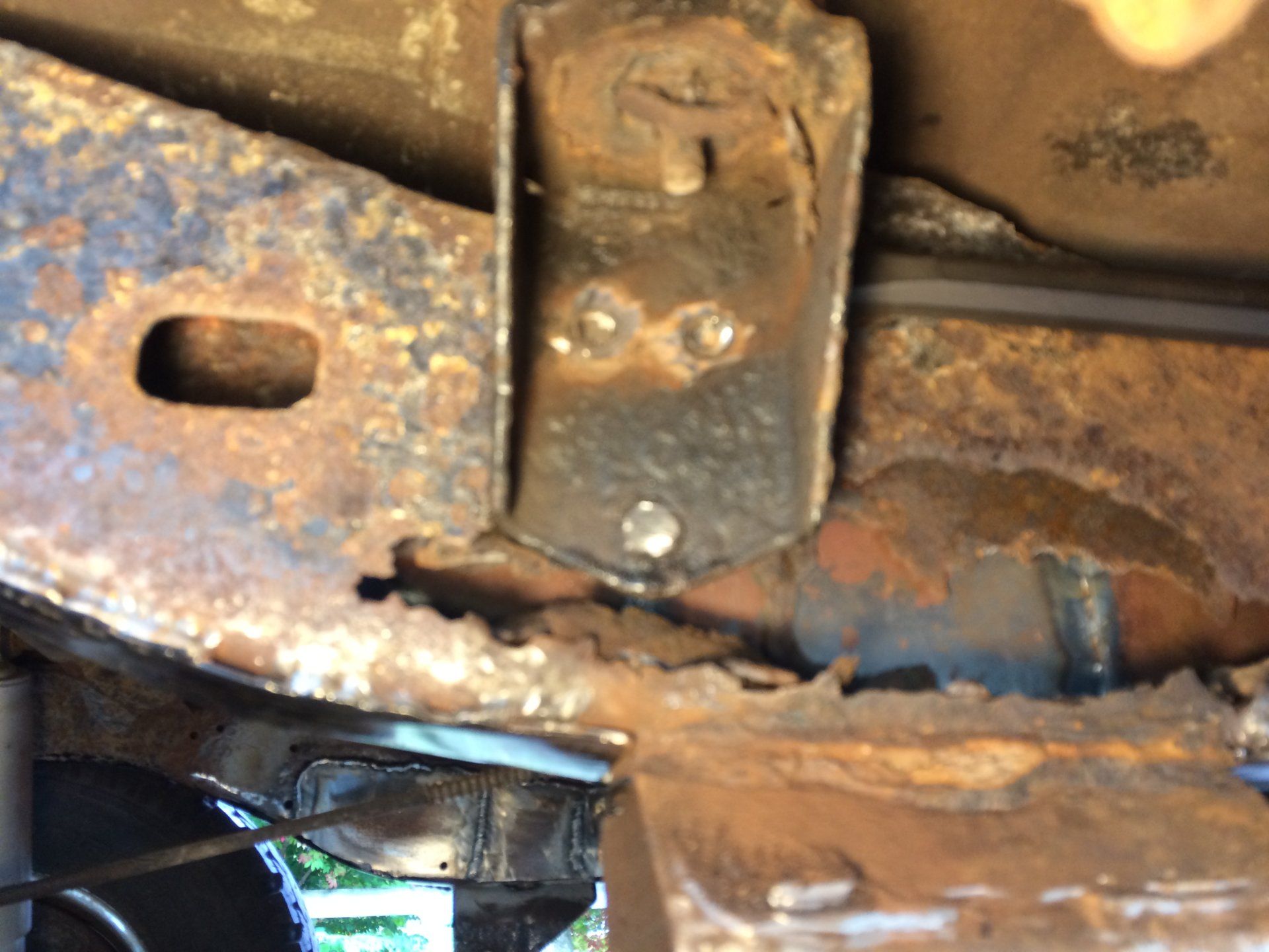

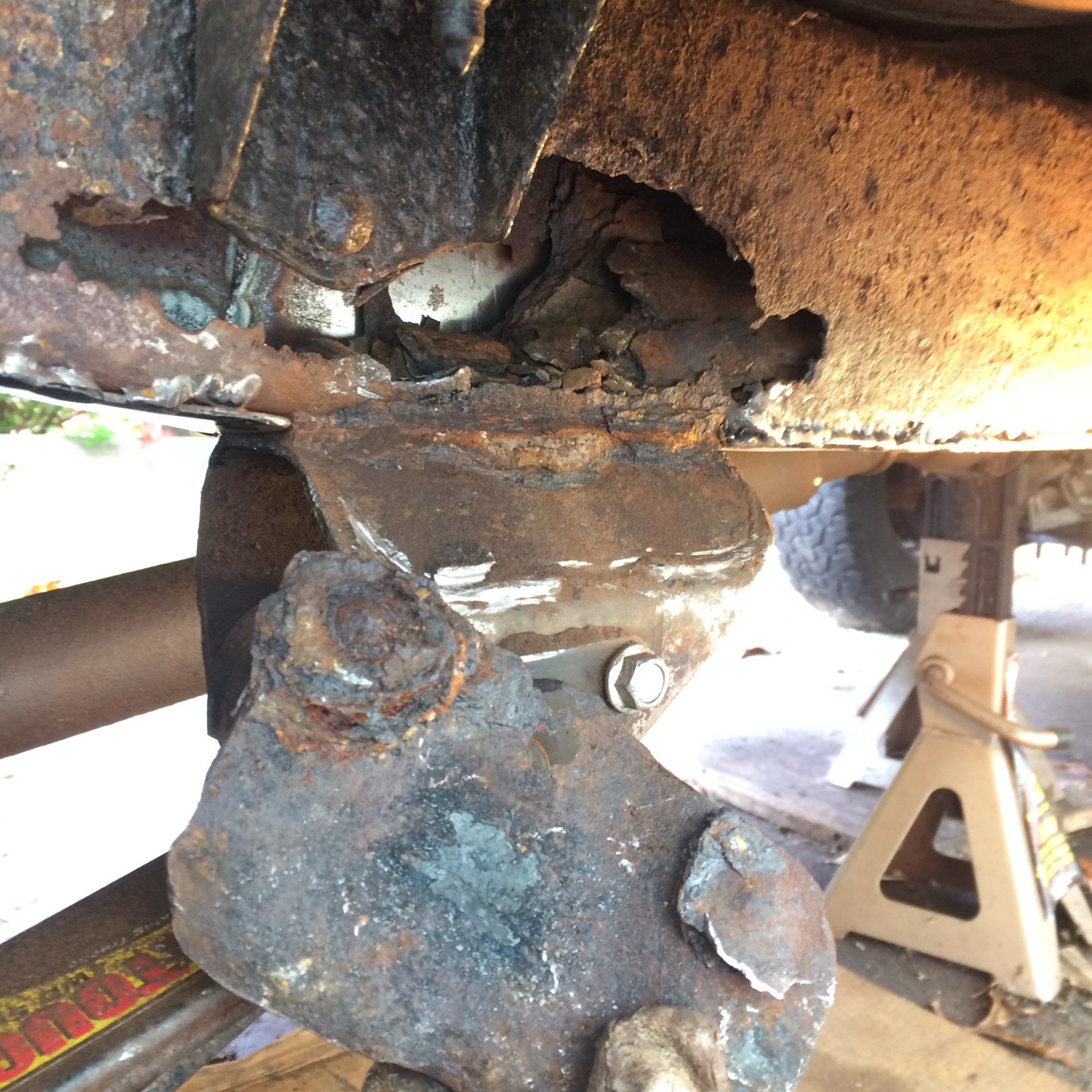

More ugly.
Inside the inner patch (was my first) I made on this side could have been prepped vastly better. Once I open it up more I’ll add either zinc weld to those rough edges or ospho then paint.
