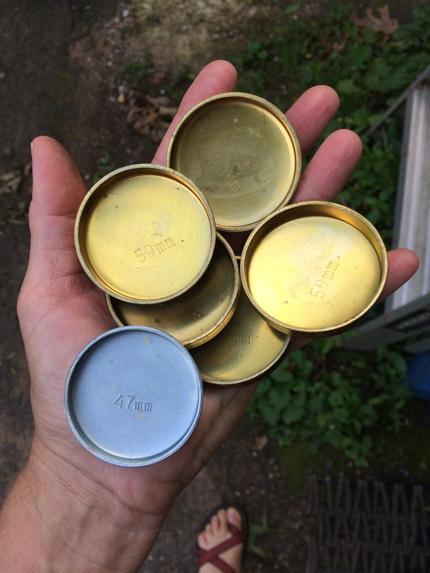

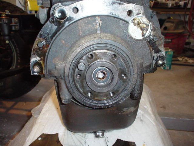

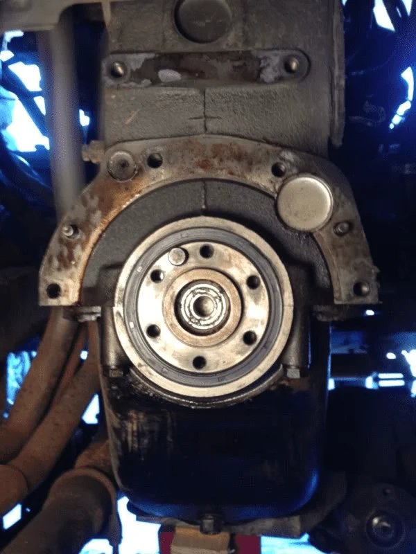

Not a freeze plug, more of a oil galley plug.
Cam Expansion Plug 90331-48010 69-93 F/2F/3F
You want to use a new one anyway. Check Jim C's posts on installation. There's a 'correct' way to install so it expands and seals. May be in FSM, don't remember...
Thank you Spike!
Just to be certain, there are two plugs back there -- You mean the large one, yes?
Small one is available too, and is, IIRC, a plug for the oil circuit. You might want to consider replacing that one also, since the block has been hot tanked and the plug is old. (small one, at 11 o'clock, has been removed).
Cam plug is what I was seeking. The ones on the driver side and that upper center rear all measure for the 50mm I bought from my shop. It’s only that cam plug that’s had us stumped. The 47 is too small, that was my mistake because I measured poorly while distracted by my kid.
Crap, damn, your on it. 11 o’clock I’ll need too. My engine stand blocks my view and I missed that one too. Funny cuz they asked me if I needed another small one because the ‘set’ they would have ordered showed an extra 25mm in it. Thank you!

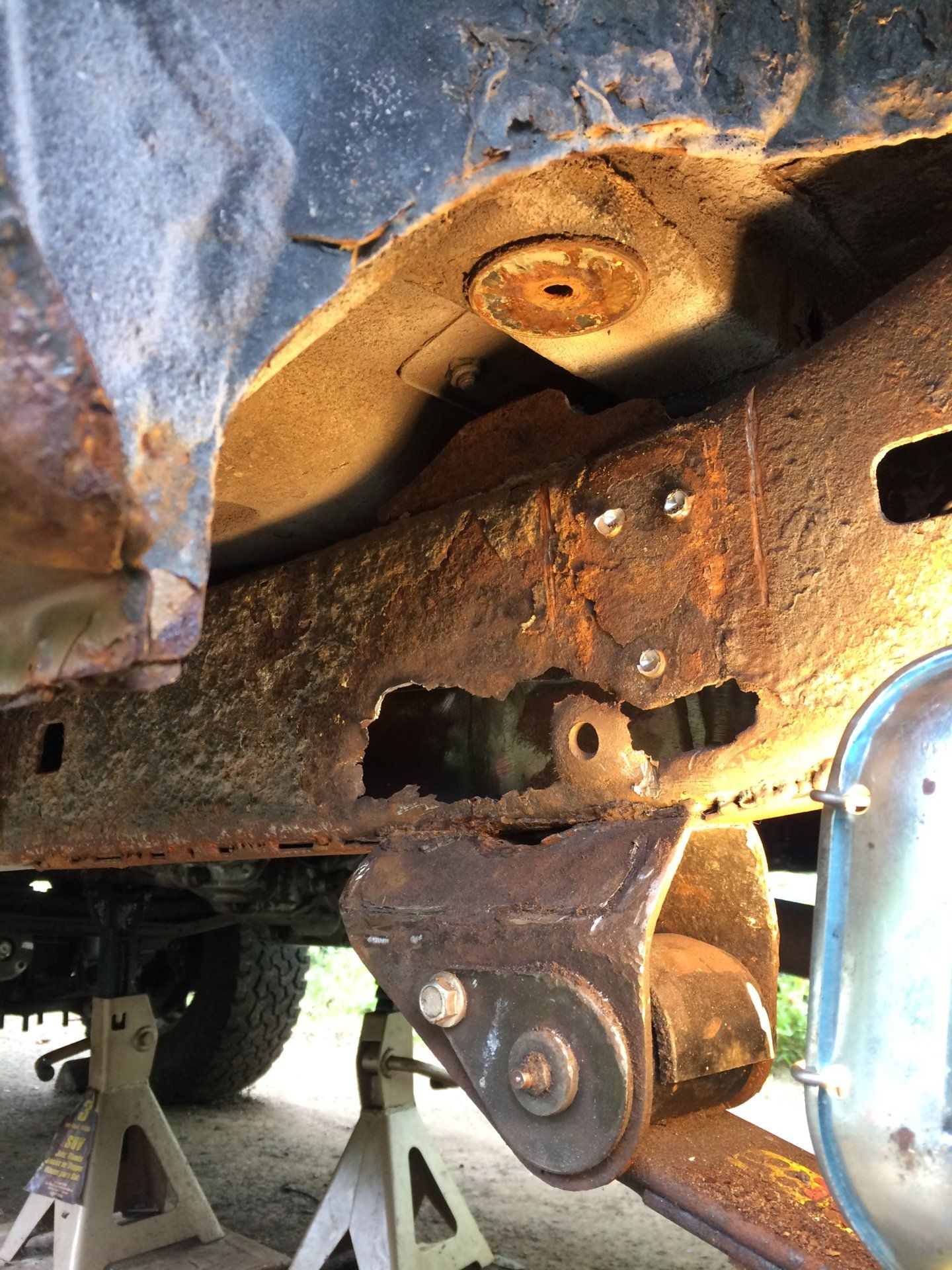

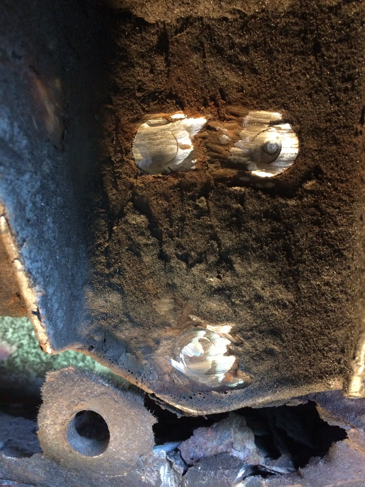

Dove back into rust remediation today. Driver side rear outer section of frame behind the spring mount locking pin.

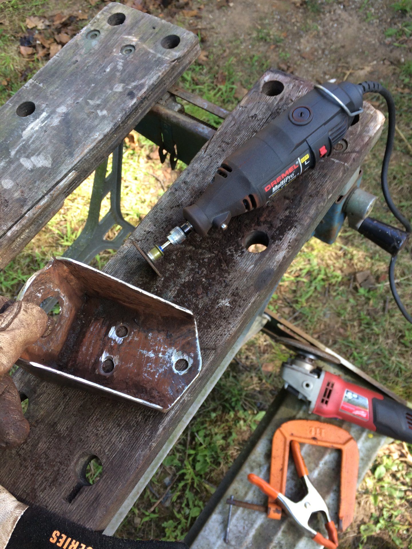

I’ve found the best choice to tackle rivets is my dremel with a grinding wheel. Shaved the heads down till I saw the ring from the inner post, drilled a little inward then pried up w/ various tools. Rivet post let’s go of the bracket fairly easily.

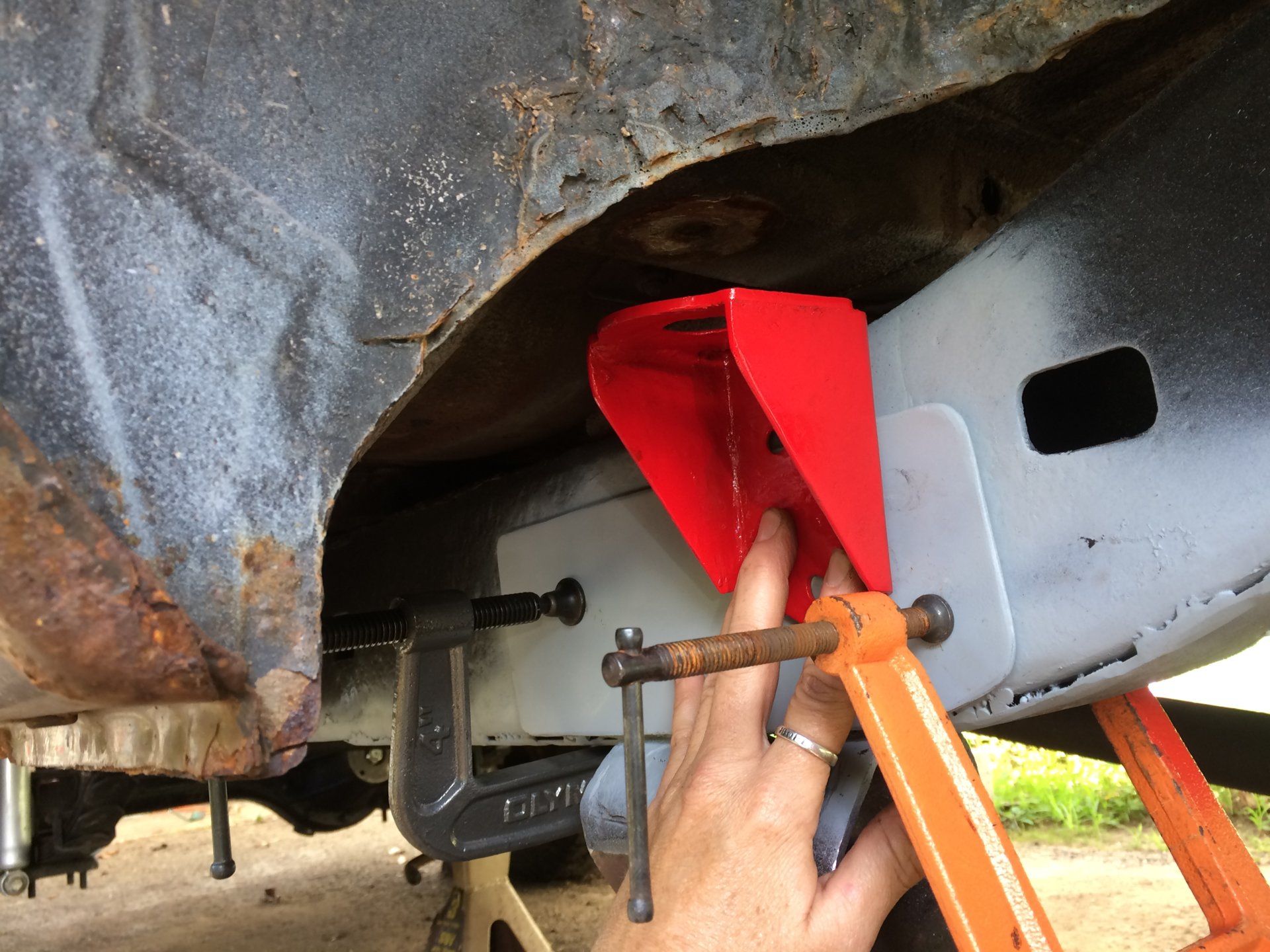

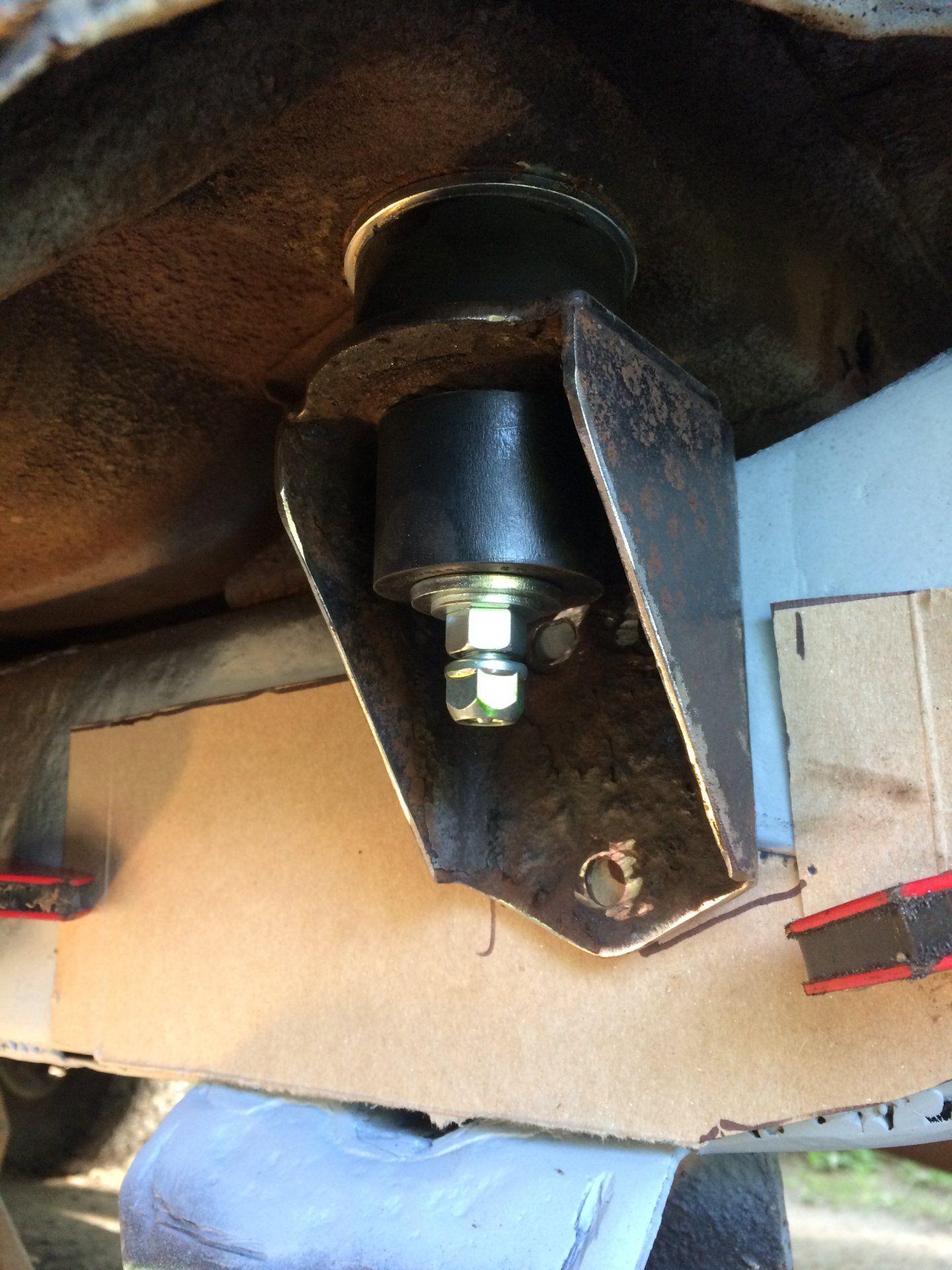

Bit more done this AM. Test fit the new body mount hardware. Then typical me... I had to add some color. Once I’ve got the patch welded on I’ll add black to the rail. Then the red will really stand out! Haha!
To get in the tight corners the dremel saved me again. Love the little grinding wheel!

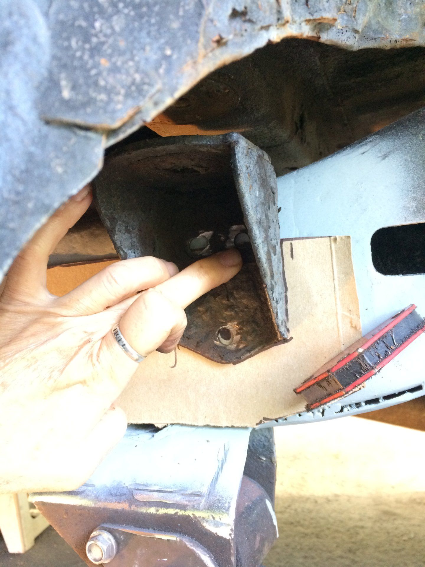

What body mounts are those?
From the dealer. I bought them awhile back. Only piece in the box I can’t use is the spacer, I think... appears it doesn’t go through the floor as it might on another year. I can post p/ns tmrw, at work now.

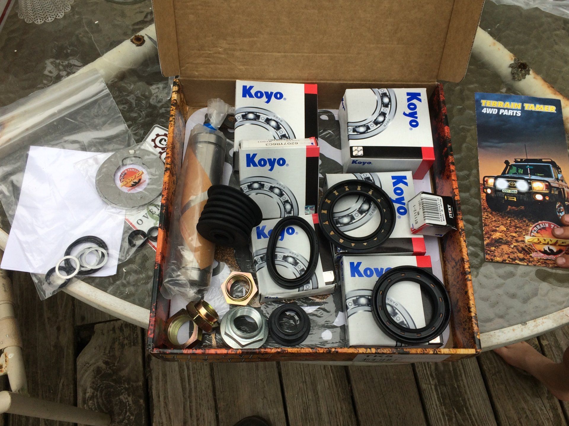

A very generous gift arrived... (not from Georg himself). One seal did arrive squished as can see but will get replaced. I can only hope that one day I can extend the same generosity.

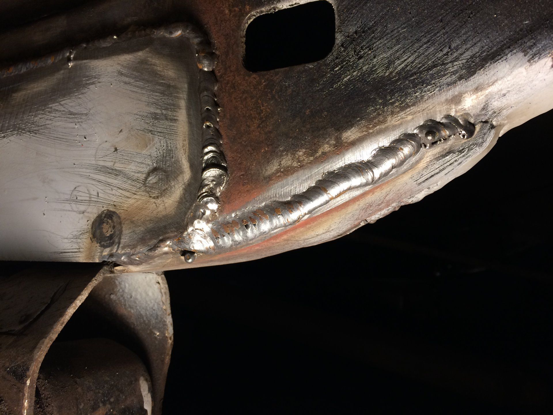

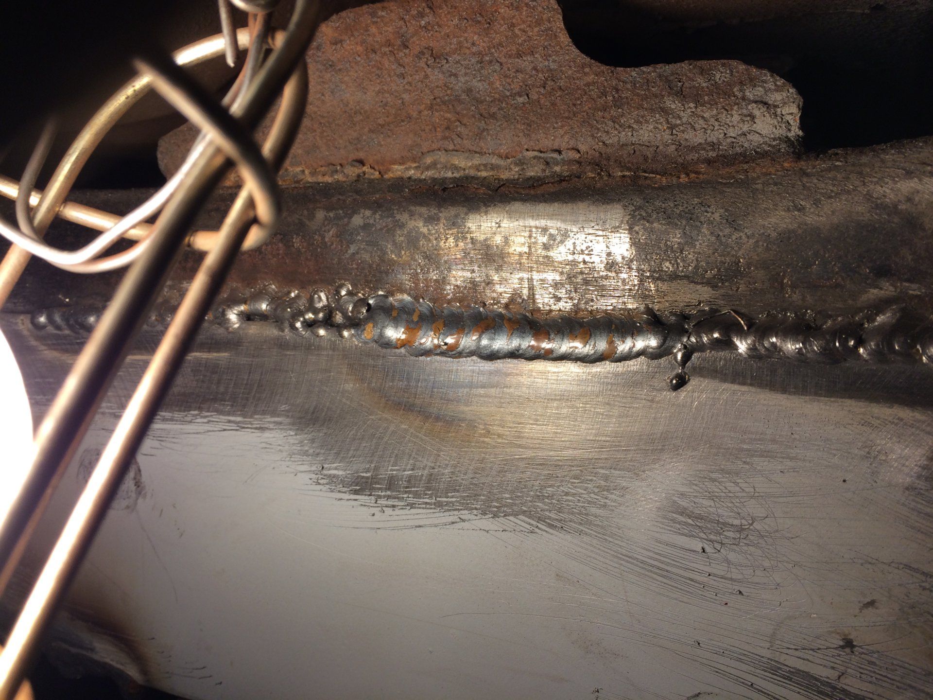

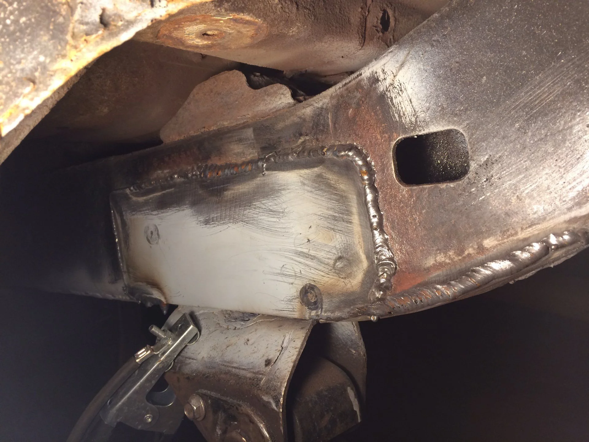

Stole an hour and added some welds to my patch. Some are great, some suck. It’s all in the angle, I think, of the gun and how I’m moving the bead.
Good on you for trying to save this beast. You need to move out of the salt. Nevada, California, Arizona, maybe New Mexico. Soon you'll have patches on patches. You have some welding voids. I assume you're using gas outside? Try and get better wind protection and your voids will go away. Even a bit of breeze tends to blow the inert gas off the weld and you're left with a void. But in the end, grind everything flat and no one will ever know.

I have a 6 year old and I’m not w/ his dad. I wish but moving across the country is not going to happen most likely ever at this point. Saying that, doesn’t really do me much good. I appreciate the tips on welding tho.
Matt said similar. I’ll check my flow, grind the junk down and try again.
