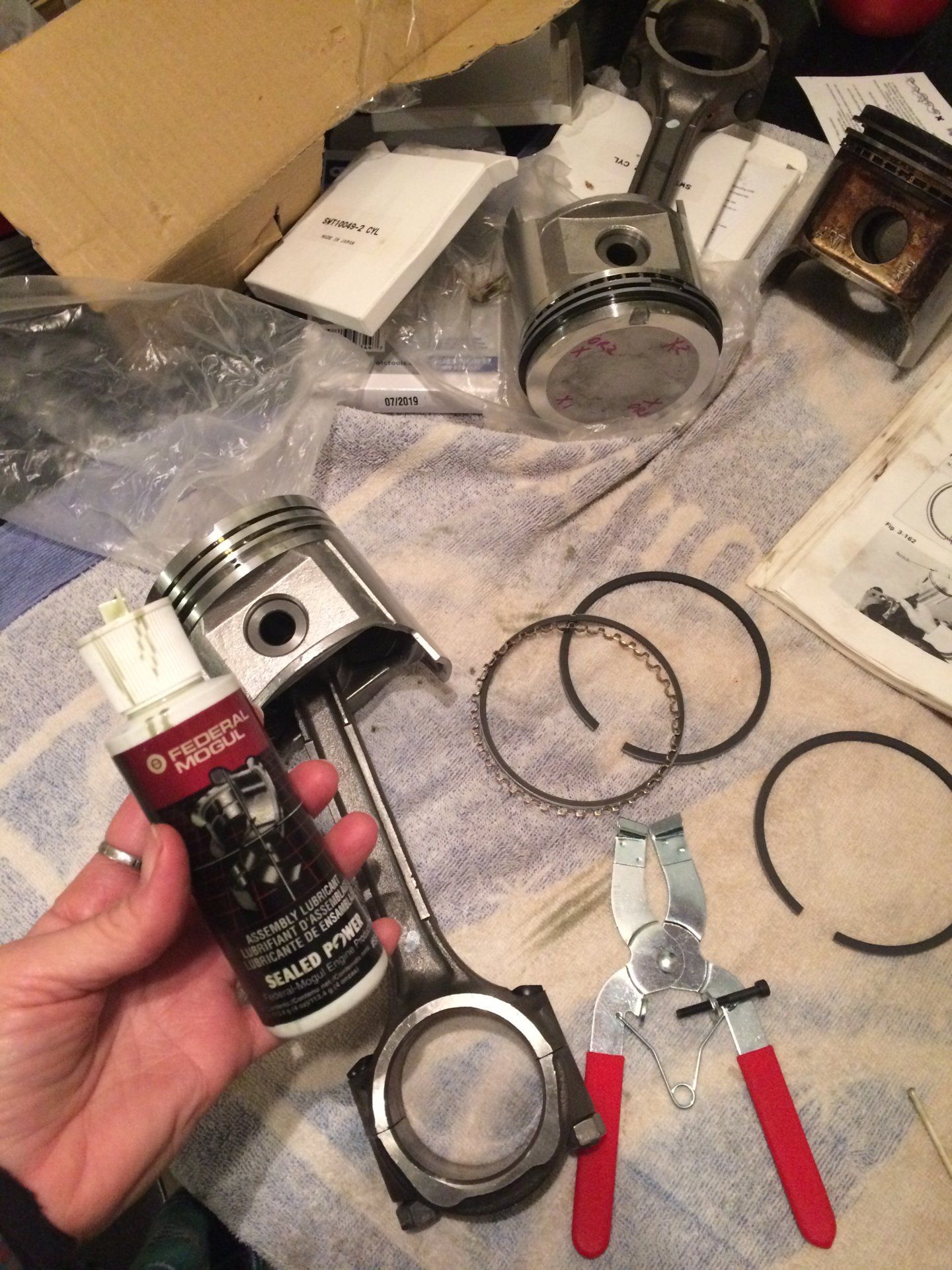

Got up some gumption and began some engine assembly this AM.
Wow, good progress on everything! I see you broke out the plasti-guage to double check the math on the crank, but did you check the ring gap in the bore?
Shop overbored. I’ve only begun adding the rings to the pistons; one is done so far. Had to stop to get ready for work at 3.
Work... always getting in the way of important stuff ;) Just for peace of mind, fit (at least) one set of rings in a cylinder bore, and check the gap. You can probably assume all six sets of rings are the same size, but I would surely check at least one set. As an engine builder, it was one of the most common "out of spec" component we would find. Grinding rings was pretty common. It's worth a check.
Yes ma'am, exactly that.
K, I can do that. Thanks for pointing it out. I have one set installed so far... fussy little job esp with the lube making things all tacky. I'll give the gap check a try after work today.

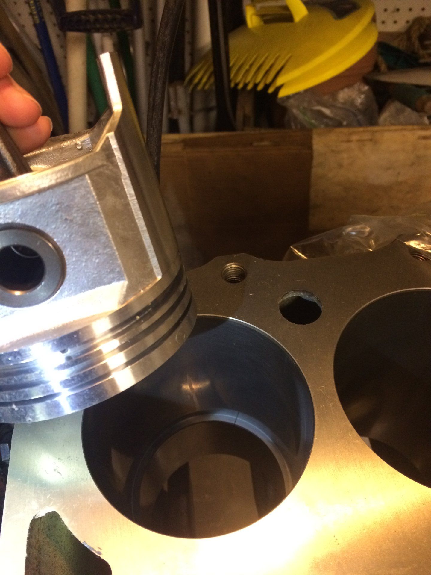

Per ring gap. I checked one set. They go down deeper than in the video. .014 fits snug and I’ve misplaced my .026 but the .025 won’t fit. Initially I was worried I wouldn’t be able to pop them back up and out but it wasn’t an issue.

When I got home last night I had to go back to the garage to settle a thought I had floating around my head all day. Had I pushed the rings too deep w/ the piston and would the gap be different if only squared about one inch into the block? So one inch down I got the same reading. Curiously now wondering are our cylinders tapered?

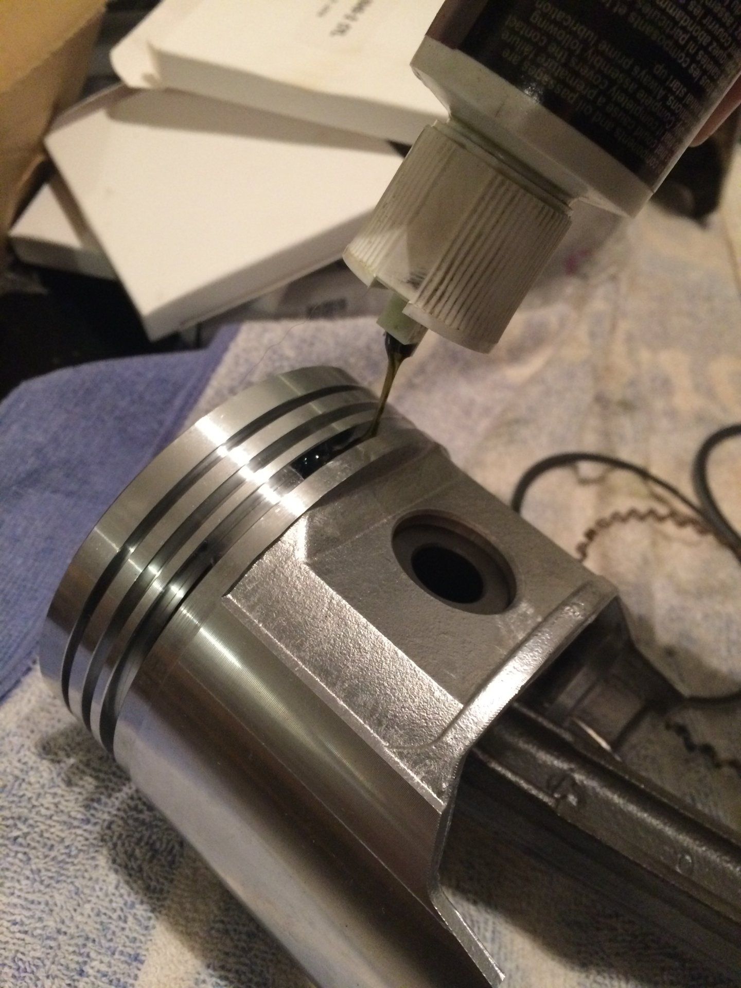

Sat at the kitchen table (it’s amazing the versatility that table allows) and installed the remaining rings to the pistons. I’ll say it here cuz I can... assembly lube has a stretchy tackiness not much different from duck egg whites or man jiz.
You had the block bored oversize correct? Then the gap better we'll be consistent the whole length of the bore.
Yes overbored. So the bores aren’t tapered tho?
