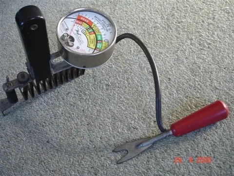

I have an old battery tester that I use to see how well my battery keeps its voltage during a big current drawn-off:
Perhaps if there is any doubt as to your battery charge (and if you haven't got something to adequately test your battery performance with) - charge it for 24 hours and see if your vehicle maintains the same symptoms.
I know - Sounds like I've got a one-track mind in continuing to suspect your battery..... but I find it hard to think of an alternative reason.

You'll see that a "9V" reading on my antique battery tester indicates "recharge and try again".
And to drop your "new" battery's voltage down to 9V should require a VERY high current draw-off - assuming this battery is indeed "good".
And a big current drawoff means either "a big power output from you starter" or "a lot of heat build-up and arcing somewhere".
Yet you say your starter doesn't get hot , and it can't crank your motor (when your motor is hot).
So I now think your second battery isn't up to scratch!
