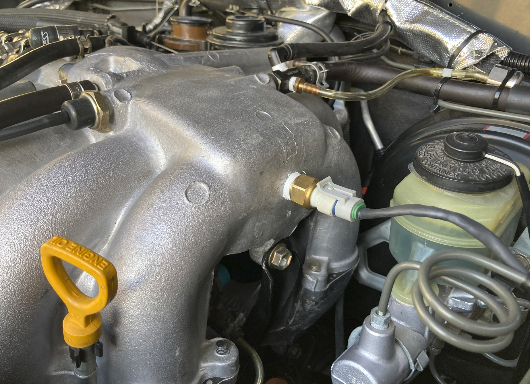

IAT sensor in intake plenum. 3/8 NPT tapped hole. Yes, had to remove the plenum to install.

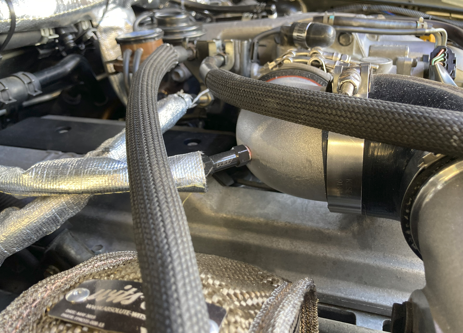

AEM methanol injector in cast aluminum elbow upstream of throttle body:

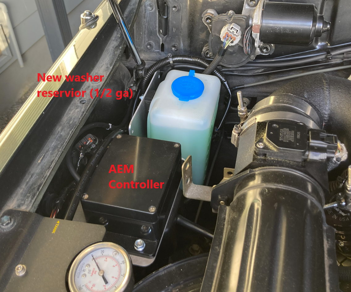

AEM controller in water tight box and new 1/2 gallon washer tank. The factory pump plugged right into the Amazon tank.

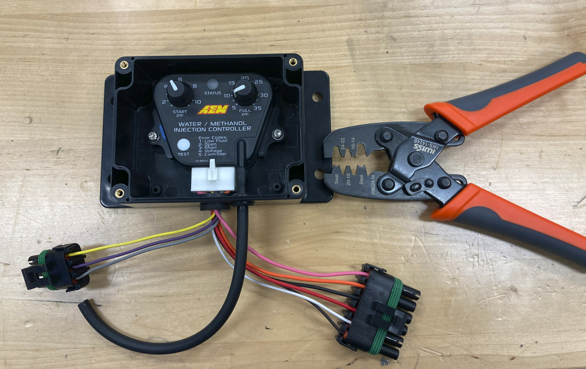

AEM controller in water tight box. Controller is not water resistant. RTV on wires at grommet in side to seal it up. As a side note, the controller has an LED out
wire so that you can put an LED in the cabin to verify that the methanol is armed and for it to flash errors at you. I repurposed
the factory security LED by installing a brighter LED and modifying the wiring harness to take two inputs, with diodes blocking
power going back to the security module or the AEM controller, depending on which was on. The use of the LED is mutually
exclusive. When the alarm is set, the rig is off, and the meth kit is off. When the rig is running, the alarm is off, and the meth
controller is armed. Did not have to drill a new hole in my dash or anything like that.
