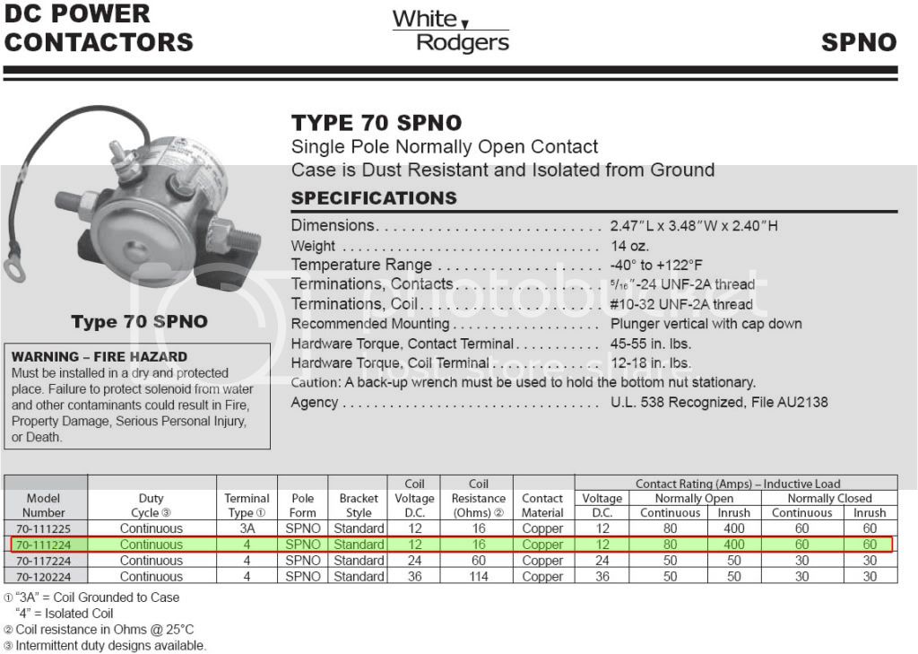

I bought these from a local golf cart supply house to replace my solenoids on my 8274. They are White-Rodger model #: 70-111224, 12V SPNO 80amp-continuous 400-Inrush continuous duty cycle. Do you think they will work? These solenoids do not ground out through the case attachment so I will have to have a ground cable to ground them, that is one difference I see. Either that or the fee that mount to the case have rubber boots on them that I could take off, I bet that would ground them out.

According the WARN website this winch motor pulls 55 amps in a no-load scenario, almost 200 amps at 2000 pounds and 450 amps at 8000 pounds.
I would say they are not properly rated/sized for your intended use, and there is no way I would install them on my winch.
I have been witness to on more than one occasion, the results of this winch not having the correctly rated continuous-duty solenoids installed. Not being able to control your winch, read, stop it when you let off the controller is not a desirable scenario and will cause serious damage to people and equipment.

Ok thanks poser, thats the exact info I was looking for. I'm going to look for a solenoid that will work with this winch. I've been reading about the albright contactors. We'll see. Thanks.

Thanks for the info. I ended up just buying an entire new control pack which included the new style of warn solenoids. I tried the solenoids I posted above, but they didn't work so well. I feel much better now that I have OEM stuff in there.
