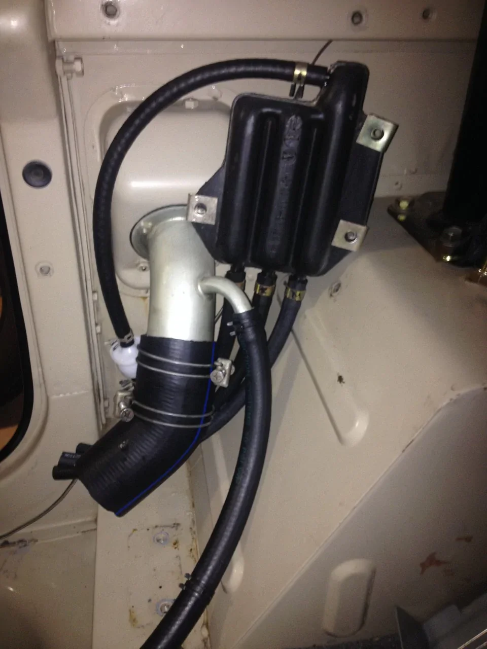

this is a simple to confirm and verify topic :
during restore re-asembly , your various FUEL vapor lines are mixed up
2nd

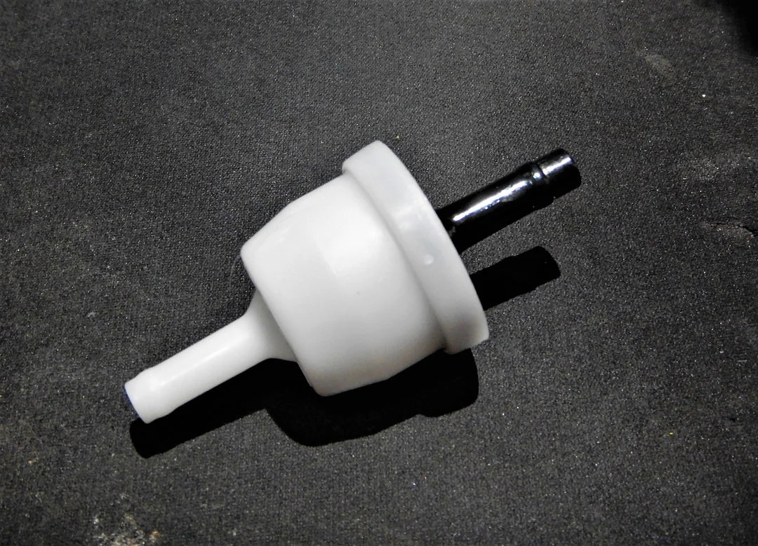

you forgot to install the fuel line check valve or installed it back wards
- OEM TOYOTA Fuel Systerm Gas Tank Check Valve Line Hose Petrol Vapor Recovery 90917 Fits Just about ALL Land Cruisers See application chart first please ... - VintageTEqParts.com - https://vintageteqparts.com/products/oem-toyota-fuel-systerm-gas-tank-check-valve-line-hose-petrol?_pos=1&_sid=50710e253&_ss=r
