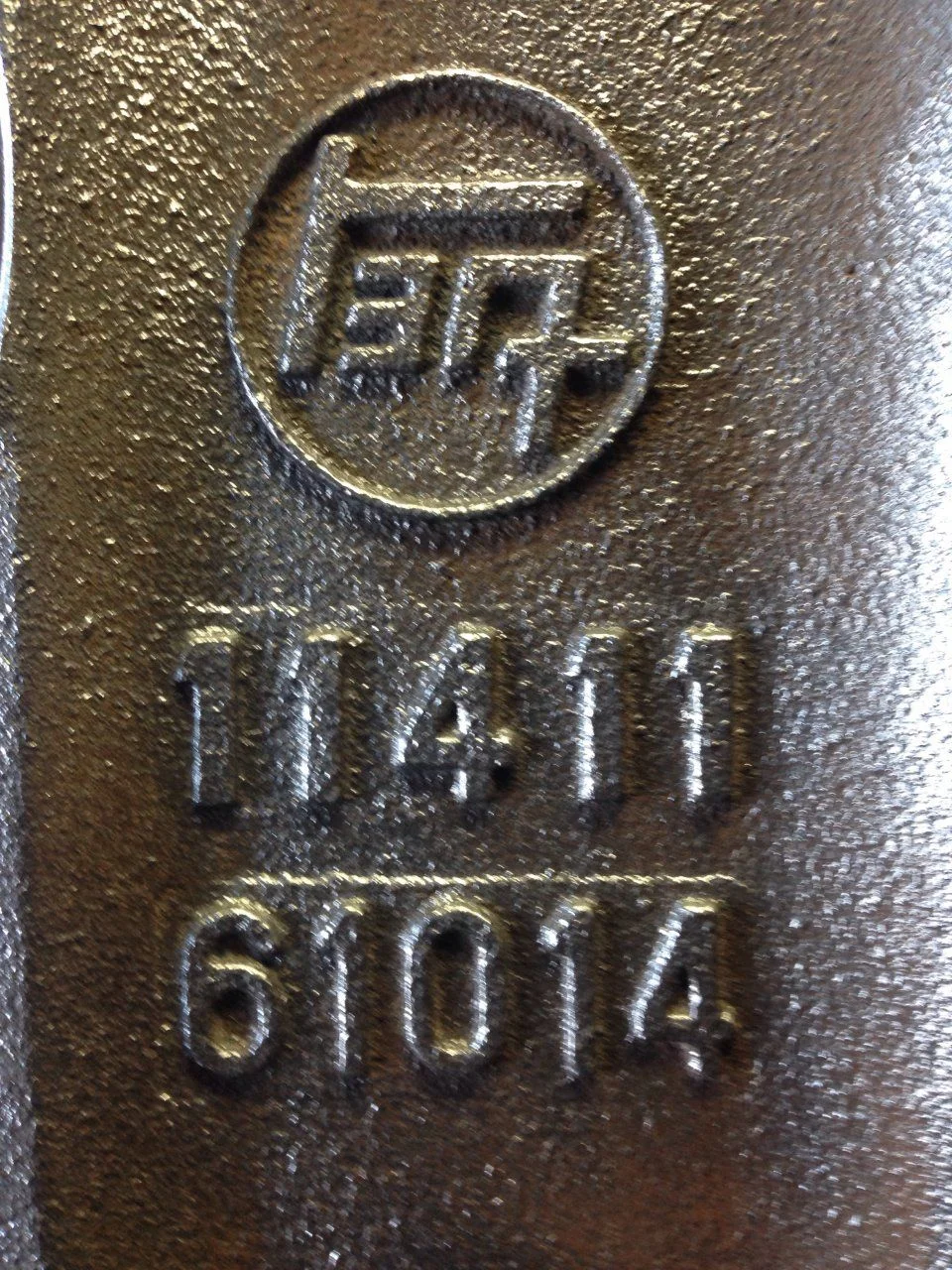

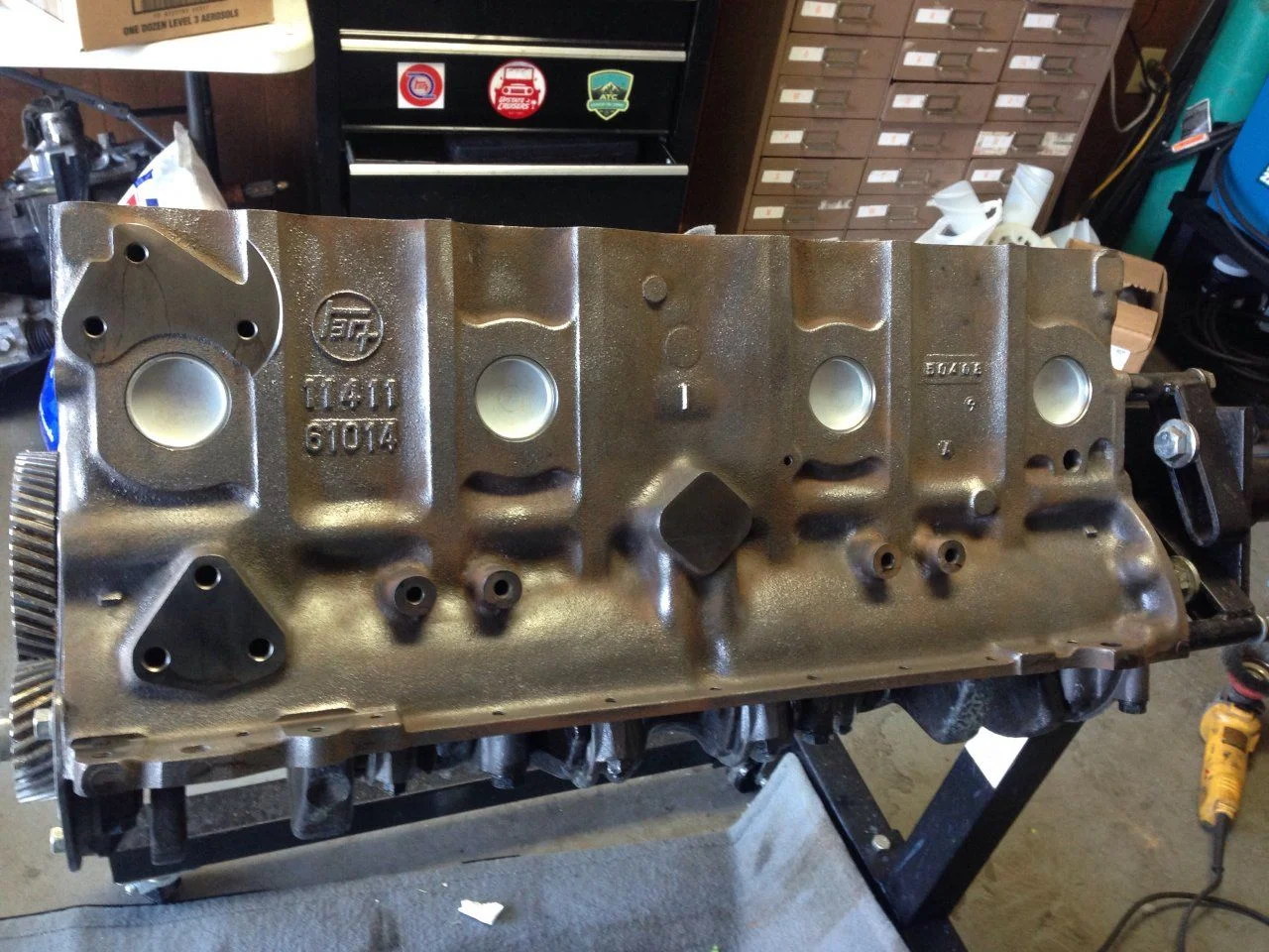

More pictures of the machine work and block needed in this thread. Just sayin'

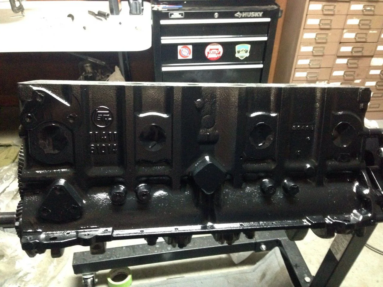

Cleaned and painted the DS of the block today. :)

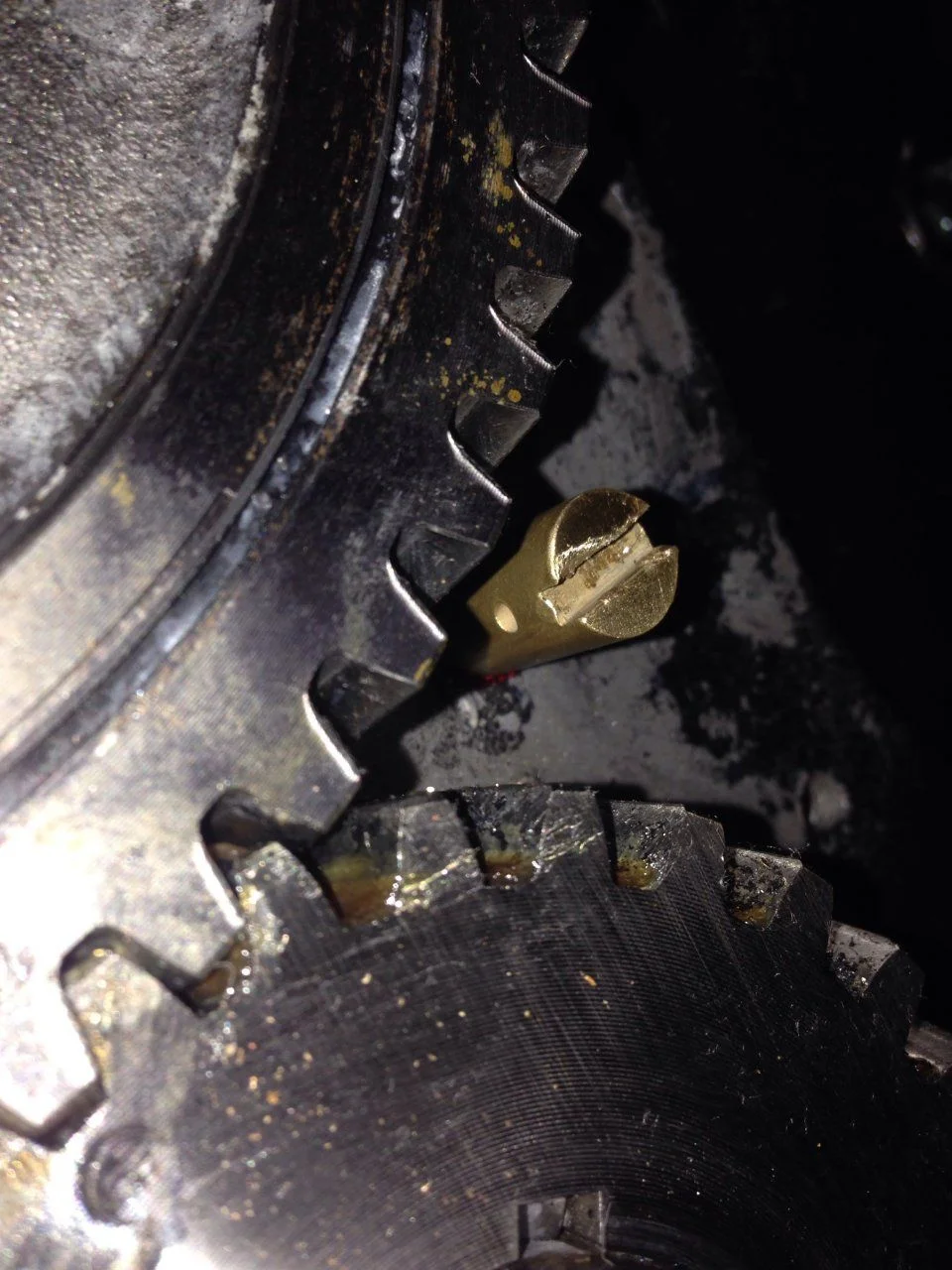

Notice the oiler hole pointed towards where the cam gear and timing gear mesh:
And you were careful to avoid setting the oiler too deep? If too deep the timing plate will be pushed away from the block leading to an aggravating oil leak.

wow, pretty. Never seen so clean a 2F. Keep going
