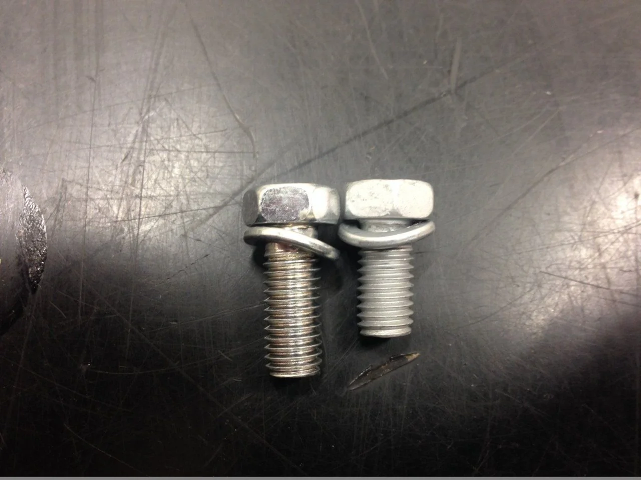

I ordered the following:
90080-11220
90080-11230
90080-11231
90080-11251
90080-11260
Overkill?
Yeah. Oh well. They will go back to Toyota if not used.

I'd go with 90080-11251.
That's a 5T 8x20 with a captive lock washer.
Correct. Definitely the one it seems. I got 14 in today and the remainder backordered.
I'm going to test fit it tonight but it seems to be the winner. 25mm in length.
