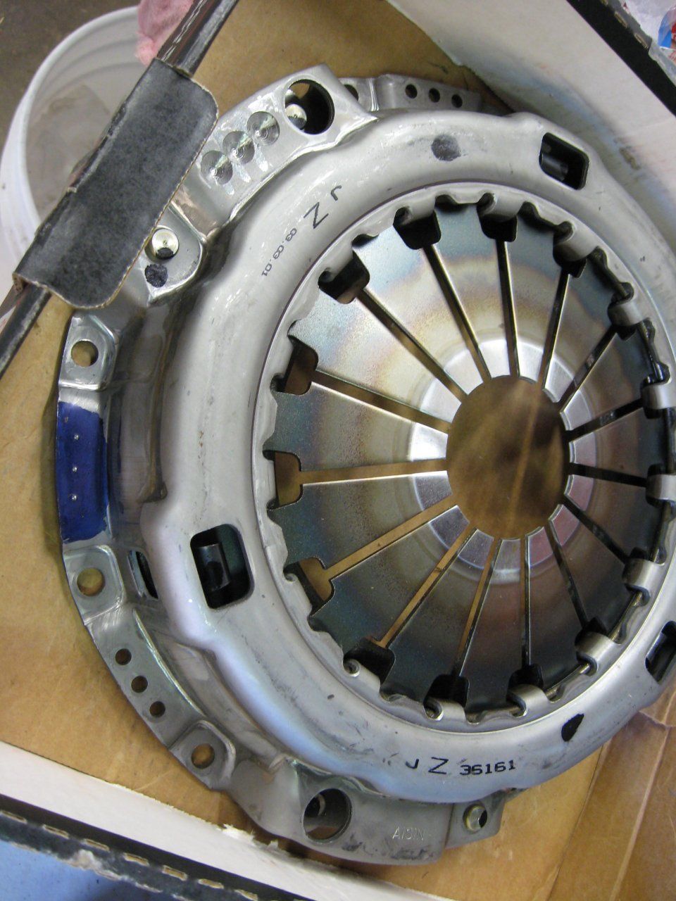

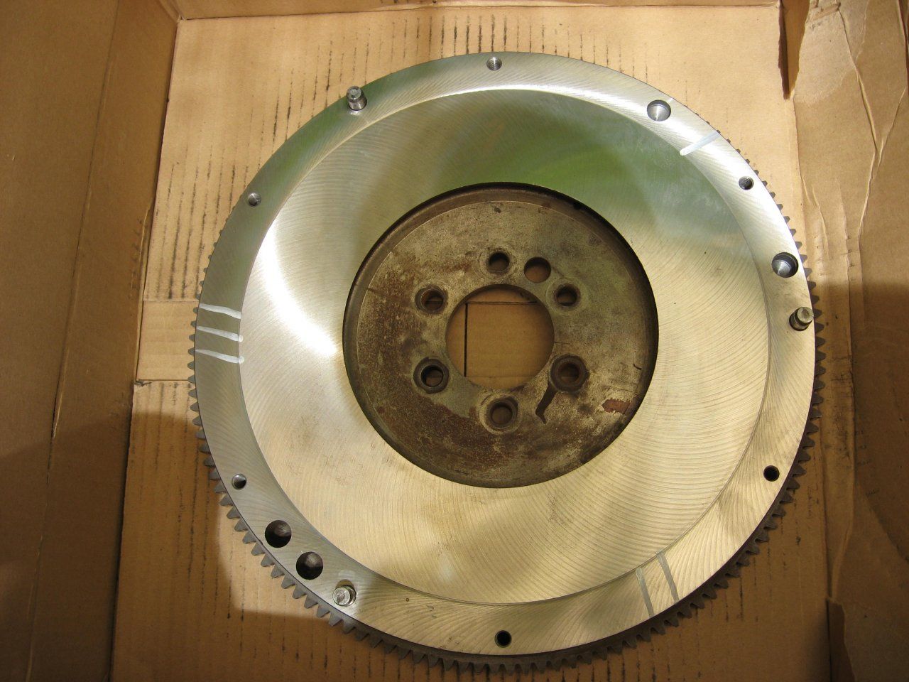

Yes. Same place that machined the FW should be able to do it. They'll balance as a rotating assy, bolted together, then mark how it goes together, so you can reassemble in balanced config. The 3-2-1 hash on the FW correspond to the center-punch dots on the PP.
View attachment 966314 View attachment 966315
Never heard of balancing a pressure plate.
On a tractor anyways.
Can't hurt I guess.
The PP is already well balanced by Aisin.
Balancing the FW, crank, rods & pistons is nice, they are not real close from the factory.
For serviceability, it is preferred to balance parts parts individually. If not, when one part is changed at a later date the balance is off. IOW, zero balance the FW, then attach PP and zero balance again, only drilling metal off the PP. Now the FW is zero balanced and so is the PP. When the release bearing seizes up & saws through the PP, necessitating PP replacement, it will not require rebalancing the FW.

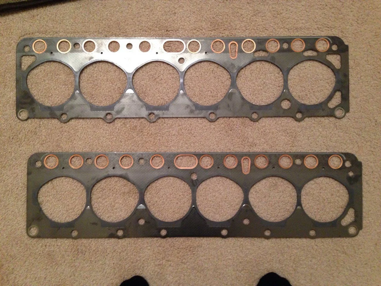

So I've got a part quandary that I never thought I'd have.
I have 2 HG's im able to use. The correct one (11115-61030) doesn't seem to have te correct cut outs for the water jacket holes in the block.
The incorrect one has three out of the 4 water jacket cutouts correct but like the later one closes off the one toward the front of the block on the DS.

Below, early 2F for FJ60 (top) and correct for my build HG on the bottom....
Perplexed by this since it just does not make sense to make a HG and close off a water jacket hole.

Notice they are correctly oriented as if you were looking down on the top of the block from the DS.
Top one only has three out of 4 cut outs for water jacket at all 4 corners.
Bottom one only has 2 out of 4 with one being way too small for cutout on the block.
