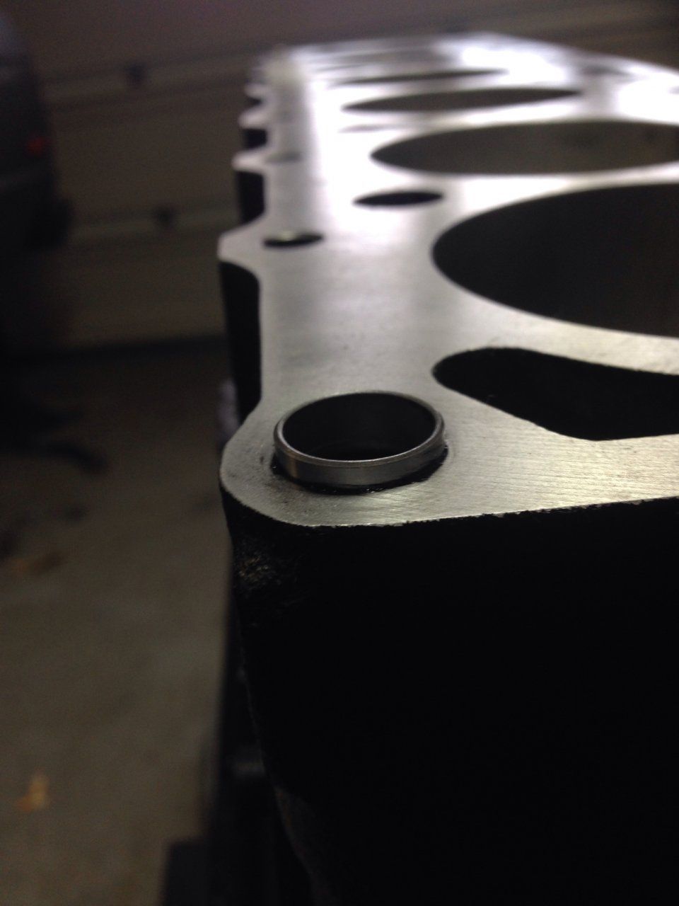

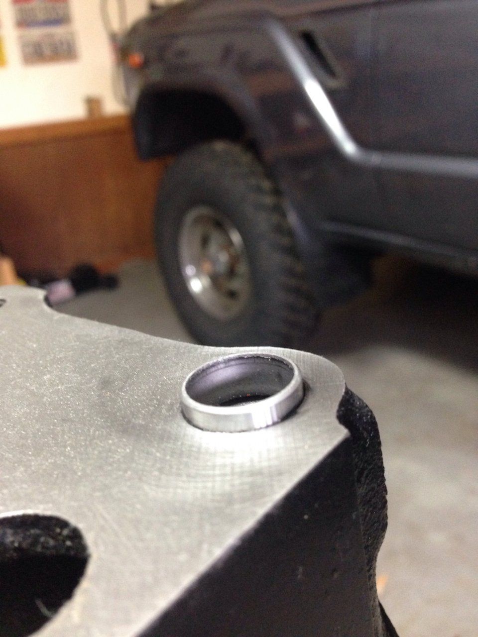

Timing cover seal and dowel pins placed.

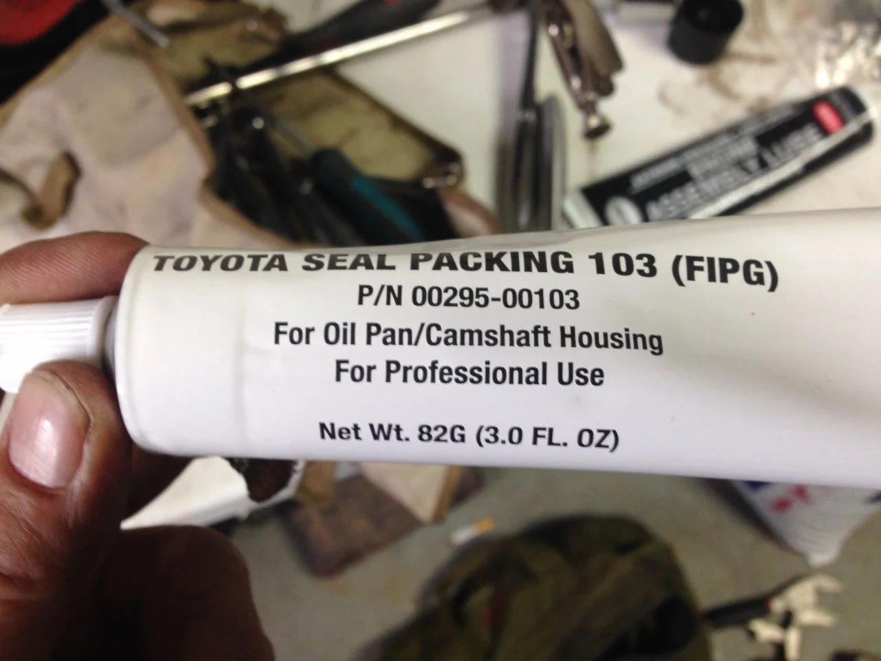

Got the timing cover gasket in place with FIPG. Definitely mandatory on a job like this.
Installed timing cover. Gotta be careful to put the correct length bolts into there they go. Also recommend using a JIS screwdriver on the screws for the cover. Looks nice IMO.
