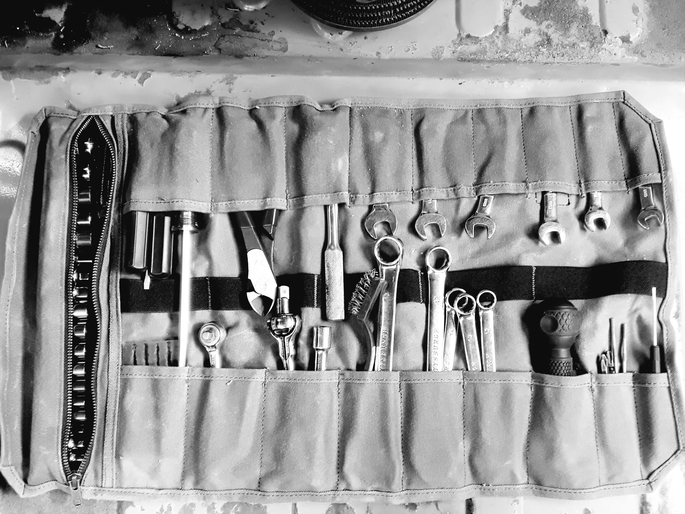

A Readywares tool roll. The socket rail is a custom length HF socket rail. It is so nice to have everything in its own trail-stable spot. Other tools are in the reproduction Teq bag under the driver's seat, and a couple of bags for larger items.
I love the product. I have one as well. Took it to a local embroidery shop and had them upload the logo/writing from an OEM bag and embroider it on to the ready wares roll.
@Grayscale … the ready wares did get discolored over time. I would consider scotch guard or some other stain protector.

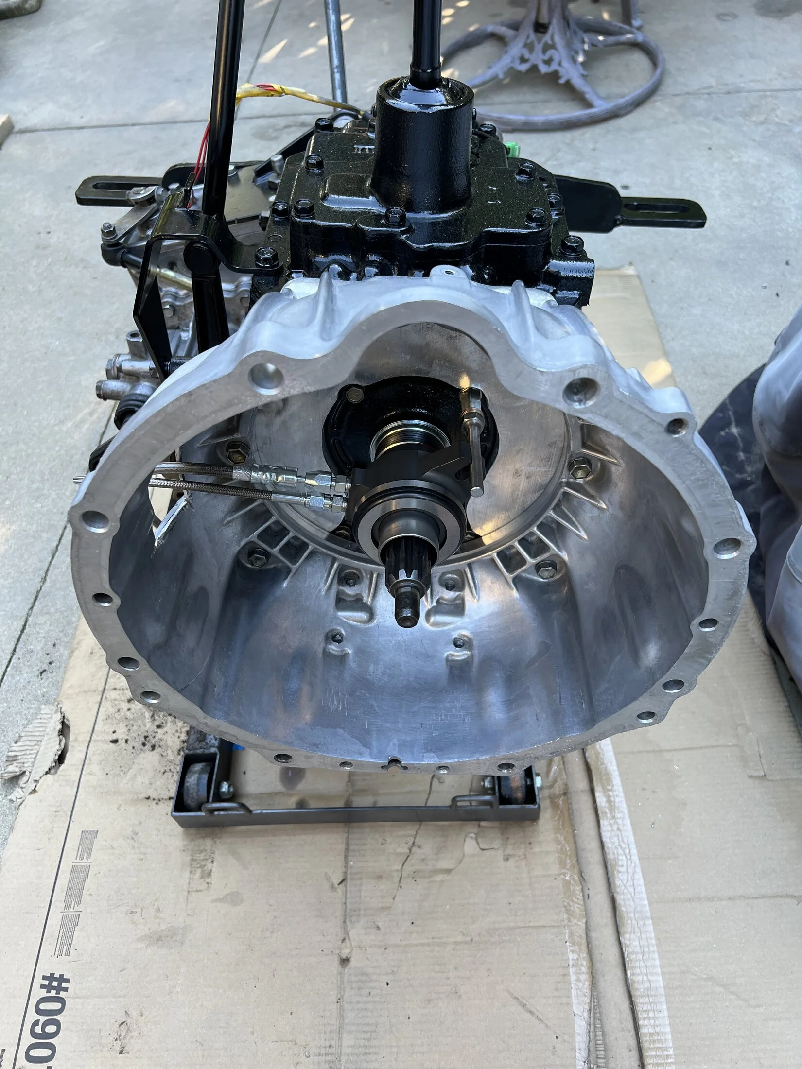

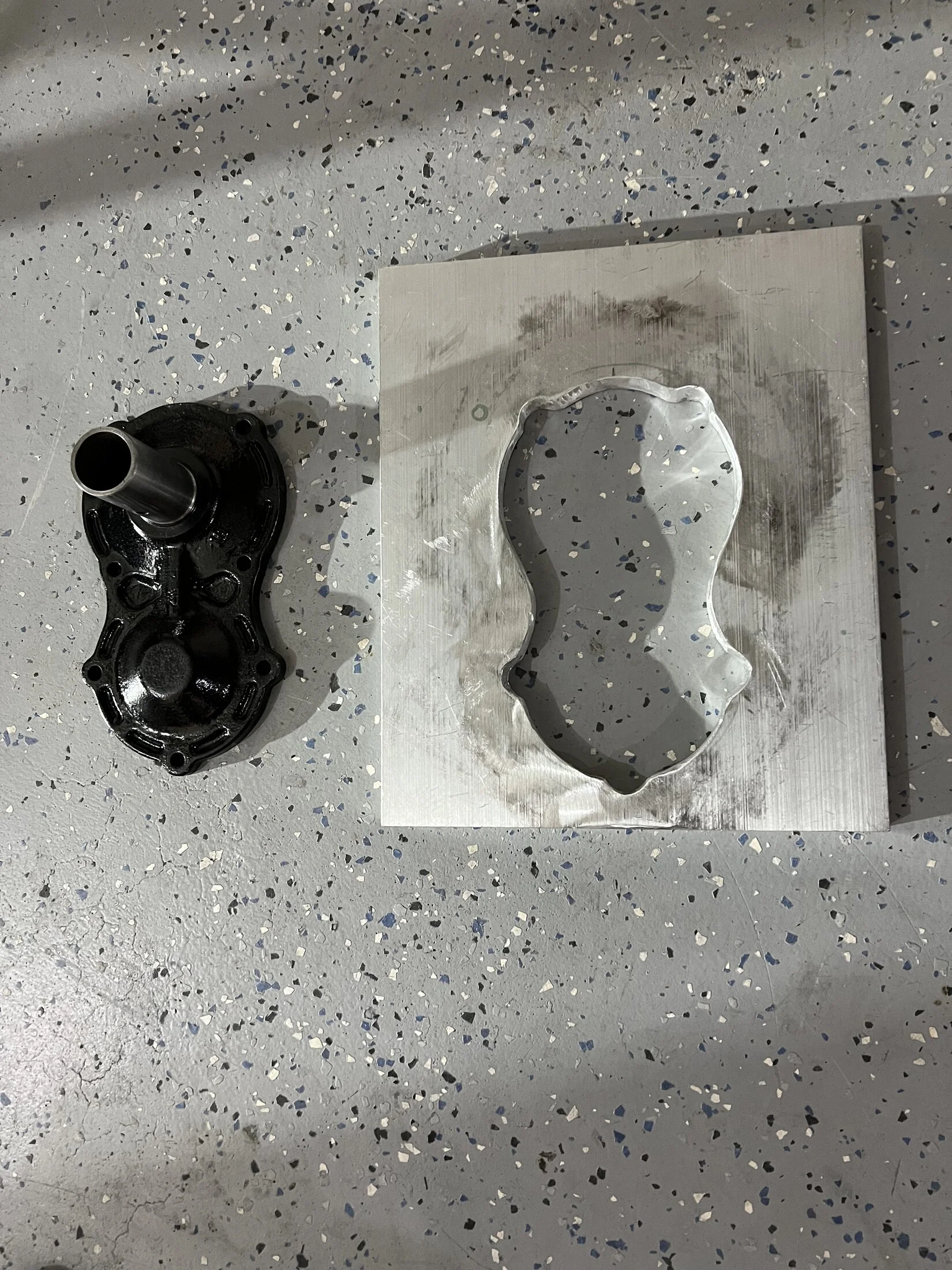

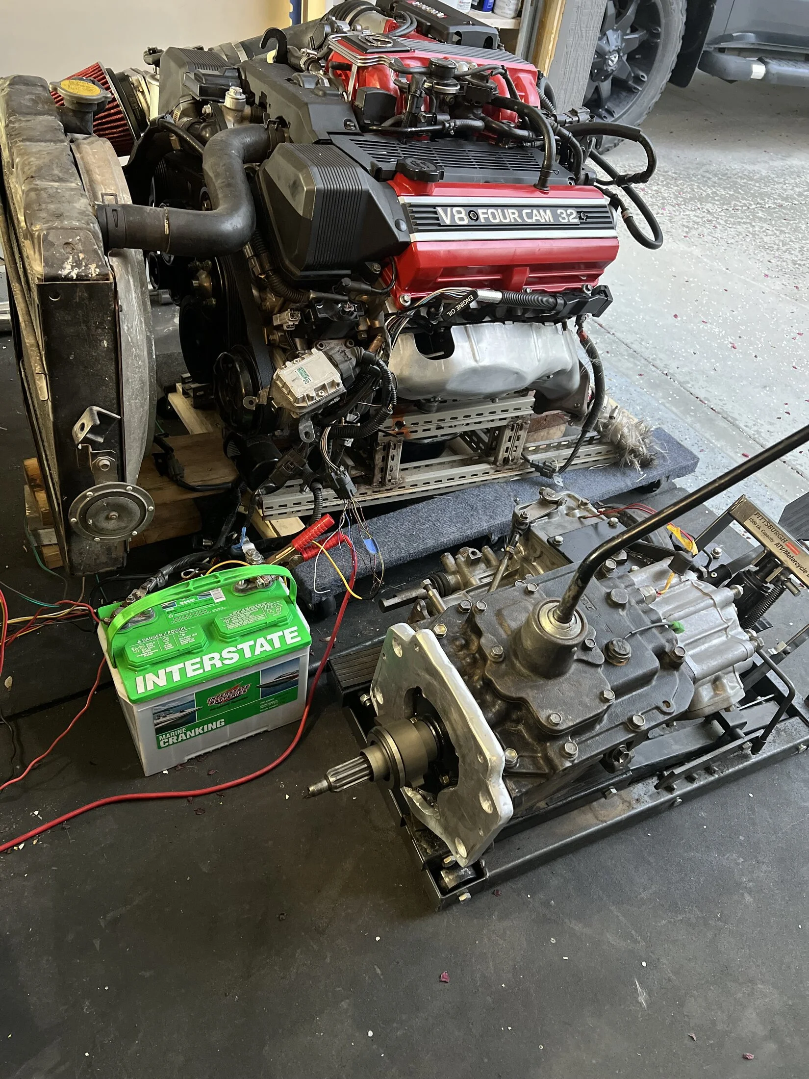

Did you make an adapter plate, use the Dellow bellhousing, or something else? Any pictures?
Clean looking swap. Nice job!
I reached out to Dellow but couldn’t get a commitment of when I can get delivery of their bellhousing. Asked around local shops but they put me out weeks/months since it was a small job for them on the adapter cut out that I drew out.
I ended up cutting my own adapter out of 3/4”aluminum just to test out on the 1UZ bell housing. Since it worked out great, I decided to roll with it.
I didn’t take a lot of pictures but here is what I can find on my phone:

The only Toyota tool that I like is the 2-piece screwdriver. It works better than the OEM brake spoon, iirc. Other Toyota tools are nice, but, I use sockets and box-end wrenches. Of course, I'd love some of the older wood handled screwdrivers, but, Vessel screwdrivers are awesome. I have some 13mm hardware on the truck, and a couple of SAE sockets (I forget what sizes offhand) for hose clamps. My replacement battery cable uses a 5/16-inch bolt, but, I'm not going to carry a 1/2-inch driver, just an adjustable wrench. You'll see a couple of tools for installing a tire plug, and I carry the plugs in the tool roll, the air compressor is in a bag, at present. I carry sandpaper for ignition or electircal, as well as a ball of steel wool, wire brush for cleaning threads, which may have dropped on the driveway or trail. I have a Toyota spark plug wrench that I really should put to use, but, the 13/16 from HF has the rubber cushion in the socket well. Nothing beats that swivel head 1/4-inch ratchet handle for rapid assembly / disassembly, and I carry adapters so I can turn 3/8-inch sockets as well. A breaker bar, stored in a reproduction tool bag, increases the range of the socket set, yet, I typically just use it for oil / gear oil changes, and major service.
