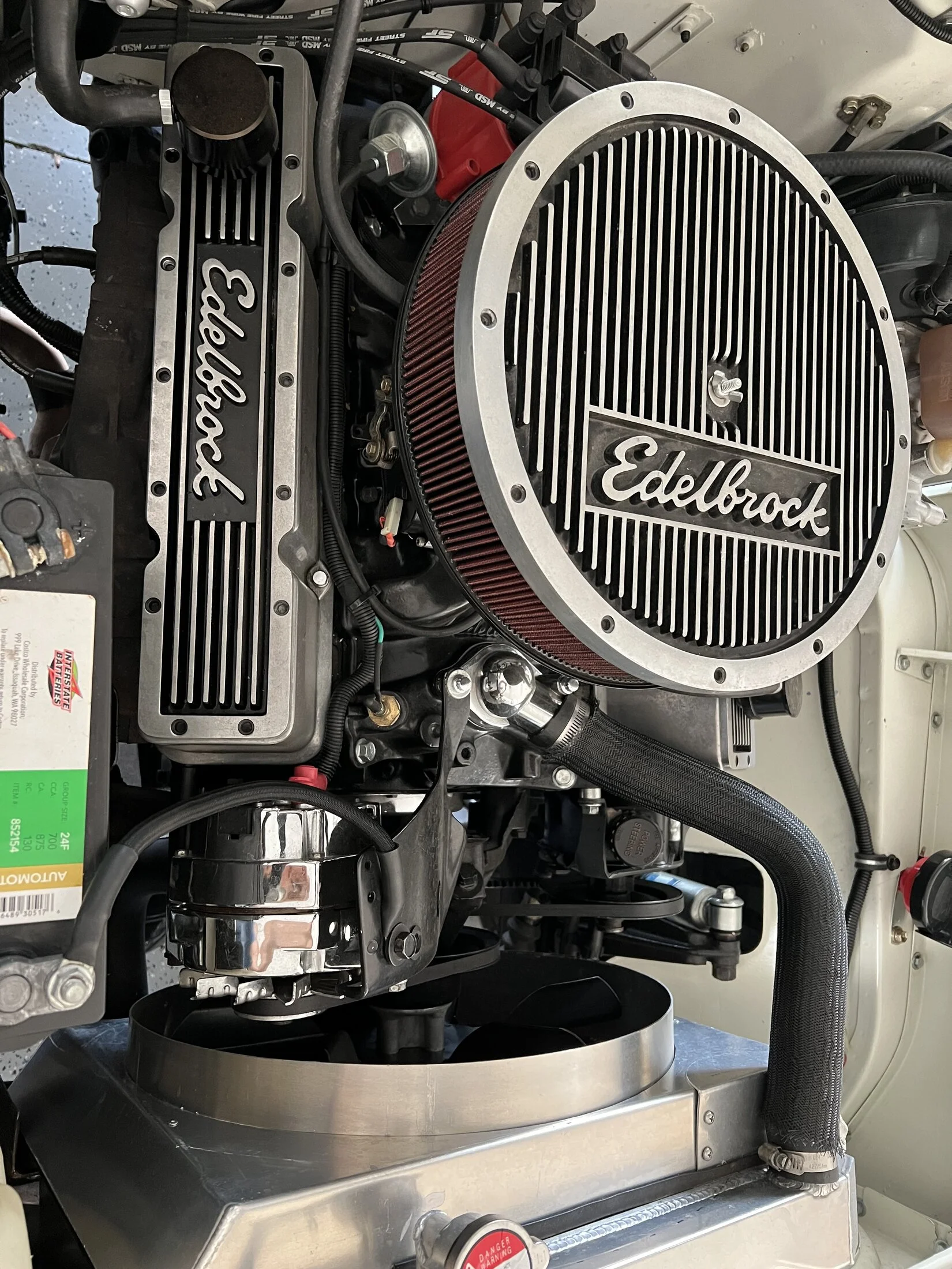

I bought it with the 5.7 SBC. I spent a lot of time tuning and threw bunch of new parts to it. It ran great but I was not satisfied with it plus I want to put Toyota DNA back in it. I didn’t really mind the SBC engine but could stand opening a hood on a Toyota and see it in the engine bay.
Here’s the before with SBC:

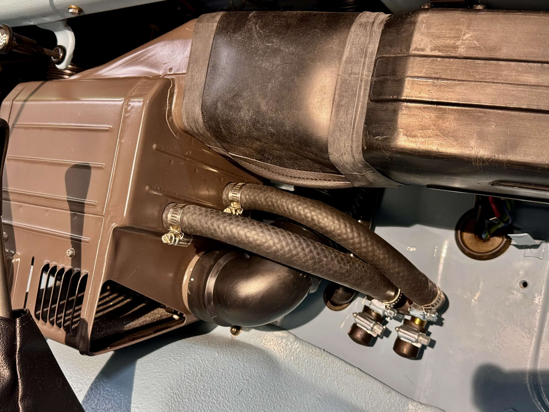

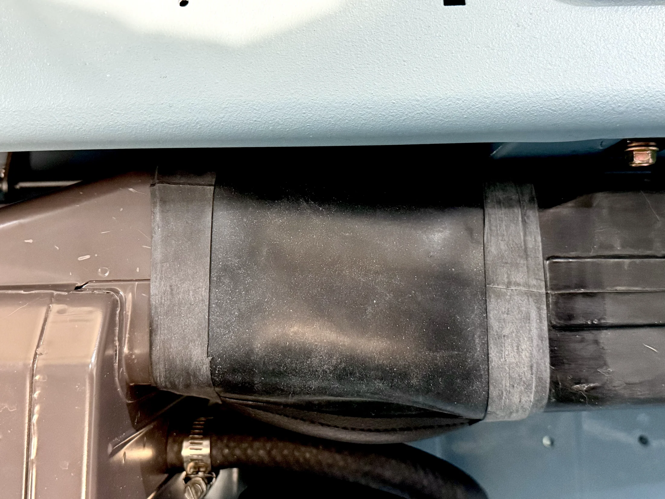

put on my aftermarket heater duct/ hose - what a nightmare. the fit was poor and frankly, I should have just made my own but since I had it, I figured I'd make it work.

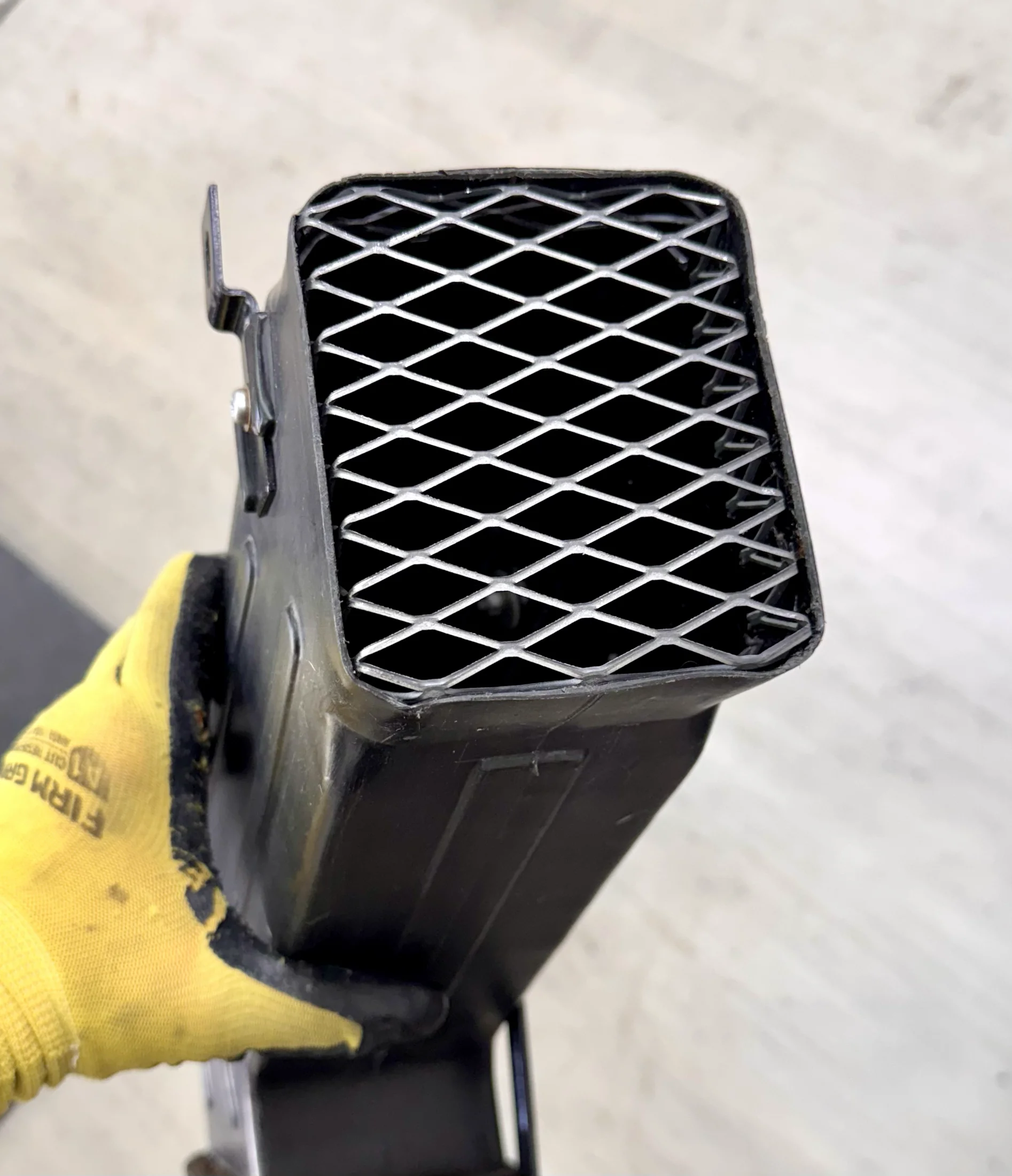

First the hose was a little too big to be secure on the plastic duct (or maybe my old duct was old and loose?) I made a mesh insert to hold the form so once I placed the tube, I could at least secure it somehow. I tried big zip ties, velcro straps etc to hold the tube secure but nothing really was working.The tube would bunch up and fold over etc. I ended up cutting some sections of 4" inner tube to use as rubber bands. Like I said, nightmare: no room to work under the dash, everything was sliding around and bunching up. Probably took 3-4 hours to get it all on and straight. It's not too bad from the front but it's a little more wrinkly in the back than I'd like but should work until I find a better solution.
