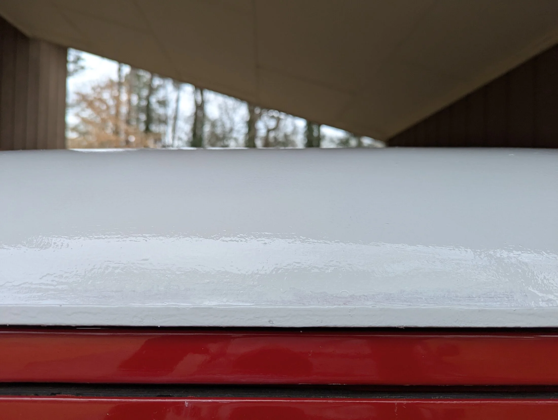

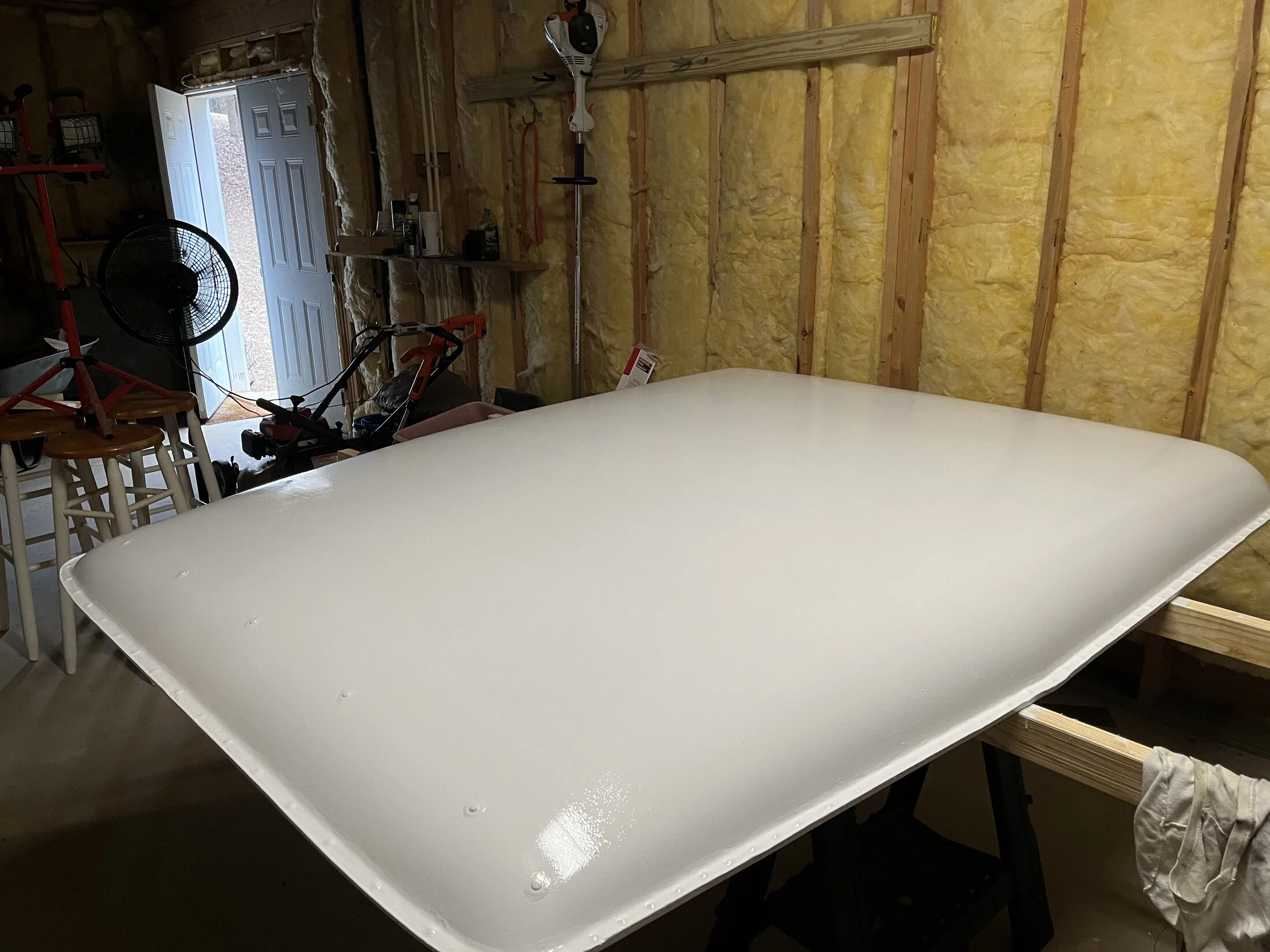

After prep I used a roller then a paint brush for the tight spots.
One quart will do 2.5 coats I would say. Let dry for 24 hrs. in between.
The paint is "self leveling" and looks great fully cured.
Its not perfect, but for the cost and effort the results are impressive IMOP.

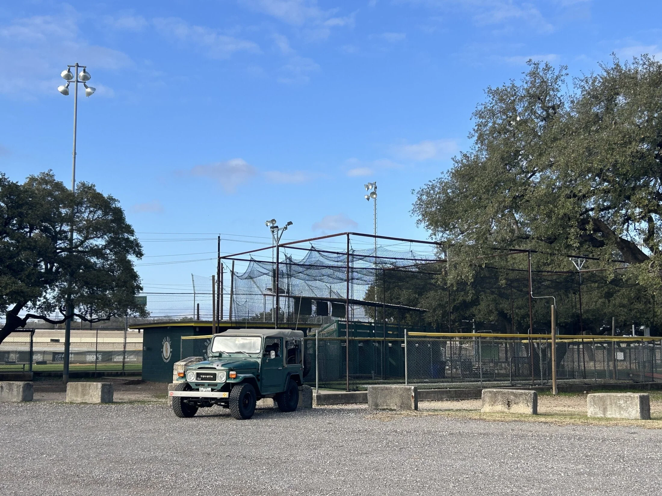

Been driving the hell out of her. Batting cage with the boy, not one other soul at the entire complex.

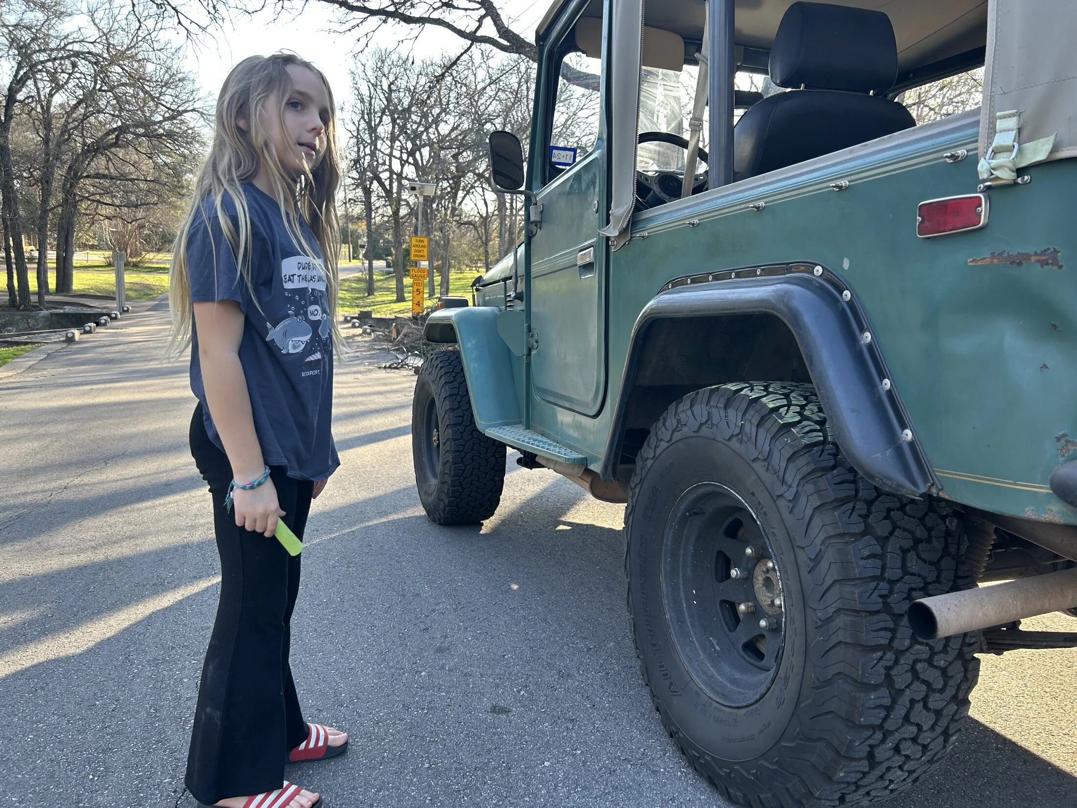

And chalk testing with the daughter.
^^pretty freeborn rig!
What wheels are those? They look like stock 15" steelies but wider with 12.5 tires??

For the record…. I did the same thing 😎

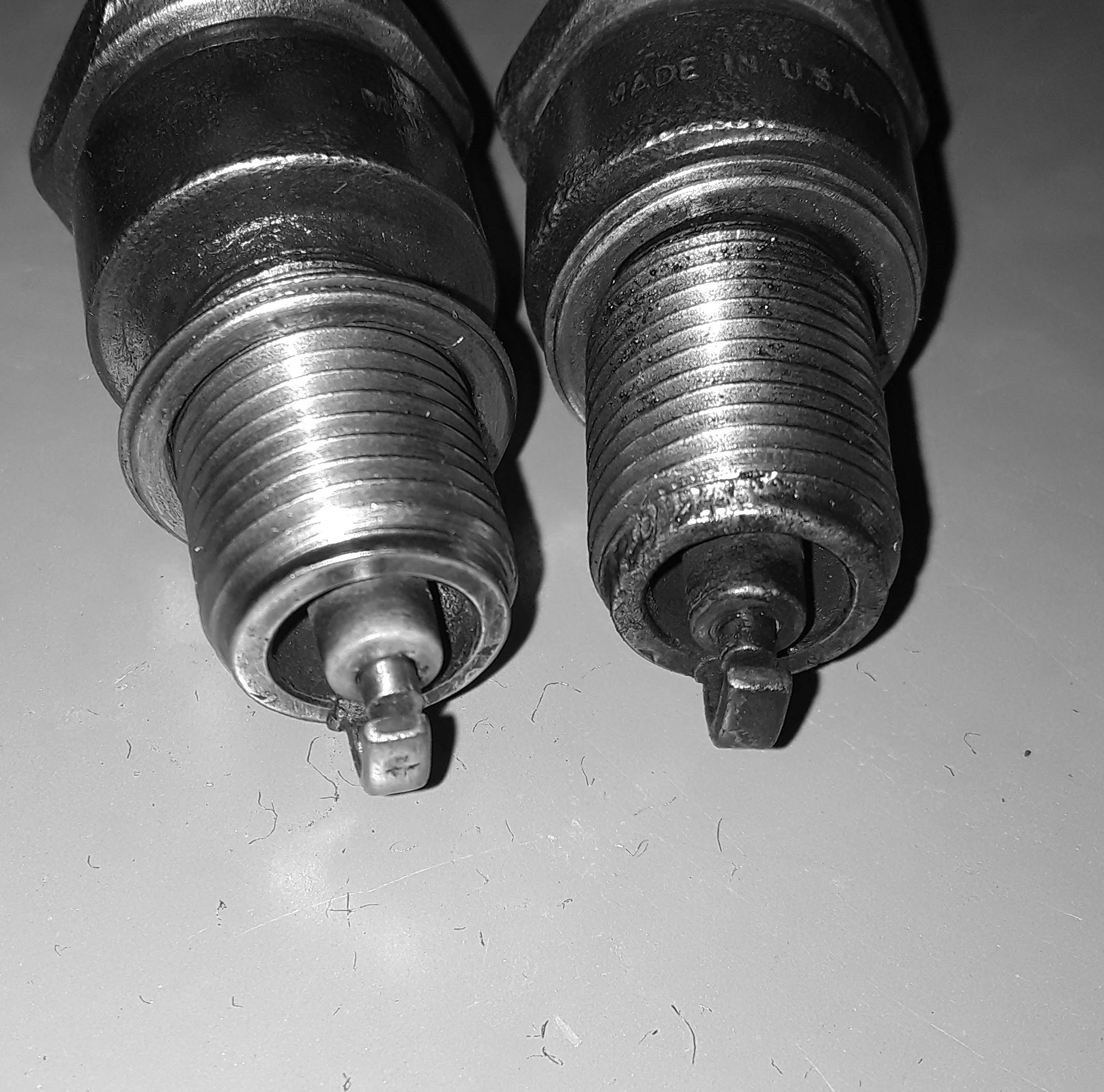

These are the plugs that came with the '75 2F motor currently in use. It has been on the road, and trail, since '20. I have like three sets of spark plugs, so they get service, then cleaned (left) and shelved. I'll let you guess what happened to the threaded portion for the one on the right...

You recommended this for mine over a year ago, the stuff goes on easy and even, levels great and "skins" quickly so that bugs and debris can be flicked off after 24 hours.

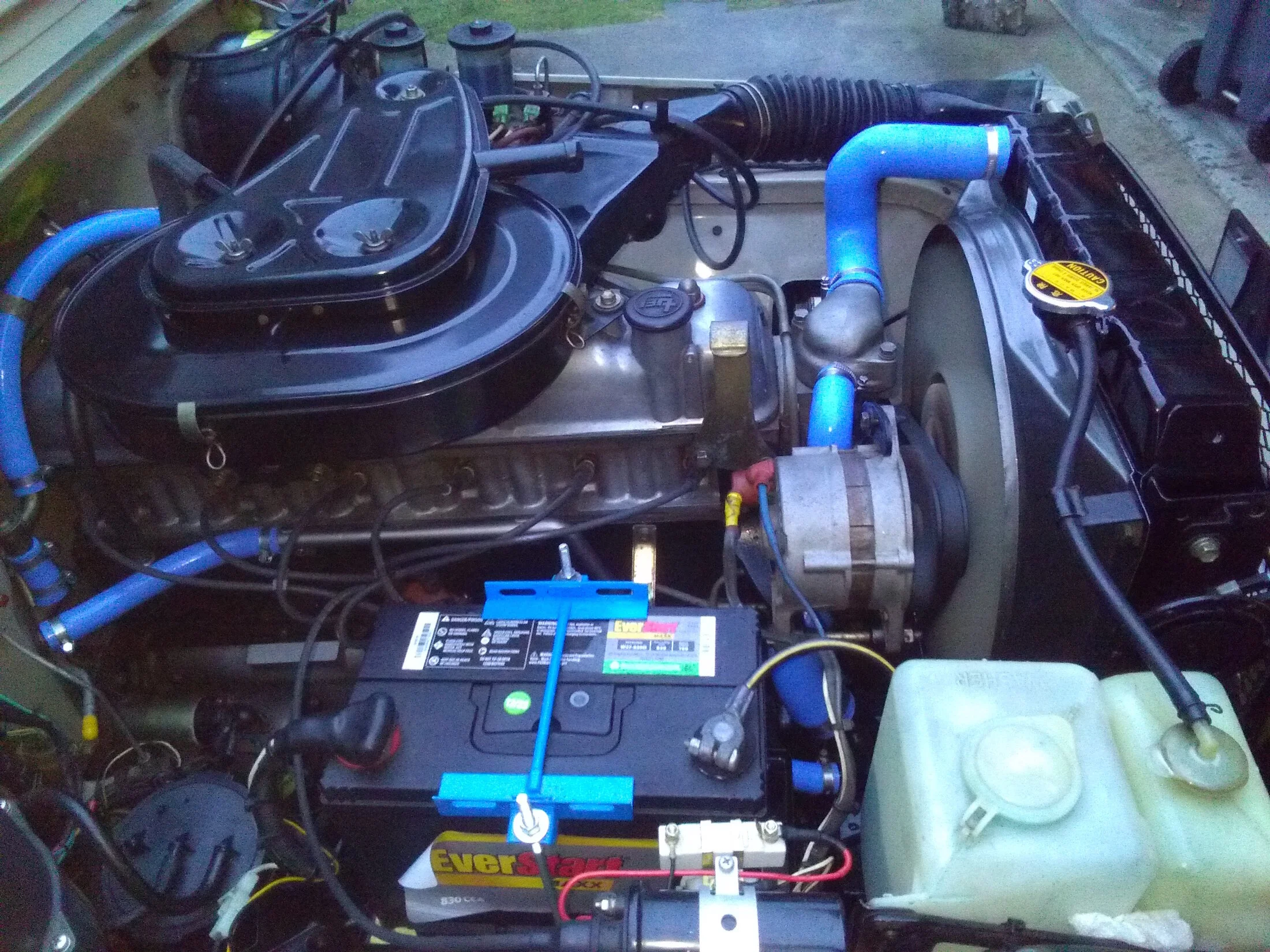

I finished up the OEM radiator install over the weekend too. I was going to go straight Mr. T. with the hoses but I've had (ancient) Goodyear Hi-Miler heater lines for years and have gotten used to the color so...
It's a super-blingy Chinese silicone set off Ebay that I will probably regret but there it is. The seller was super helpful and made up a couple of one meter lengths of the matching 5/8" (16mm) heater line for just a few extra bucks. I drained 4 gallons from the block/system and 4 fresh gallons of roughly 60/40 went back in without issue. I used some decent SS clamps from HPS but there's lots of them out there that are just as good or better. No issues. No leaks. No Drama. :meh:
I rarely venture far from my purist's roots despite admiring all the amazing mods folks here do so this is a bit out of my comfort zone. The funny thing is: Blue is definitely not my favorite color.

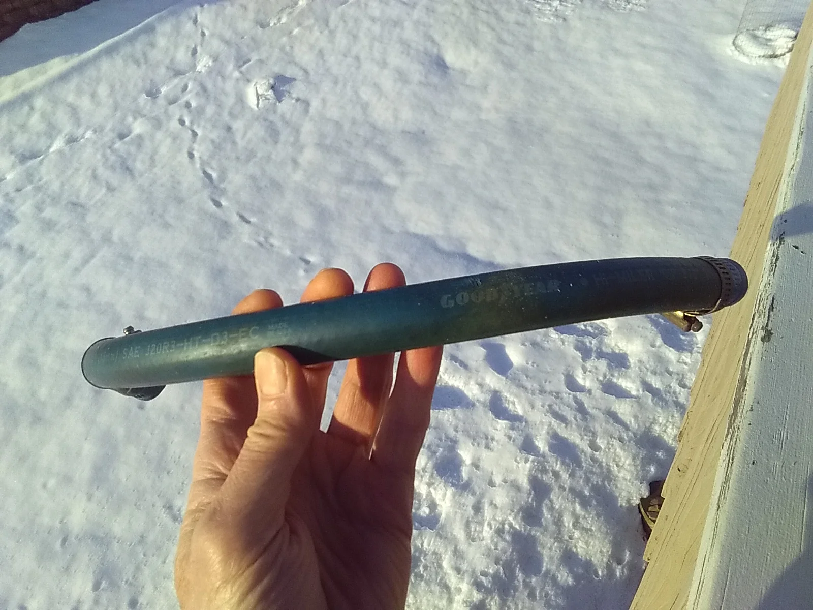

The last piece of Hi-Miler headed for the bin after almost 30 years.

The spark plug, which is pitted (right, below), this one sports a layer of rust-pitting on the face of the thread. The 2F-type air cleaner assemblies don't protect the intake from water, and this one must have been outside for a while. It is amazing that the engine is even on the road after rusting from the inside!
