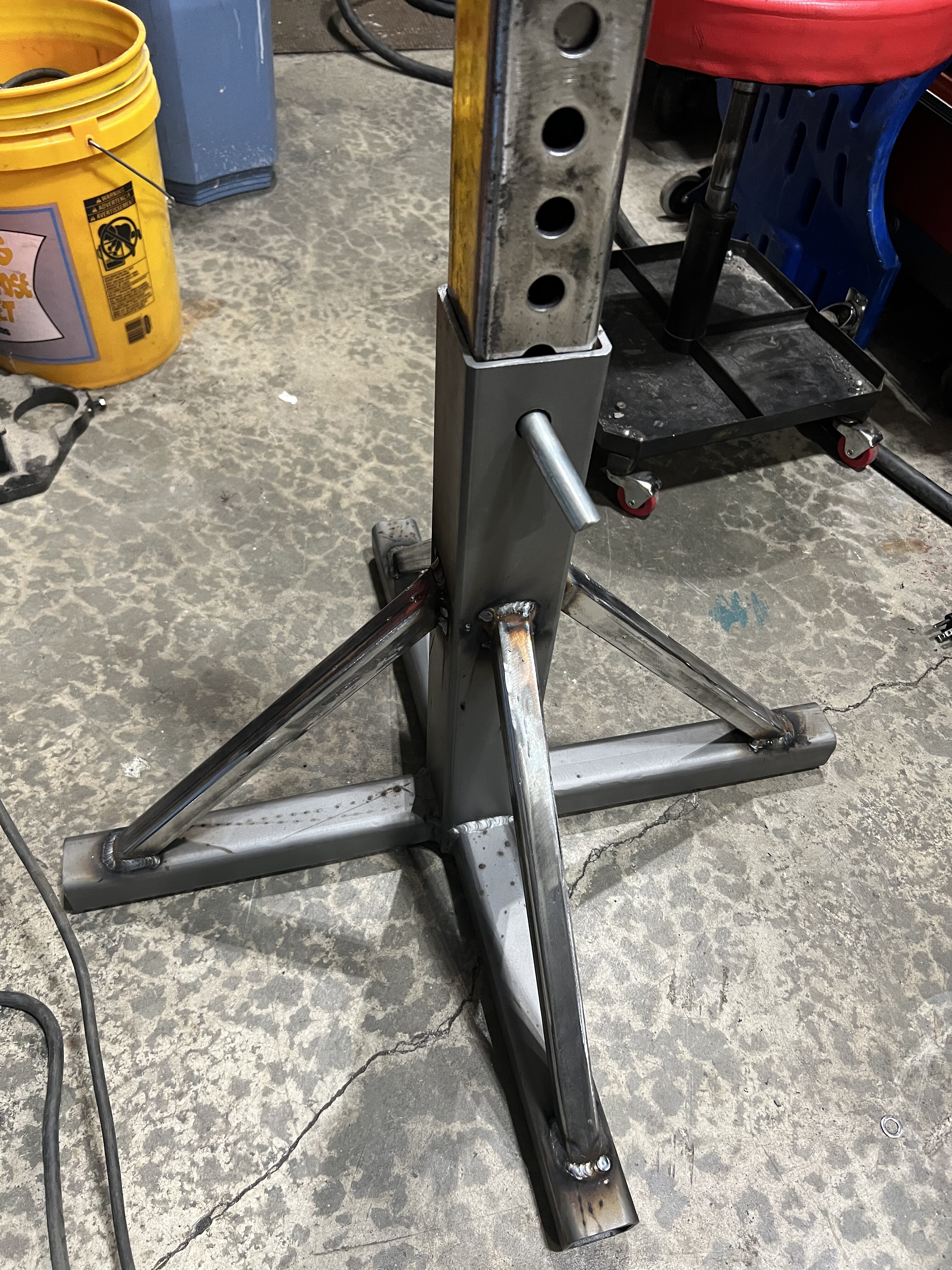

I thought he was adding the “triangle support pieces made from bed frames” to be the gussets. I may have read it wrong.
That's the way I understood it also.
Possibly... but bed frame wouldn't meet my overkill standards and seems a bit light to support 5000 lbs on one stand.
Gonna add some leveling feet or leave it?
They sit pretty flat on the concrete. I don't think I'll need them.
Yes, the triangle support will be added shortly. I think the supports are just for lateral movement and the 5000 lb support is largely straight down. Anyone else have an opinion on whether or not the angle iron from a bed will be under kill?
Yeah, I would definitely NOT use flimsy angle from a bed frame. I wouldn't even remotely consider it. I think "kill" was your operative word there.

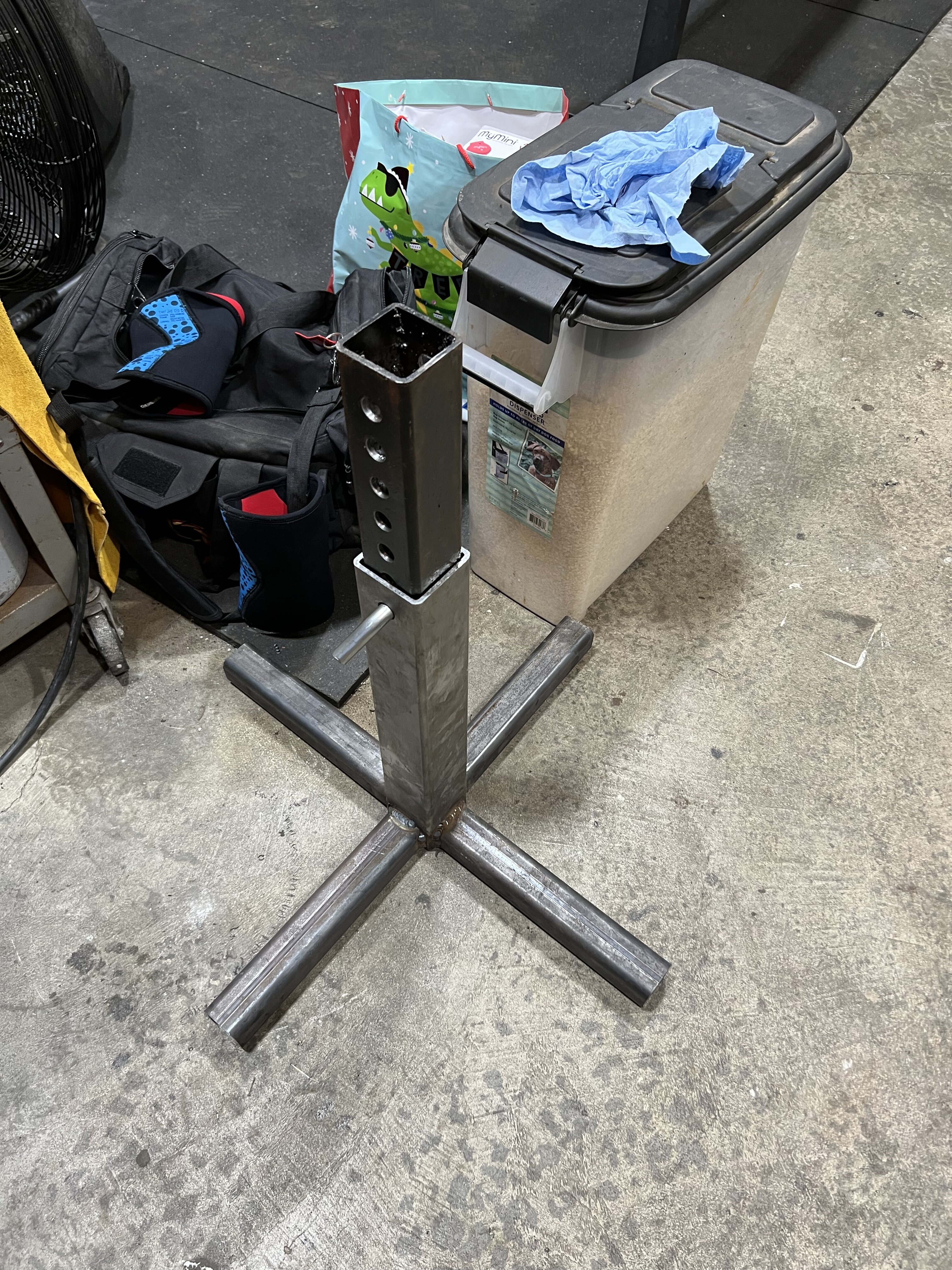

This is a little late but you have used your strongest material in the area requiring the least strength, i.e, the very bottom.
The beefy and no doubt expensive heavy wall tubing would make excellent struts angled from closer to the top of the column to the ground,
where they could then be tied to the center column with cheap flat stock which would only ever be under tension. For the same cash outlay you
would now have nearly indestructible trusses supporting your load. What you built is similar to a table base with the weight kept low for ballast.
I'll admit that it is difficult to accurately gauge the thickness of your tubes from the photos, so apologies if my statements about them are in error.
While I'm at it, thin wall may not be the best choice for the center column but would probably be OK if it was supported by the angled heavy wall.
As you have done it though, all the loads converge where you have attached the base tubes, weakening an already somewhat weak material.
Prices being what they are, I would have used the same center tube size for the whole structure, increasing strength and probably saving money.

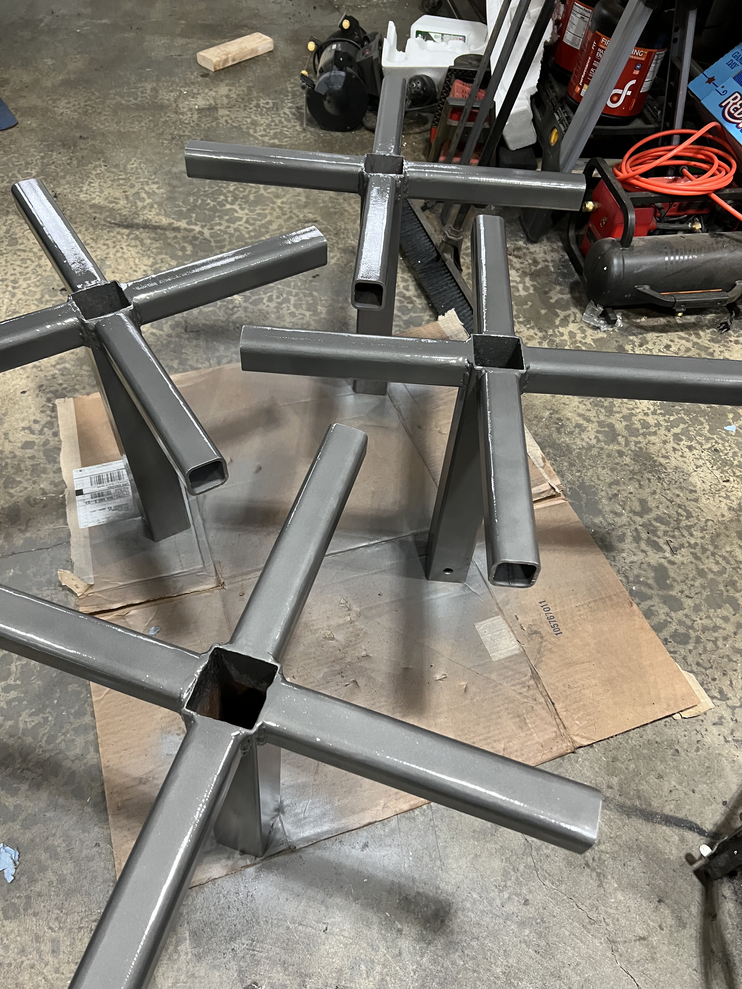

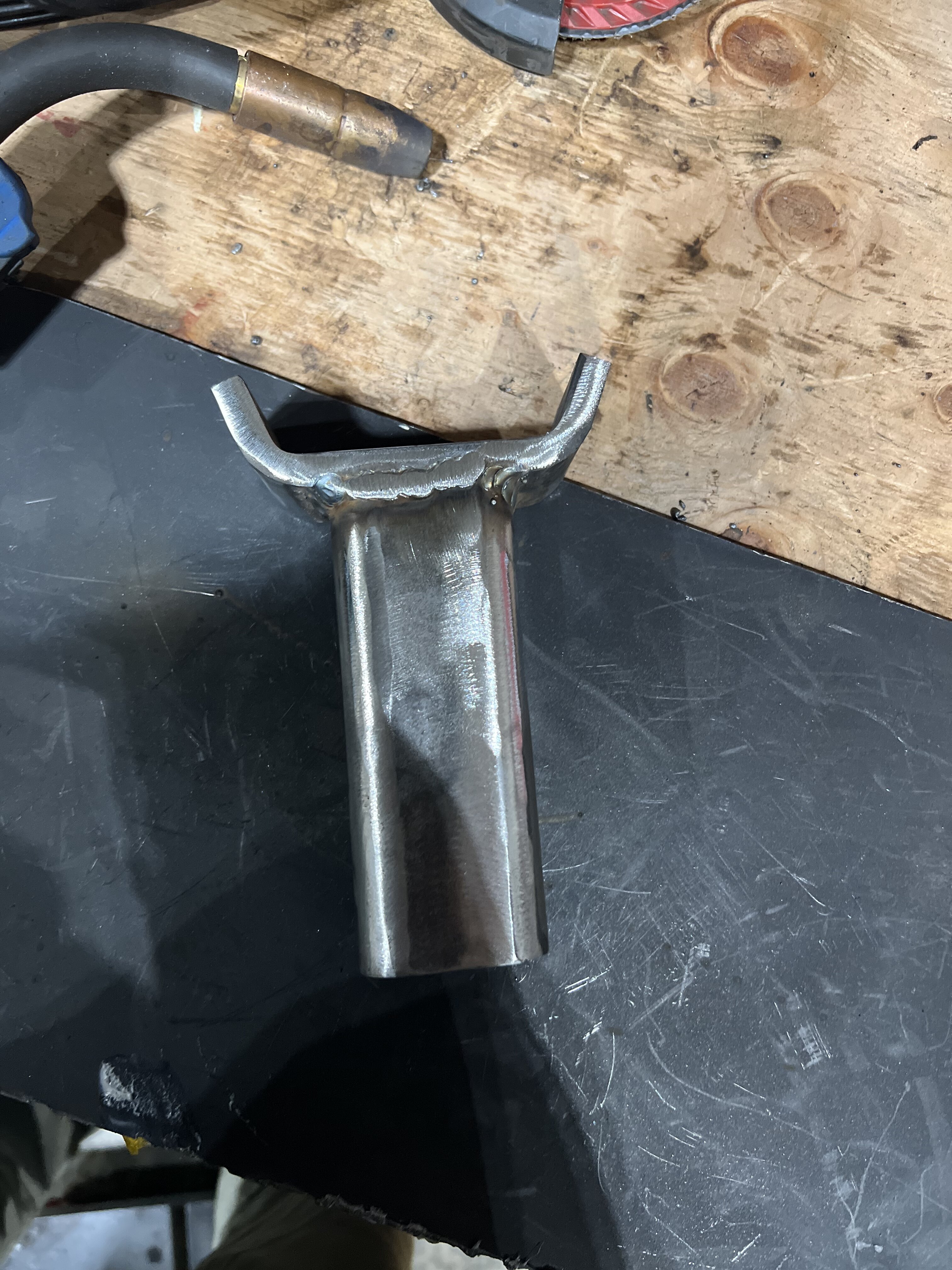

You make a lot of good points @flee . Unfortunately, the bells been rung. I think all of the material is 0.120. After the comments from @bikersmurf and @suzuguru , I decide to go buy some nicer, stronger steel. I decided that square was better for cutting angles than angle iron, plus, stronger. I still need to clean up the welds and apply some paint:
With all the heat cycles, I'm not sitting as flat as I was so I'll add some rubber feet to keep it level.
