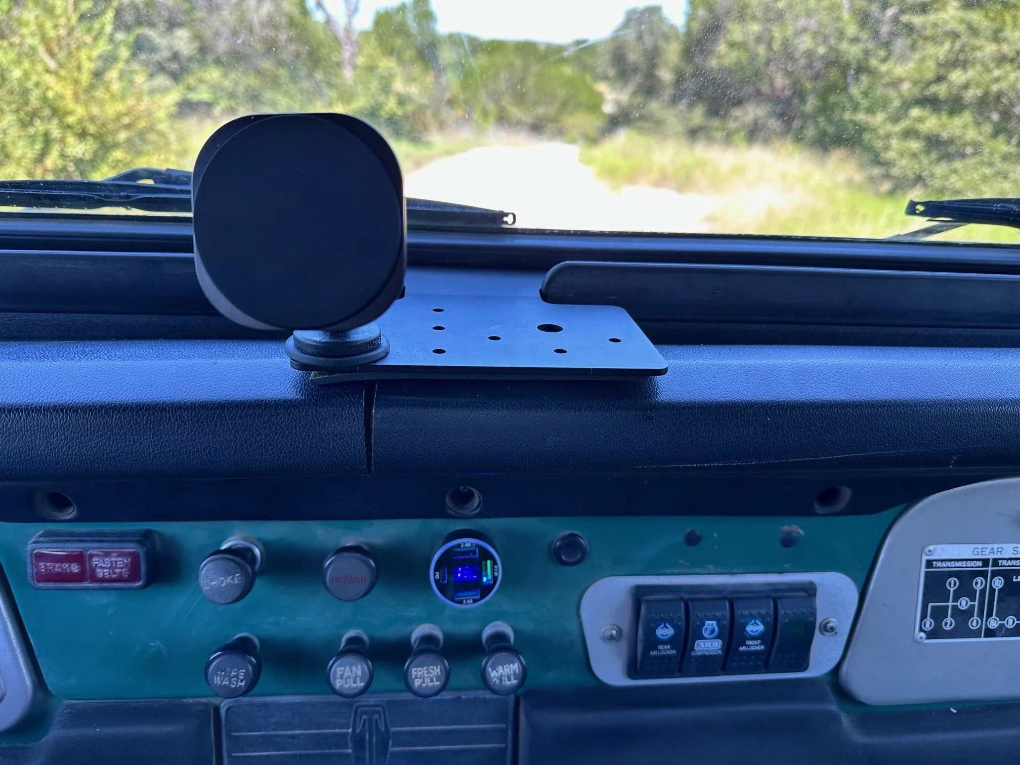

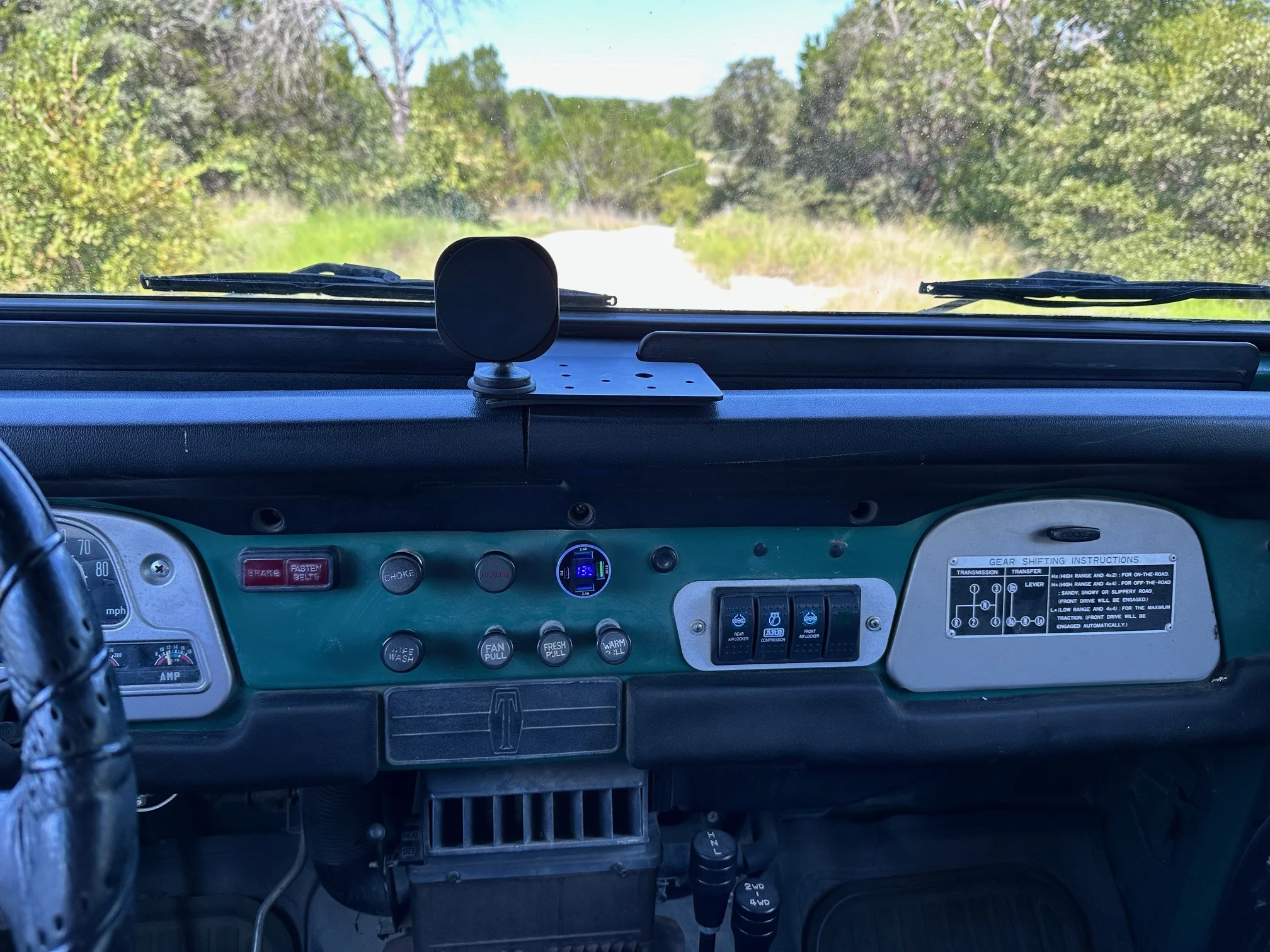

Gamiviti dash accessory mount installed. I had been looking for a way to mount my phone on my dash, because my 20-year-old GPS that is mounted up next to the rear-view mirror is slowly sh!tting the bed. Gamiviti just came out with this dash mount, and it is perfect for me - made of heavy steel, nice powder coating, room for lots of stuff. It puts my phone at the perfect height; high enough to see it easily, not so high as to be in the way of my forward road vision. Reasonably priced for the quality of manufacture. Would definitely reccomend.

Thanks for the mount tip @1911 ! Simple design, uses existing bolt holes, has a rubber pad underneath to protect the dash. Decent path to run hidden wiring. Looks like a winner to me. May have to pull the trigger on this!

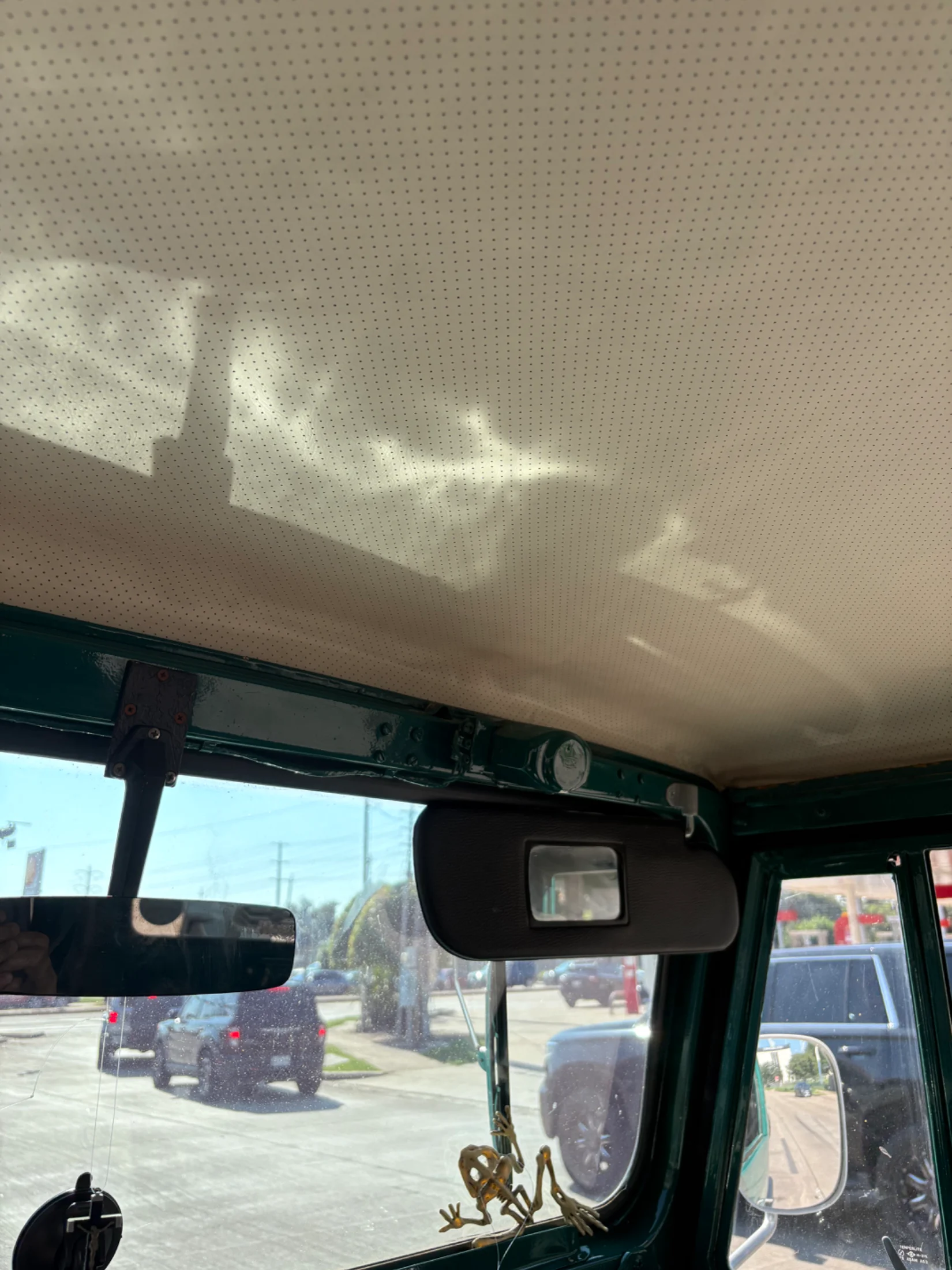

Great job done with the headliner @mef0629 !
Did you install it by yourself or brought it to a specialised shop?
PS. Heard that you cannot just glue it to the roof: a special tool is needed (like with the VW Beatle?), that even many shops don't have it...

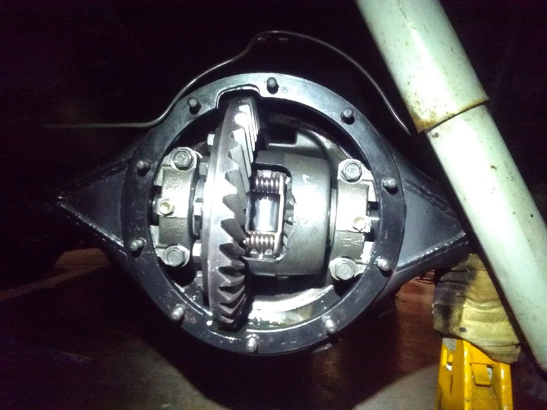

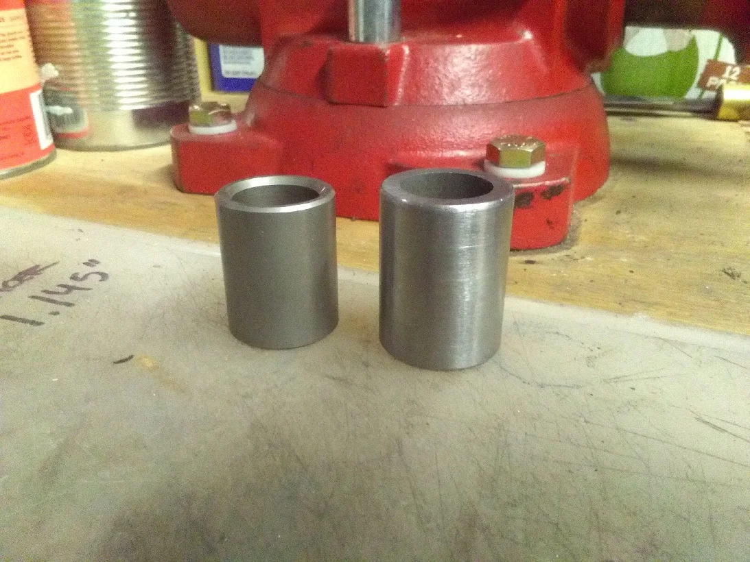

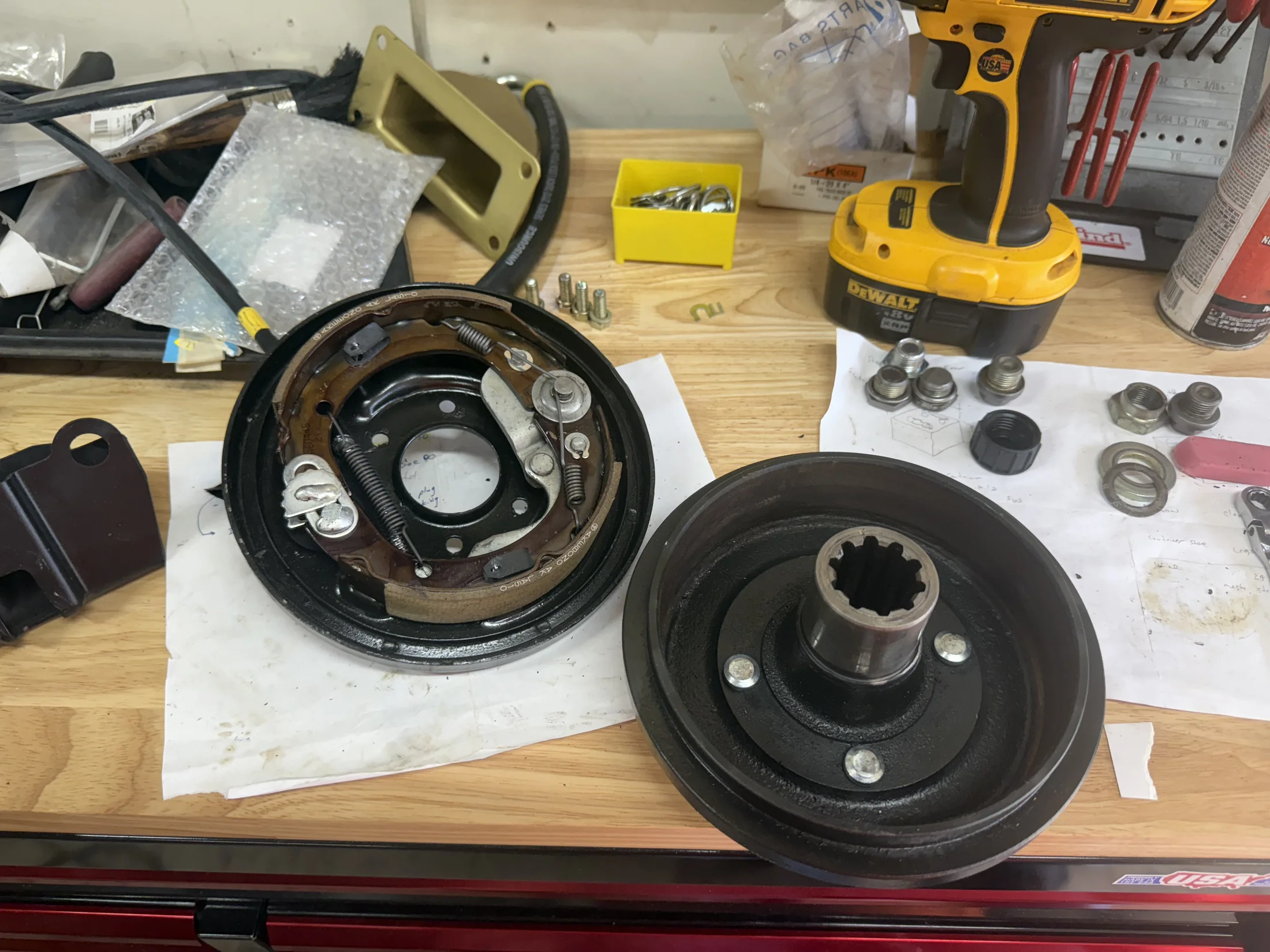

I wasn't happy with the way the supplied spacer fit. Lots of vertical space that left the button end of the axles only partially supported and more than double the end thrust allowable by Toyota. I had an old aftermarket spacer from @Downey but it was too large possibly due to manufacturing changes throughout the years. (Auburn makes these limited slips in house.)
After talking with Auburn a few times I decided to have this guy mill the oversized spacer down to what I considered acceptable. It's tough to get perfect measurements with feeler gauges until everything is fitted. I ended up deciding to reduce the overall height by an additional 0.010" which meant a bit of ham-fisted filing to rebreak the edges on one end. Not pretty but it will serve. Hopefully I've left enough clearance for heat expansion. I guess we'll find out in a few weeks when the 40 goes back on the road. At least I'm happy with the thrust clearances now.

I love my auburns...been running them for decades, and they're great for what I use them for.

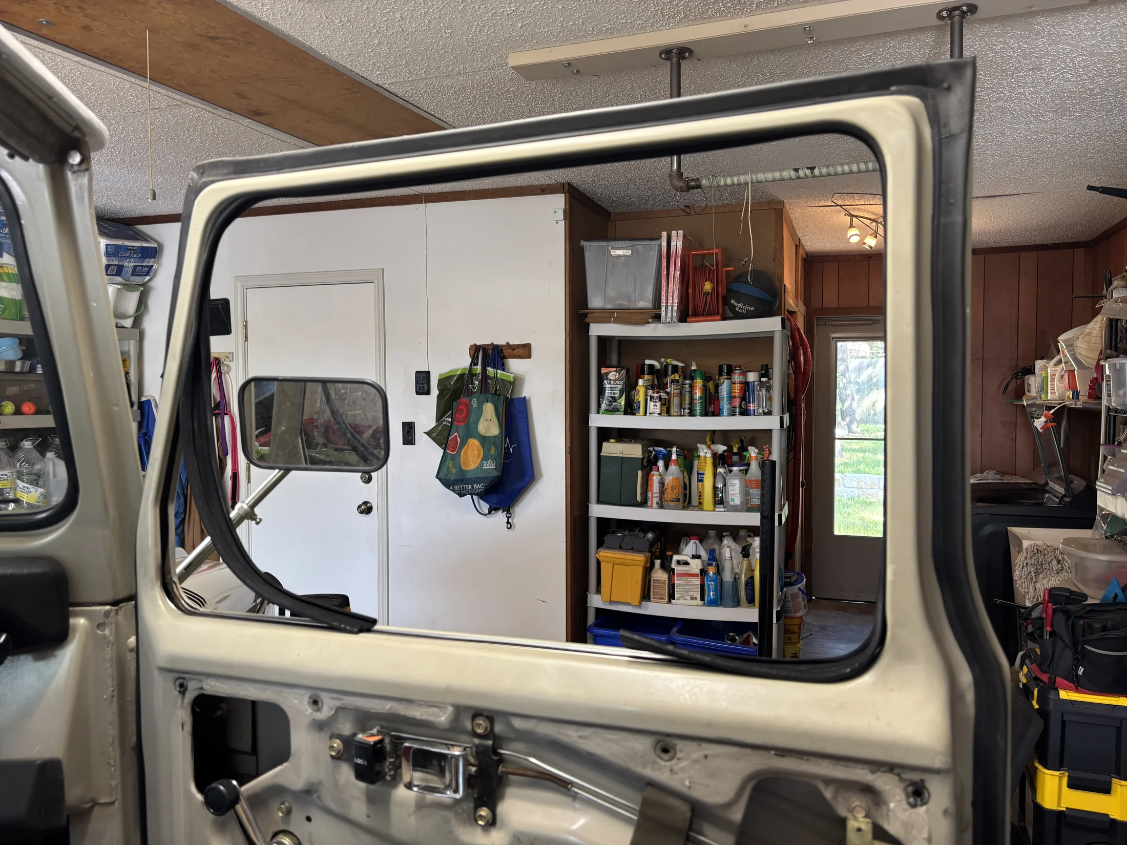

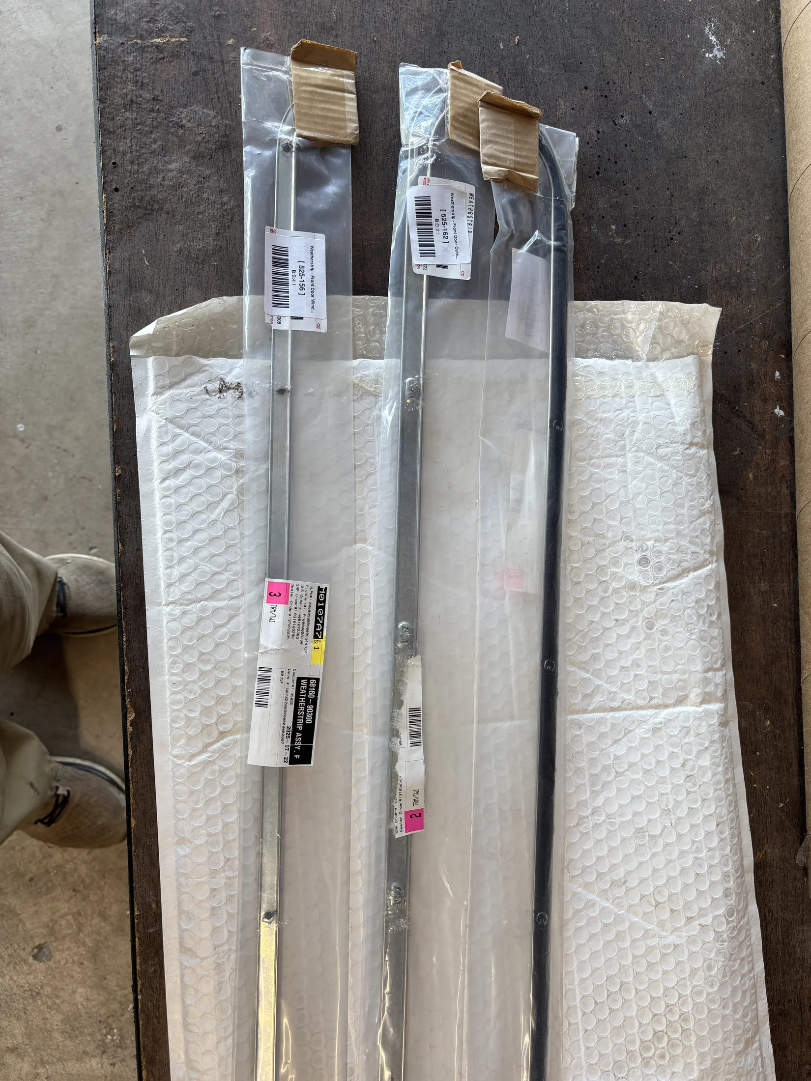

Replacing my door window track weather stripping runs with new track from City Racer and window felts. The biggest pain is removing the glass, but boy is it nice and snug now. Also got to evict a few more bugs and treat some rust spots. Unfortunately, they only had one of the outer felts, so I need to find one more.
I have to do this as well, but I have the window vents. Maybe I should leave this job to a body shop? Yours looks great.
I think it'll be just fine for my usage. I didn't want to run a full Detroit but wanted to stick with an auto-locker vs. something selectable. Rear only or do you have one in the front too?
Auburn in the rears, lock rites in the fronts.

I’m ordering the dash mount. Which magnet phone mount did you go with?
