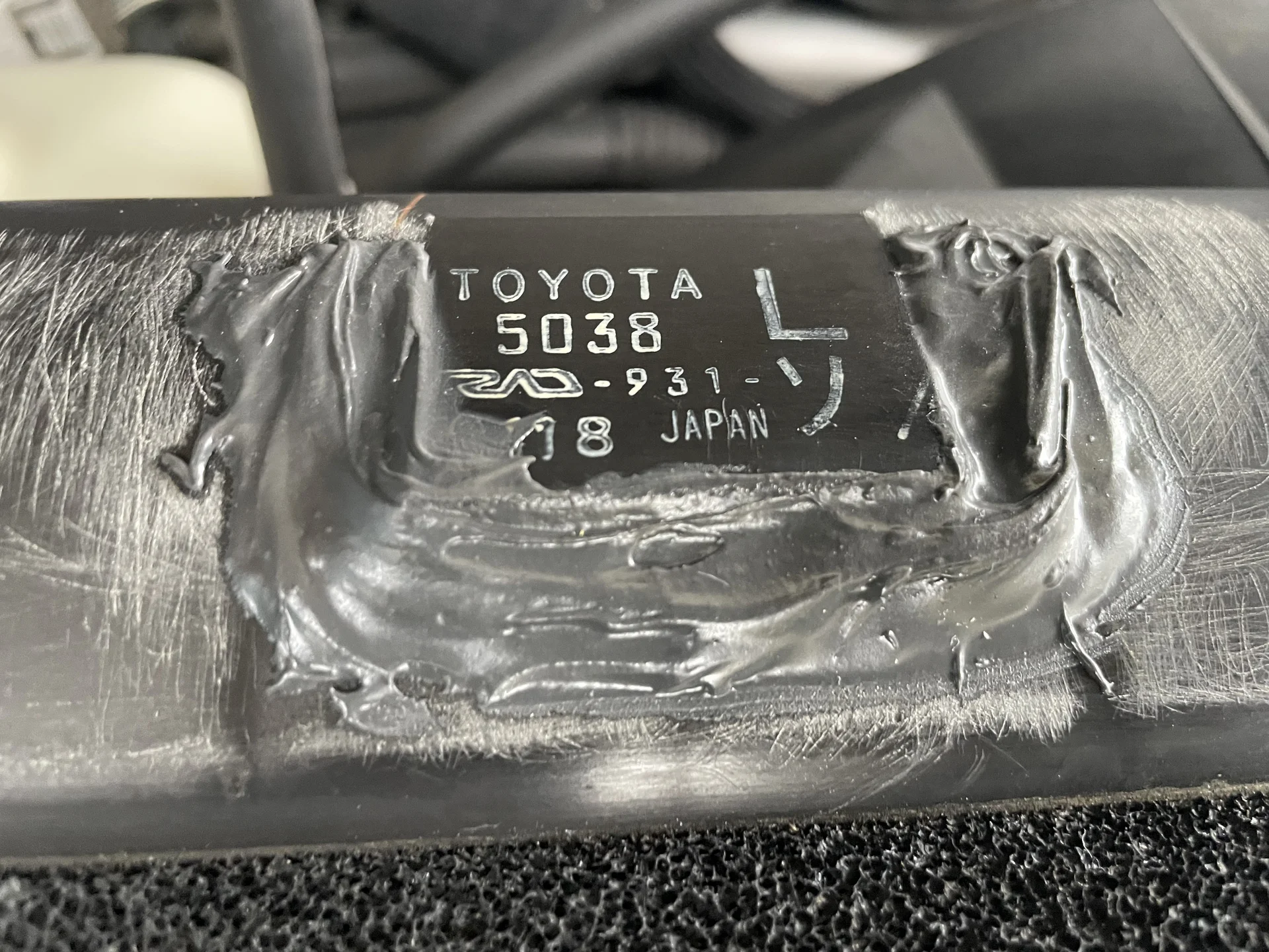

I also preventatively applied some JB Weld to the radiator. I had the very beginnings of a faint stress crack. I cleaned it with rubbing alcohol, roughed up the surface a bit with sandpaper, and cleaned it again and again with rubbing alcohol. I applied it pretty thick and did my best to make sure there were no bubbles or air pockets underneath. I'll sand it down nicely this weekend. I'll continue to monitor it, and I think I'm now good to take longer trips in the LX without worry.

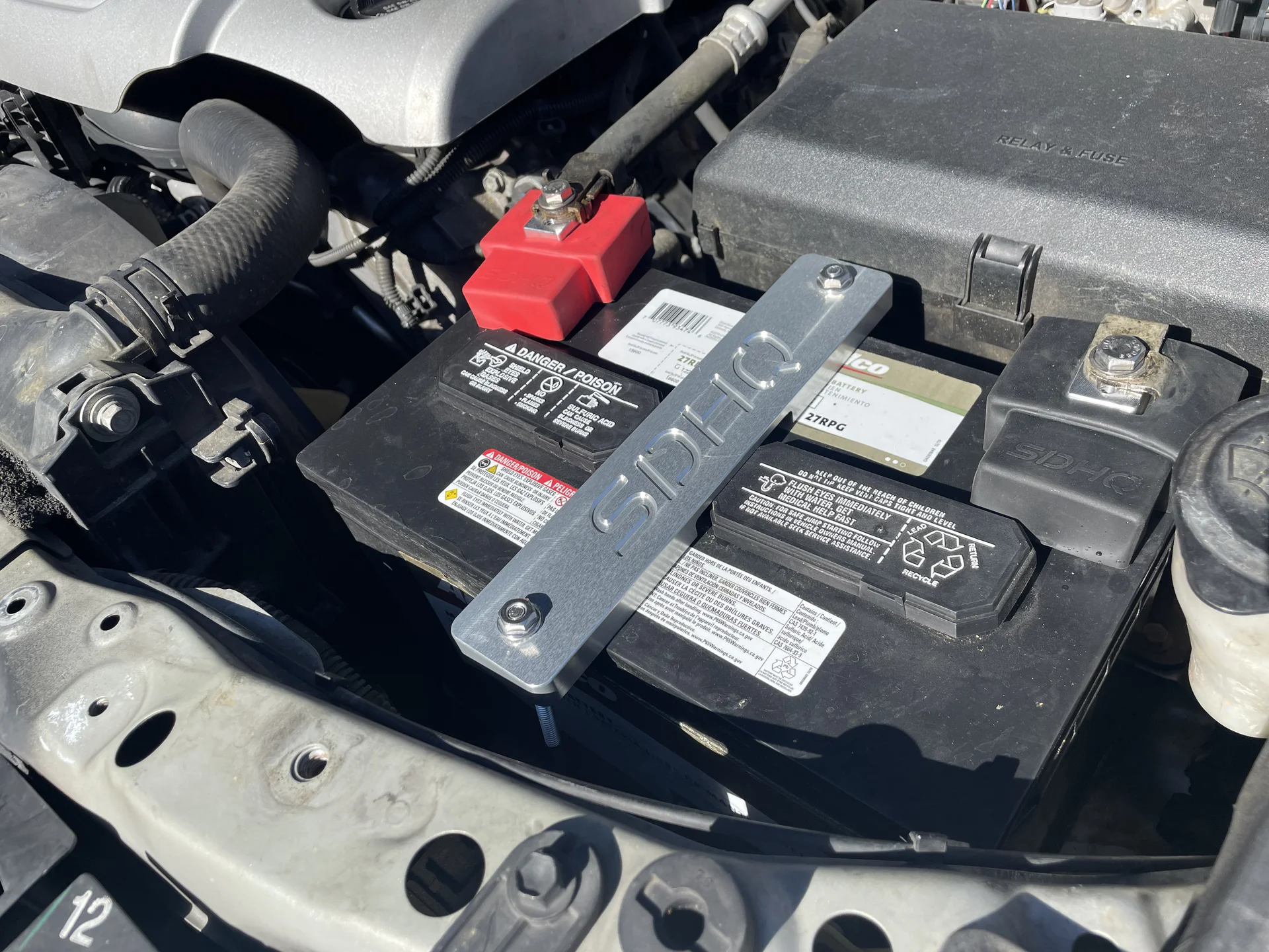

I also put some overpriced terminal blocks and a battery hold down in. The old clamps were in bad shape. I do need to swap the battery. Currently running the AC Delco that was in it when I bought it. I will start researching the forum to find out what everyone is putting in their 200 series Cruisers. Seems that most people decide against an AGM. Seeing this pics reminds me I still need to thoroughly clean the cable ends.

Friendly reminder to insulate exposed metal on the + terminal.

How were your battery terminals deteriorated, did they really warrent replacement?
And, I'm sorry, but what is prohibitive about actually replacing the radiator and doing the work that goes along with this repair properly?
I would hate to drive around with JB weld slopped all over my radiator like so, thinking, boy I really saved a buck.
These OEM materials deteriorate over time, I said it in the '08 radiator replacement thread and I'll say it here, Mr. Toyota gives to you a gift, placing the weak spot right in front of you when you open the hood. When it shows signs of deterioration, replace the unit and the other wear items like fan support bracket, serpentine belt, water pump etc.

Is it the negative connotations of glue? Because this ain't Elmer's glue you grew up with.
Epoxies and adhesives are found all over your car straight from the manufacture. Used correctly, it can be stronger than the substrate.

I hear you, but the material the radiator tanks are made from is breaking down. There are many other manufacturers who suffer from these cost reduction measures (bmw) also.
If you prevent it from failing in this manufactured weak spot, Murphy says it will fail elsewhere. Might as well get it over with!

I understand what you're saying but this is a different issue and not really due to it breaking down. I have some background working with aircraft composites. The root cause is the geometry of the feature. You see that it is corrected in the later radiator versions where there's a nice fillet, and I'd wager it's not any thicker. The epoxy can accomplish the same thing because it's being use to correct the geometry that creates the crack, rather than sealing the crack.

Would it add any benefit to shape the fillet with a tool or gloved finger rather than globbing it on? I seem to remember that being important in composite boat building.
Positive terminal fell apart as I removed it. It’s a wonder the truck would even start.

No. It does not follow that reinforcing the area around the one point where the radiator is only millimeters thick will then cause a weak point somewhere else. These radiators–manufactured weak point notwithstanding–are generally good for a very long time. Most high mileage Tundras are on their original radiator and water pump. If I need to replace mine in the next 100k miles, I’ll be very surprised.
Are you talking about my JB Weld job? If so, I added several light layers, shaped it with gloves on, and made sure there were no air pockets or bubbles. It is sandable once fully cured. Maybe then it won’t offend so many delicate Mud forum eyes. Lol.
I ran jb on my radiator for about 1000 miles. It ended up failing. Not catastrophically, just a pin hole leak.
