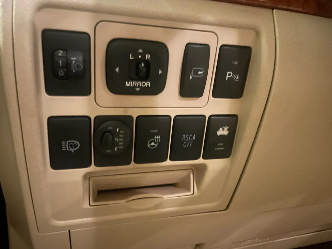

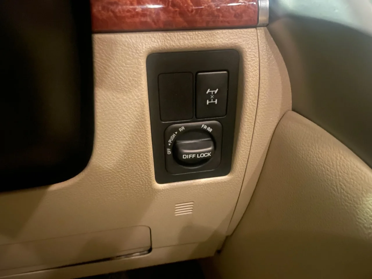

4.88s, front and rear air lockers, 24 gal LRA, new OME 2774 rear springs. Relocated my CDL to the OEM rotary locker switch panel and put my compressor switch in its spot. I plan to relo the VSC switch there too as I used its location for the LRA level/pump switch.

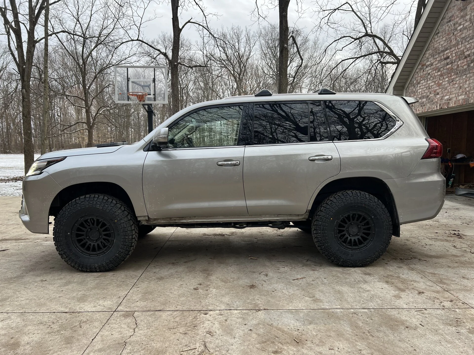

Looks great! Did you use all of the spacers included in the kit? (2 front 1 rear) Do you have any measurements for the lift you gained? I've seen several people leave off the smaller front spacer and it looks very level just like yours.
@skmaynard1 sorry for the slow reply I missed it originally.

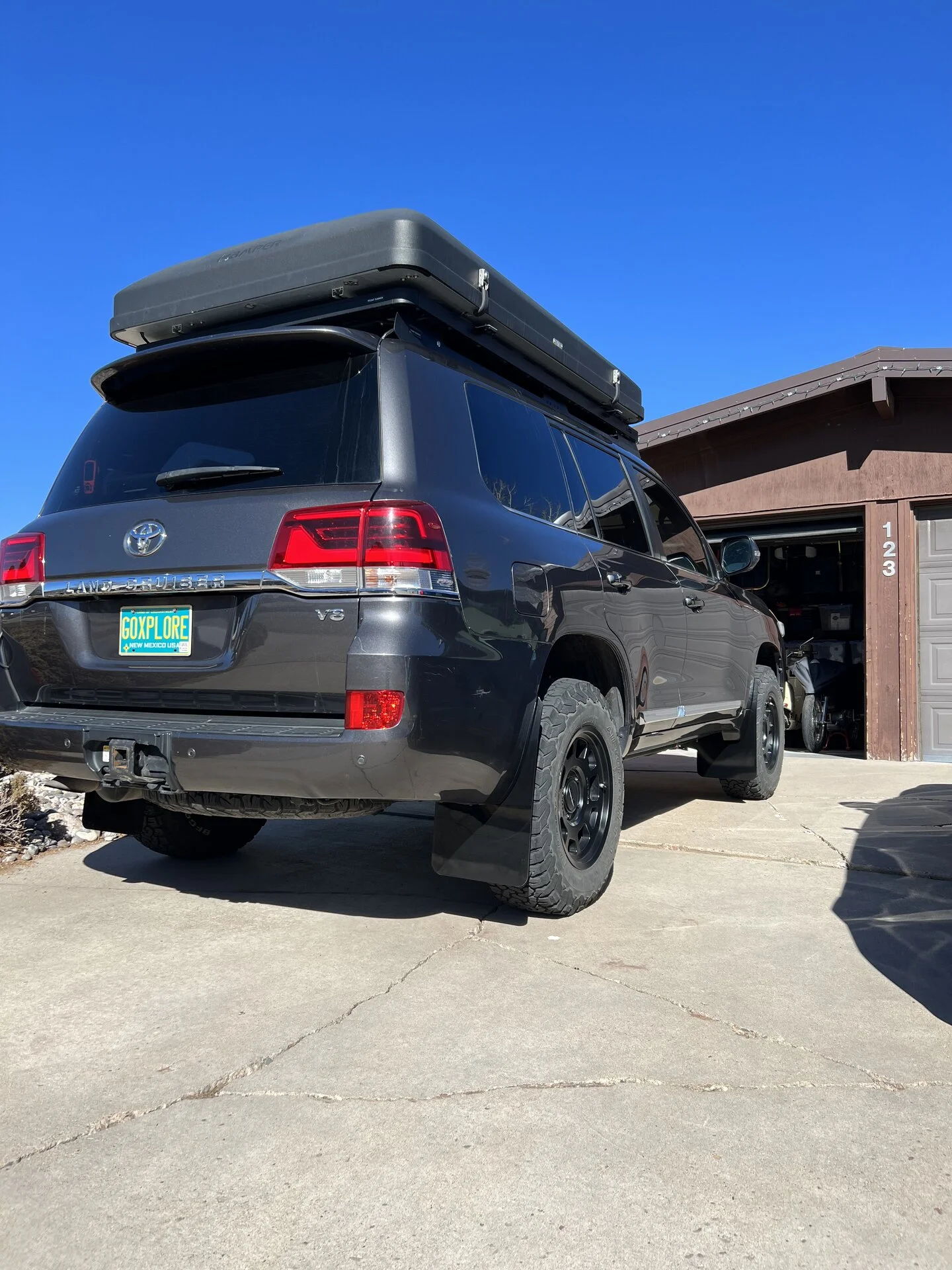

I put in all the spacers 2 front and 1 rear. I actually didn’t read much about it prior to installing. I’m very happy to have put in both front spacers. I don’t like bro lean but rake bothers me as well.
I don’t have before measurements but I can get some post lift measurements. It is considerably taller with the lift and tires. My wife was less than impressed when I had to ask her watch the roof to make sure it cleared the garage door. Haha.
@MWOverlanders loving that wheel / tire combo!

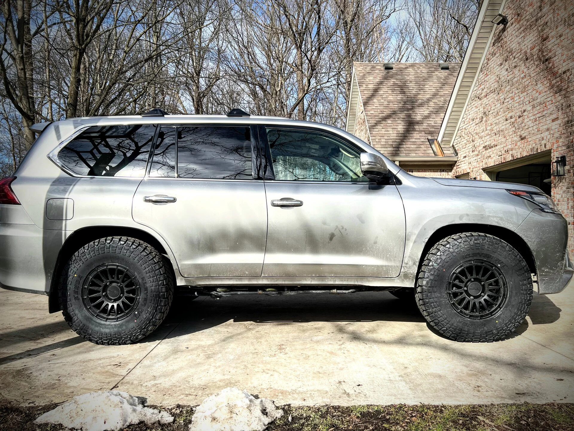

I'm loving it so far. Prior I had a set of 0 offset Summit wheels with 33s and it rubbed badly ... this +25 and the 35x10x5 is an awesome combo so far. As soon as I get the sliders built and some skids ordered i'll go out and test them thoroughly.
I have the 18" w/+18 offset. Looking at yours makes me wish I opted for the 17" +25. That's a handsome but capable looking rig.

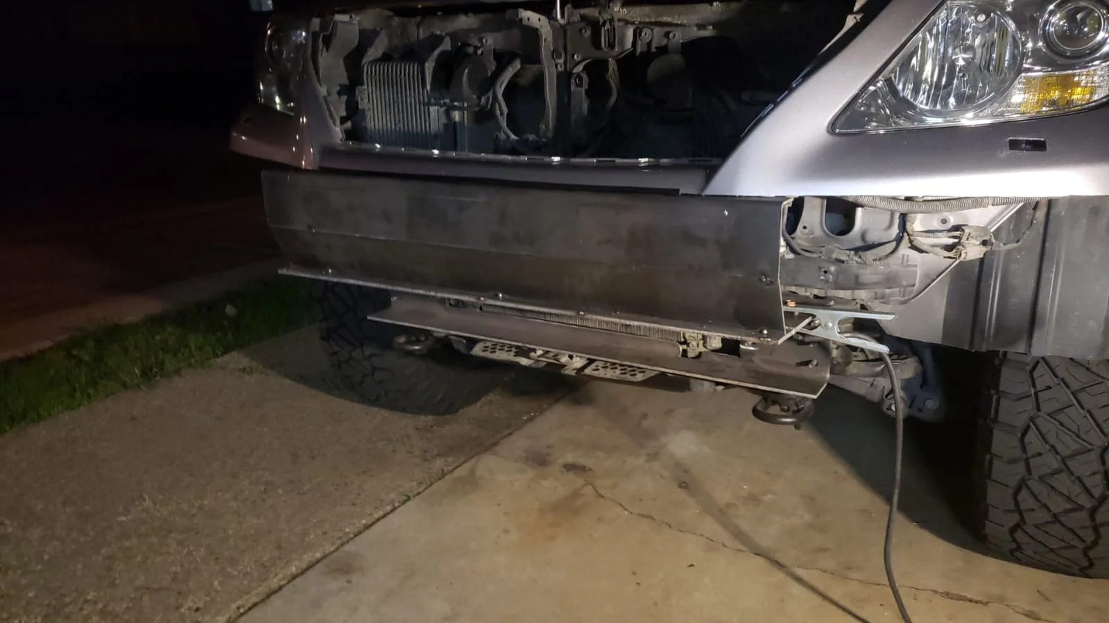

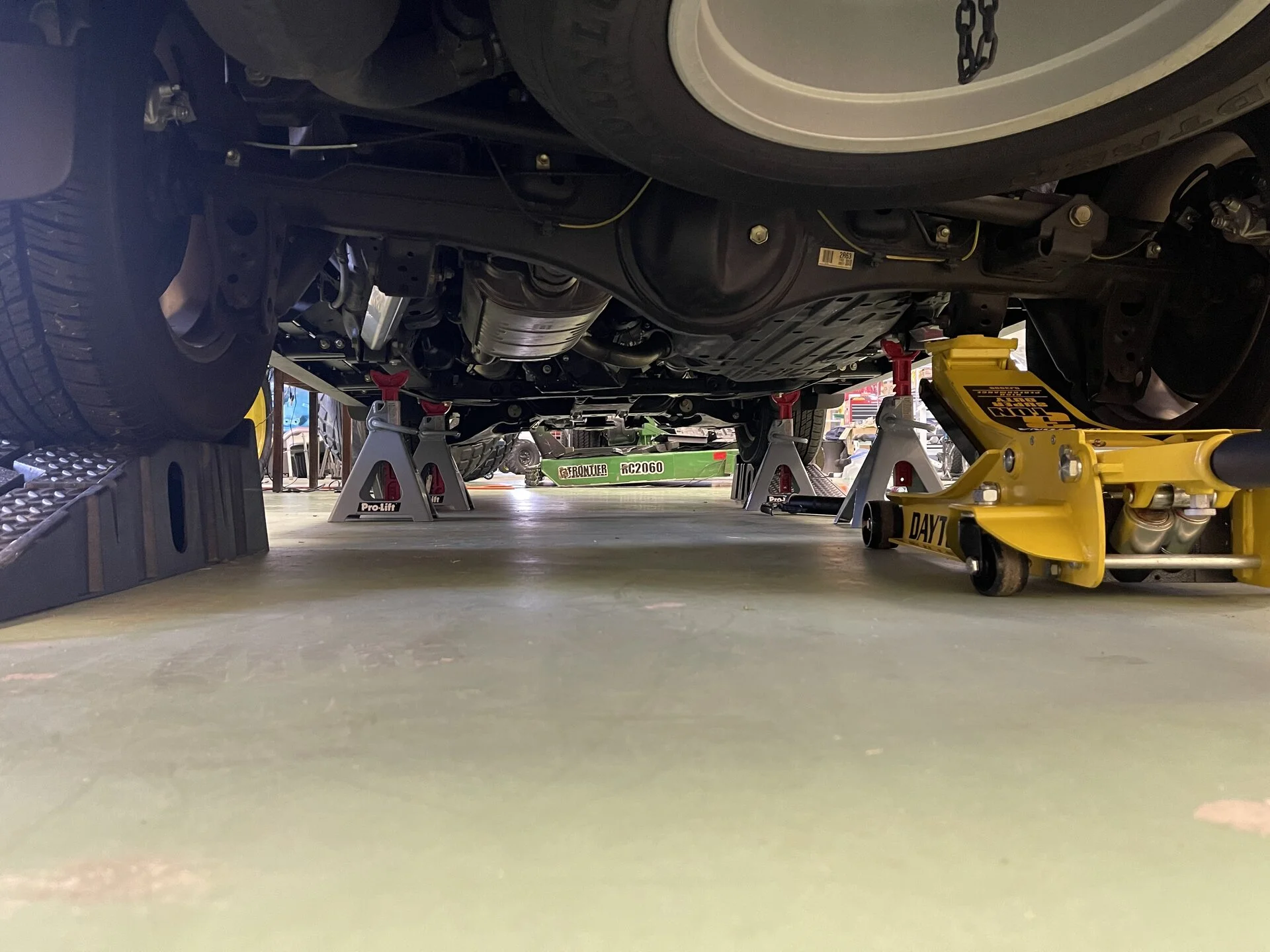

I removed my factory splash guards in preparation of installing the innovative skid plate system from @turbo8 tomorrow.
Also used @bloc ’s excellent method for greasing driveshafts and got the front and rear driveshafts lubed up with Lucas Red “N” Tacky grease.
Thanks also to @Sac Cerevisiae for his post on greasing prop shafts with the service manual pages.
