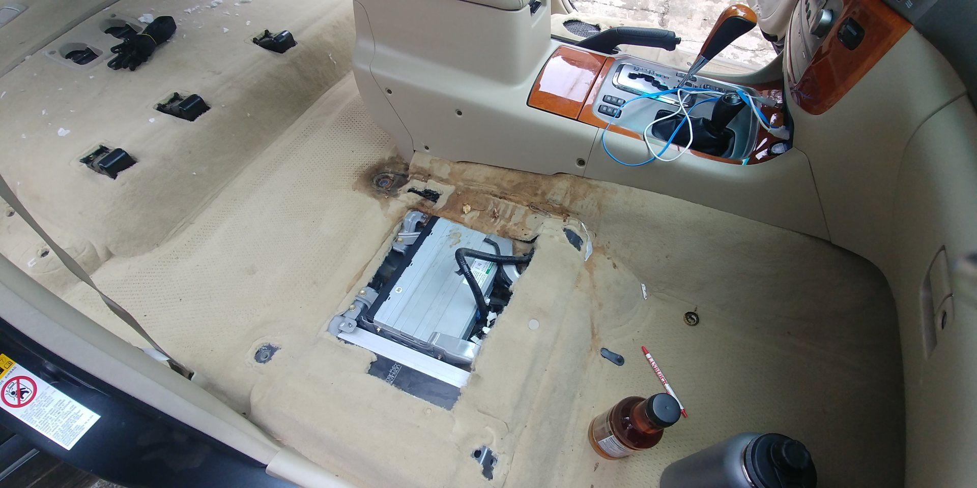

Ah, you broke out the big guns extractor! I don't have one, so had to call in pros to take care of mine when I bought it. Fortunately the pressure washer took good care of the mats.
Oh nice. You detailing the whole interior? Yup pressure washer can def do the job too, sometimes even faster.

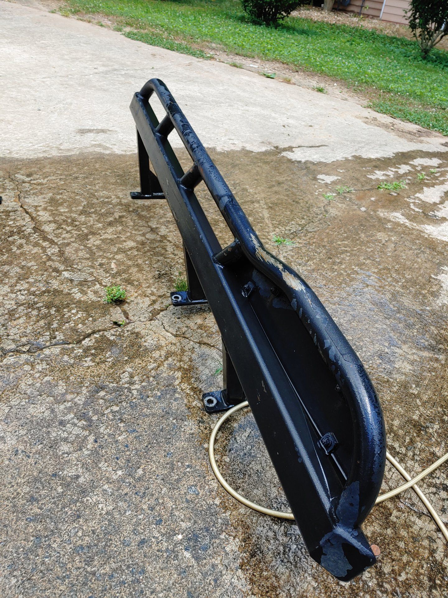

Did a quick and dirty refinish on my sliders. I hadn't realized how much abuse they'd taken in just 5 months. Nothing structural, but a lot more contact than I think I knew of. FYI, the duplicolor? rubberized bed coating in a spray can is TONS better than whatever the "Bed Armor" brand is that I used originally. The latter stuff was a PITA to spray, the former was so easy I could have done the whole truck.

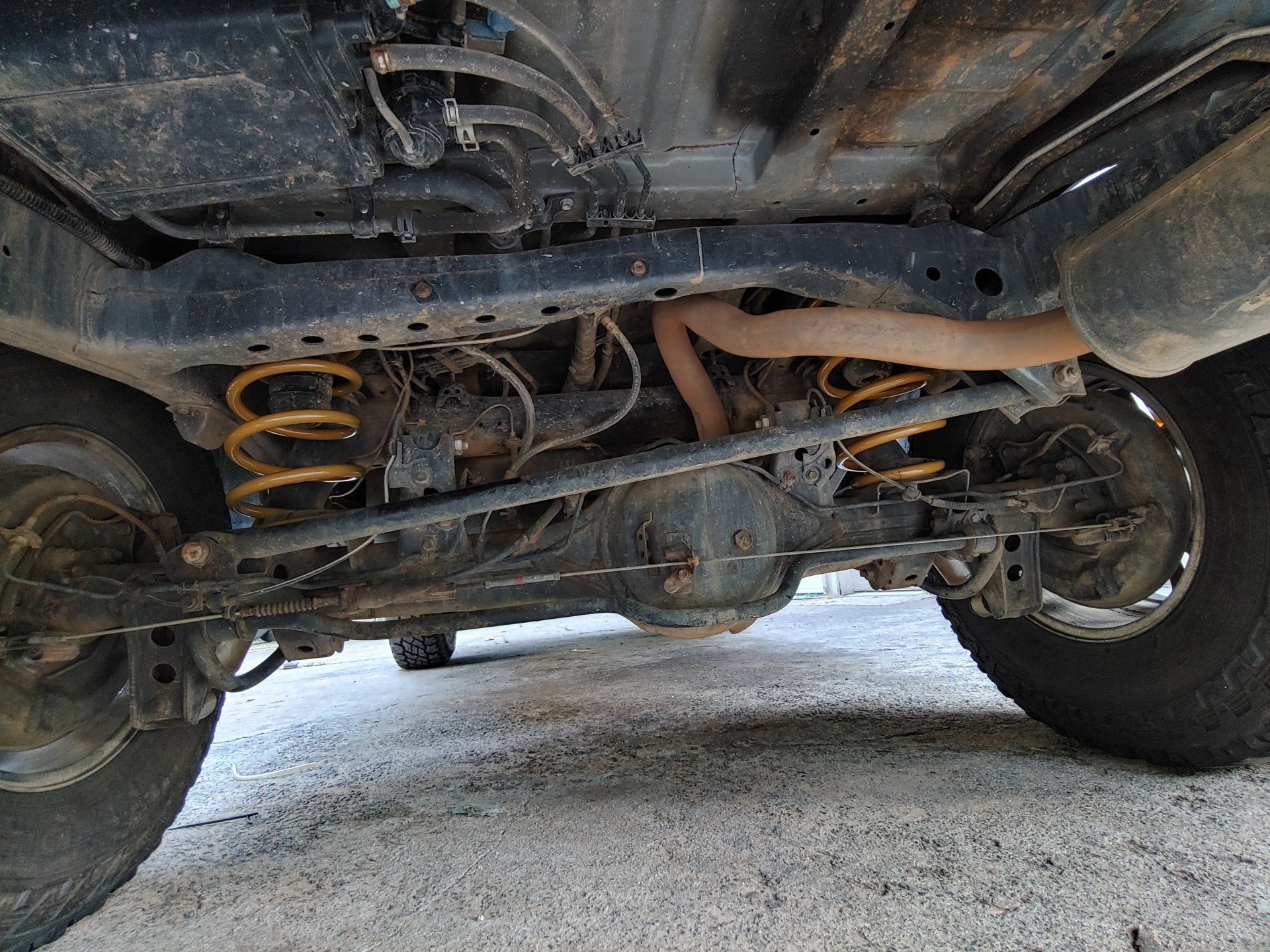

Then I tossed in the Tough Dog gold medium rate coils I've been sitting on since last Summer almost. Replaced a set of OME 865s that were nice when stock, but not quite up to the extra weight in the truck now. It definitely feels flatter in turns. Will play with the shock adjustment over the next few days to find the right spot for highway travel.

Possibly so? I've got the tough dog adjustables in the back, which allowed me to play with the setting to keep it comfy. I think if I had a standard shock it would be a little bouncy with no weight in the back. I've removed the spare and the jump seats, so my rear is pretty light. But, putting my sliders back on after the springs did actually help with comfort before playing with the shock adjustments.
