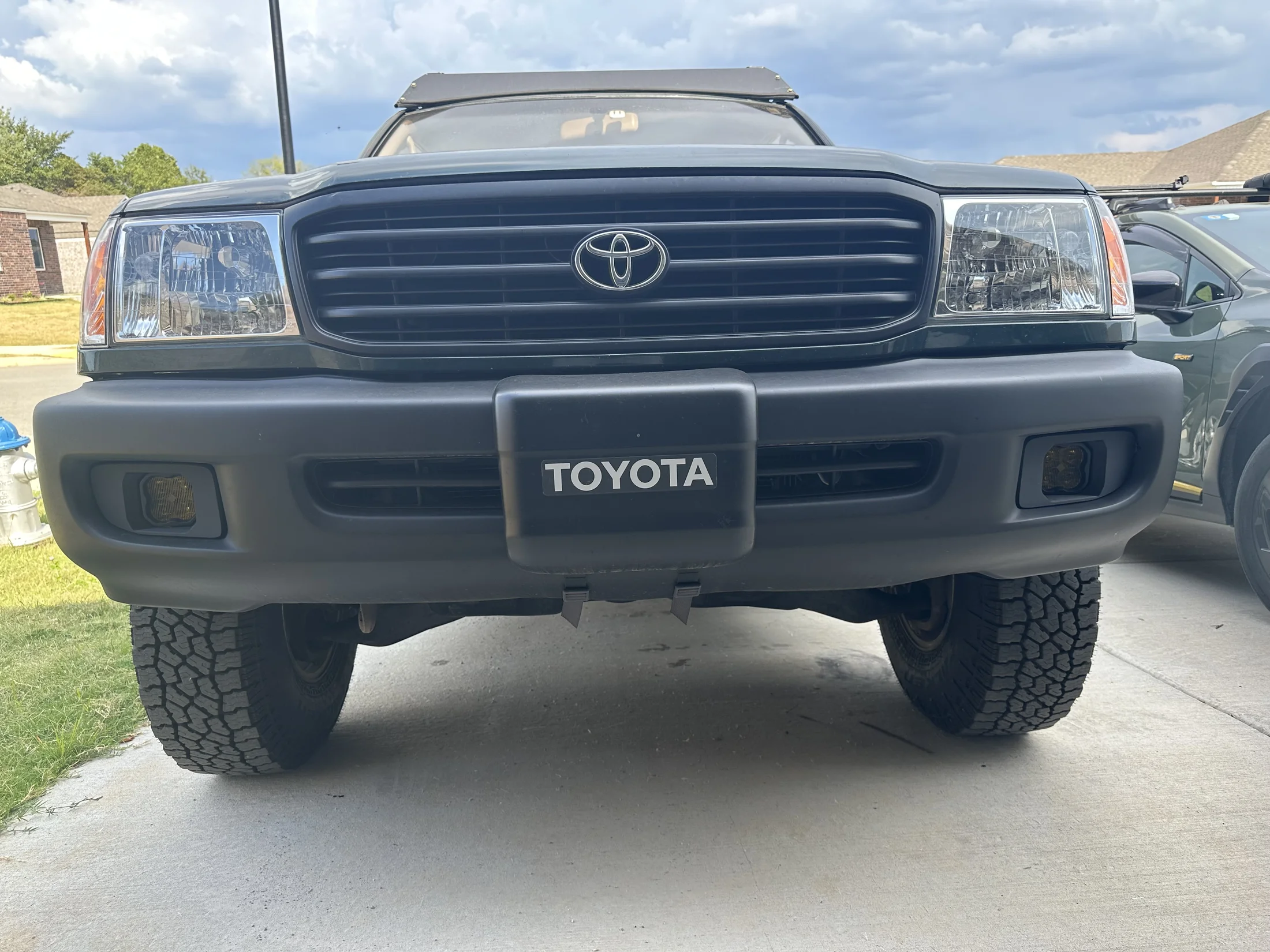

Installed some BenCC fog light inserts with Diode dynamics sports, highly recommend. Ordered these a year ago and the wrong ones were sent out. He sent out the correct ones asap. Wish I needed more stuff from him cause I would 100% buy from him over and over.
I did not! were those supposed to go inside the frame rail?? I was under the impression they went between the bumper and the frame. I wasn't a big fan of the directions, I would have preferred a video.
The spacers or shims go between the frame rail and the Dissent frame bracket. Its used to level and control the gap.

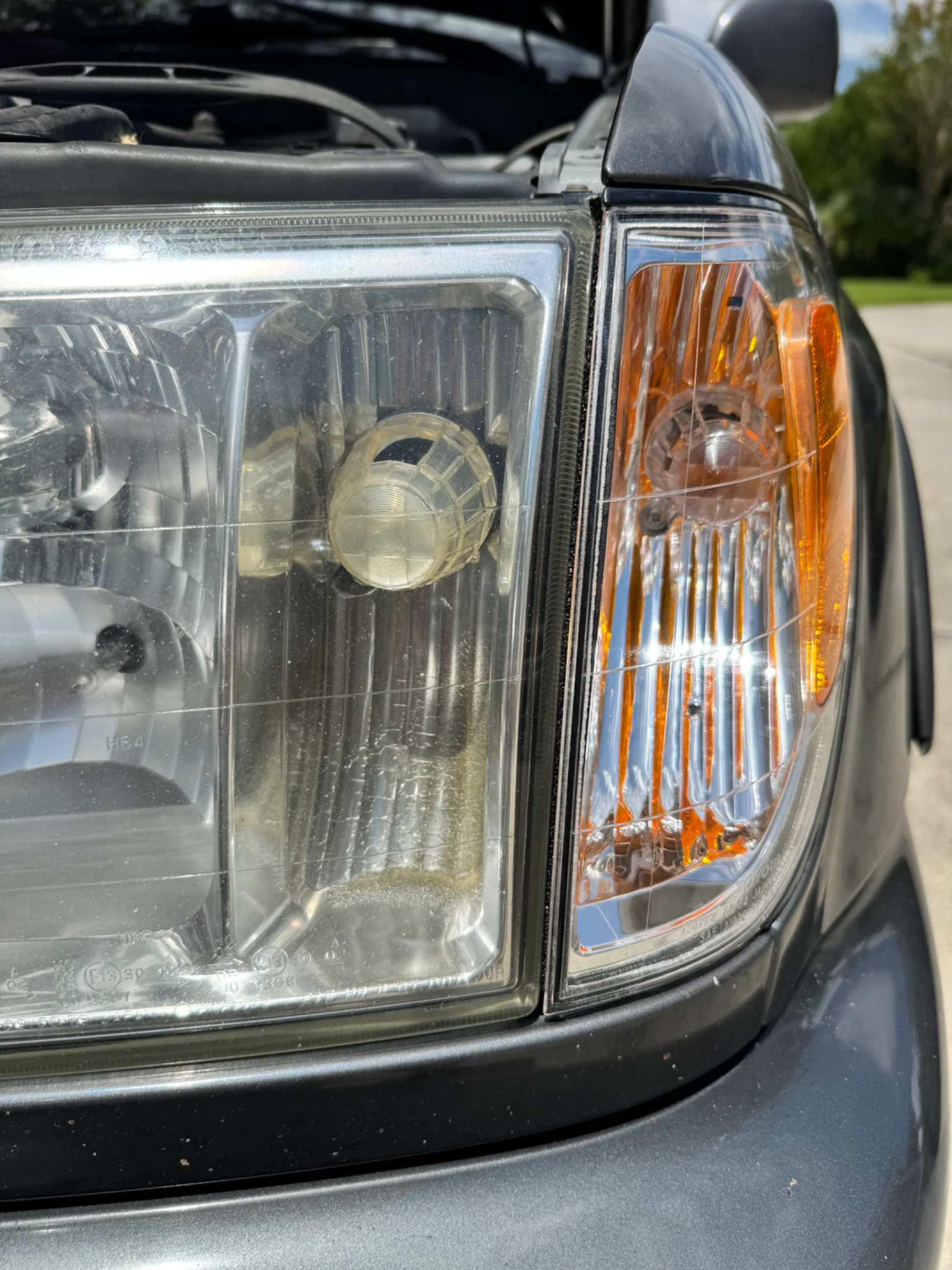

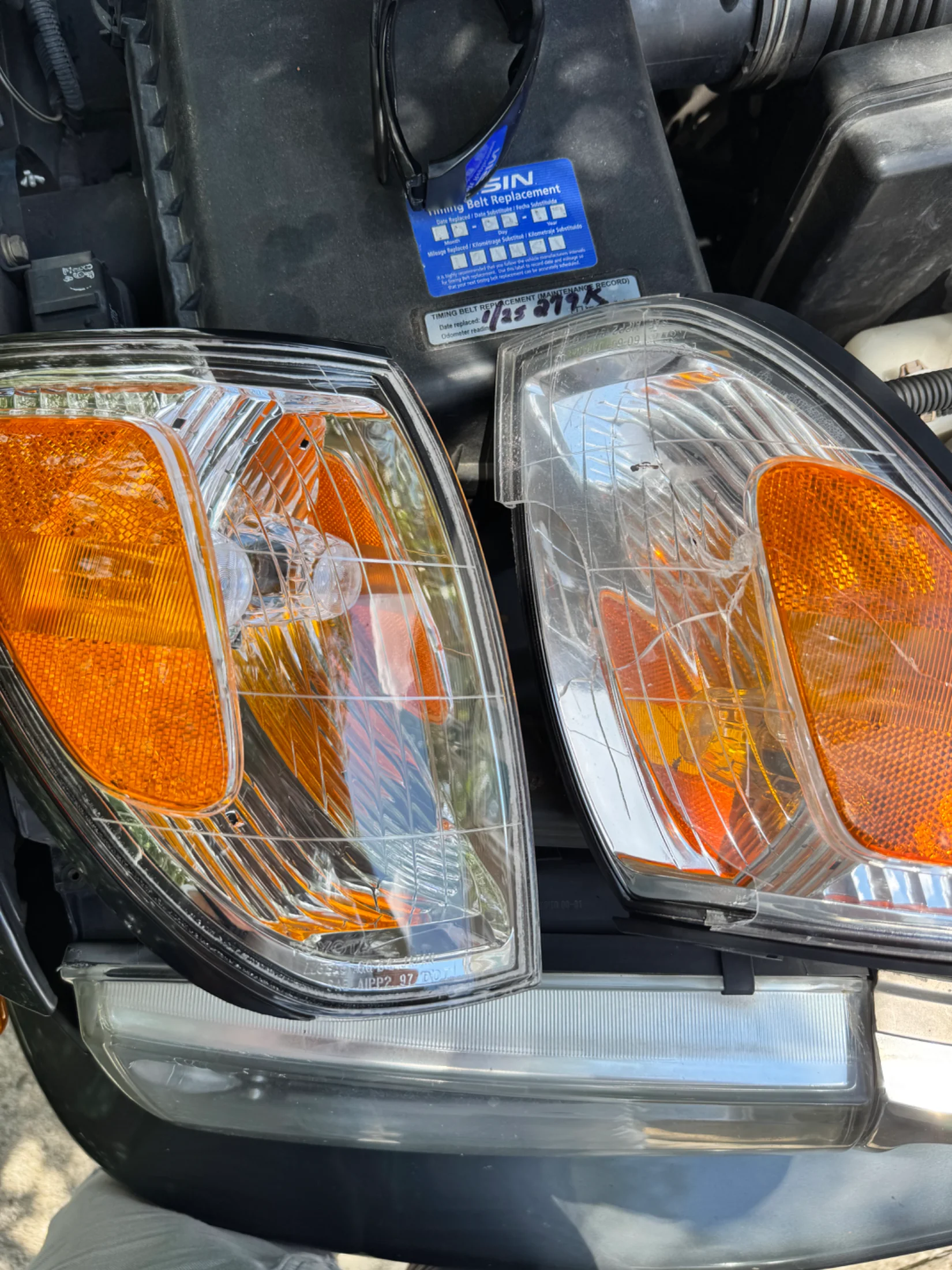

Replaced a broken side marker light. Now I’m going to have to do something about the aging of the reflective coatings of the headlights too. You never realize how much luster has been lost until you see what new use to look like. I only broke one, but decided to replace both sides while I was doing it.

Hey, got the part number for those? (I know, I'm lazy and don't want to look it up. I replaced the main headlights a couple months ago.)

LENS & BODY, FR TURN
Part No.: 81511-60500
Part No.: 81521-60370
Got them from toyotapartsdeal.com for $64 each. Not too bad.
When you ordered the headlights were they the glass lenses ones? I can’t seem to find that description in the listings yet and don’t want to swap mine for plastic ones if I don’t have to.

Yes, they're glass. I thought they were all plastic now, but for my '99 they're glass. Thanks!

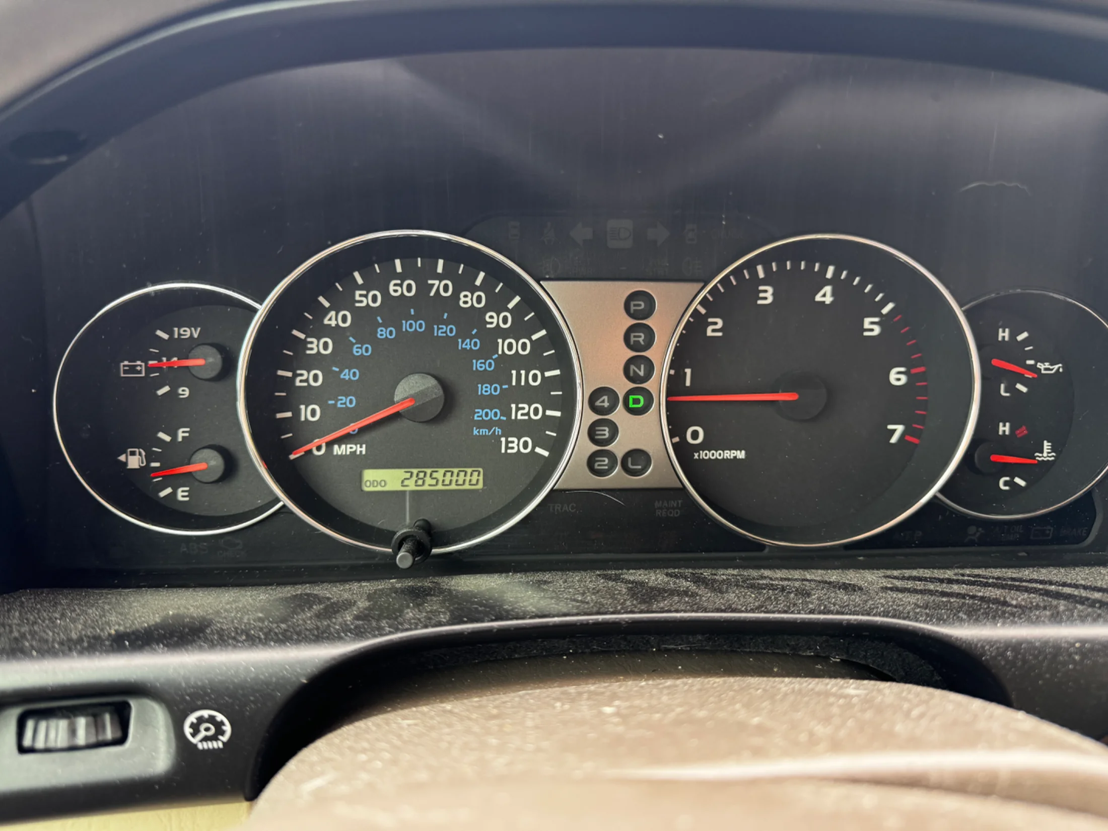

I think it is fairly impressive to be that low for a 21 year old car :-)
