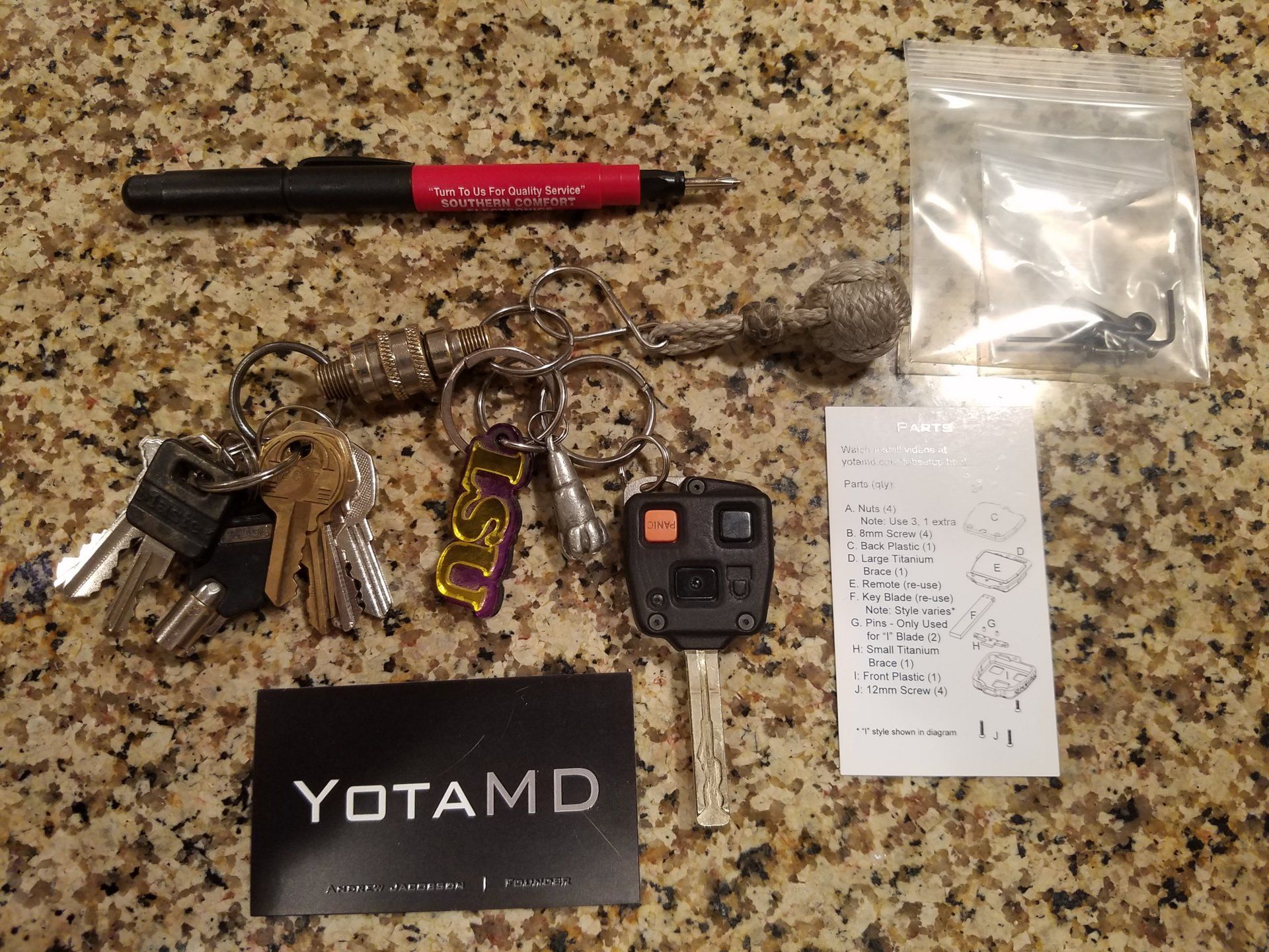

My old Ebay key fob cover finally broke off so I installed @suprarx7nut YotaMD titanium integrated key fob on my old Lexus blade.
Man this thing is solid!! The ignition switch/key tumbler will more than likely give out before this reinforced shell does!
