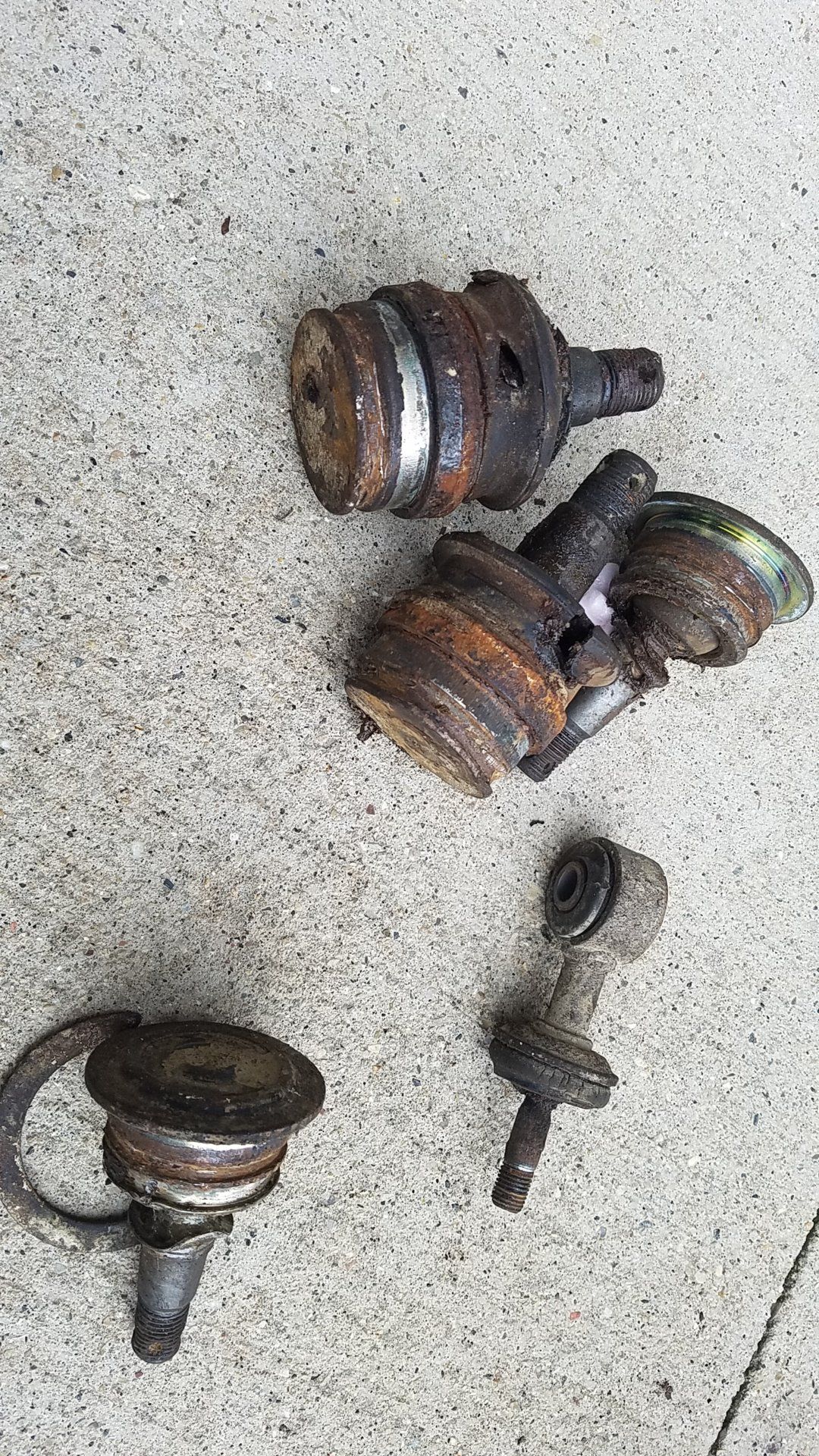

New ball joints are all installed. Kinda unpleasant job to do in sub freezing temps.
All of them were 20 year old originals:confused:. Took fair amount of "persuasion" to get the lowers to pop out.
All four were scary loose but the boots were mostly intact (except one upper one). Now I should be all set for another 20 years and a quarter million miles.:D
A drive around the block revealed no change in the steering feel whatsoever! But since a new steering rack was installed by a Lexus dealership about two and a half years ago so steering feel has been pretty good anyway.
Also installed new set of front sway bar links and bushings

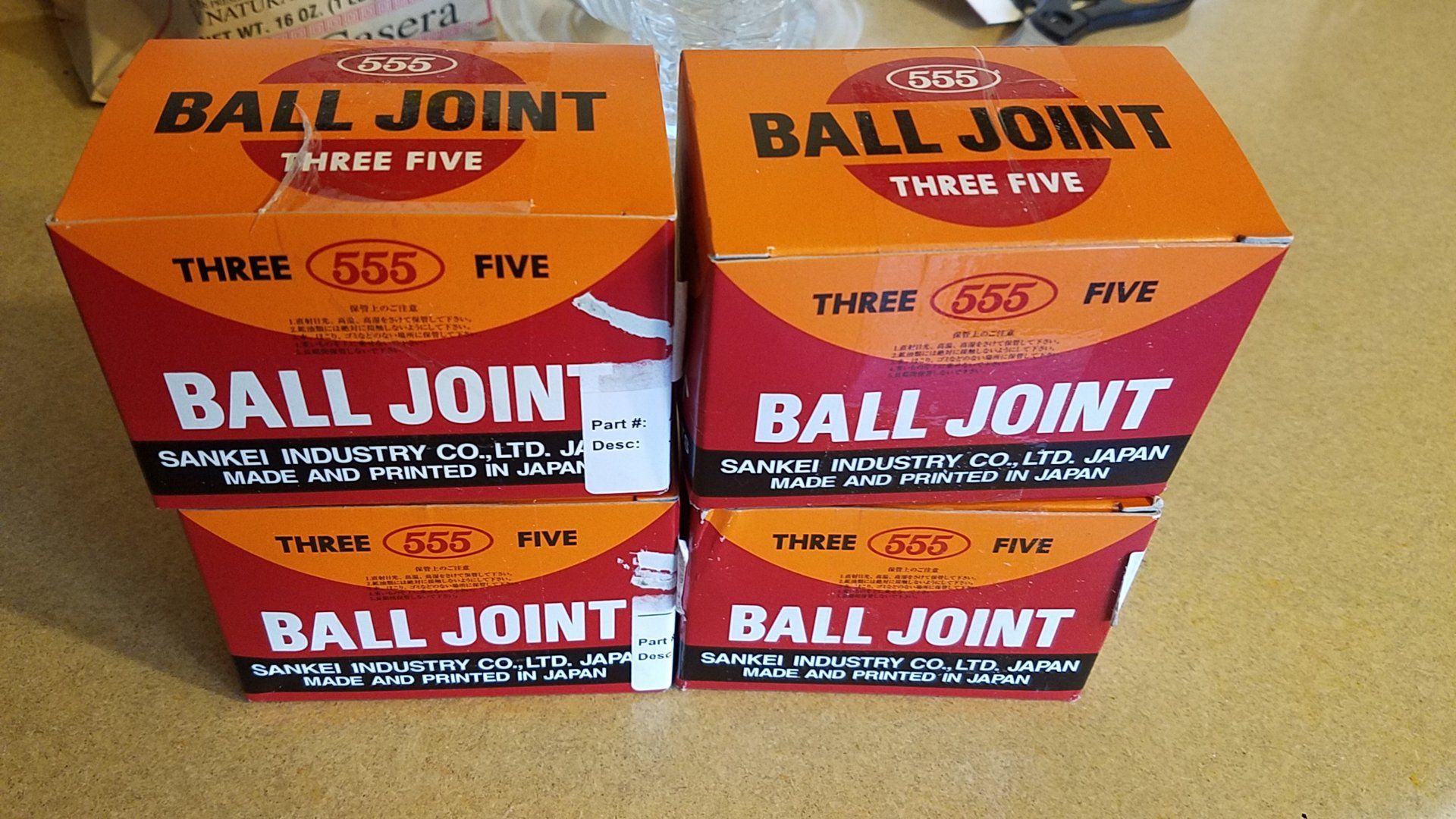

Where did you get these bad boys (ball joints)?
I bought them at @cruiseroutfit. Ordered them on a Friday and they were delivered on Monday!! I have heard that Rock auto as the exact same ones being sold as AC Delco but I had already ordered mine.
And how did you get them out?
There is a C clip holding each one in. For the top ones, I had to take the boot off to get enough purchase on the C Clip. I didn't have to take off the whole control arm - just used a large C clamp like ball joint press tool (rent at ORielly's for free). Use a penetrating oil (such as PB Blaster), and a ton of patience.

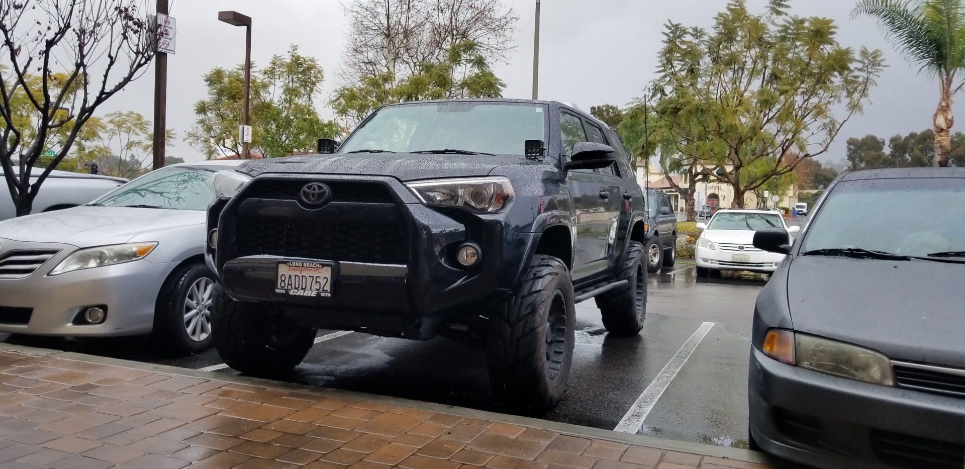

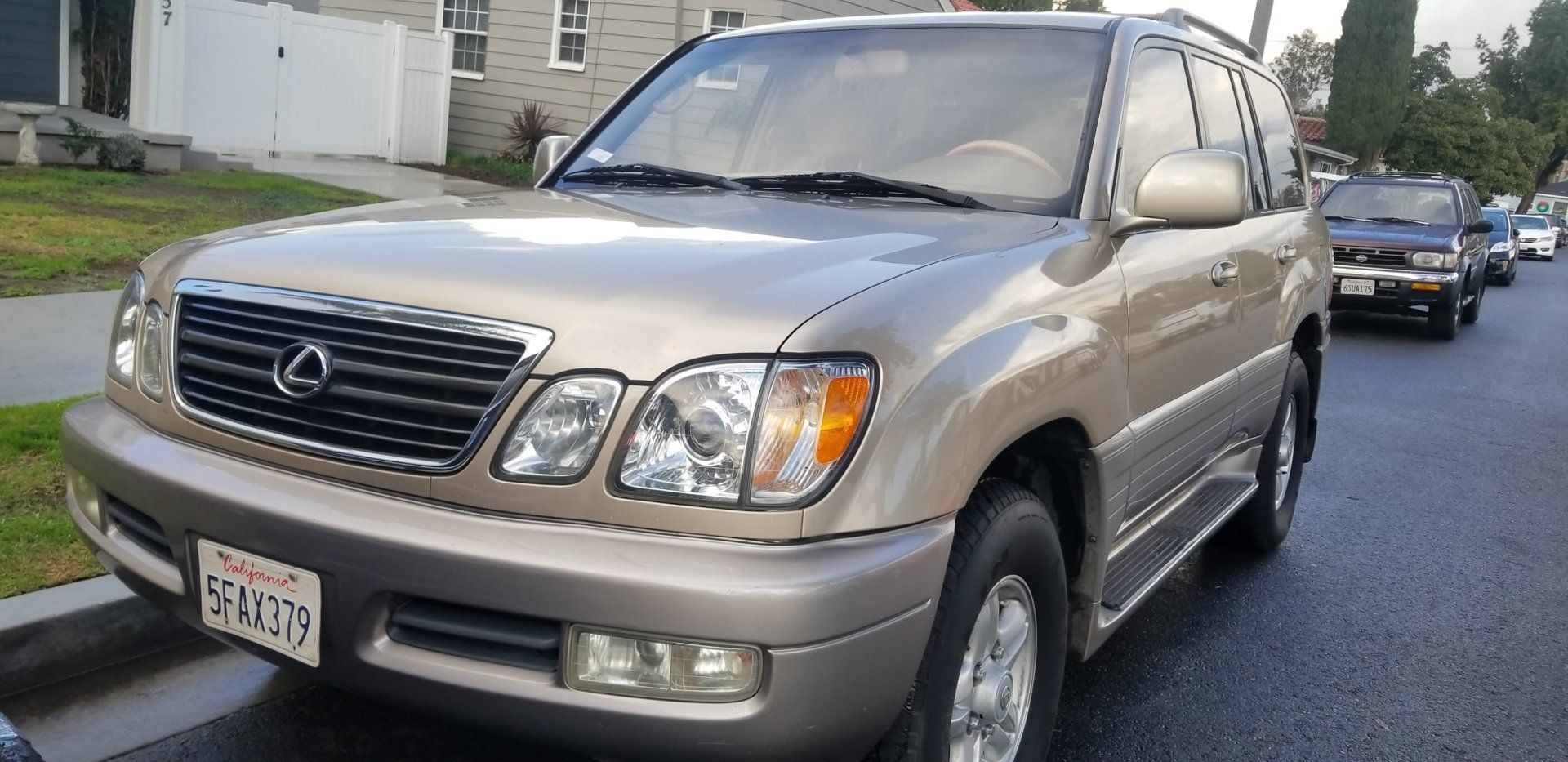

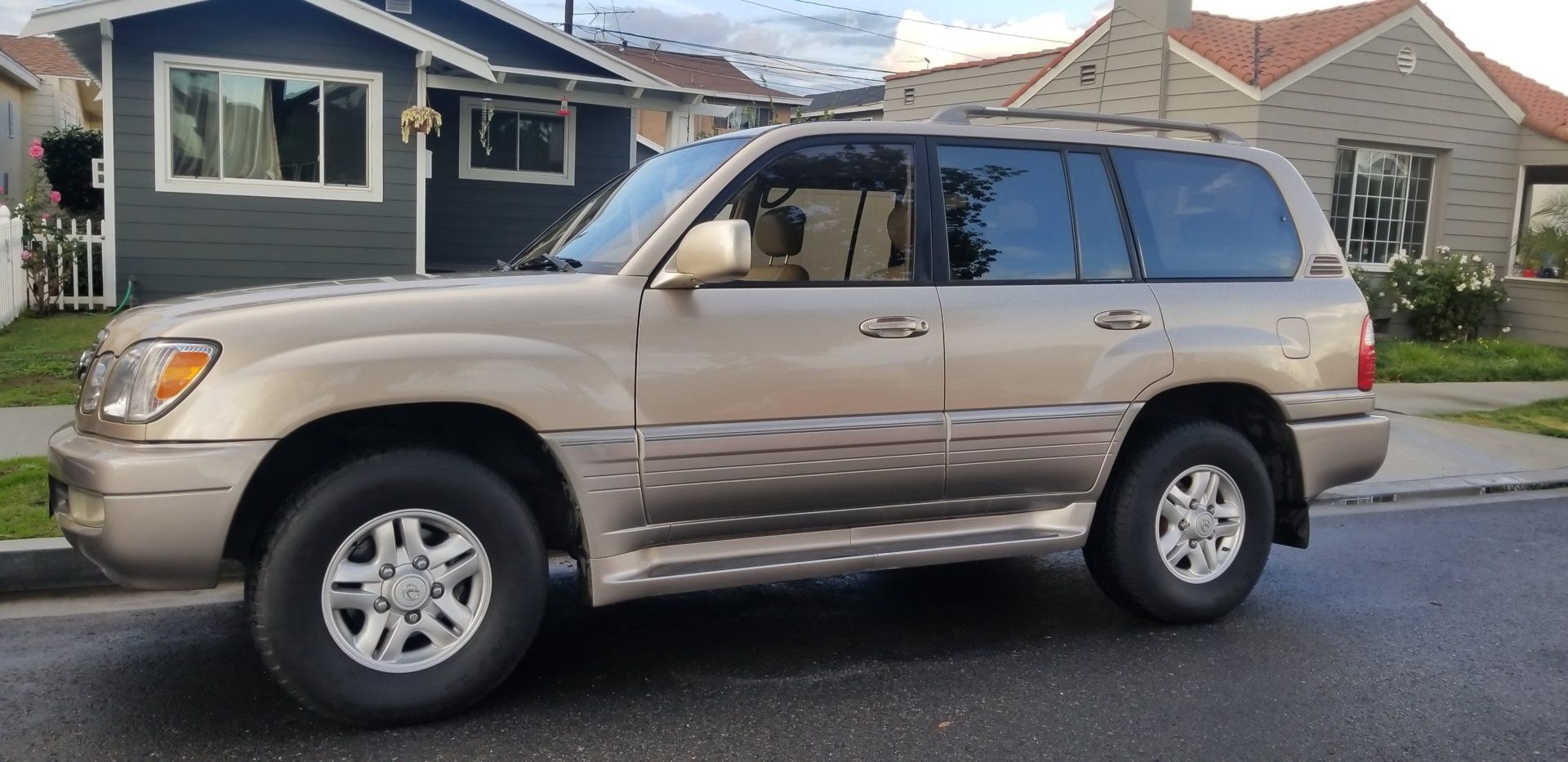

You and I are from the same stock. I did the same about a year ago and I can honestly say I do not miss my 5th gen.
It's so awesome to hear about experiences like these. My wife has hinted a few times about getting a new 4Runner.
We rented one when we visited Lake Tahoe last year and while it was pretty good at all the mild stuff we did, it just paled in comparison to my 20 year old LX

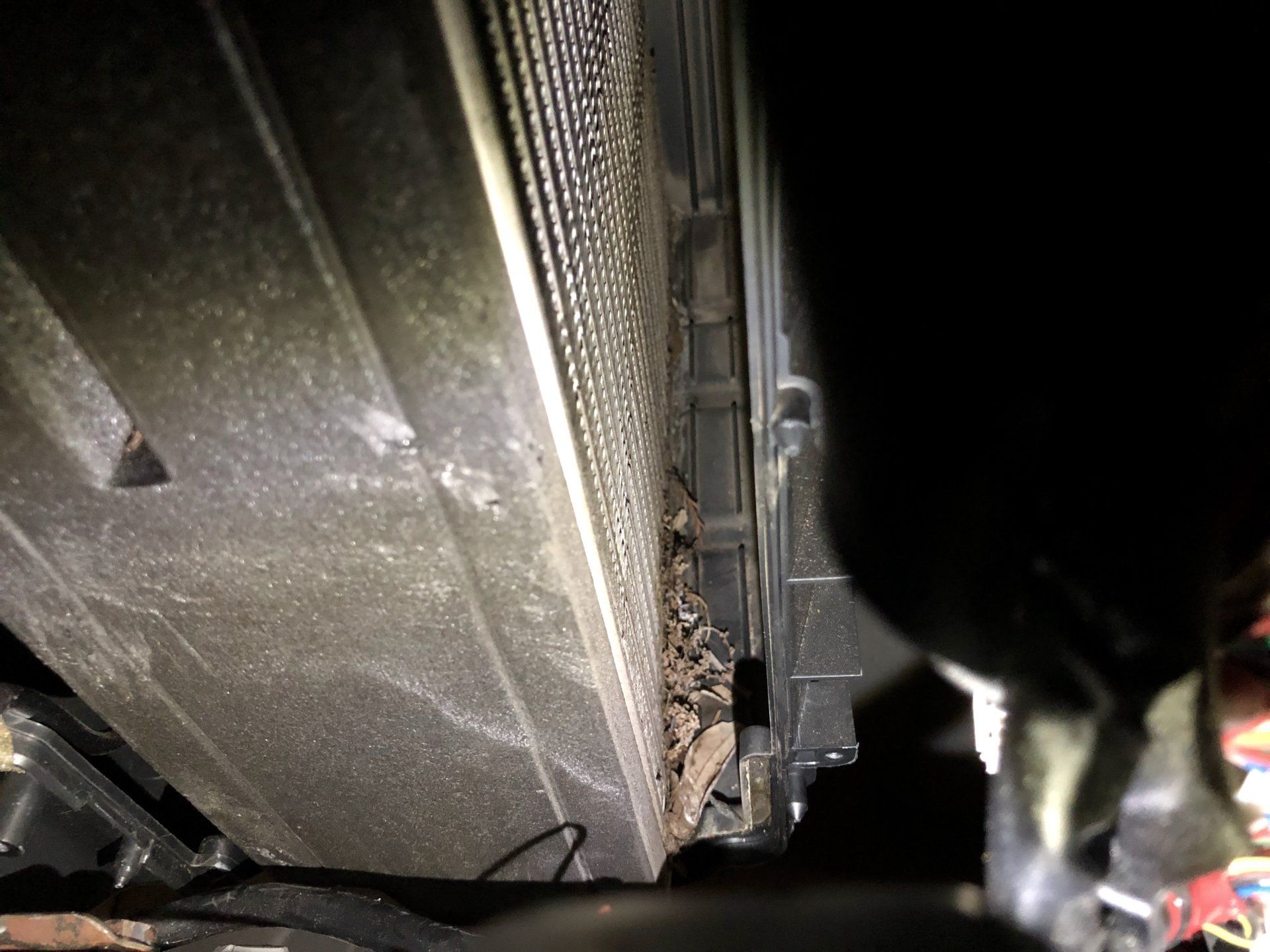

Negative, I don't even know what that is. I do have an LX though.
LX470 Cabin Air Filter Replacement DIY
It’s definitely worth checking out. Since you said you don’t know what that is either you do have them and they’re absolutely caked in dirt and debris, or you don’t and your air box is filled with said dirt & debris and your inadvertently circulating all that around the cabin of the truck. Takes all of 5min to inspect!

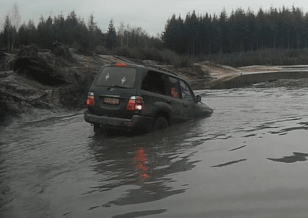

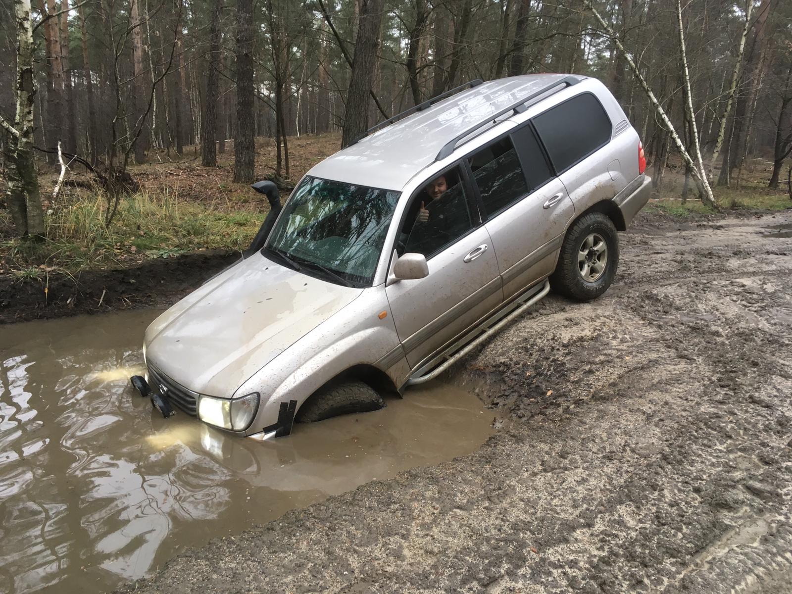

Went offroading with a few mates (3 x LC100 & Suzuki Jimny), had a lot of fun, got a bit stuck and put the snorkel to the test:
@DutchCruiser Pulled me out with no problems, little bit of muddy water inside the cabin. Took an hour to clean + three hours to dry, had lots of fun. Learned that wet carpet is quite easy to clean and that grease on door seals helps keeping water out.
