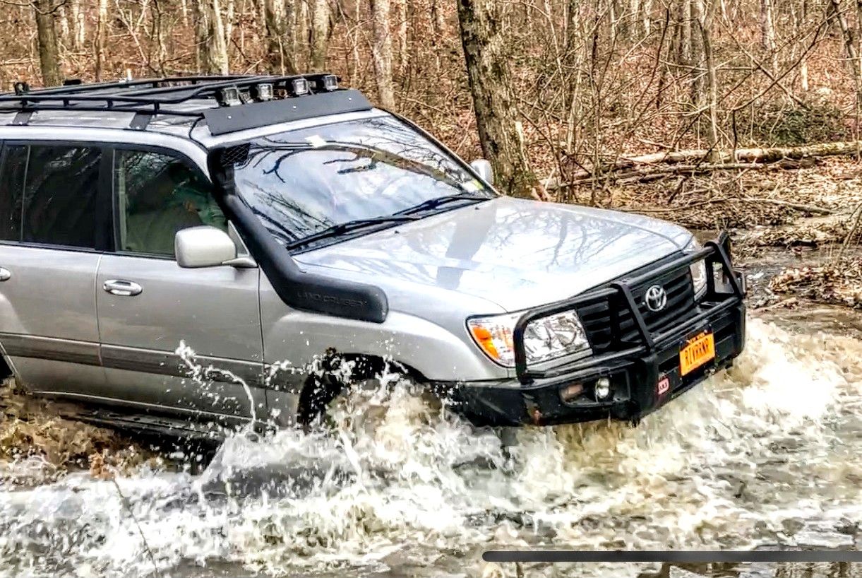

Looks like a fun day!
I have an odd question, is that a home made fairing on your roof rack or did you purchase it somewhere? And does it help with wind noise?

Hey! It is the one that comes with the Gobi rack.
