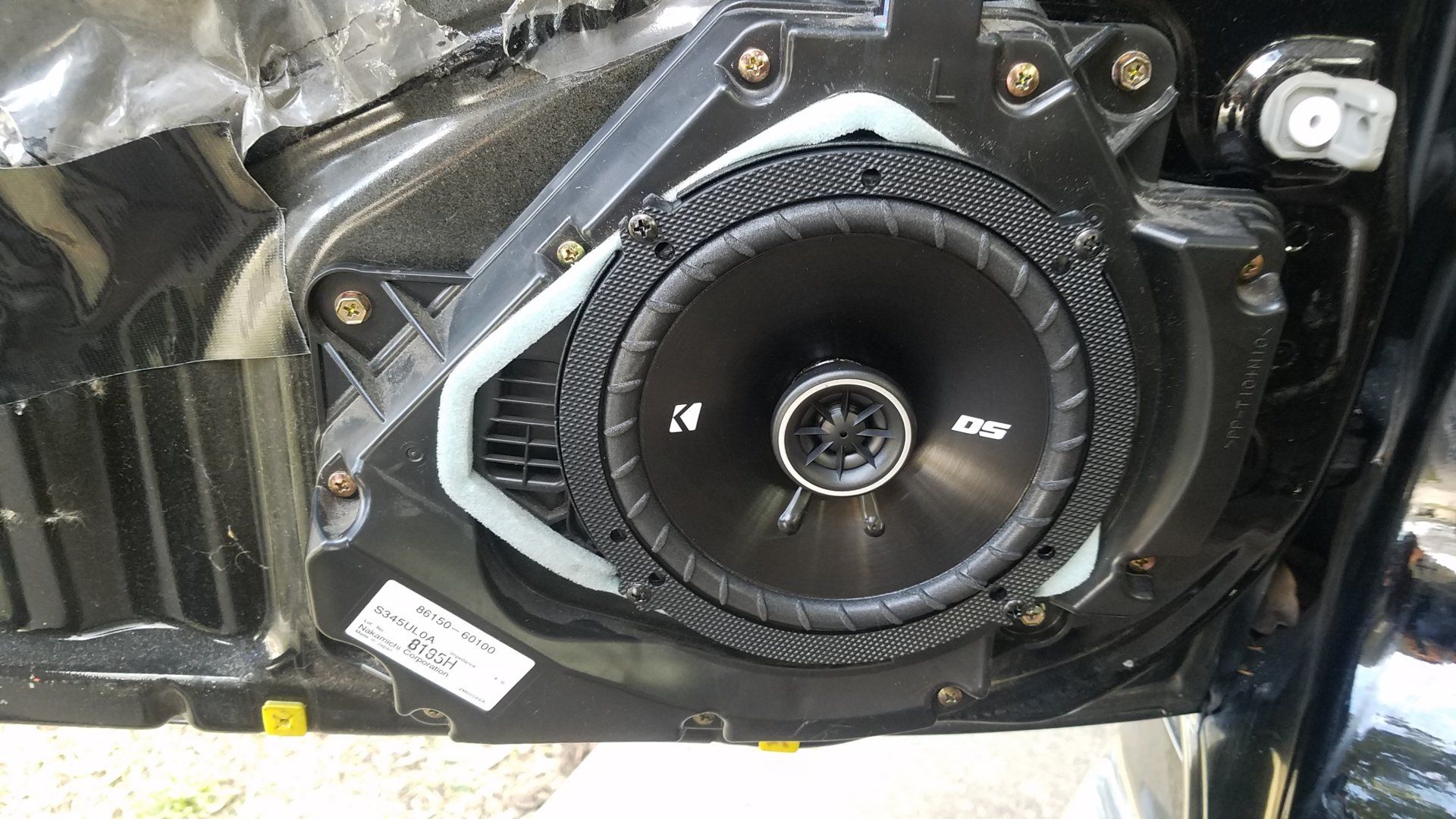

Speaker swap
Not an audiophile so just looking for an upgrade with no major modifications
Found 6.5" kicker speakers that dropped right into the nakamichi cradle. Screwed them in and reinstalled the door panels

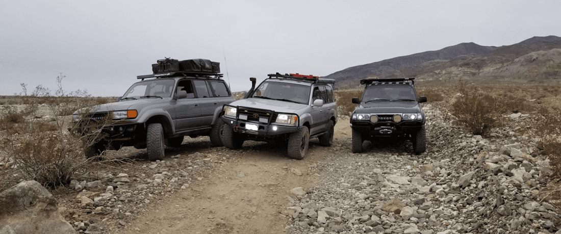

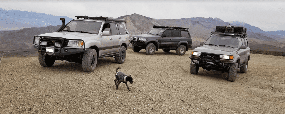

Did the annual death valley trip - 4 days
San Diego to Trona > Balarat > Jail-Canyon > Panamint > Lippincott pass > Racetrack > Ubehebe > Furnace creek > Echo Canyon and back to San Diego
Looks like a great trip!

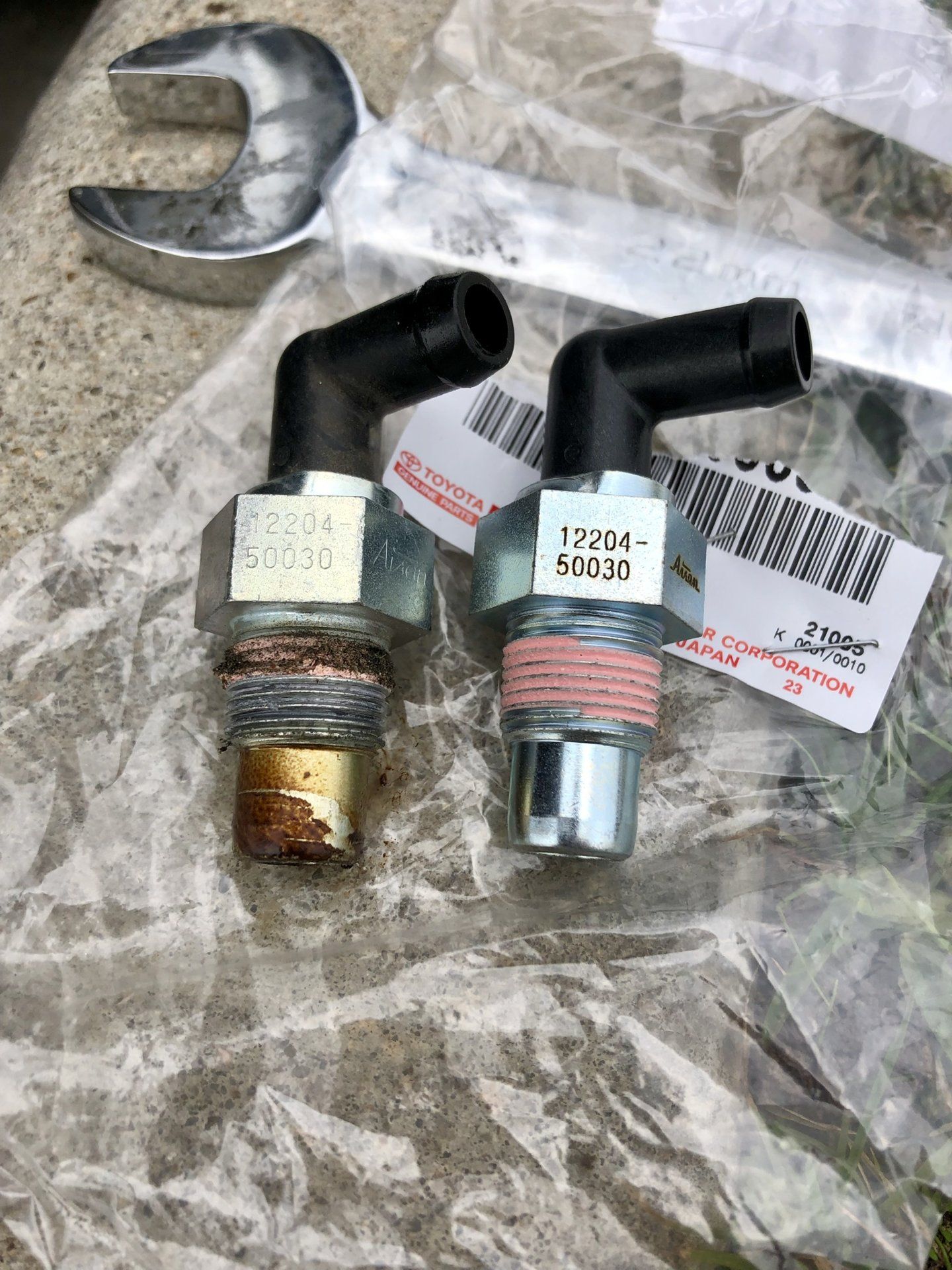

All for an outrageous $12 and 8 grueling minutes of my time, I replaced my ‘06’s PCV valve (no grommet required for ‘06-‘07s)!
There was no reason for its replacement, other than OCD stemmed from recently replacing all of the nasty 27-yr-old PCV components on my other vehicle.

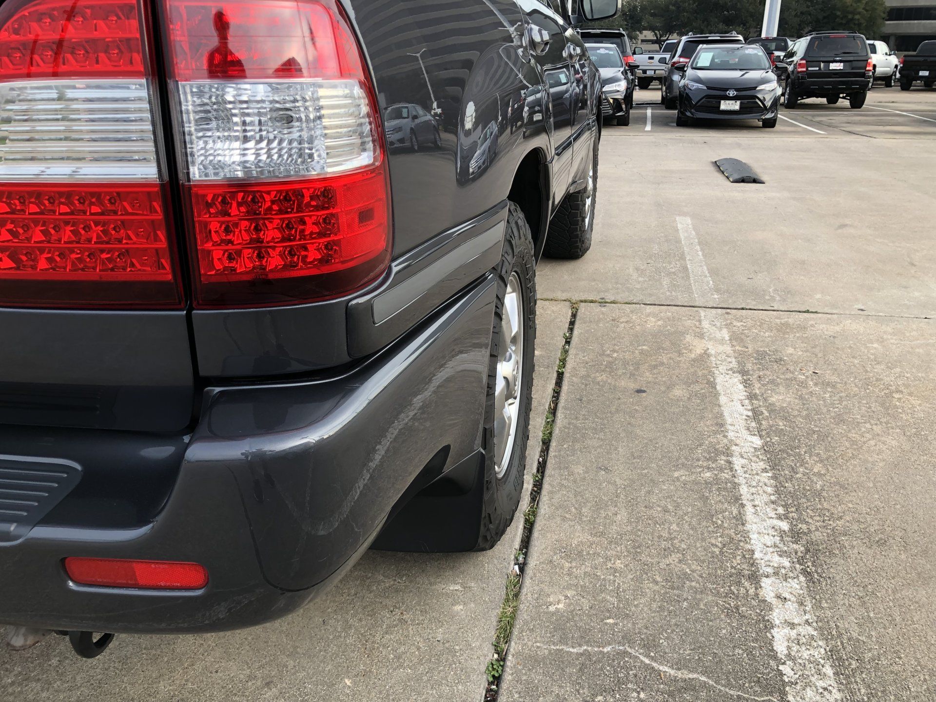

Next, noticed a strange snapping/clicking noise similar to that of which a bad CV joint can make, which occurred when going straight, and turning left & right. So, I took it to the dealer to investigate, and they found that the CVs were perfect and decided to take off the Spidertrax wheel spacers... Lo and behold, THEY were the culprit to the noise. I suspect when they were removed for a brake job at Slee a while back, loctite wasn’t used!
(Tucked look is killing me—this won’t last long)

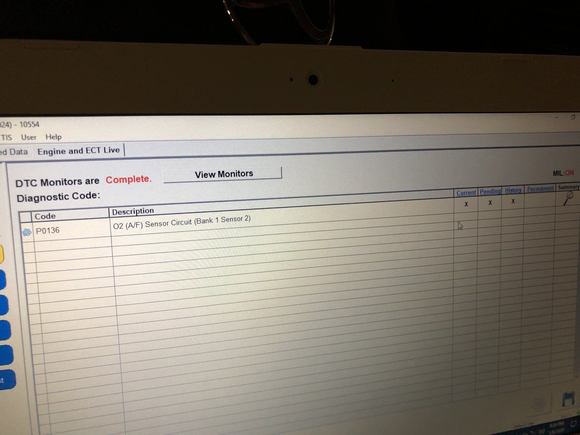

Then got a string of dash lights when driving down the freeway, so I hooked Techstream up and found: bad O2 sensor (bank 1, sensor 2).
______________
Just ordered all 4 O2 sensors because what the hell, and also think I found a great deal on (upstream & downstream) Bosch O2 sensors. Hope these’ll bump up my god awful (for a near-stock setup) fuel mileage, too!
Upstream O2 sensor ($76): https://www.amazon.com/gp/aw/d/B000CF5Z2G/ref=cm_cr_arp_mb_bdcrb_top?ie=UTF8
Downstream O2 sensor ($55): https://www.amazon.com/gp/aw/d/B0028MN5IM/ref=cm_cr_arp_mb_bdcrb_top?ie=UTF8
(These work for ‘06 & ‘07s—not sure about other MYs)
