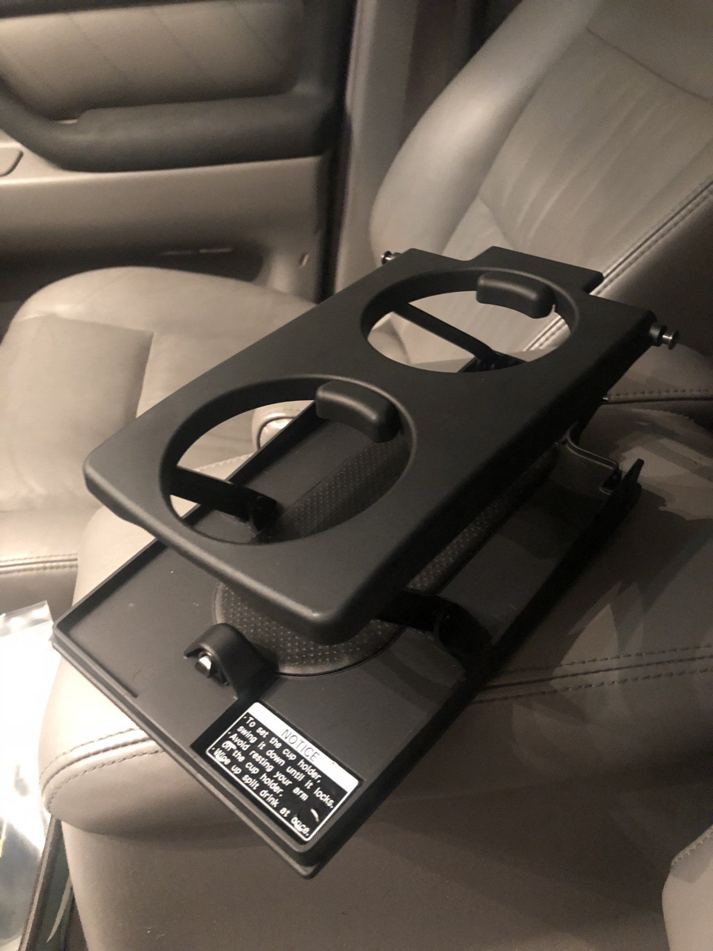

Nothing too technical, but removed OEM cup holder from center console and added Wit’s End organizer. Anyone need a cup holder?

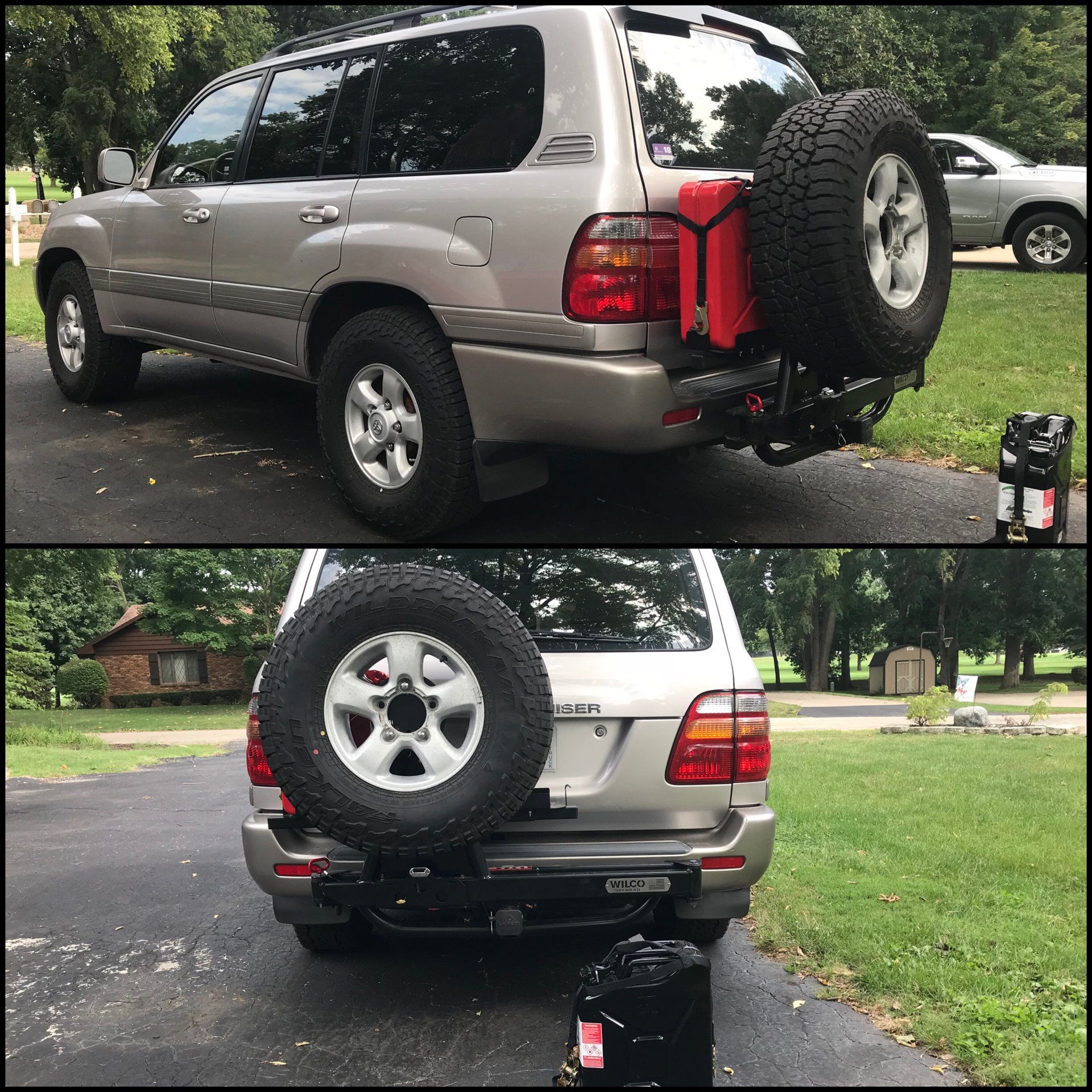

I bought this Wilco offset tiregate. Paid $450 on Craigslist. Came with two jerry cans. Good quality, I like the look, affordable, good resale (even jeep guys can use it).
Wow, nice score! Looks like their prices have gone up too. $960 for the Offset.

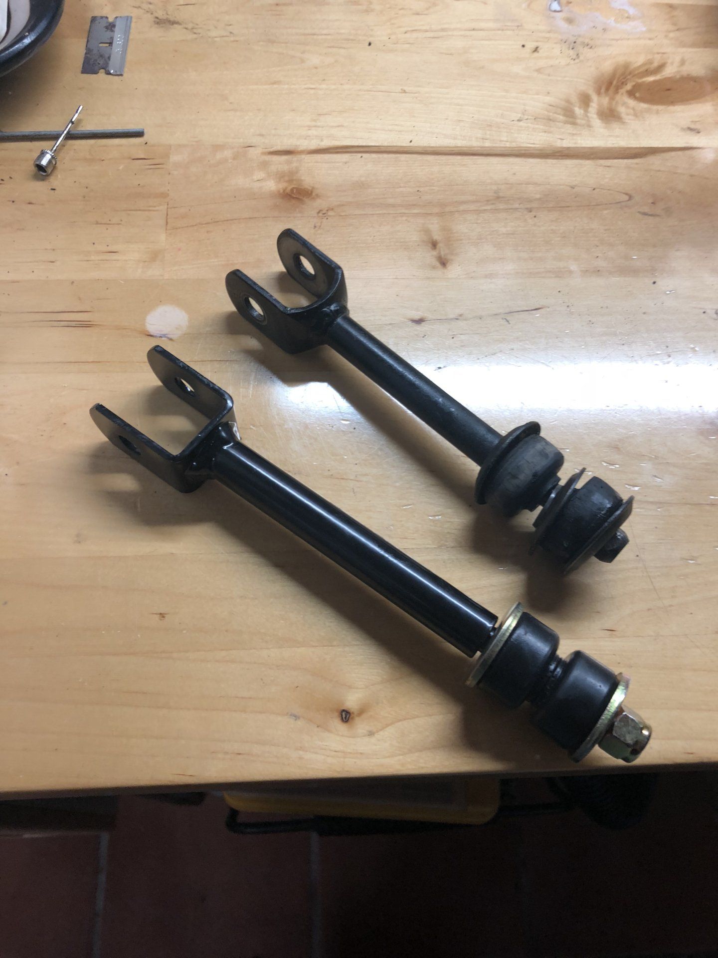

Highly recommend for those with the full lift. Initial impression is they got rid of the jittery, slightly nervous feel overall For the front, save some time and take both off at the same time to rotate the bar down.
I wasted a lot of time trying to install one at a time.
The rear were a little easier but the top nut is a pain in the ass.
Well worth the money.

Is that the original sway bar link pictured next to the new extended TT?
If so you definitely got your money's worth from those bushings.

Yup, and they look like they are almost 20 yrs old.
I still need to try them off pavement, but this is the way I wanted this truck to drive.

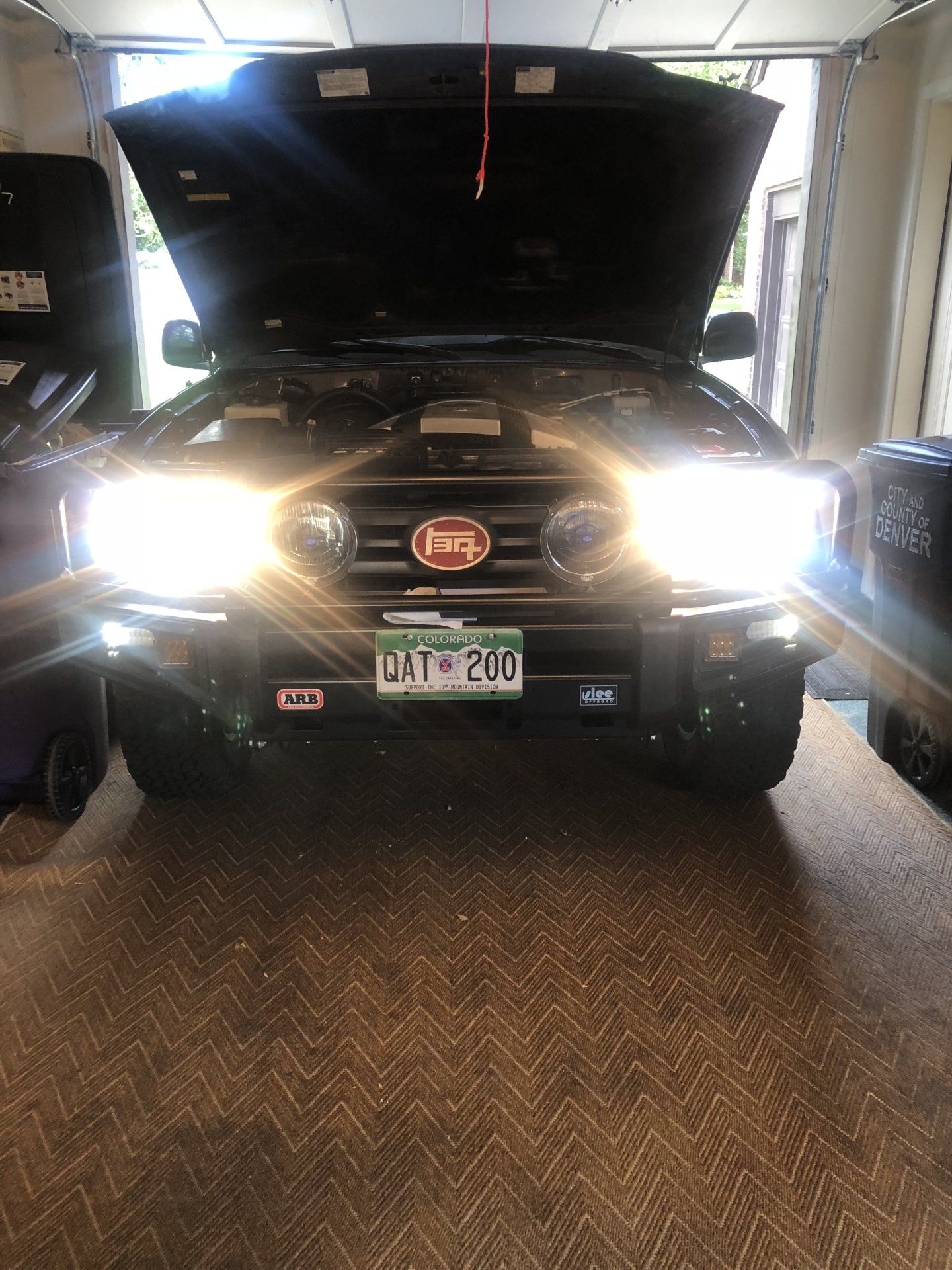

Today, I went farther and installed 2006 LED bulbs from LASFIT in the LS series HB4, rated at 90Watts to produce 10,000 lumens in the 6000k color. Very easy to install and look to be a much brighter light. Will report back once the snow flies and see if they blind me in snow, but right now I am just happy to have more brightness from my low beams.
