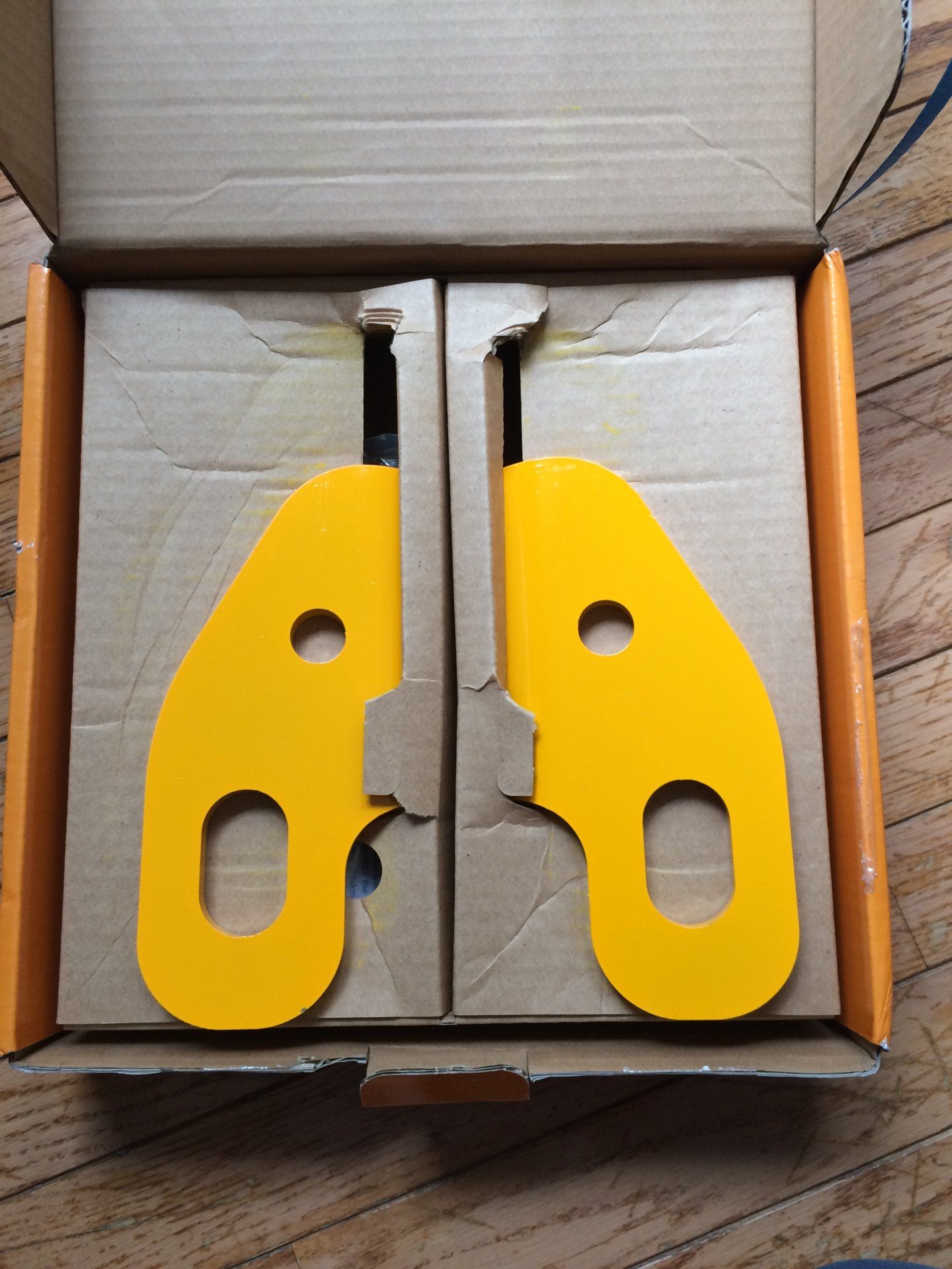

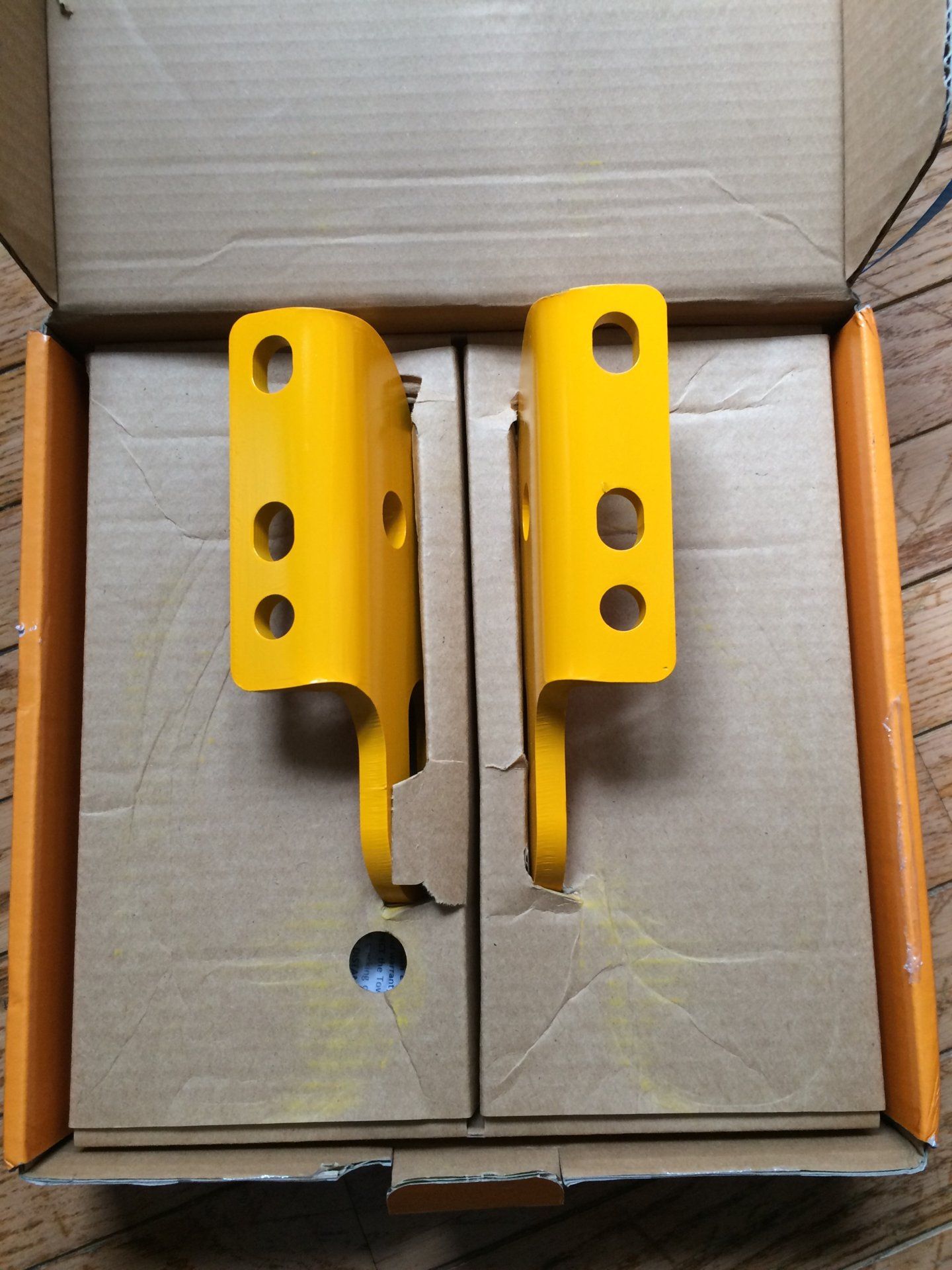

I plan on running synthetic / soft shackles so I had the anchor points ground smooth - I asked for a chamfer like TT but they didn't want to take away from the "integrity of the design" - although this sounded more like liability protection on their end
Because they were ground down they had to be repowder coated - I asked what other projects they had going on - 2 sets of wheels one in matte black and one in ultra black chrome.
With a name like that of course I went with ultra black chrome

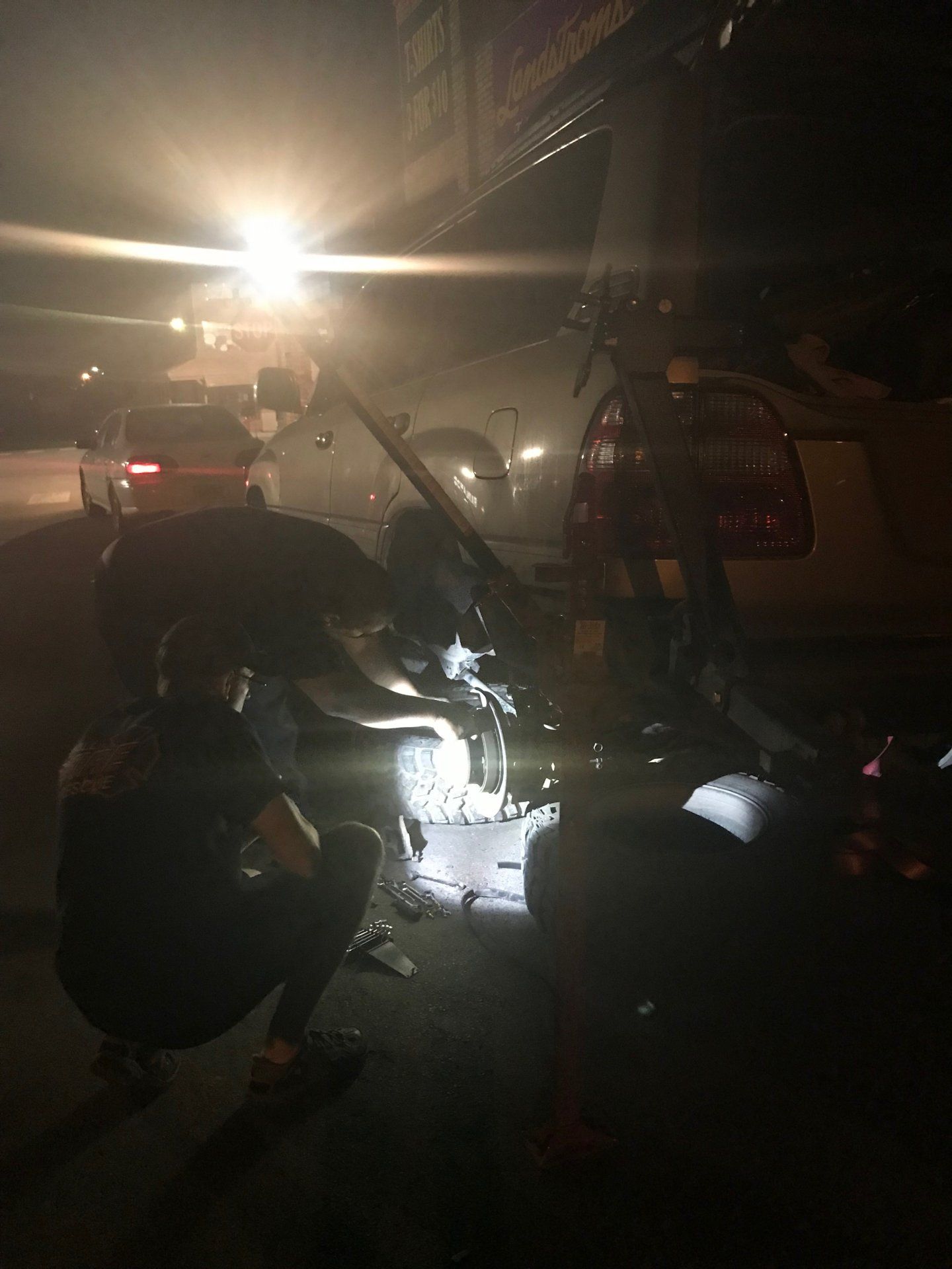

This happened on the way back from our Colorado/Utah/Nevada trip. We suspect foul play as I had just gone through the brakes before leaving and torqued everything to spec....and there were some shady characters eyeing up the Cruiser at the hotel we stayed at the night before.
3 sheared studs and a 4th that sheared when I tried removing the lug nut. I was able to scavenge some studs and nuts from te spare tire carrier and a local kid ( I was at Wall Drugs in South Dakota of all places) stopped by and held the flashlight

Nothing worse than a thief. But at least there were some good people to help out. Silver linings, and all that.

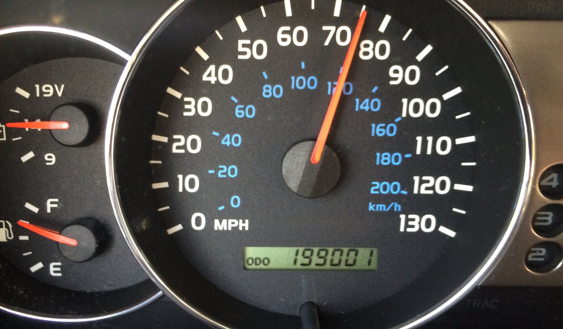

Added this 100 along side my wife's LX about 10 months ago - have driven well over 20k miles in that short time.
Only repairs outside of routine maint have been heater T's (preventative) and rear brakes.
Don't let the miles fool you.
Exactly! I don't blink an eye at a high mileage cruiser with the right maintenance history. Hands down, best car I've ever owned.

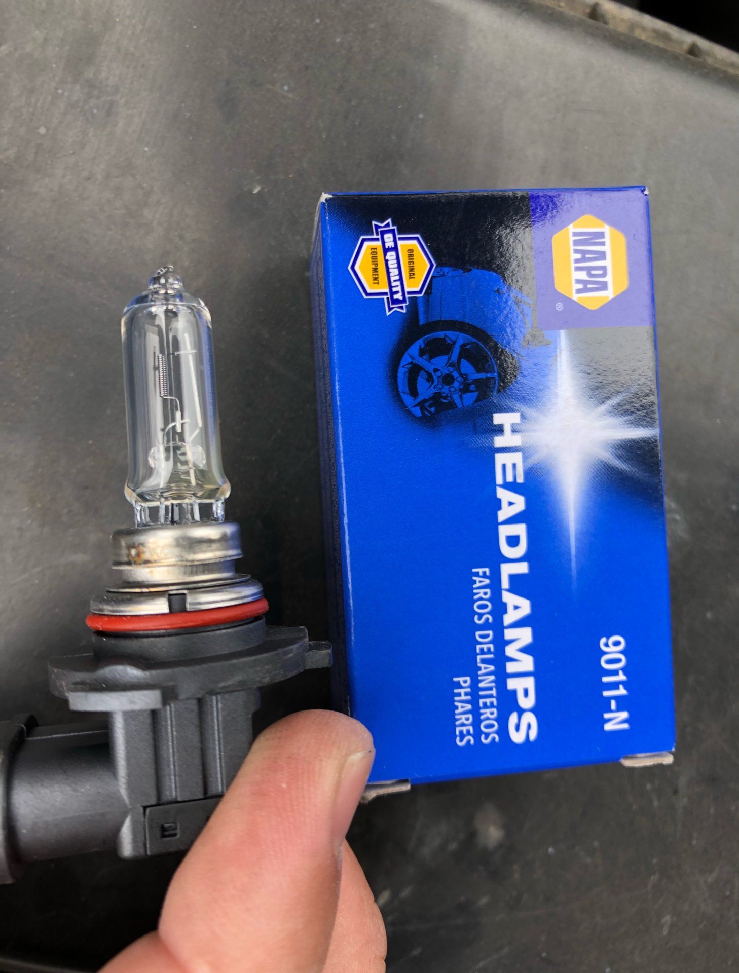

I swapped out my Nokya 2500k 9005 HB3 1700 Lumen high beams for NAPA 3450k 9011 HIR 2100 Lumen bulbs. Not only are these so much brighter than the yellow Nokya lights, but they seem twice as bright as the OE level Philips that were in the LC100 when I bought it. Color is perfect and the overall coverage seems larger as well. $40 for the pair is a bargain.
