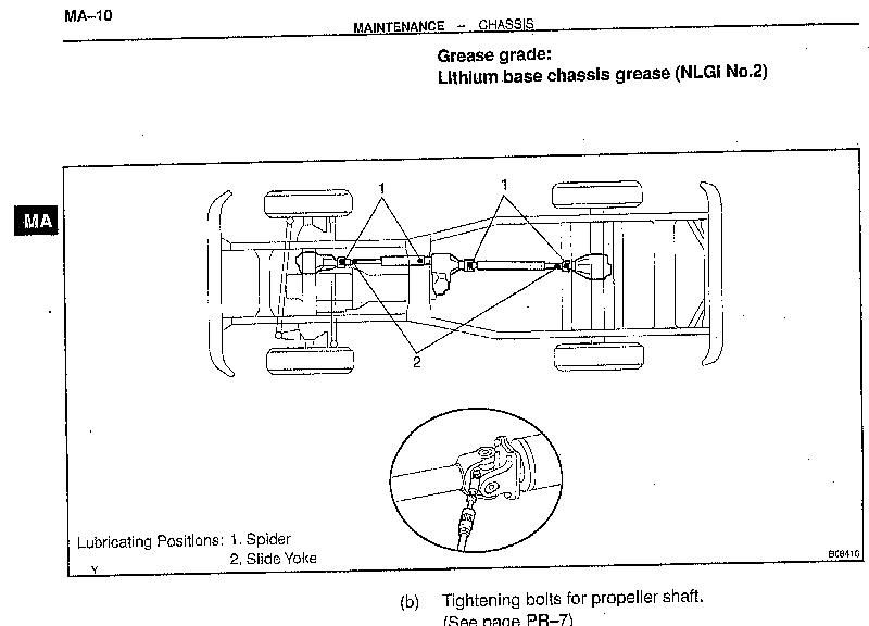

Why is your rear drive line in backwards?
That was the way it was when I started. My old Ford truck was the opposite direction. After a quick look around mud it looks correct. See the picture and sheet from a manual.
^^^ orientation depends on transmission.... according to FSM. Whether it really matters, I don't think so.
I swapped mine around so the grease points on the front and rear are closer together- (less crawlin' under the truck) also keeps the rear slip joint out of the mud-sand-etc.
I don't think it has any impact one way or the other which way you orient them. Driveline shop confirmed this.

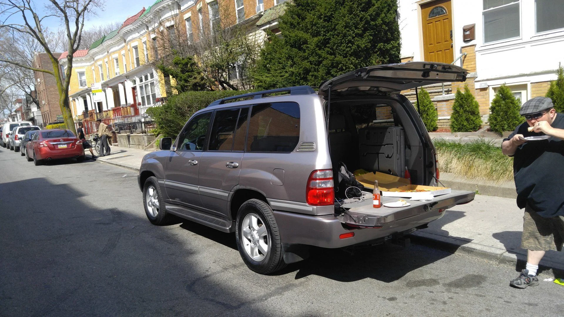

Bought it!!!! After a year of lurking and research finally in a 100.
Stopped at Difara pizza on the way home, if you're ever in Brooklyn go there!

Congrats on the Hundy and Difara's for the win! This photo of Sal is in my kitchen
