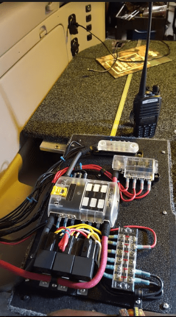

Finally got around to finishing up some old projects. Wiring of the rear aux distro block. Took care of some current 12v needs and made provisions for future growth. Tucked it all underneath the ARB drawer side wing away from all sorts of possible easy interference. Since everything was off, decided to give sound deadening a try...just one of those things I guess. Focused mainly on the wheel well to combat those death valley washboards. Also upgraded my gauge lights with some warm white LED's....Sure brings some life back into the dark "Cockpit"
Nice wiring job!

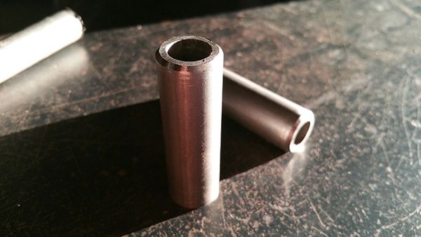

Received some sway bar links from @abuck99. I will extend these 2" with HD DOM tube.

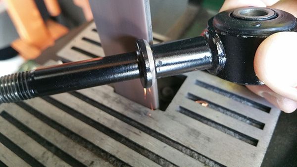

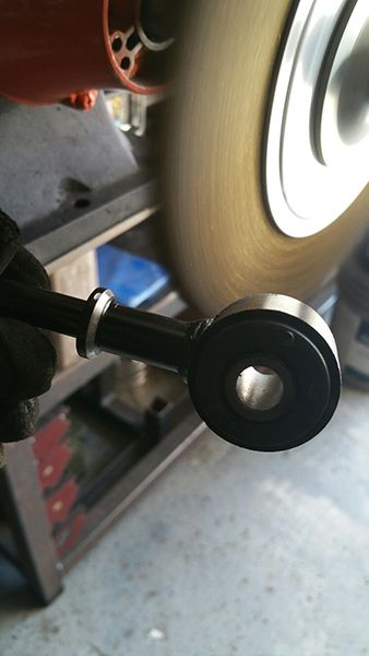

Made mine 1.5" longer than stock:
Was like $7 for the DOM tube and about an hour of my time including paint. I used aftermarket links. Not weld porn, but these were for testing the length. They worked so I well I haven't made nice ones to replace them. I whipped up a pair for the rear also. Way cheaper than buying.
