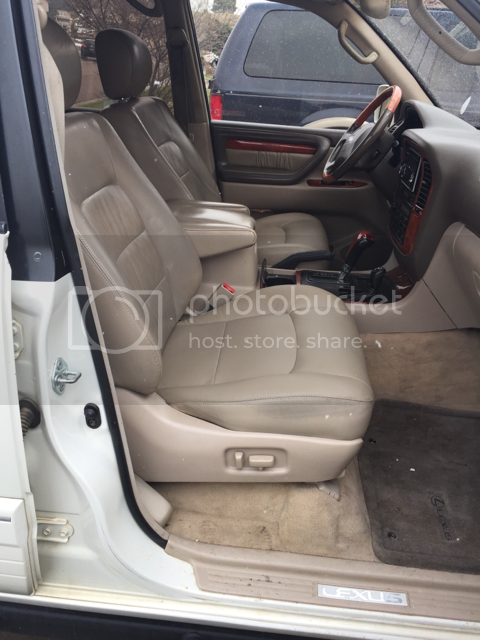

Had the bottoms of my front leather seats redone. Timberline in Colorado Springs did a great job. Long time coming.

pic please and if you don't mind cost?
thanks

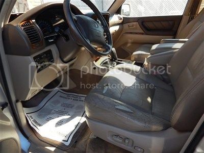

Hi I have a before and after picture, actually the driver's seat got a lot worse by the time I found someone to redo the front seat bottoms. Cost was $625 parts and labor, bottom of seats only.
before:
after:
