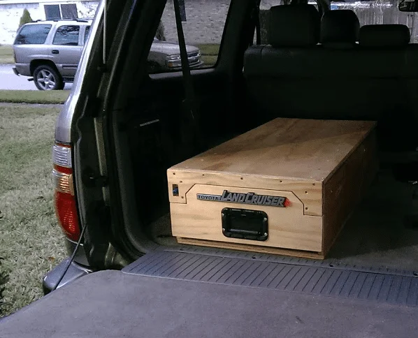

That is a sweet drawer!
Thanks I'm pretty happy with it. This was the third one! finally was happy with the outcome except for one defect. Since its not a "closed" box there is some outward flex on the top since the slides give a little. 500lb locking slides at top and 100lb on the drawer.

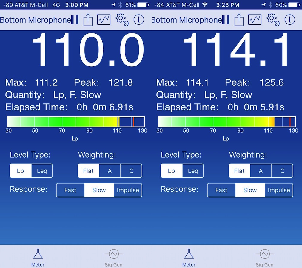

Replaced the factory horns with 200 series horns. Decent improvement - before (left) and after (right) measurements (flat, not weighted):

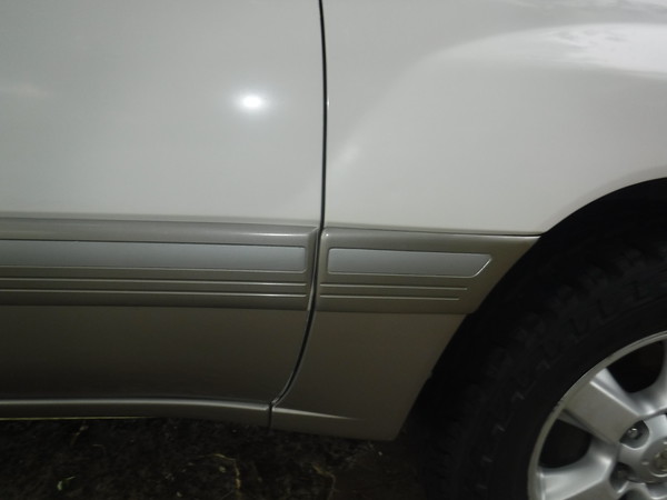

Painted the center of my body trim with Plasti Dip Aluminum. My 100 spent much of its previous life in a parking lot. The trim, especially the center part, was in terrible condition. Not just faded, but had some black spots where the silver was completely gone. I seriously considered the $700-800 for new trim. The trim now looks 1000 times better. Not perfect, but appropriate for an 11 year old vehicle. If they made a color to match the rest of the trim, I would paint it too. Hoping it holds up for a couple of years at least.
i ordered a rattle can of color match from here:
Touch Up Paint and Accessories | AutomotiveTouchup
shipping was slow (probably b/c aerosol), and i haven't gotten around to doing it yet, but if the weather holds this weekend i will be.
