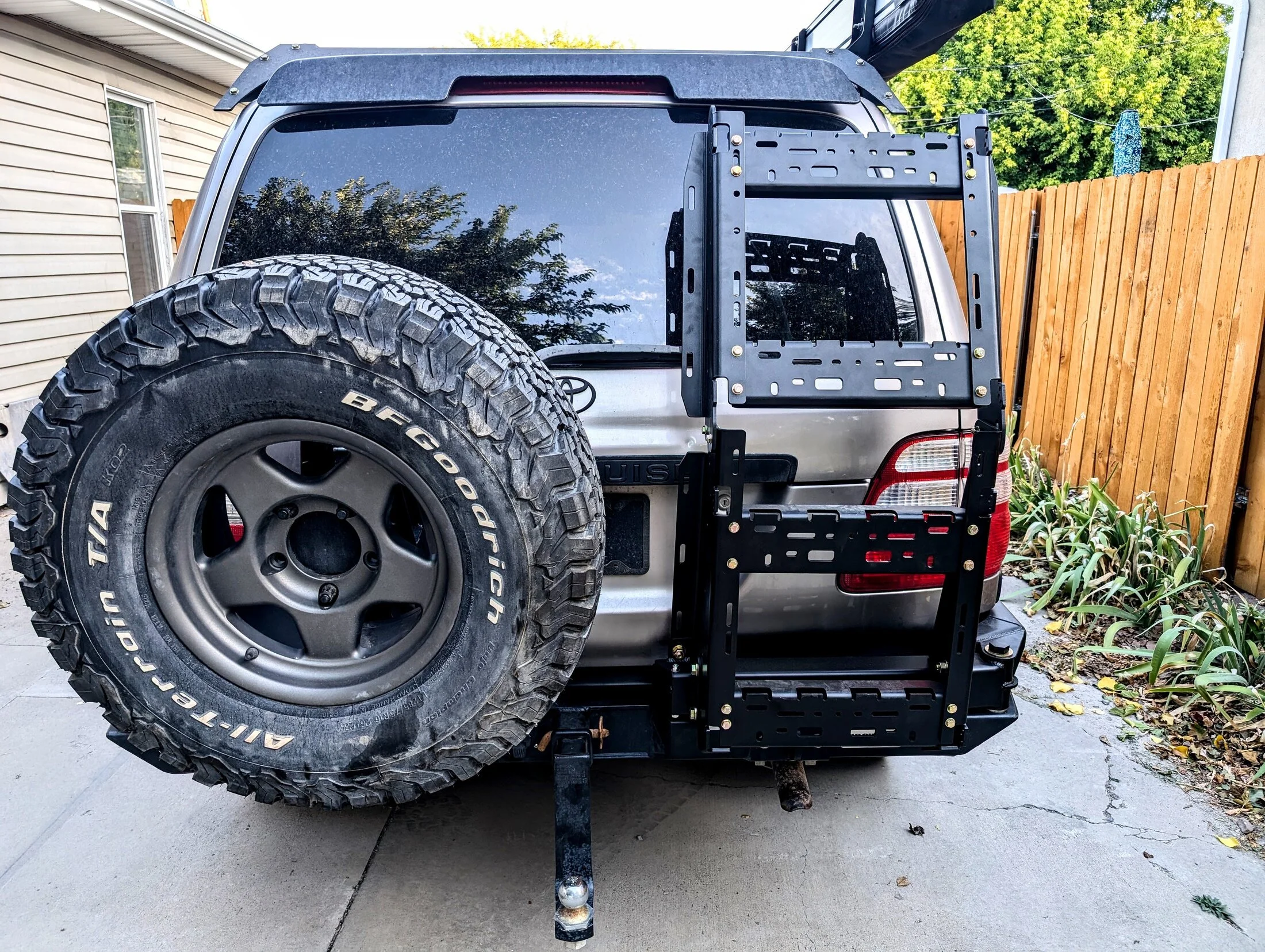

Got the Dissent ladder swingout installed, working up a new reverse camera location and wiring:

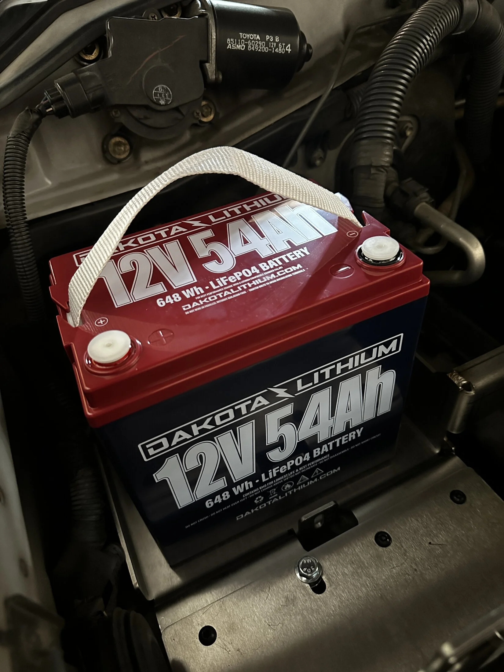

I’m using a Slee dual battery mount and their Redarc BCDC mount in a different orientation.
I’ve seen a few videos of people running Lifepo4 batteries under the hood despite it not being recommended. With prime day sales I said f it knowing I may well cook it at some point.
To combat this I went with a smaller 54ah Dakota Lithium battery which gave me plenty of room to build a heat shield using Design Engineering form a barrier. It was easier to work with than expected and for a first try came out pretty good. May redo it and/or add their gold reflective tape in the future.
54ah lithium had more capacity than the group 35 AGMs Slee recommends. I’ll also be running an Ecoflow Delta 3 power station in the rear with their alternator fast charger (their version of a Victron DC converter). That will be wired to the house battery so the start battery is isolated. It’s a bit redundant but I like that. Can add solar to charge the EcoFlow or the Dakota battery via the Redarc BCDC.
Right now I’m just test fitting everything. I’ll do a dedicated post when I have everything done.

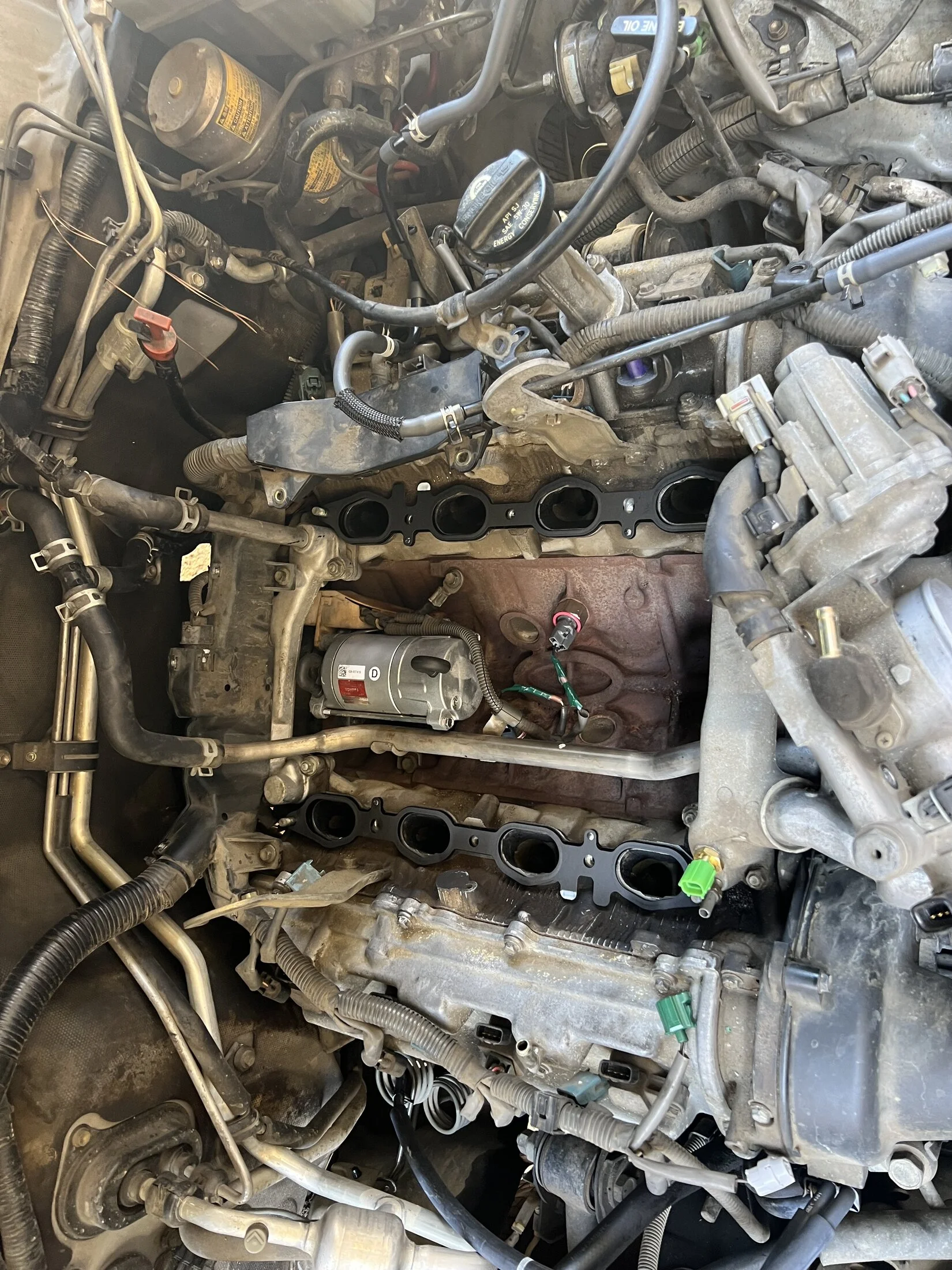

What happened with plug number eight?
Not spark plugs!
The starter plug, both knock sensor plugs, water temp sensor plug, and a few others. I soft fingered them as much as possible during disassembly but they were just too brittle and crumbled. I had a struggle to identify part numbers but the oem plastic plug housings were easy to do the depin and repin process to so it wasnt bad.
Not spark plugs!
Ah, nice work! It's a great idea to replace those old connectors while you're in there. For future reference the number molded into the plug is the last half of the part number. The first half is the same for most/all of them. I think it's 90980-, but it's easily searchable on Mud to make sure.

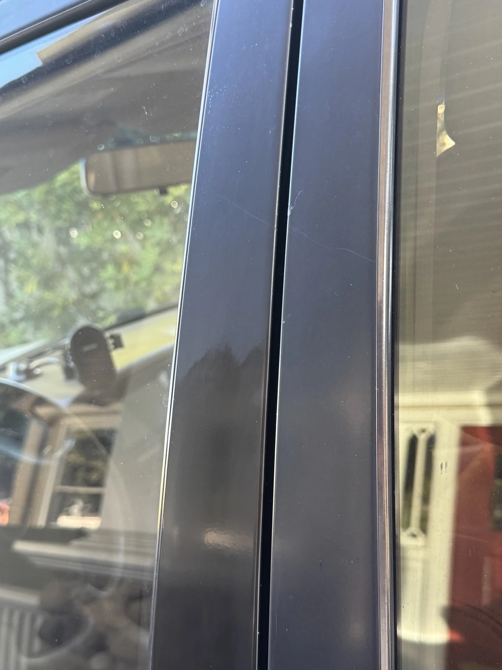

Just gave it a shot with “Once a year polish” on the faded doors. Gave some shine back, let’s see how it keeps up.
Bad idea man. I used to do that on my old 97 Avalon. Looked amazing like in your picture. Long story short the paint all faded and failed after a few years. It’s thin paint to begin with and the more you polish it the thinner it gets and more susceptible to failure.
