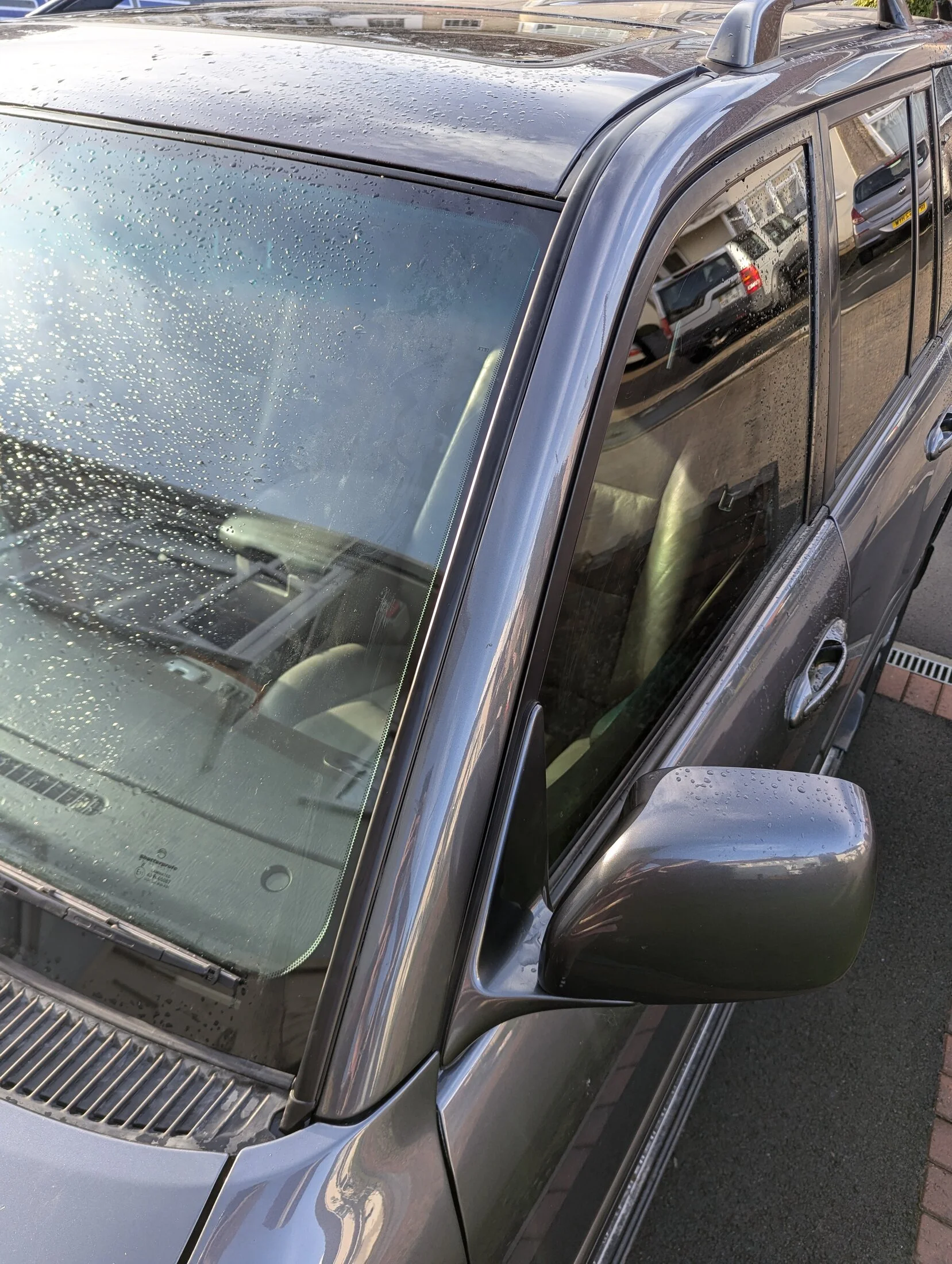

After last week's windscreen installer decided he wanted to avoid the task of fitting the mouldings/rivets, I had a windscreen guy visit who's been doing it for 40 years and has done plenty of these thankfully.

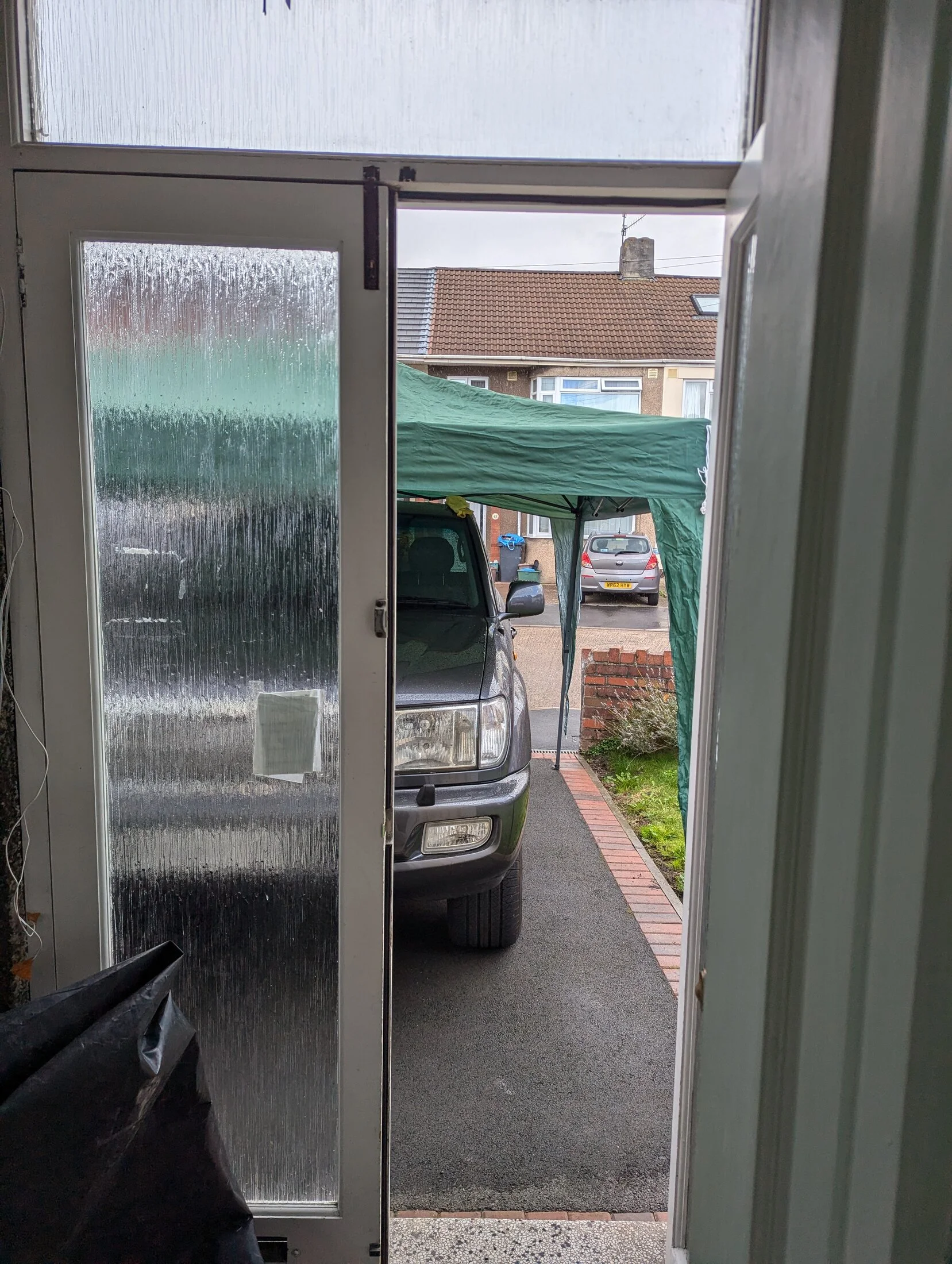

Nearly got rained off but I pulled the pop-up marquee out the garage and the rest is history!
Turns out all of the holes were bigger than factory which is why the factory rivets weren't fixing in place properly when I tried myself on the weekend (a bit of vindication for me!). The installer had to fit large rivets and use some appropriate grade sealant but they are all looking much better and it's now firmly in situ.
I'm hoping it's now watertight but I expect it will be which is a massive weight off my mind!
PS. there is a tiny bit of flaked paint along the upper lip of the windscreen area, this is being addressed, but underneath the windscreen itself all bits of rust were fully cleaned up and treated.

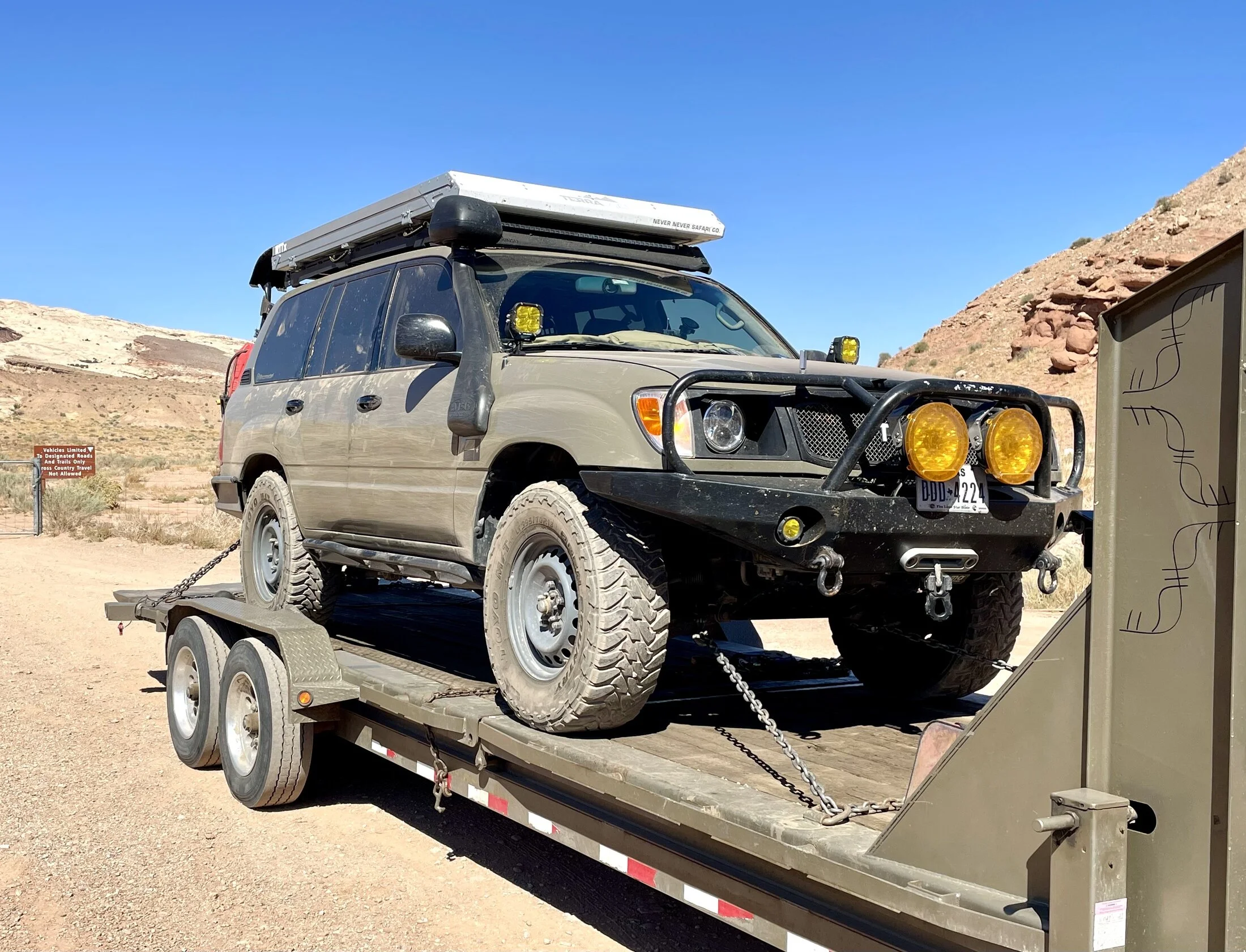

Moab trip cut short by twisting apart the rear driveshaft AND grenading the spider gears on the front differential on the same obstacle! Got it back together enough to drive it back to Texas, and now the real repairs begin.
There is more to this story that NEEDS to be told.....how did you drive it back? No front diff and no rear driveshaft?
Pulled drive plates and front driveshaft off, installed a new rear driveshaft and then drove it 1,000+ miles back to Austin.

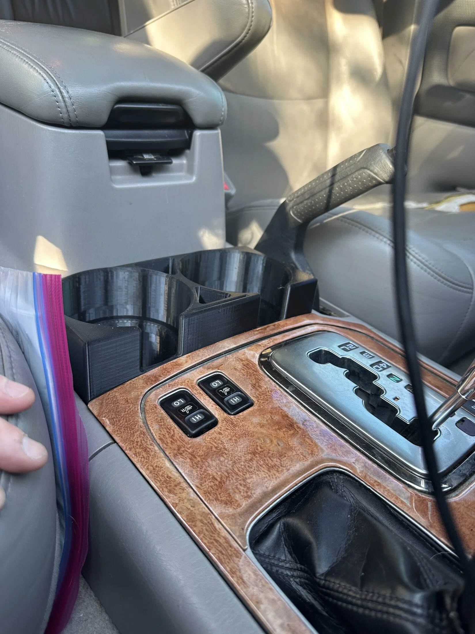

Installed the cupholders

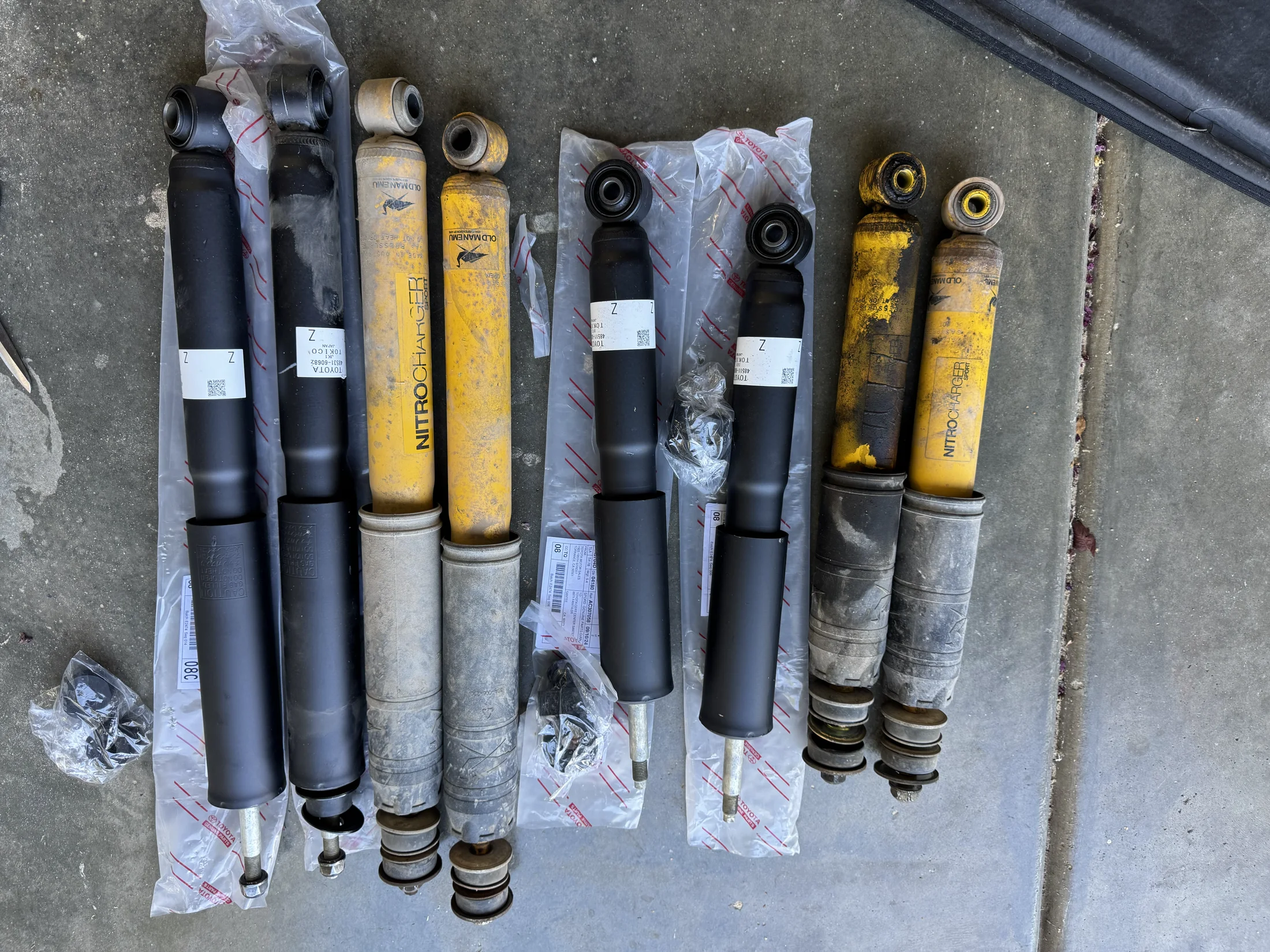

Been having problems with AHC this year and after a flush that didn't change some of the behaviours, I decided to go analog and ordered the IronMan Foamcell with diff drop.
Pretty easy install, aside from the nightmare of removing the rear. Also, removing the accumulators and some of the lines was a pain.
Got an alignment and rides smooth. Not as plush as the AHC, but also haven't had it fully loaded with people or gear for any camping/bike trips

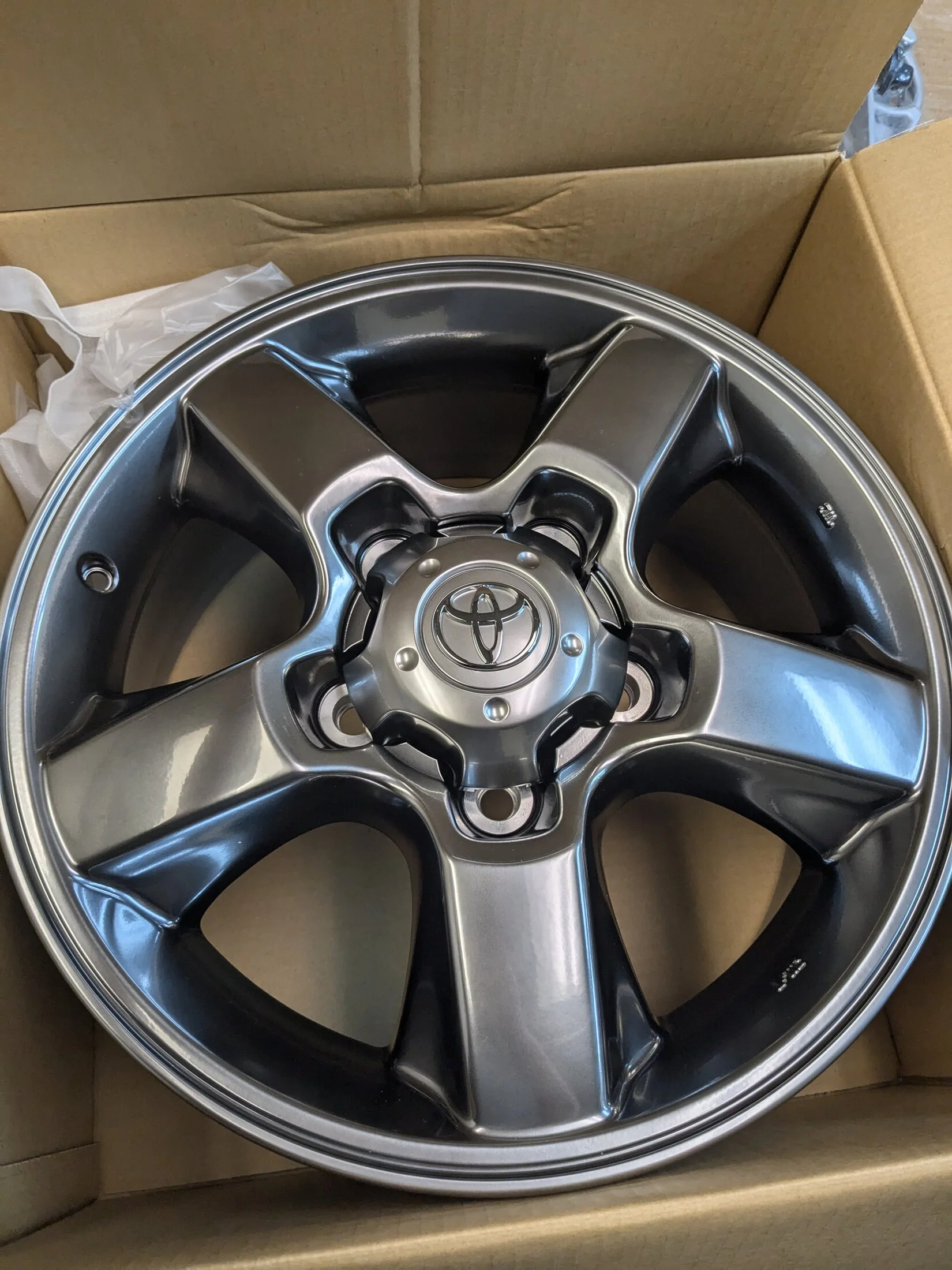

Me too! I have the full set of 4 wheels and 4 caps. I am having them ceramic coated before the tires go on.
I've had a few private messages on the wheels so figured I would post here. Surprisingly these wheels and center caps are still available from the dealer:
Disc Chrome Painted Wheel : 4261A-60160 QTY:4
Wheel Cap: 42603-60680 QTY:4
