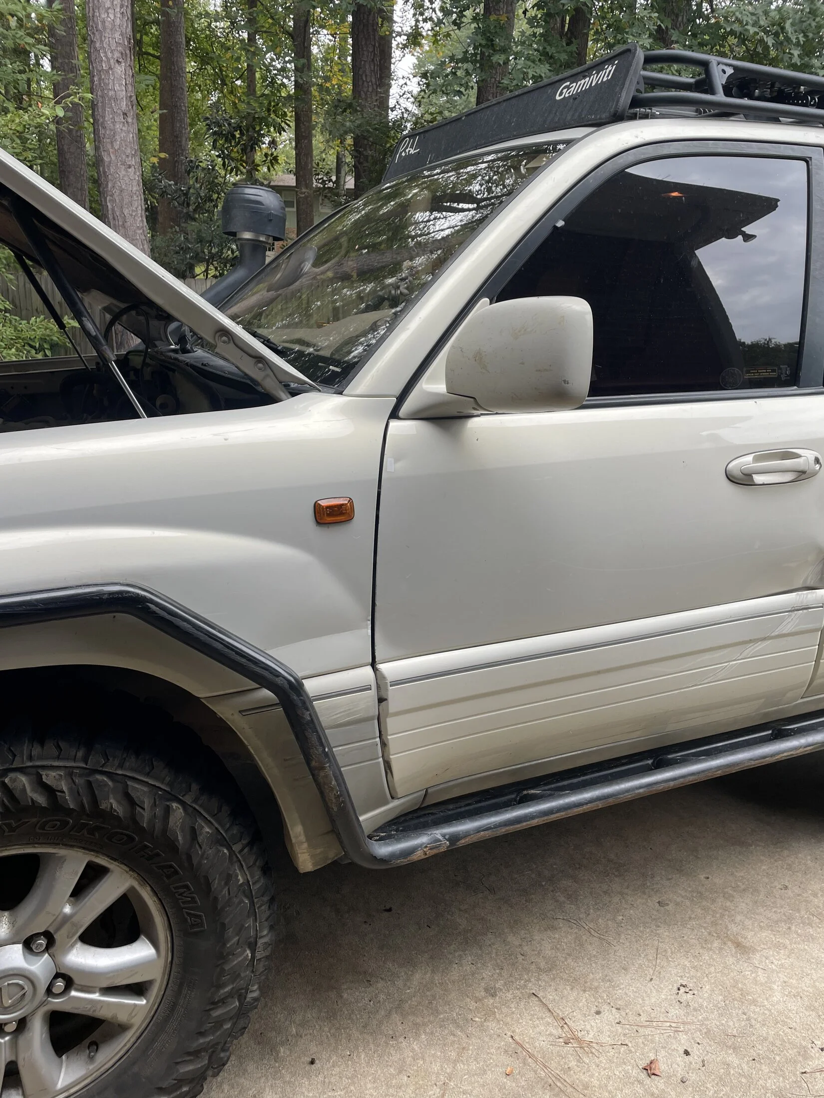

Adding OEM turn signals to my fenders for extra visibility (Atlanta drivers are more blind than I am)
I’ll be adding these in a kit to CruiserPatch.com soon. Also fits 70 series 🍻

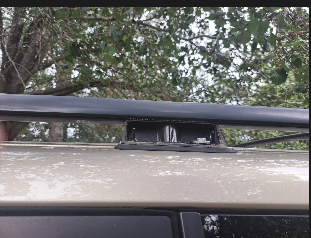

I owned my 100 Series for several months now, and am embarrassed to admit that I just now noticed that I’m missing the plastic cover on my factory roof rack. Are these still available from Toyota?

I owned my 100 Series for several months now, and am embarrassed to admit that I just now noticed that I’m missing the plastic cover on my factory roof rack. Are these still available from Toyota? View attachment 3739572
Last I lost I bought from parsouq, about a year ago, plug vin to get correct part.
Expensive little things to loose or break..

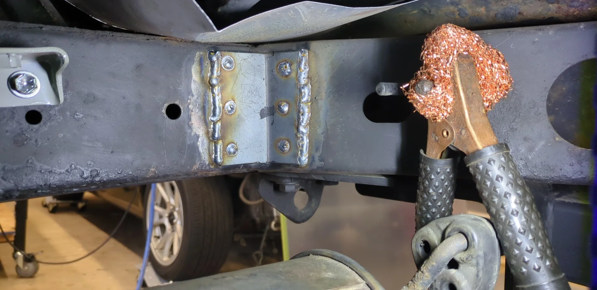

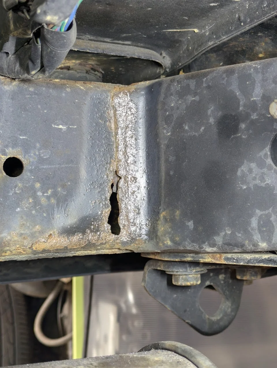

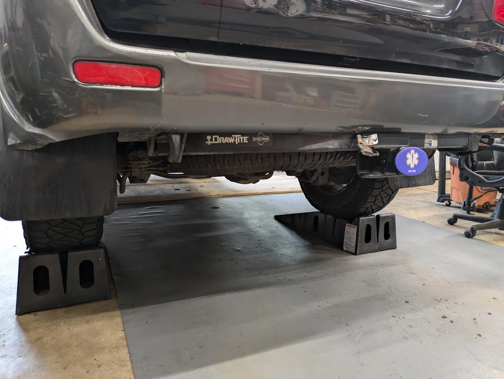

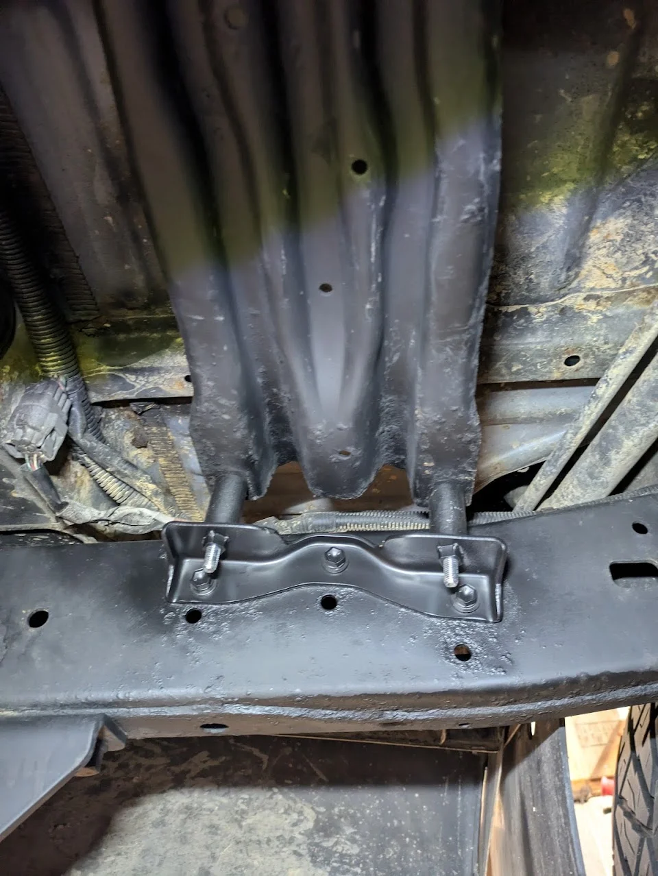

Finally finished raising the spare tire carrier and got the steelie spare that came with my Tundra rims mounted in place. The existing brackets were rusting away and I had to drill out three of the six bolts so as usual for anything underneath this truck, a 30 minute project turned into a few days. Also discovered a rust hole straight through a weld on the frame so I patched that up. Not the prettiest but it's stronger than a hole, so ...
It looks like my tow hitch is going to limit the size of a spare that I can pack under here. Not 100% sure an inch larger tire will fit so I might have to stick to 32s because that tow hitch sure ain't coming off.
I can't speak to that particular hitch, but I am able to squeeze in a 33" equivalent KO2.
