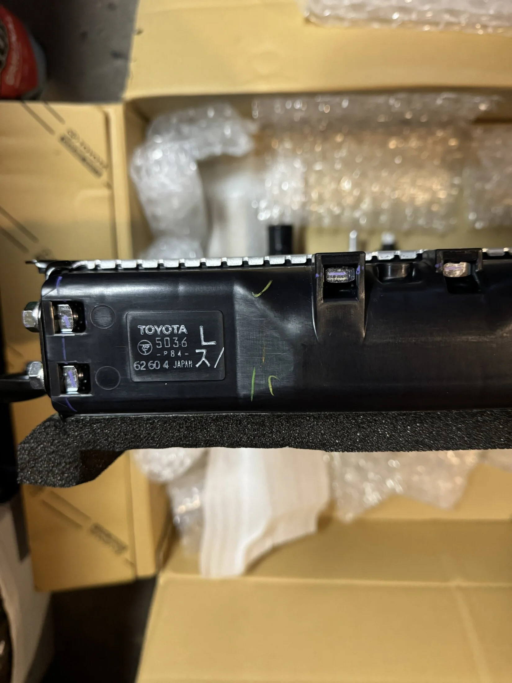

I used one of these...^ ^ ^I can confirm that it comes with the proper adapter for the 100 Series.
Installed on radiator, filled until it started showing a volume of coolant in the funnel...
Started the engine, turned front and rear heaters on, let it get to operating temp so
that the t-stat opens then just let it run for a while (also squeezing the upper radiator hose)
making sure the volume of coolant in the funnel didn't sink to zero.
Double-checked two days later and topped it off just a touch.

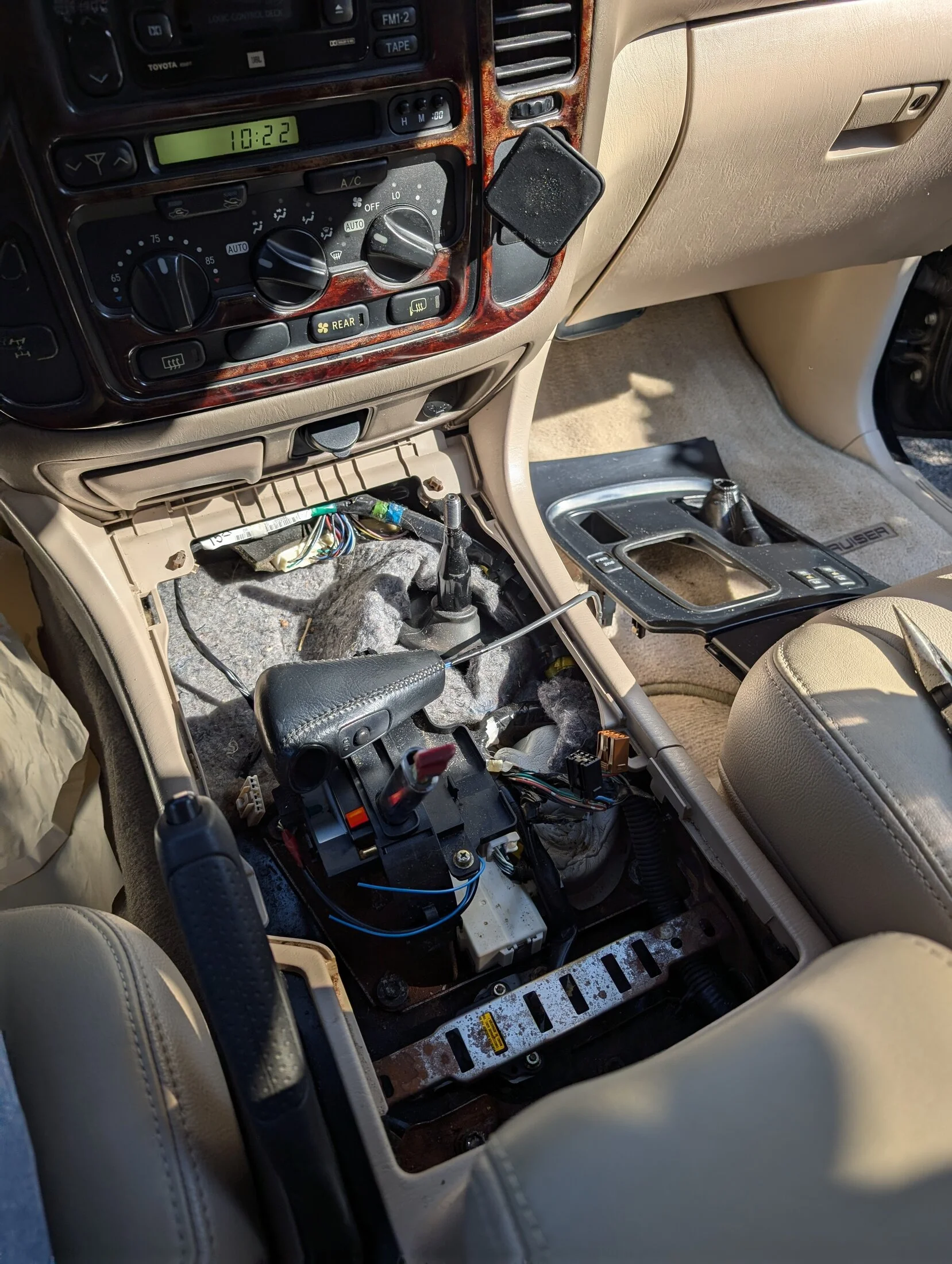

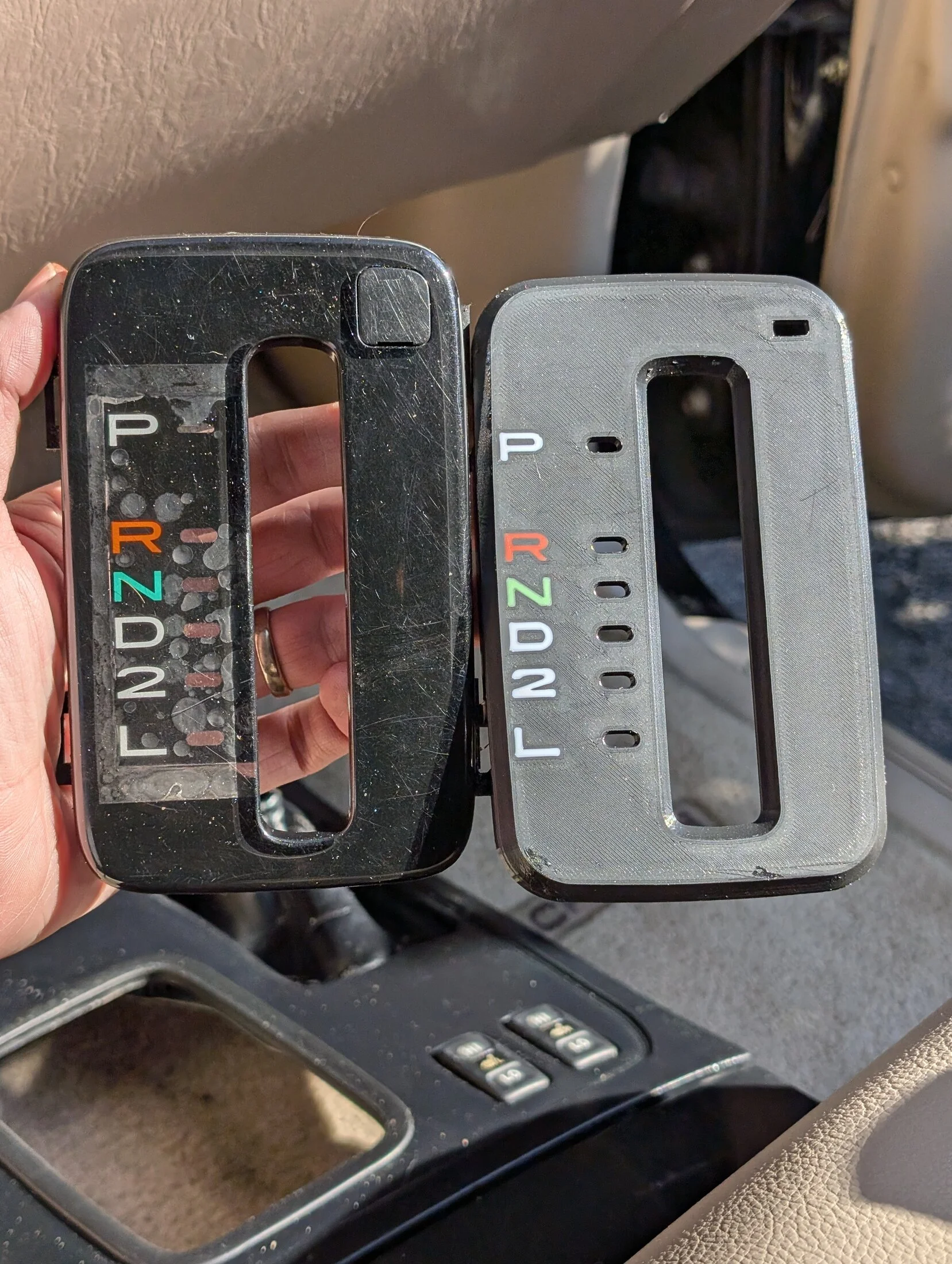

Replaced the shift surround over the weekend. One :banana:
Hardest part is just getting the little Wago connector right without having much slack in the wiring for the O/D button.
Also cleaned her up and installed a fresh sticker, zero :banana:
