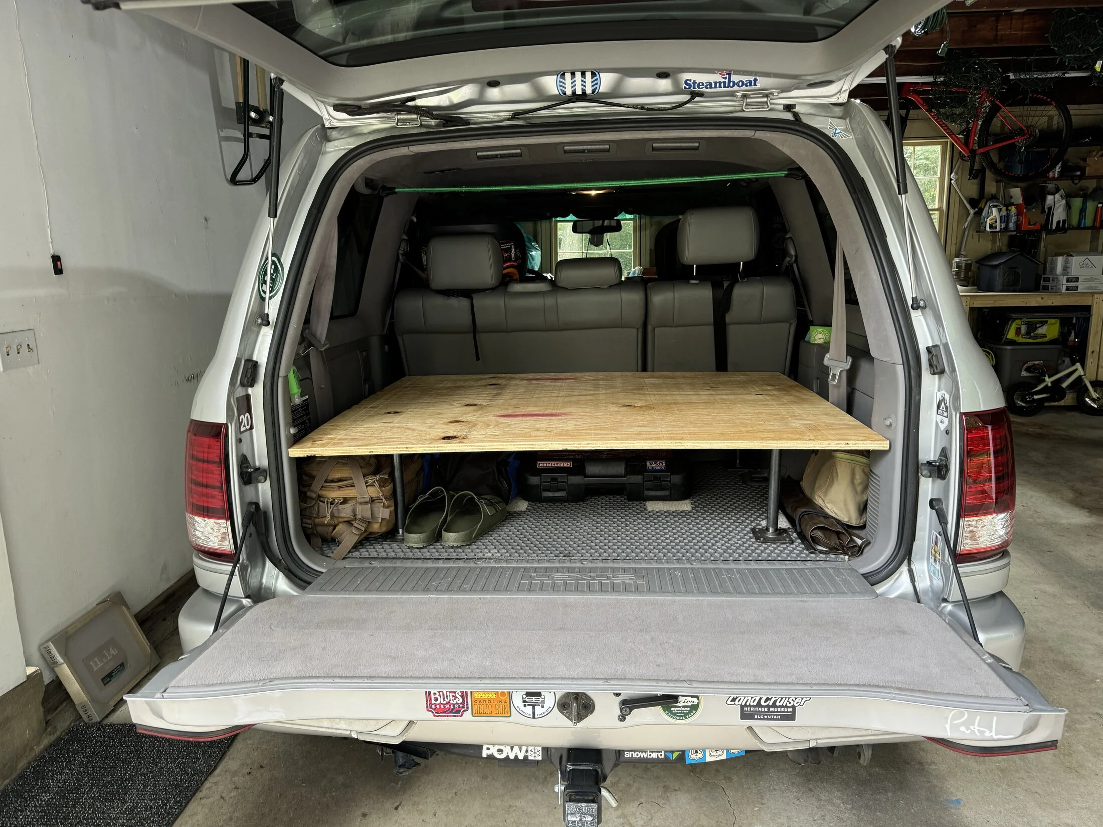

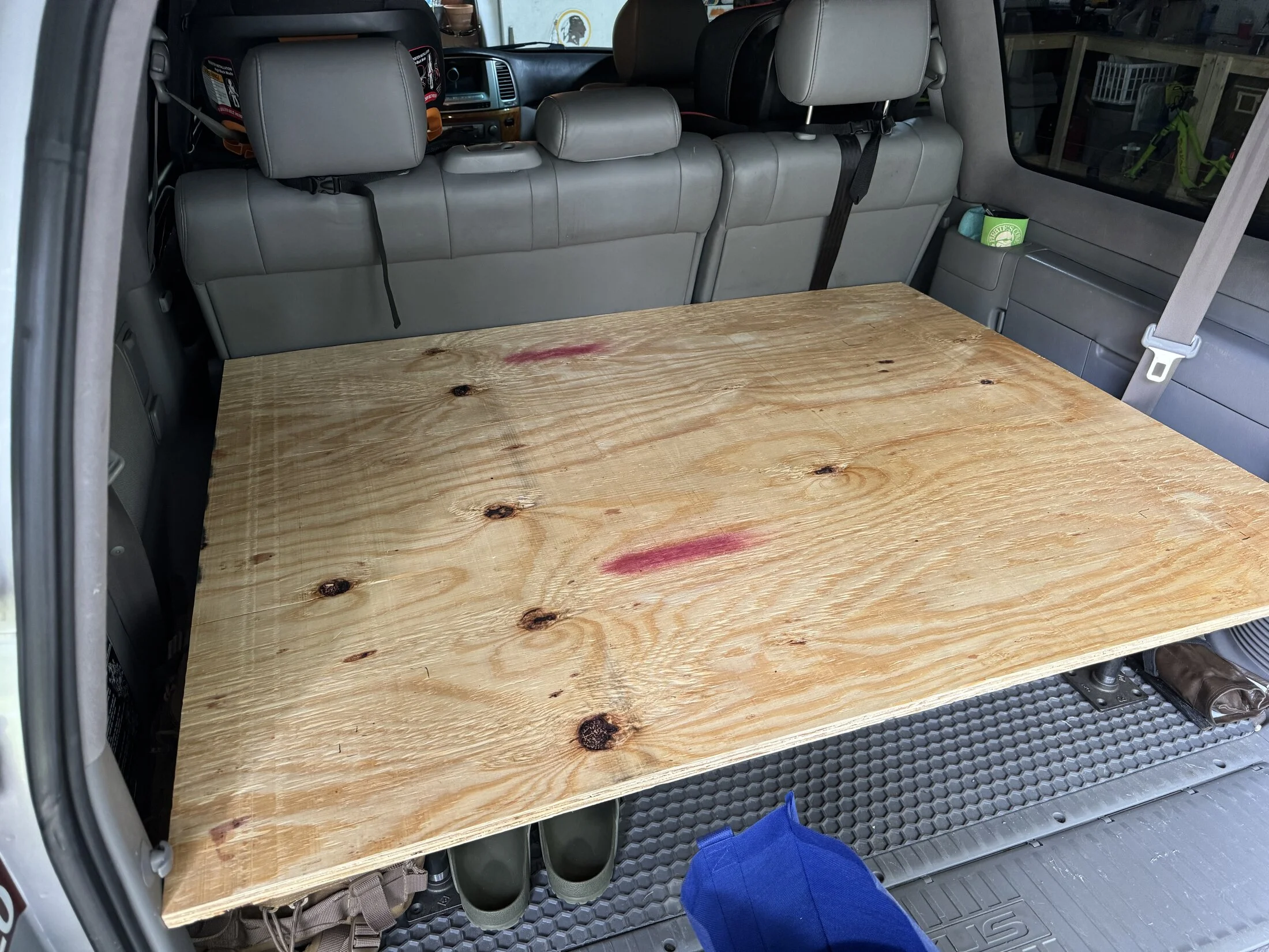

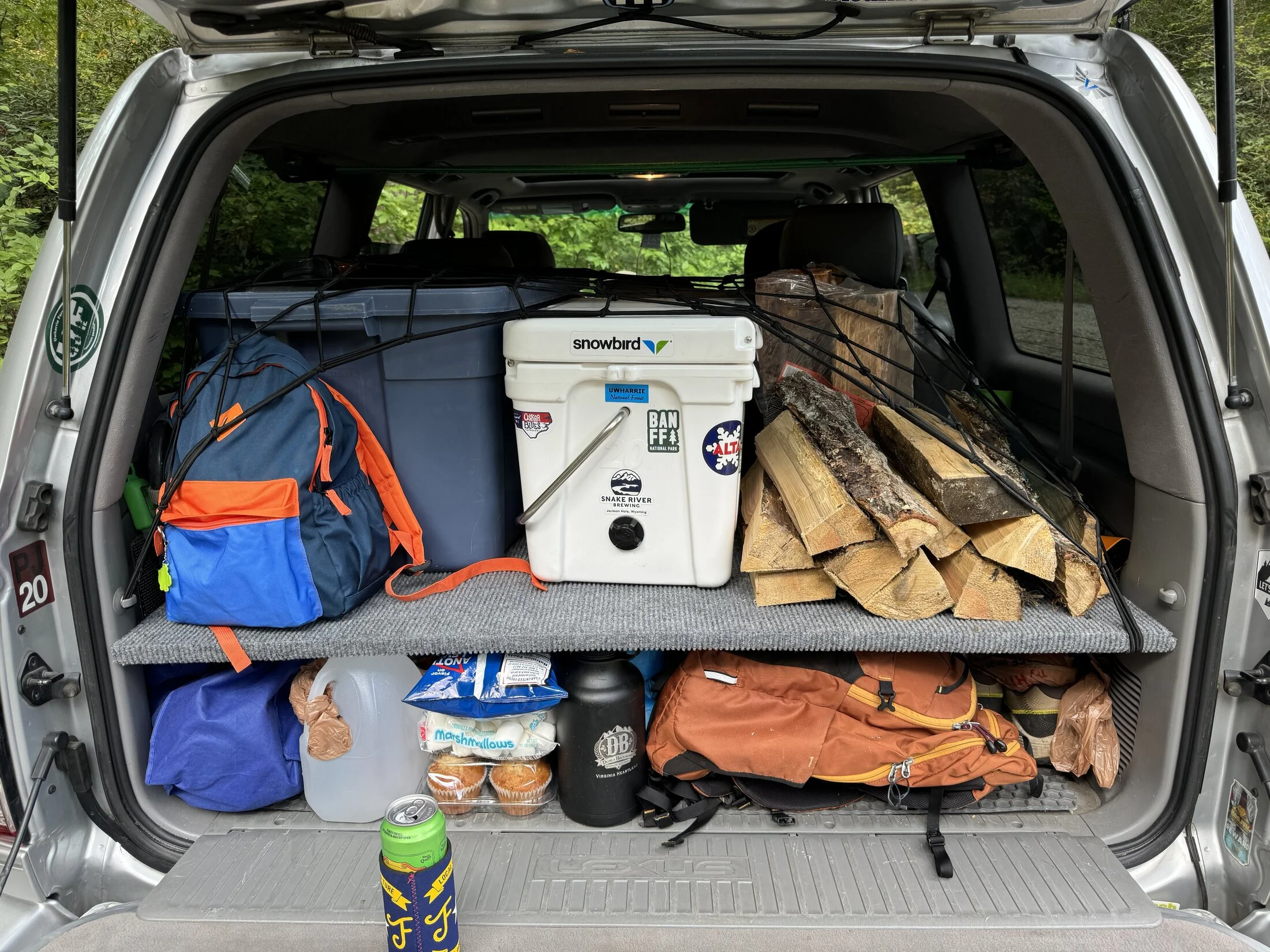

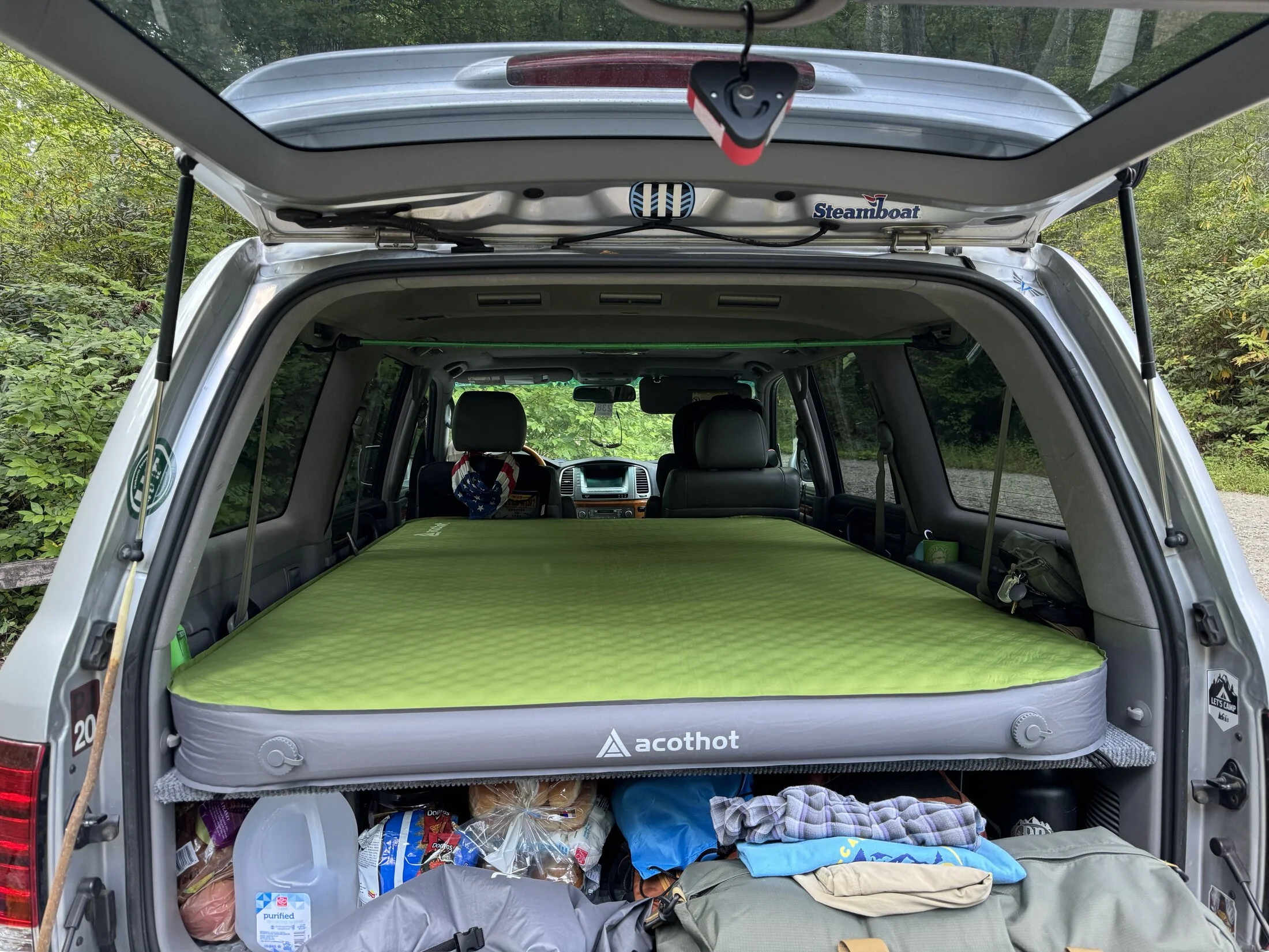

I built a platform.
I don’t like the permanence if drawer systems but wanted something I could throw a sleeping pad over and be able to store gear I always keep in the vehicle in an organized manner.
Here is the list:
42”x52” 3/4 plywood
4 10” x1” iron gas pipes, prethreaded
8 1” pipe pedestals
Roll of indoor/outdoor carpet
Glue & staples
Fits right up against the back seats with them in first or second recline position. Very minimal gaps between side of interior and deck itself. Perfectly level for mattress when resting in back of folded down rear seats.
I got 10” high cargo boxes that fit perfectly under the deck for my gear.
A 3’x4’ bungee net is a must. Probably all in <$150 and I can easily remove it if needed.

Cool. I have some hand sketches of building something similar with 80/20

simple and pragmatic! love it :-)

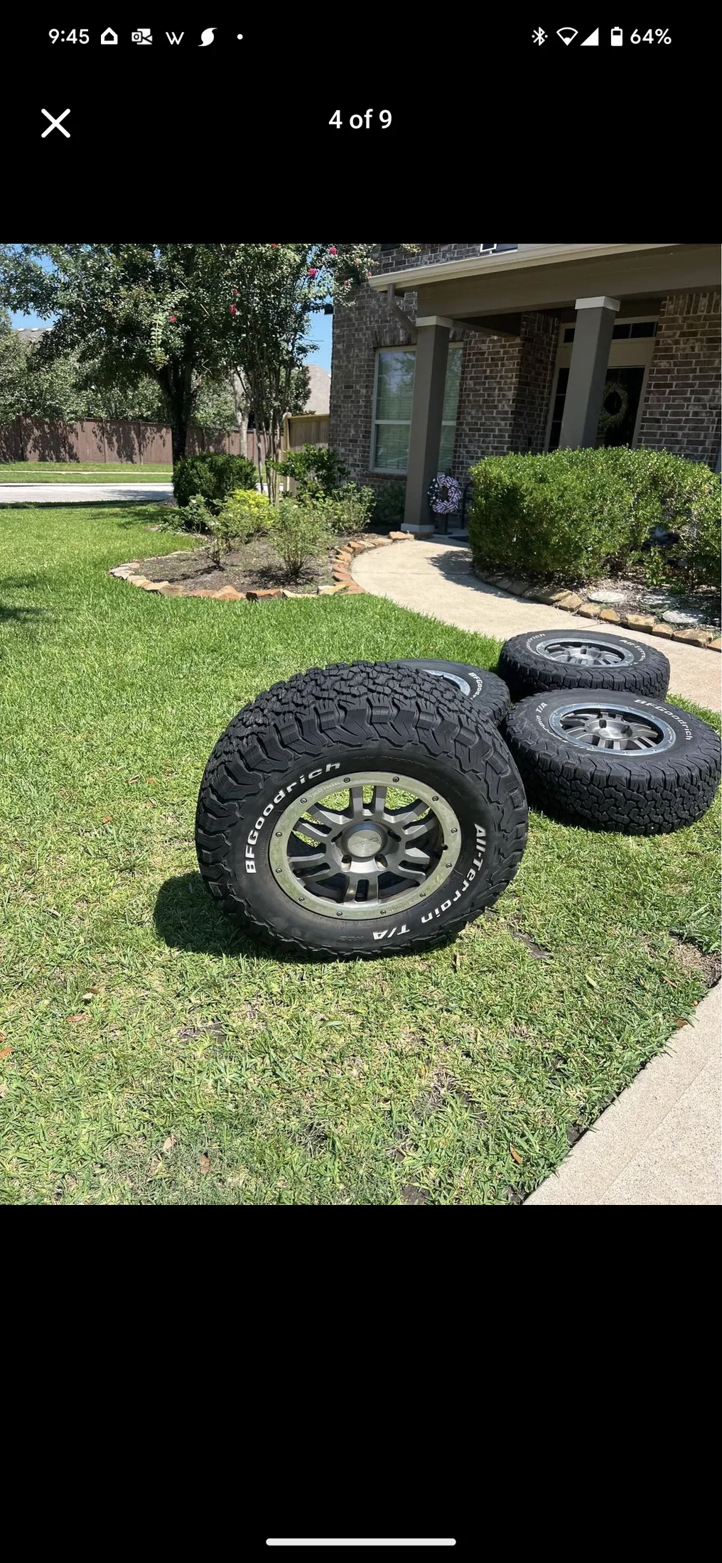

Picked these frim FB market place locally for $1000. Not a big fan of rock warriors but gonna give a try. Came with almost new 285/70R17 KO2s. I'll keep it if I can get rid of spacers currently on.

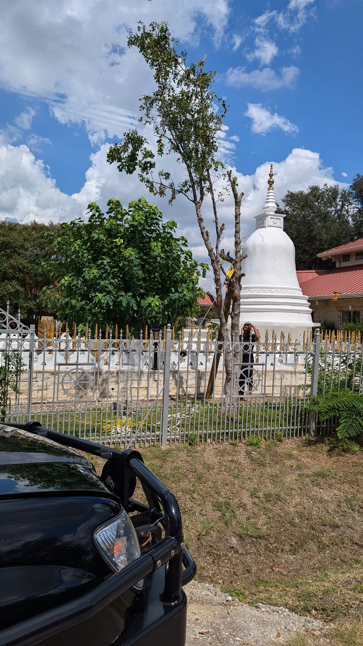

Another use of the winch. A friend badly wanted to save a treet pulled out from ground a side during Beryl. Straighten it even though I don't know it'll survive.
Where those Rock Warriors in Austin? Did they come with spacers? I think those may have been on my white 100 at some point! :)

Simple setup, nice. But I’m interested in the rubber mat you got there, can you share info on it please.
No, picked up from a Tundra owner.

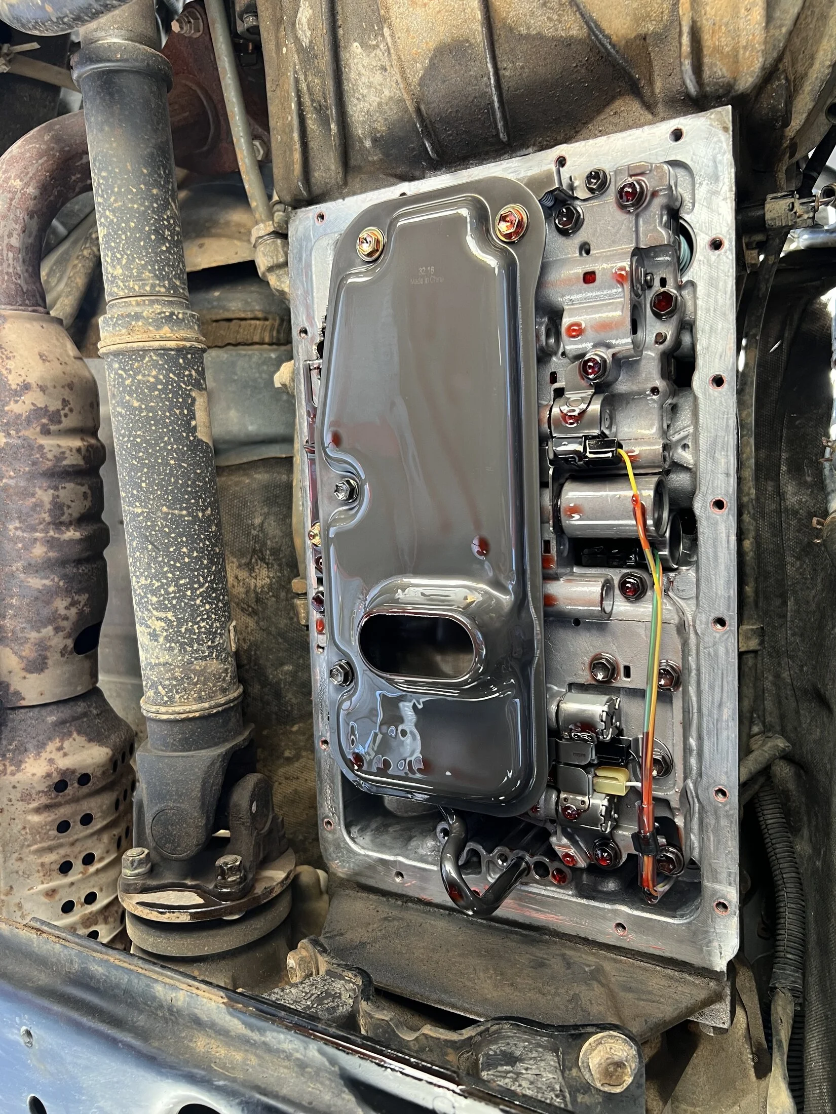

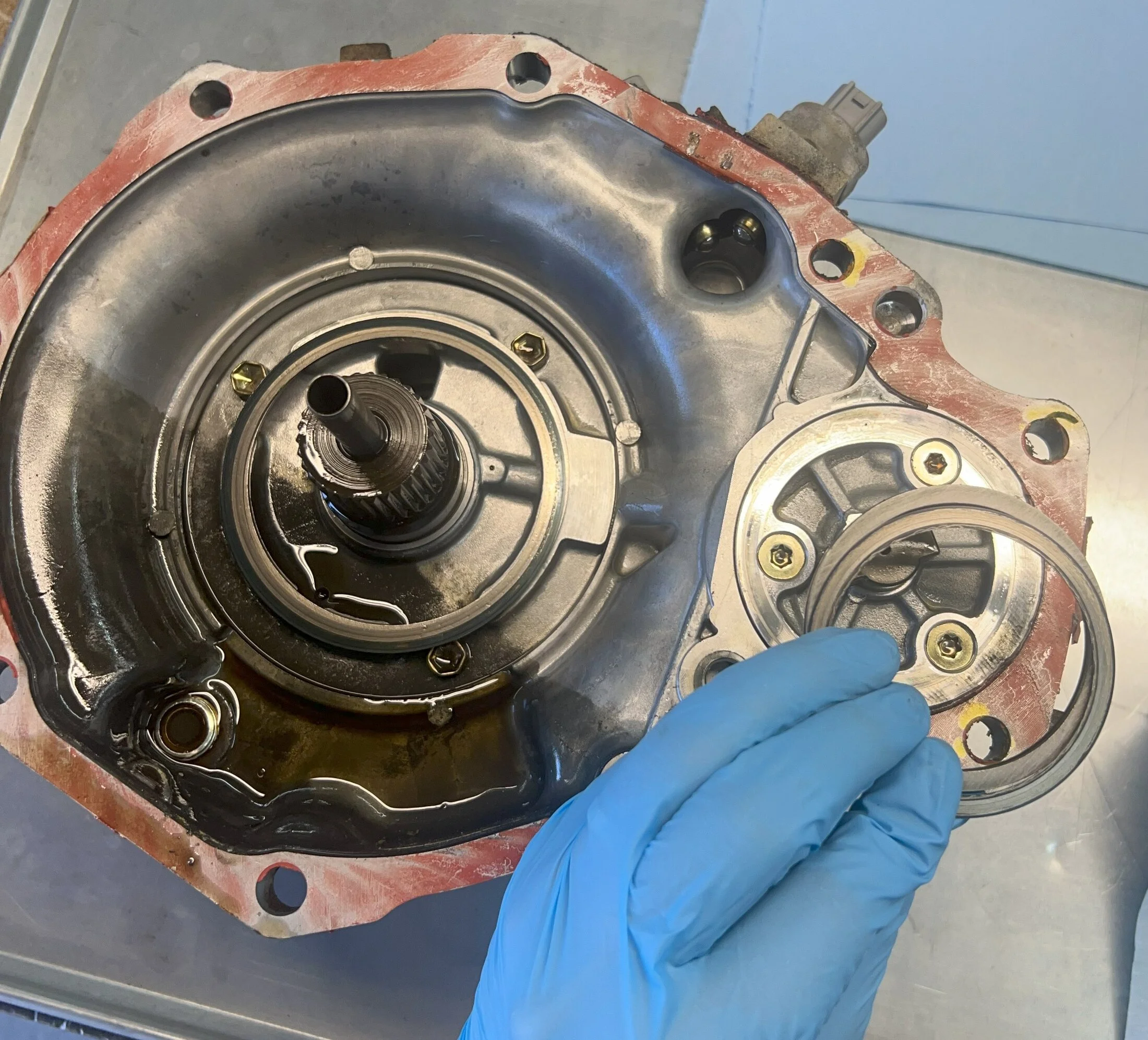

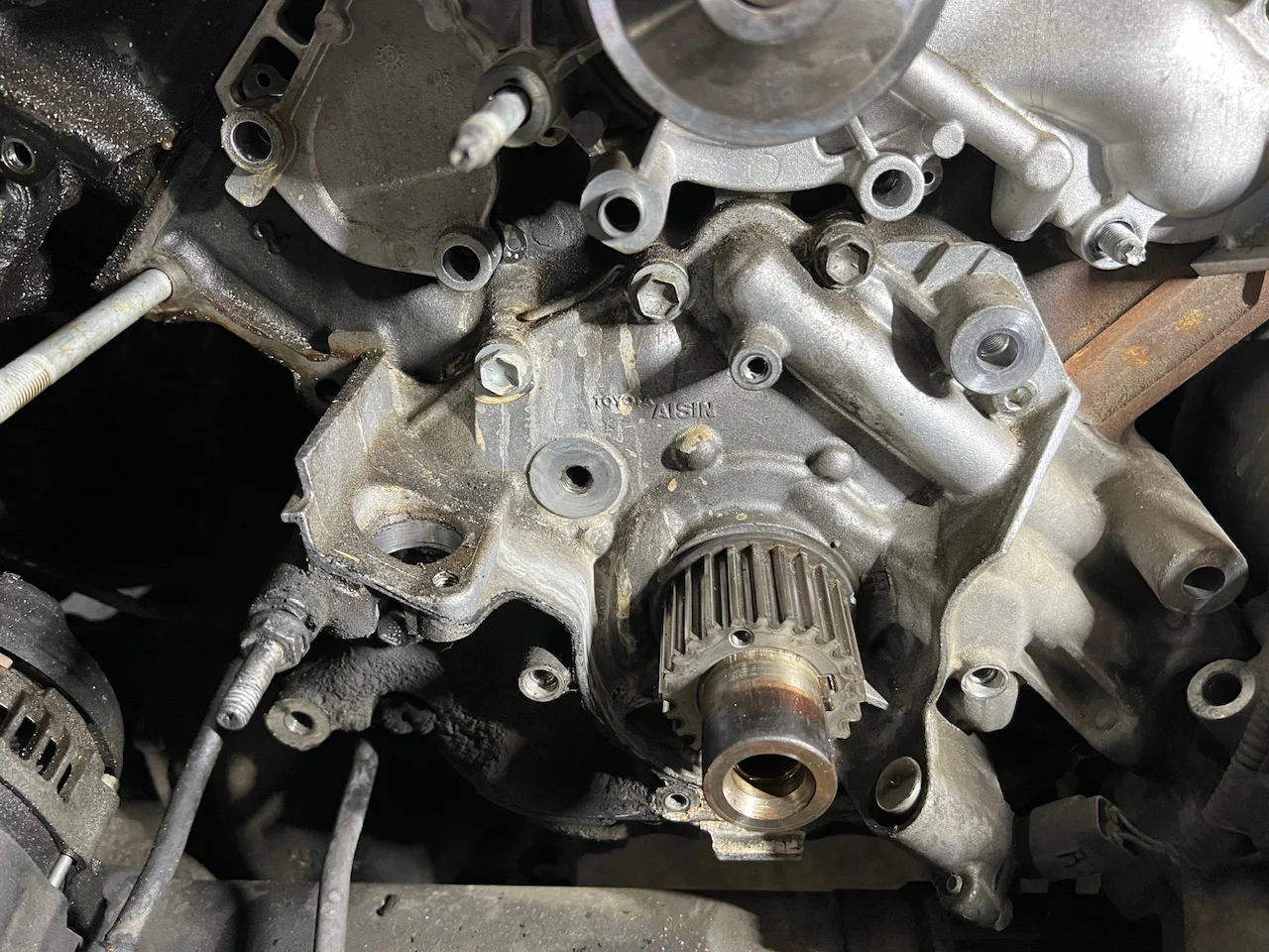

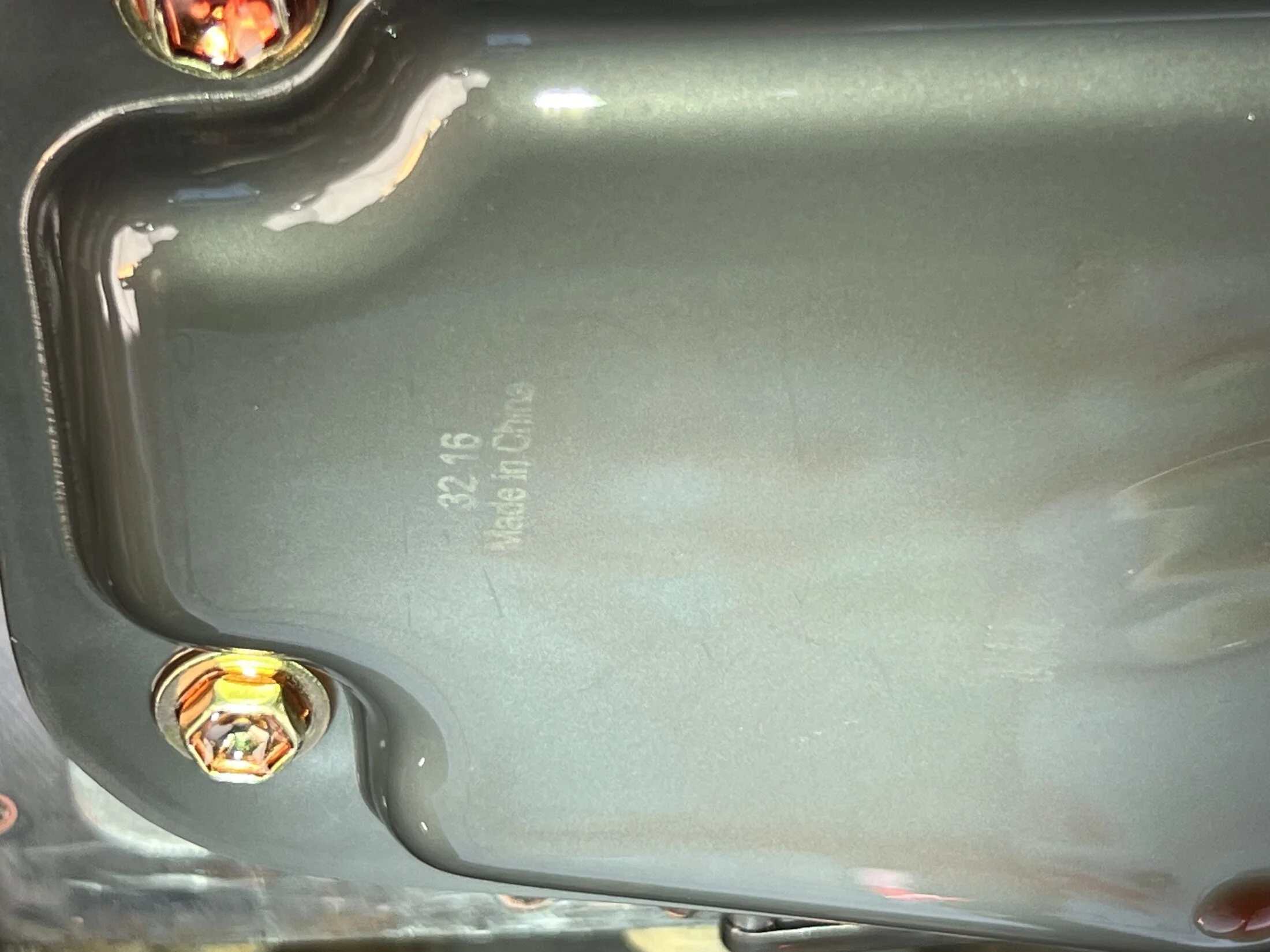

Started working on some big tasks that I hope to finish before the end of next week. On the docket is an oil change, transmission pan replacement, transfer case rear end R&R along with bearing replacement, heat shielding, replacing charcoal canister, and new headlights. If time permits I’ll also do a full rear end brake job and maybe a fuel pump replacement.
On the transmission I have been monitoring seepage that seemed to be coming from the area where the fipg should have been. Well just removed the bolts and the pan fell down sans any fipg. Seems the previous owner had some work done down there. The mechanic at the time use some cheap felt gasket that was seeping.
I’m guessing the OEM transmission filter isn’t made in China….
Now to investigate further and see what else isn’t OEM in there. Anyone see anything off the bat?

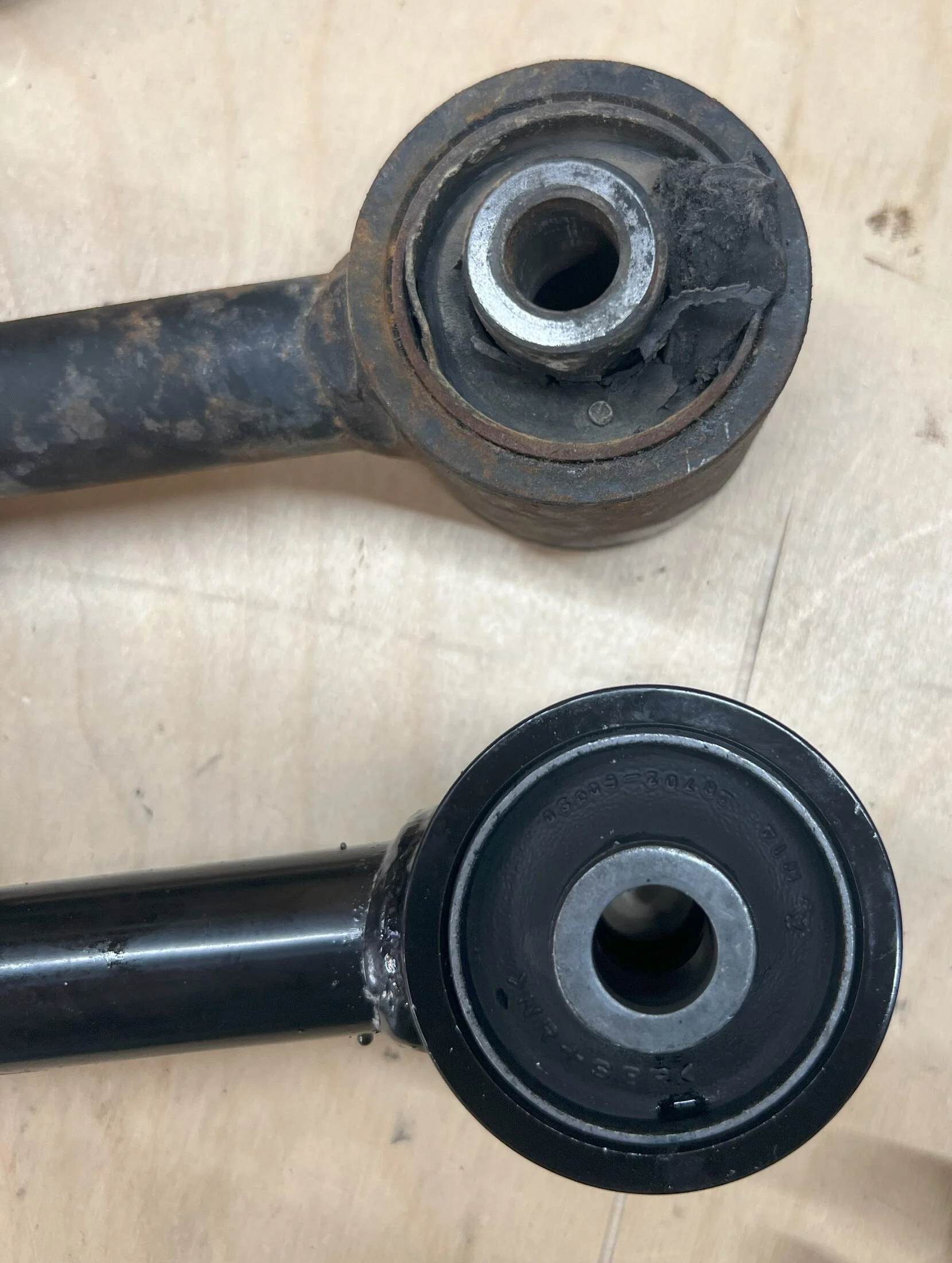

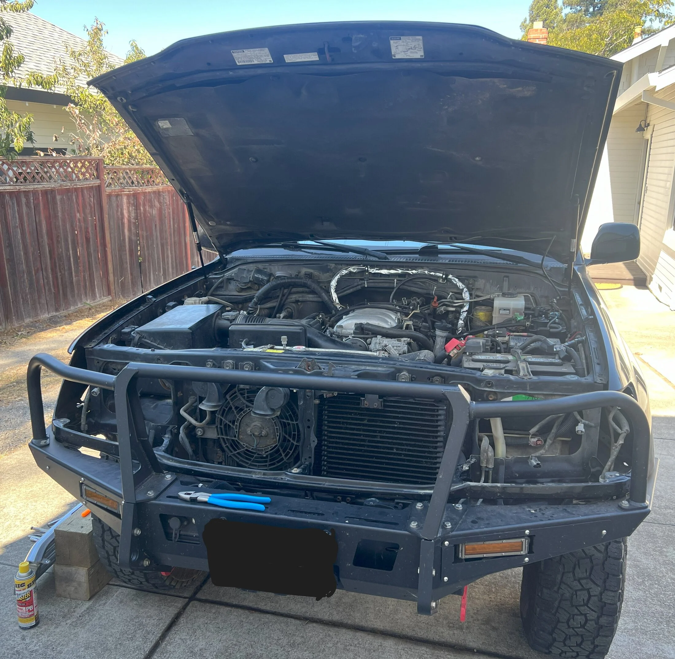

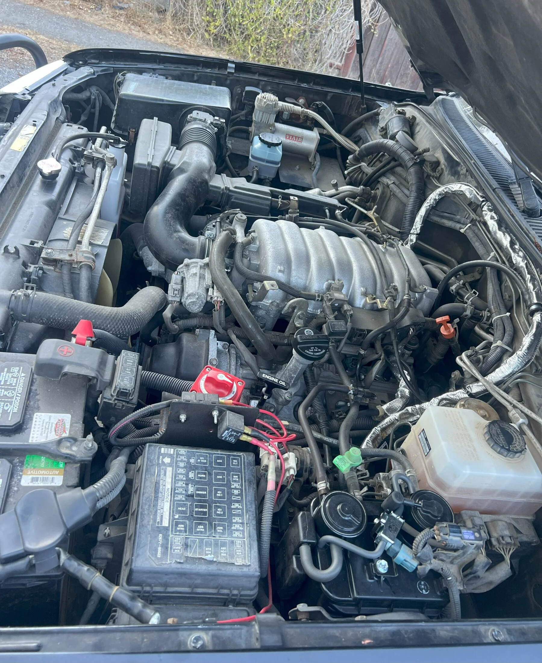

Took a week longer than I hoped, but finished up my big list of tasks which included:
  • Replaced radiator overflow reservoir
  • Rotated tires
  • Engine oil change
  • Lubricated drive shafts
  • Front/rear differential / transfer case oil change
  • Retorqued spark plugs
  • Replaced transmission pan and filter
  • Rebuilt transfer case rear output side
  • Replaced power steering reservoir
  • Flushed transmission fluid
  • Flushed power steering fluid
  • Cleaned transmission fluid cooler fins
  • Replaced charcoal canister
  • Replaced headlights
  • Adjusted passenger fender

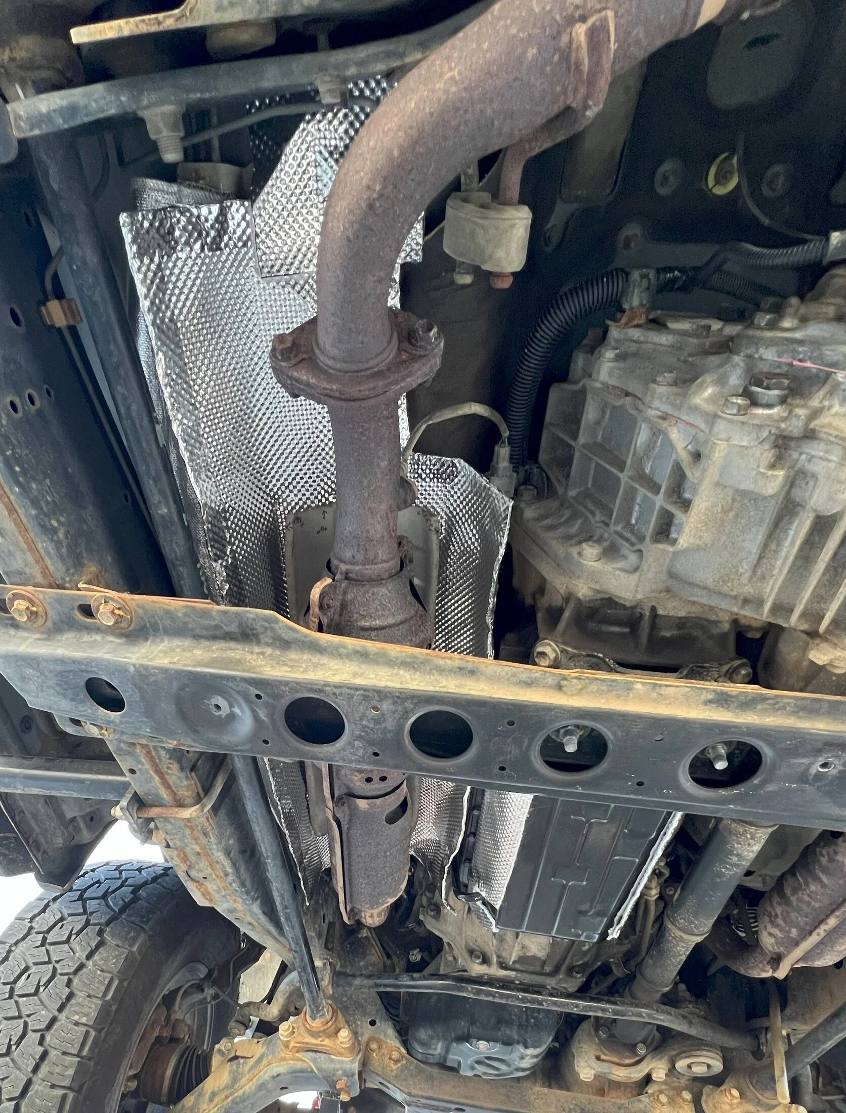

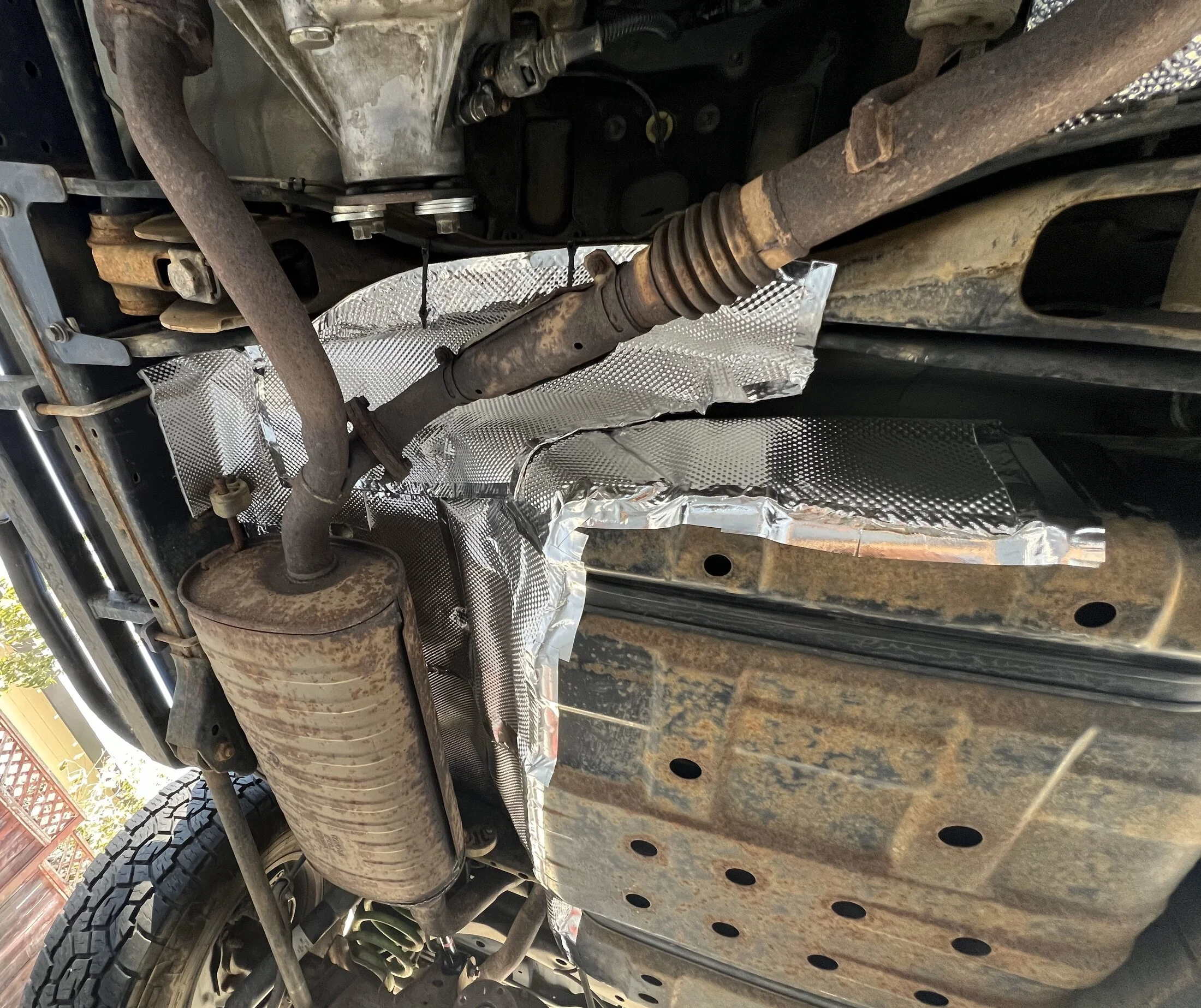

  • Heat shielded fuel lines, gas tank, muffler, rear passenger side UCA, rear AC lines, driver side cat, and the cross-over pipe
  • Relocated return fuel line off back of engine
  • Replaced wiper blades

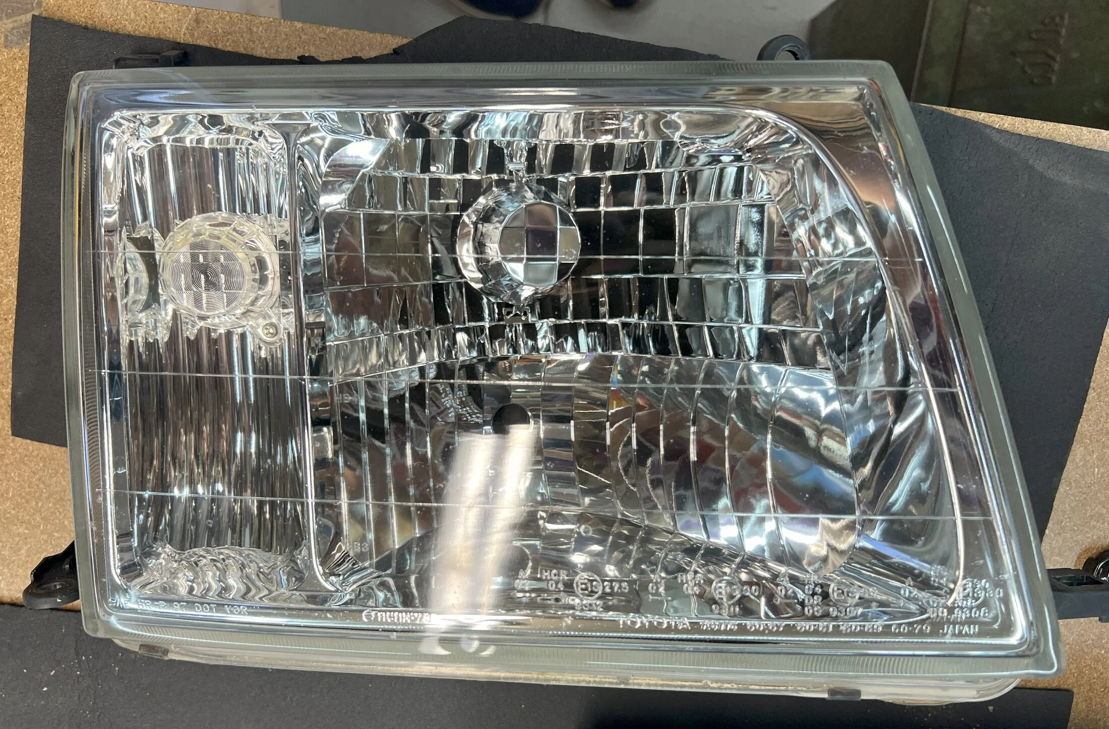

Old headlights are listed in the classifieds if anyone wants some glass ones or wants to use them for a LED/HID retrofit:
And because who doesn't love to look at pictures....
Engine Bay Goodies

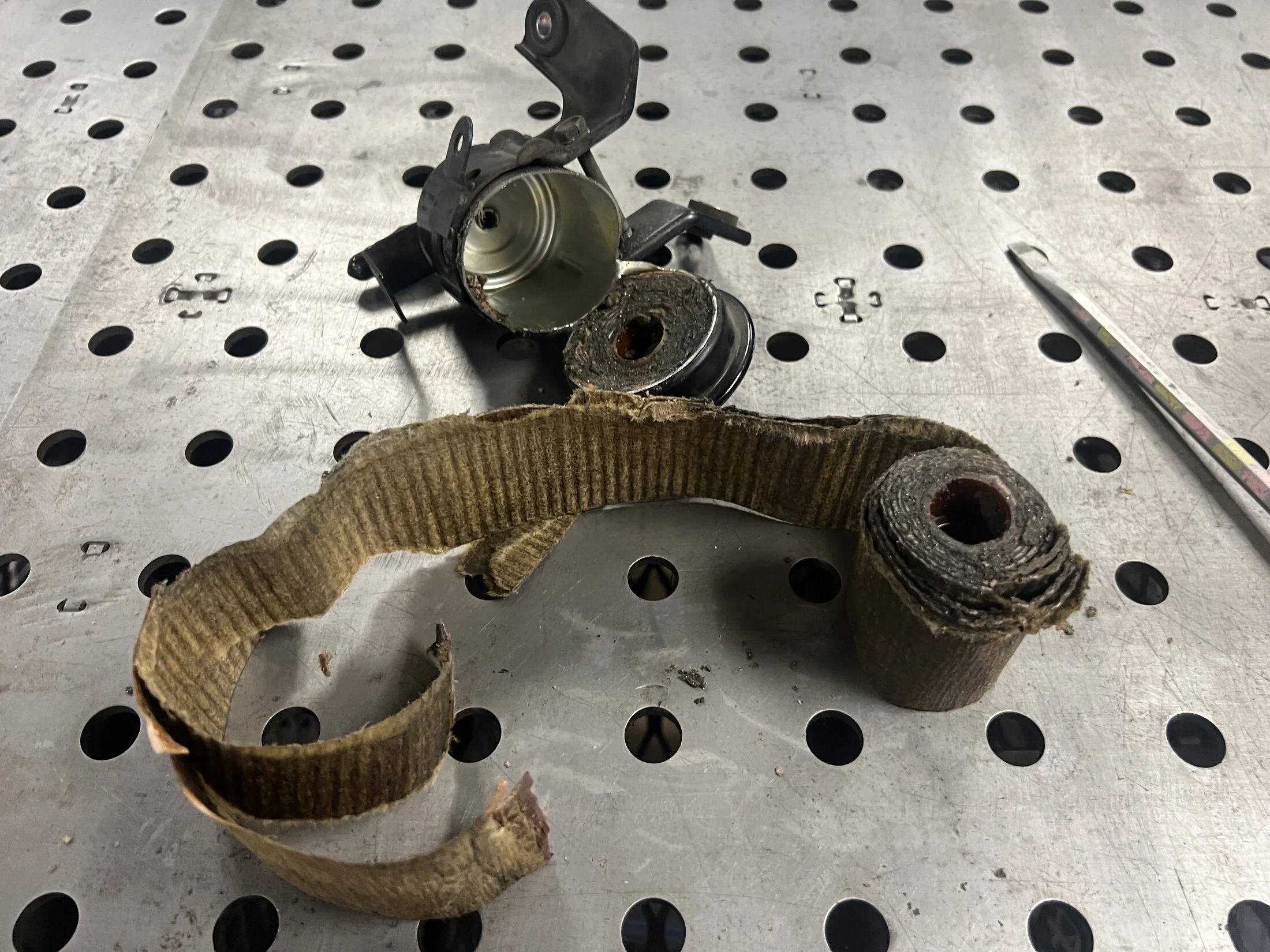

Heat Shielding
Headlight/Fender/Cleaning Transmission Fluid Cooler Stuff
Rear UCA

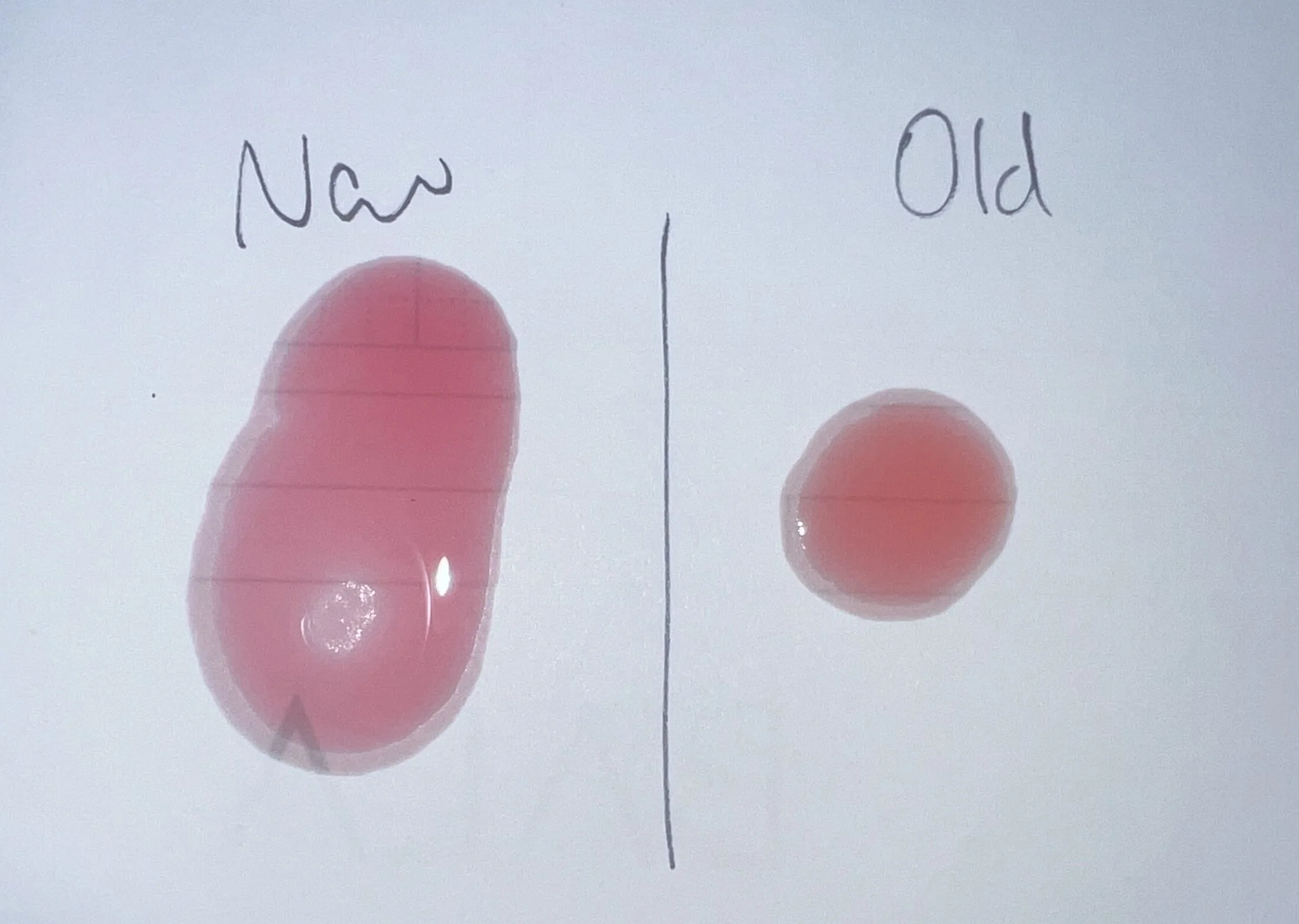

Transmission Fluid Flush New vs Old (old didn't look so bad after a couple drain & fills over the last 4 years)

Heat Shielding
Rear UCA
You did a lot, good job. FWIW I barely shielded my gas tank and with using ethanol free gas in the Rockies had no issues above 13k ft. With your shielding and ethanol free fuel you’ll be golden.
Thanks! I definitely went a bit overboard on the heat shielding, but I had some extra material so I figured why not. I have noticed difficulty in finding ethanol free fuel consistently so I figured more shielding plus the new charcoal canister would help.

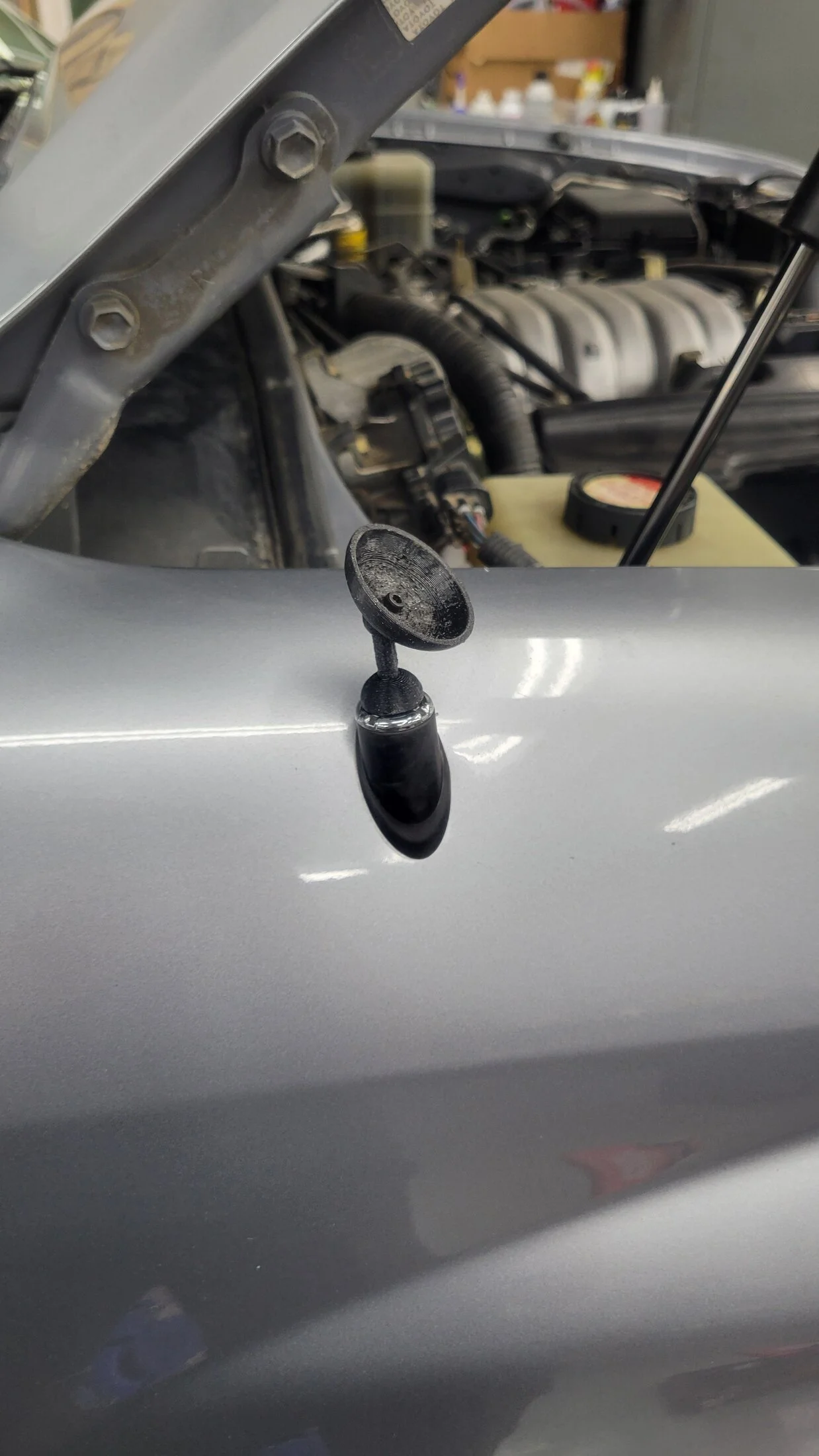

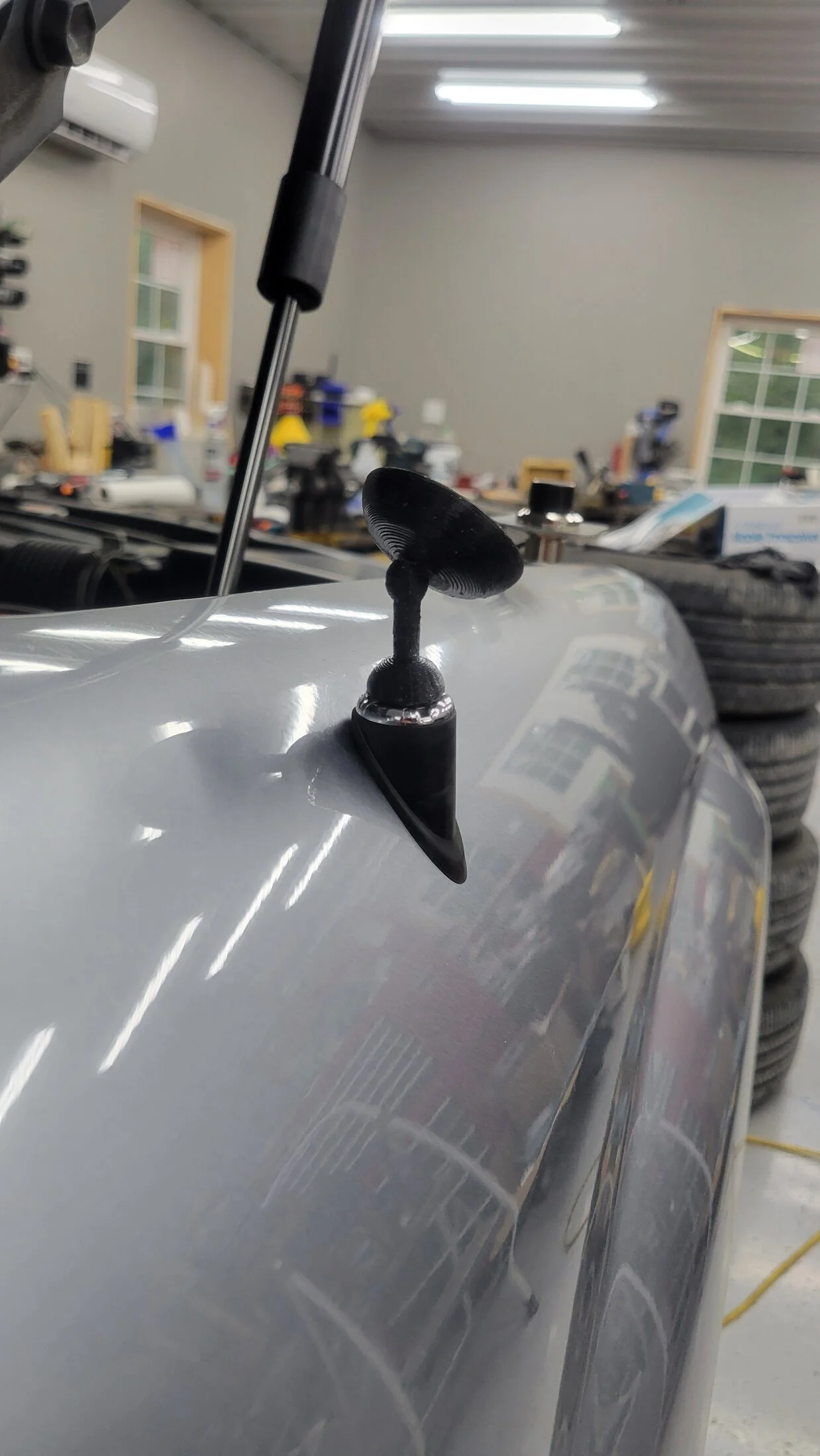

The previous owner of my LX BUTCHERED the FM antenna (and got rid of the mechanism for raising/lowering it) so I figured I might as well upgrade to that fancy satellite radio people talk about... 🤣🤣
The previous owner of my LX BUTCHERED the FM antenna (and got rid of the mechanism for raising/lowering it) so I figured I might as well upgrade to that fancy satellite radio people talk about... 🤣🤣View attachment 3736343View attachment 3736345
I love it. would be hilarious to have the mast a ball and the dish a socket so you can swivel it around LOL

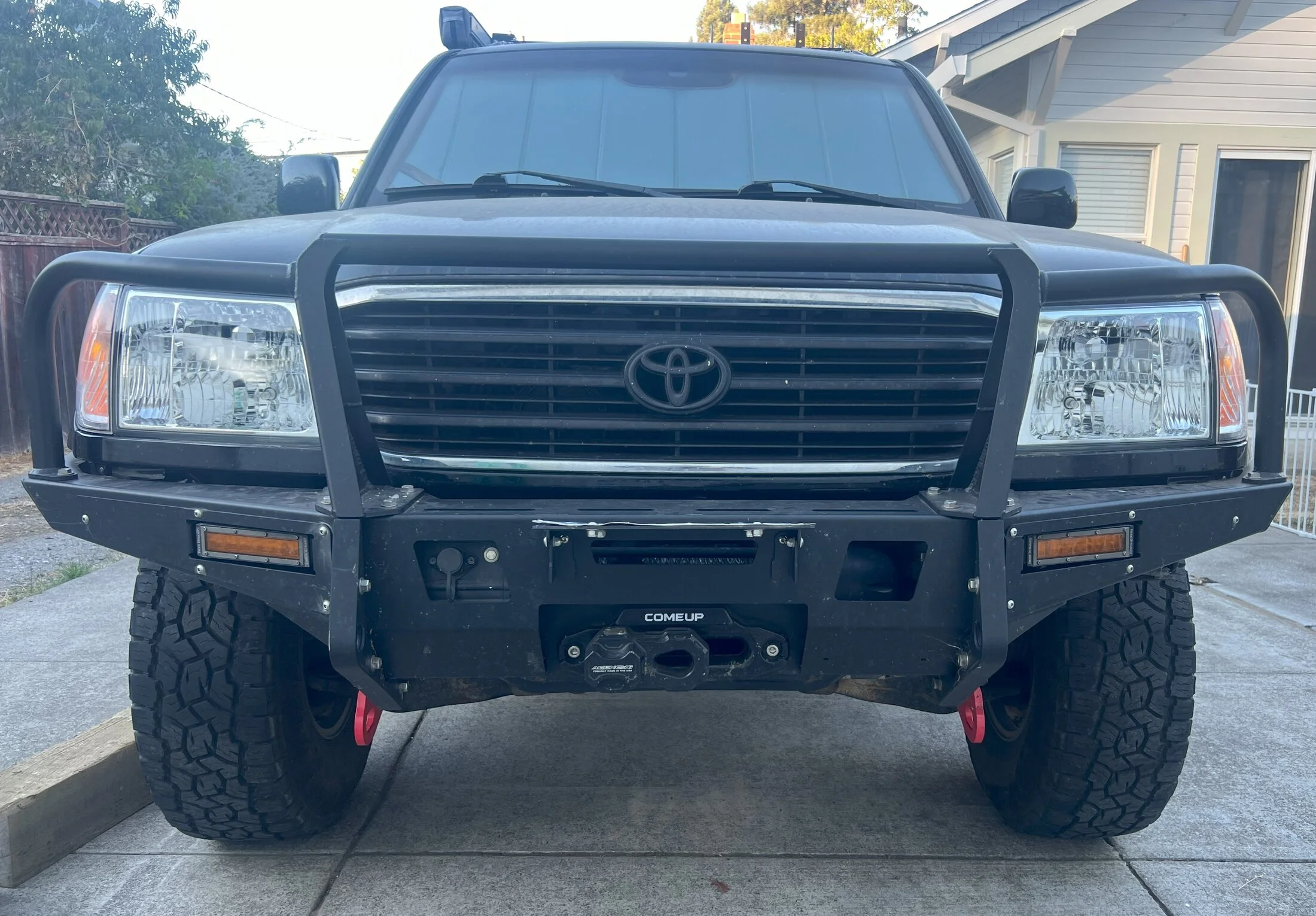

I made the jump from an 80 back into a 100. They both have their pros and cons, apples to oranges and all that. The 100 is just a better fit for my current needs. It’s good to be back!
Now I will start getting it ready for a trip to Moab in November. Small maintenance items (though not much) and a sleeping platform mostly.

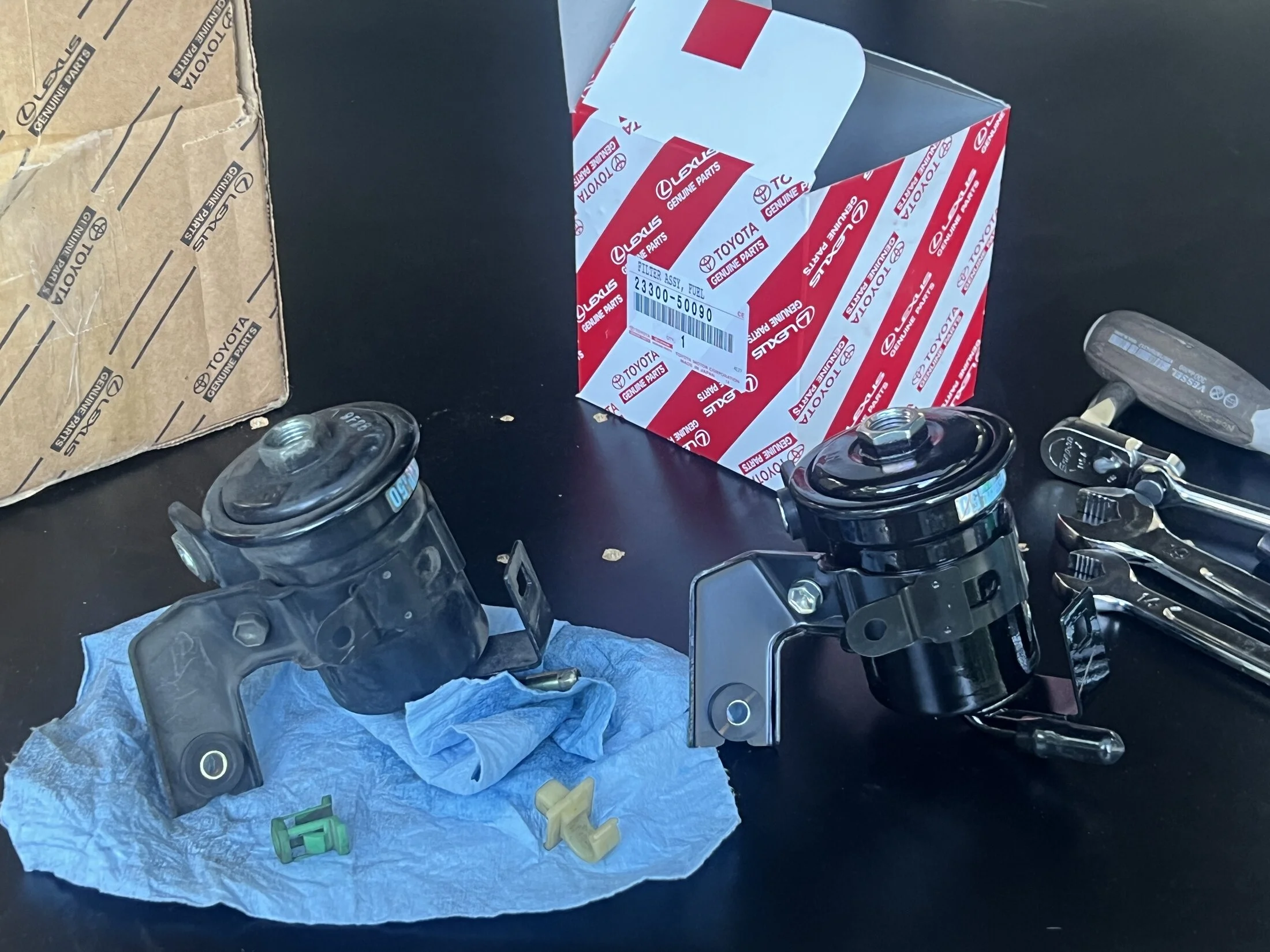

I noticed a fuel smell a few days ago when starting the engine, and decided to change the fuel filter first, which turned out to be the cause as I noticed a small leak from the base of the filter, where the L-shaped fuel line comes out of it. I didn't have any service records of when it was changed last so I cut it open to see what condition it was in........definitely needed to be changed...

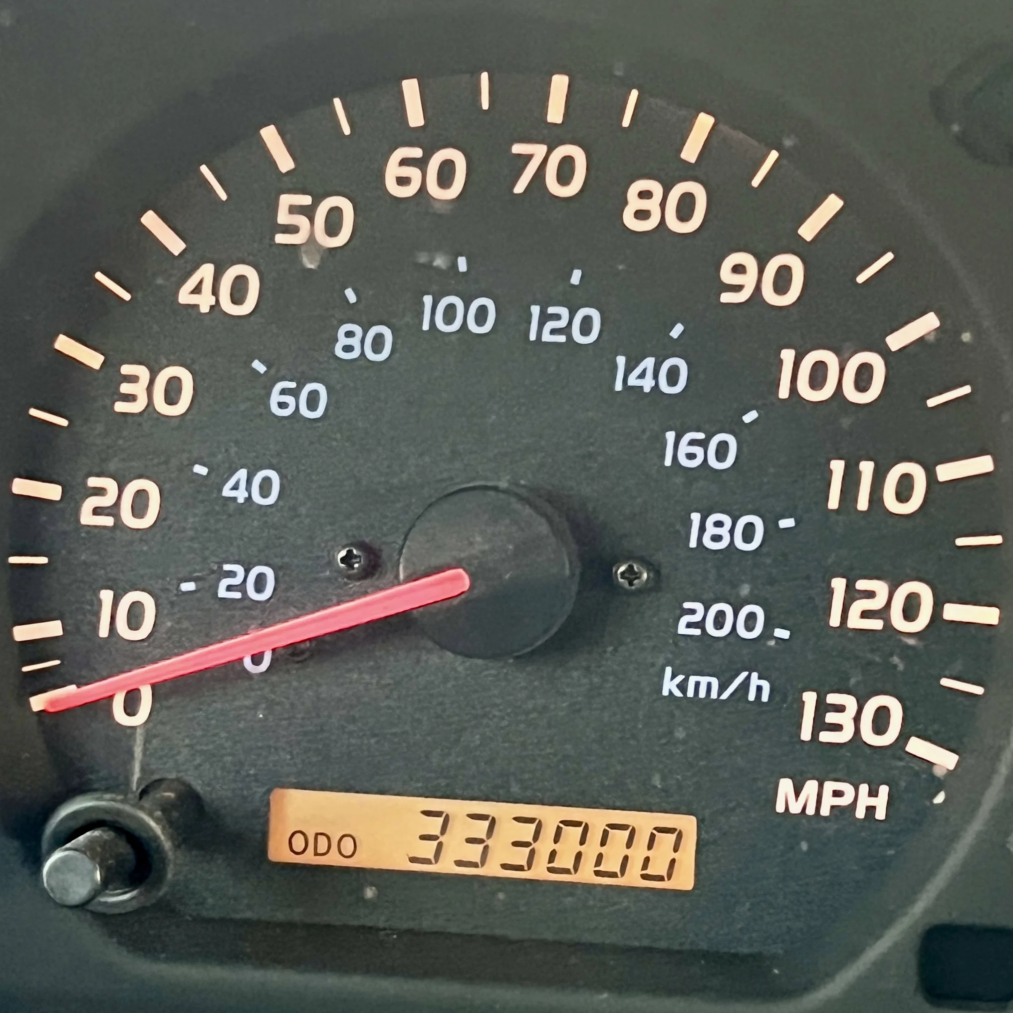

Also hit 333k miles today.

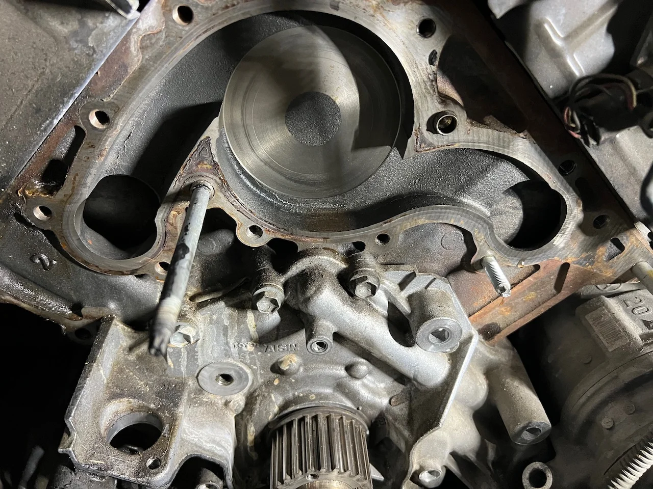

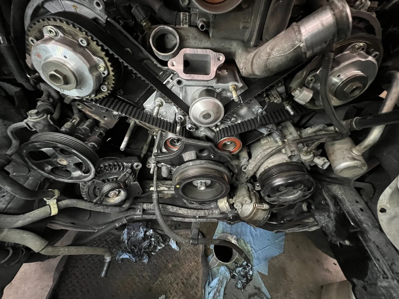

07 LX- Finished timing belt and all the extras. Ended up with new Denso radiator, hoses and clamps, and did the passenger side valve cover gasket. I need to get a set of 07 manuals. I was nervous about the vvti being different than my 2000, but in the end it’s exactly the same timing. I got in there because at the last oil change it looked like it was leaking coolant from the water pump, and sure enough, it was.
