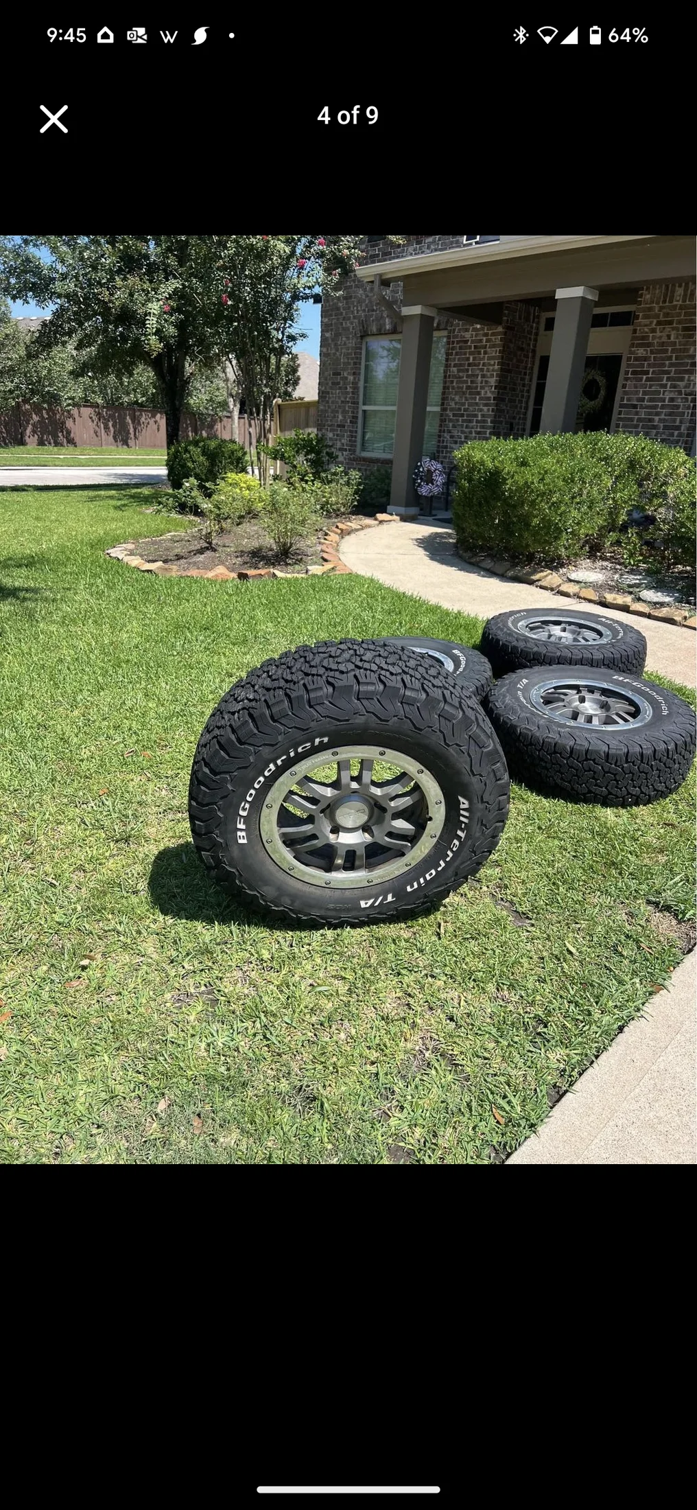

Picked these frim FB market place locally for $1000. Not a big fan of rock warriors but gonna give a try. Came with almost new 285/70R17 KO2s. I'll keep it if I can get rid of spacers currently on.

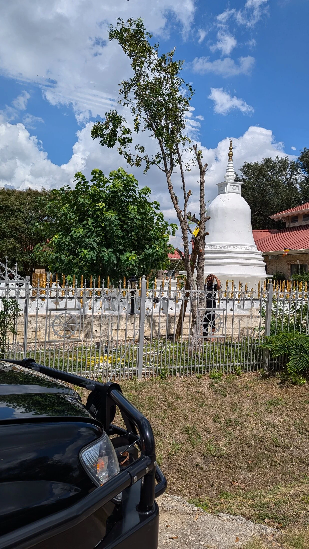

Another use of the winch. A friend badly wanted to save a treet pulled out from ground a side during Beryl. Straighten it even though I don't know it'll survive.

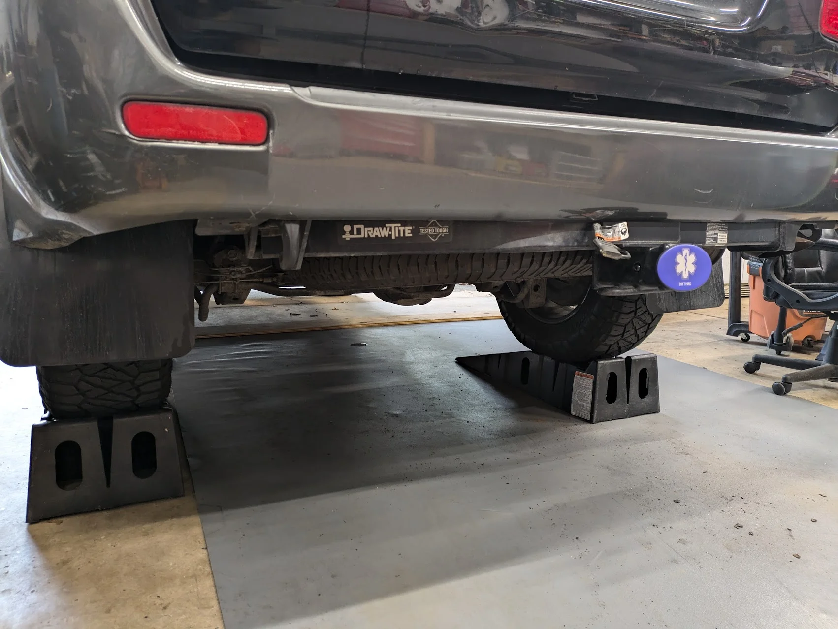

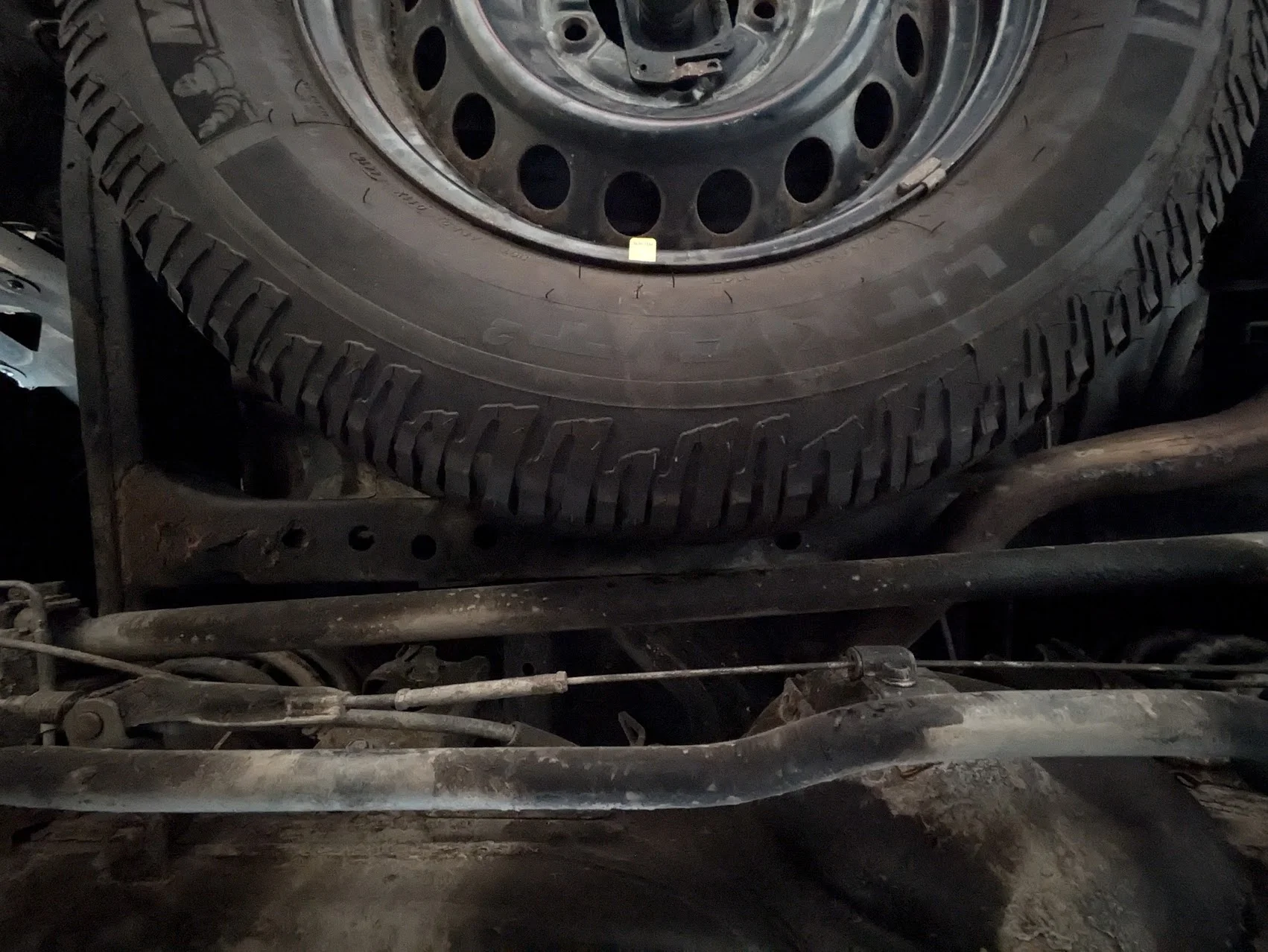

Finally finished raising the spare tire carrier and got the steelie spare that came with my Tundra rims mounted in place. The existing brackets were rusting away and I had to drill out three of the six bolts so as usual for anything underneath this truck, a 30 minute project turned into a few days. Also discovered a rust hole straight through a weld on the frame so I patched that up. Not the prettiest but it's stronger than a hole, so ...
It looks like my tow hitch is going to limit the size of a spare that I can pack under here. Not 100% sure an inch larger tire will fit so I might have to stick to 32s because that tow hitch sure ain't coming off.

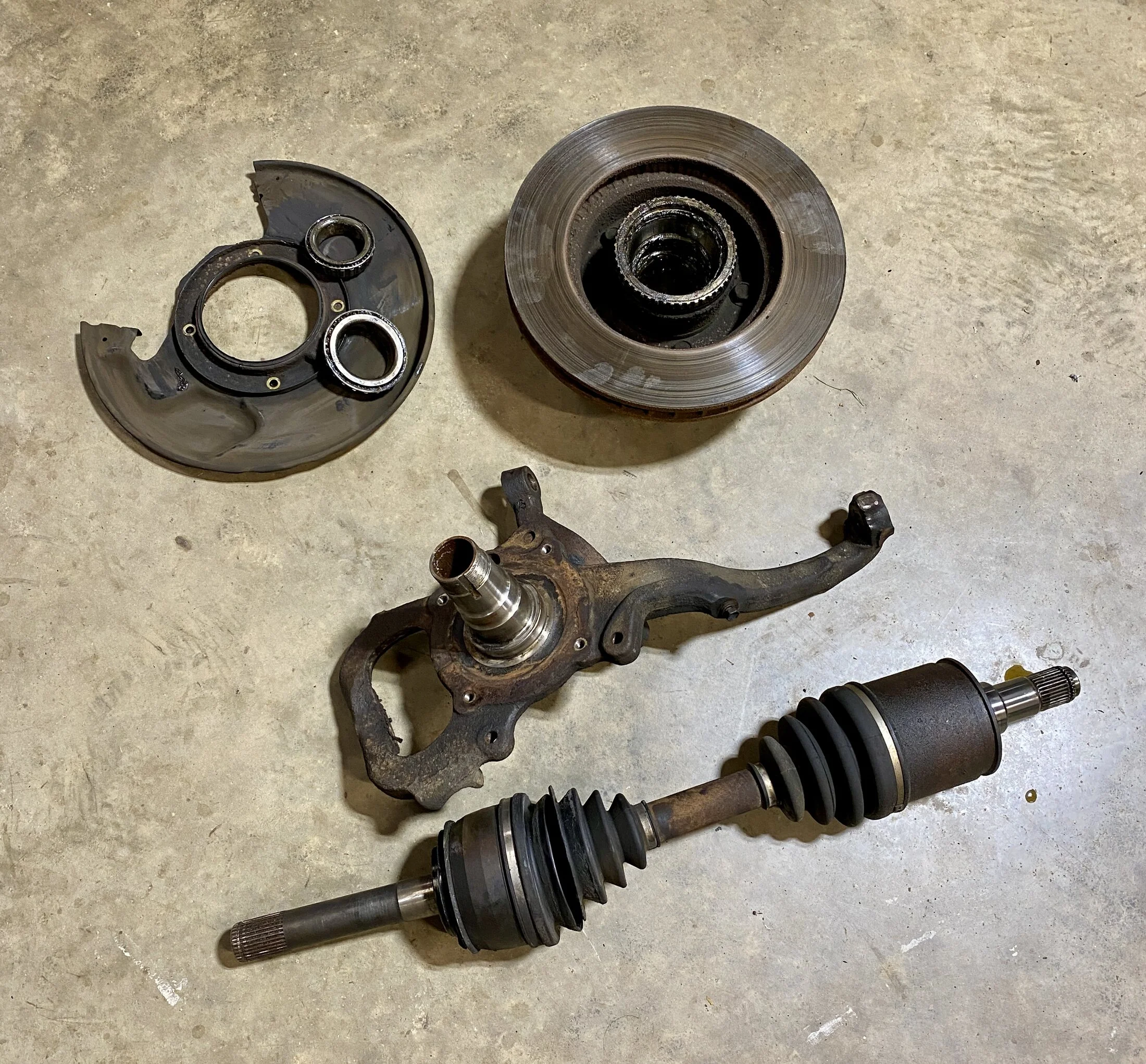

Full front-end baseline has started:
OEM CV boot kits
OEM bearings, seals, & brakes
Sway bar bushings and end links
OEM shocks
555 upper control arms
555 lower ball joints.
yeah! also did that when I couldn't get rid of my front end rattle. New bushings, needle bearings, all parts cleaned/ etched/ painted with POR15, ... :-) took some time, but finally solved it and gives peace of mind.

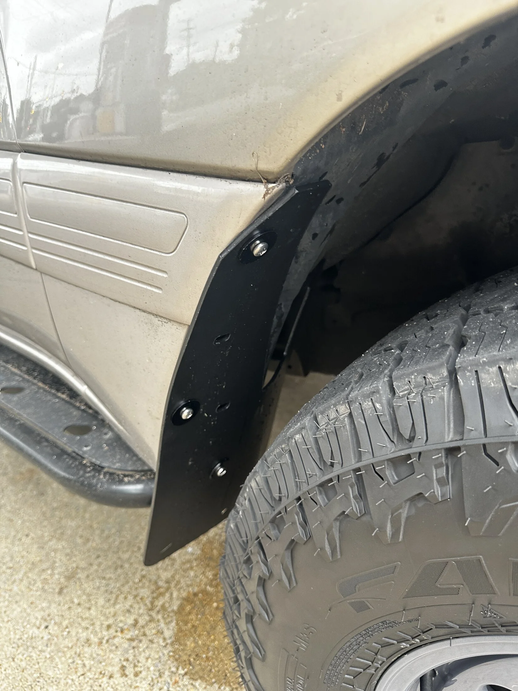

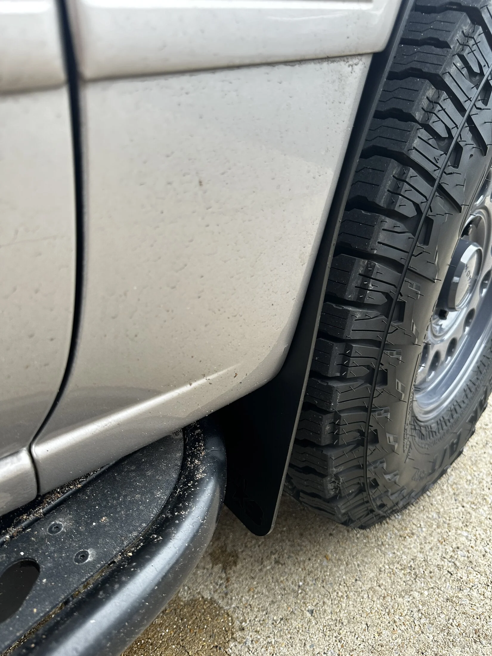

Had to lose the factory front flaps when I went to new wheels and tires. Also hammered the pinch weld and reformed the wheel liner
The rokblokz front kit for 08-21 Tundras fits well with minimal mods. Drill two holes in each flap and hit with a heat gun. Eventually I’m going to modify the brackets for the factory front flaps and use those.
Caveat: I haven’t fully stuffed it yet
Caveat: I haven’t fully stuffed it yetView attachment 3733409View attachment 3733410View attachment 3733411

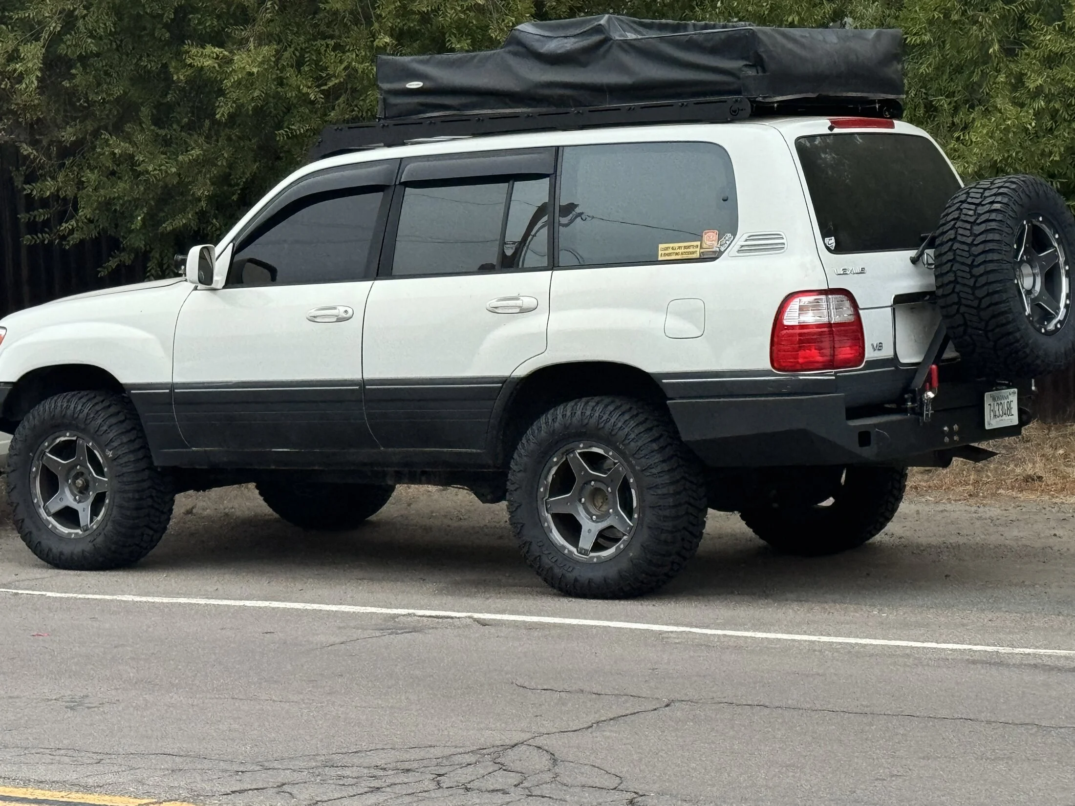

Jeez those wheels are gorgeous!
